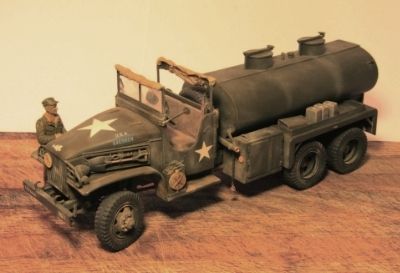

AND . . . If you should just get tired of having all those left over Italeri water tanks and Tamiya open cabs laying around you could build an open cab water truck just to use up some of those spares! (Anybody need the Italeri water tanks parts? I got lots and I hate to see good plastic go to waste!)
Mike,
Thanks for the water truck parts and Opel front axle. I think our cat and the carpet monster are running a con. After moving the bag around (liked the bag, shapeways 5th wheel 😂 ), he started running off with the tool cabinet. The monster tried to take a rear spring. I successfully wrestled the parts away from both and into the correct boxes.

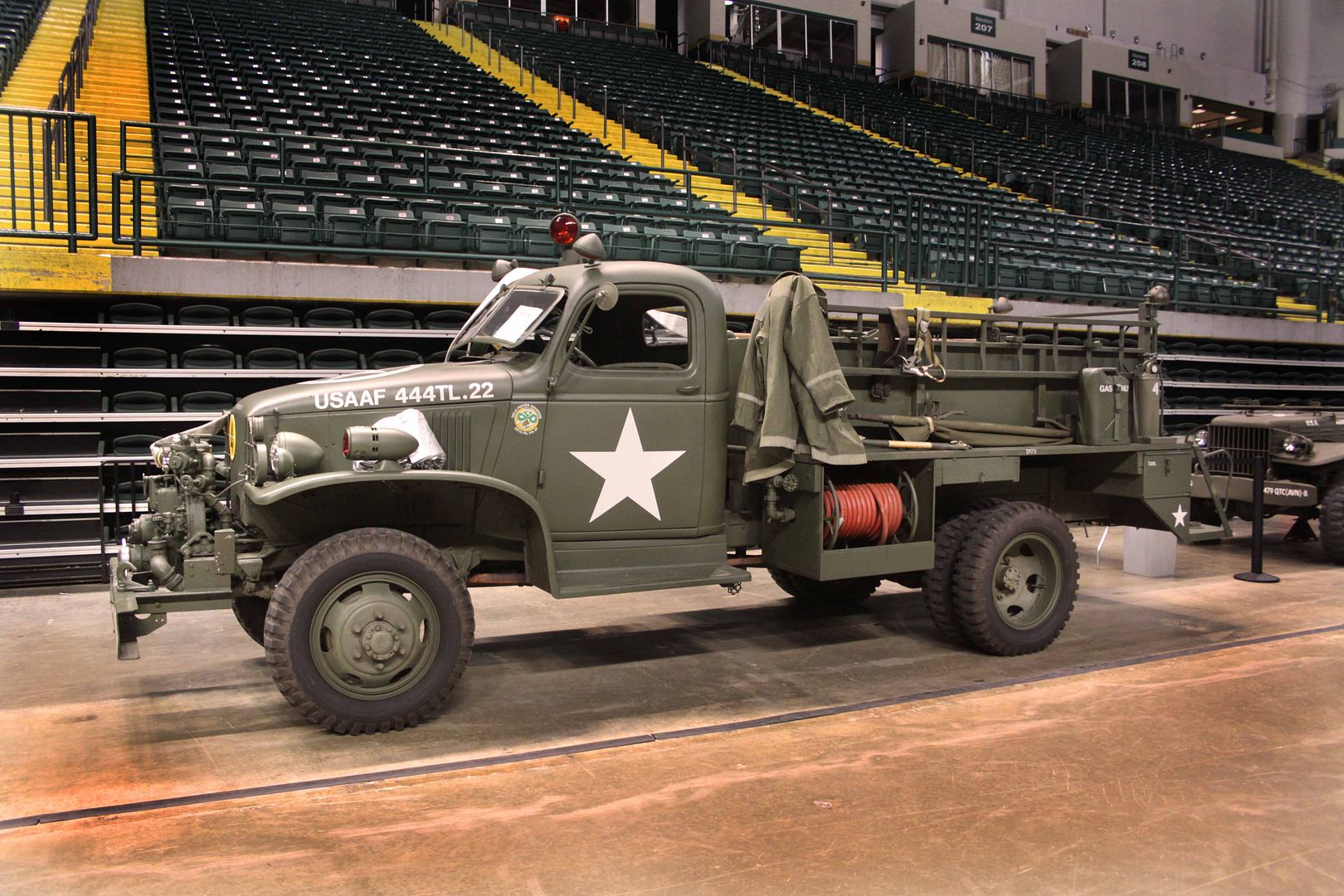

Well I intend to use that Italeri water tank to build this Fire Truck version (if I ever get around to it!) Will also use those left over Italeri DUKW tires for this one as well.[/URL]
Don't waste your time on the Italeri DUKW wheels - they are undersized inaccurate garbage! Get some DEF Model DUKW wheels instead. (No point doing all that scratch work only to ruin it with bad wheels!)

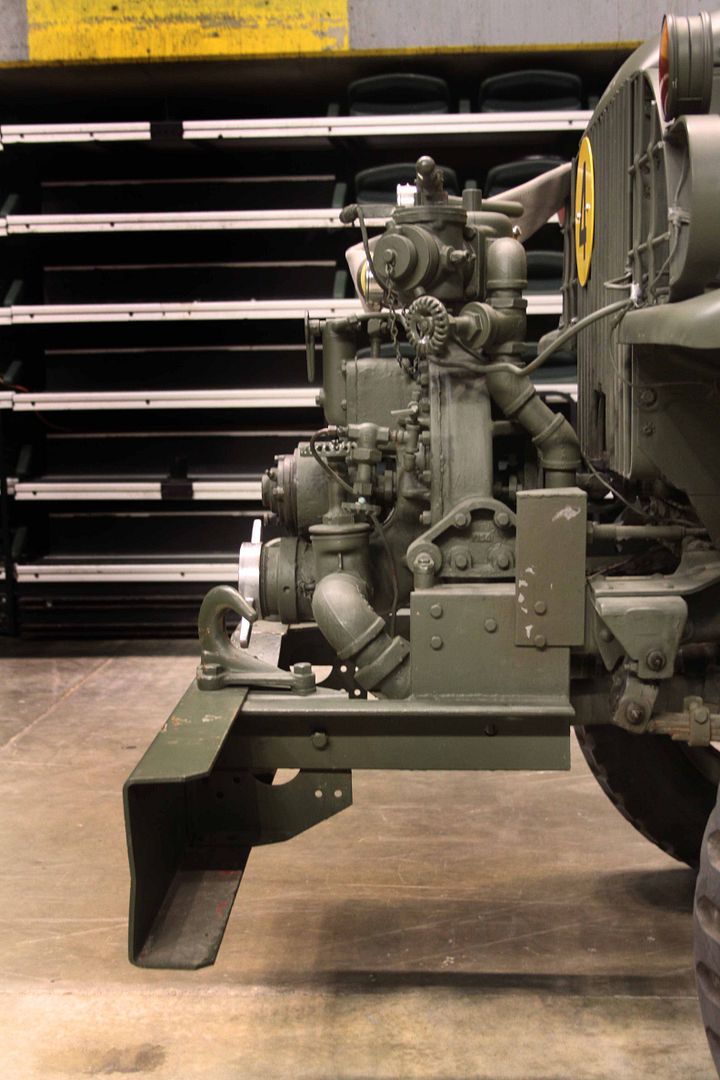

Posted: Saturday, October 03, 2020 - 01:23 AM UTC
Also on my list for future (after I'm gone) builds:
I have everything I need for the build except the Darley water pump and Tom just connected me to that on SW.
I contacted Darley in hopes they still had tech manuals/engineering drawings for my doing a scratch build on this pump but sadly no.
I've got some too - I wonder if they are the right size and shape for one of the many fire trucks built on Chevy or GMC frames? I found and ordered a Darley pump from Shapeways for just such a conversion...
[EDIT: This is the pump: https://www.shapeways.com/product/GTF4UAQJ5/1-35th-darley-fire-pump-front-mount?optionId=137982208&li=ostatus]

Posted: Wednesday, September 30, 2020 - 03:39 AM UTC

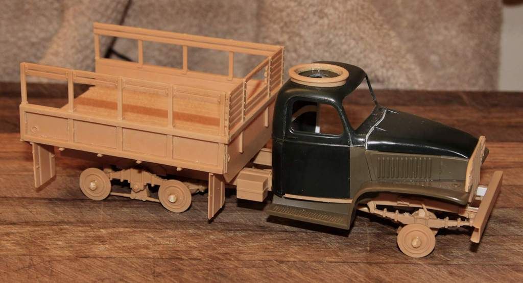

Posted: Wednesday, September 30, 2020 - 01:10 AM UTC
Some out there will roll their eyes and say "Oh not this again . . . but."
I recommend for those who want to make this conversion that you stick to using the Italeri water truck as you donor kit.
Some will ask why not use the newer HobbyBoss hard cab kit? The HobbyBoss cab and fenders have a serious proportional problem: The fenders and hood are too long and the cab has then been foreshortened to make up for the problem. This started with their very first offering of the open cab Deuce which mounts the Bofors AAA gun and has continued thru their entire line of CCKW offerings. The remainder of the kit is extremely well done but when building any of their versions of the CCKW I continue to substitute the Italeri hard cab for the HB.
However the HB squashed cab might be a good candidate for use in building a semi-scratch Bedford truck??? - Waste not want not!
Here is one of my HB Short Wheel Base trucks under construction using the Italeri cab and Tamiya fenders - that was kind of a tough joining - I suggest you just stick to using the full Italeri cab and fender combo which is an easy drop-in conversion!
