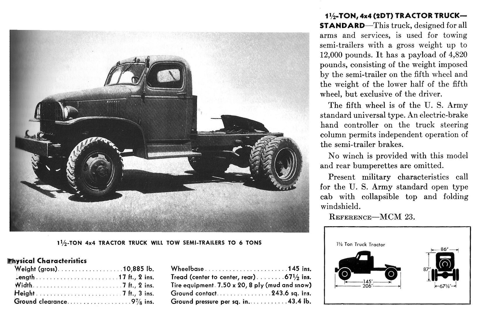

Wanted to reconfirm a reference on the wheelbase for the G7113.
This scan comes from Hogg's book "The WWII Standard Ordinance Catalog - of the American Arsenal"
Wheelbase: 145 inches - Overall length: (frame Length) 206 inches.
Posted: Monday, September 28, 2020 - 10:34 PM UTC

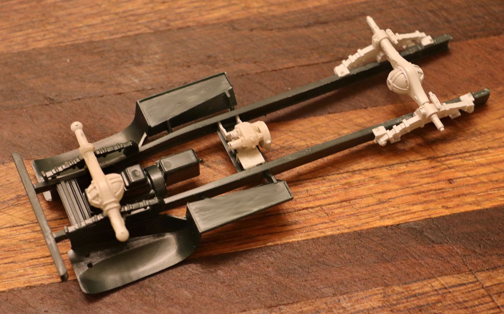

I am taking a slightly different tact on construction of my G7113 than recommended by barkingdigger.
I built the forward portion of the vehicle frame first just as Tom recommends but then I went ahead and installed the forward axle and the front bumper. This gives me the two serious landmarks I needed for locating both the rear axle (at 145") and the cut of the rear frame. (at 206")
I will also forego the drilling of mounting holes for the rear spring shackles. Rather I have built up the rear axle and springs as a separate assembly, removing entirely the shackle locating pins from the 3D print. After cleaning up the frame as instructed, the rear axle/spring assembly will then slide fore and aft on the frame. I will then use my scale rule to locate the placement of the rear axle and when in place, will secure the entire assembly with super glue.
At this point I have already cut the frame but intentionally cut it a couple of scale inches too long just to be on the safe side.
Rear axle is dry fit only right now.

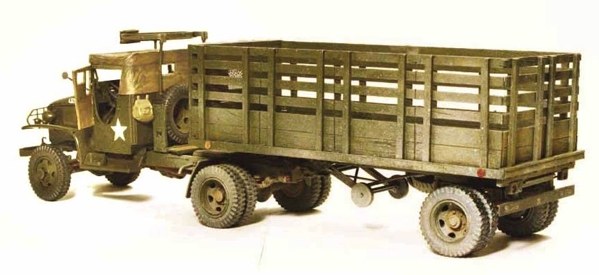

Posted: Tuesday, September 29, 2020 - 07:08 AM UTC
Hi Mike,
You wanted to see those trailer parts!
The springs are blue, the yellow is the spare-wheel holder and the landing gear, and the green is those latches on the top corners of the removable stake panels. The rest I'll scratch from Evergreen.

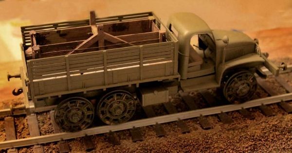

I went down that same track but took a different branch line . . . . . .
(always thought that COE locomotive looked
just a little too weird for my taste. IMHO)
Still a work in process.
Always with a load box full of scrap metal or stone for added traction.

Tom - I like that you added the hardware for connecting the stake bed sections.
Consider adding the rear body beam that includes the taillights and the rear bumper. (Not sure these vehicles had a rear bumper (as it was not till the 60's & 70's with the death of some important Hollywood starlet that these anti-rununder bumpers became der rigare.)
You might want to look at the other trailers to see if there is additional hardware to add to your set. (Just to make the set even more broadly interesting.) Then there is also the more visually interesting 45 degree angled spare tire holder.
Please let us know when this trailer set will be available as I will be you first customer.

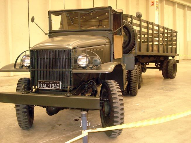

Field expédient conversion of a SWB Deuce into a soft cab semi-tractor.
Museum Vehicle:
Posted: Wednesday, September 30, 2020 - 01:10 AM UTC

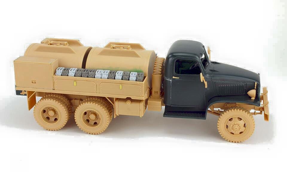

Posted: Wednesday, September 30, 2020 - 03:32 AM UTC
More work by John Hale: Here is the HobbyBoss fuel truck with the substituted Italeri hard cab. John also said the HB fuel cans were messed up - I suggest substituting the Asuka set.
Please Note: No alterations to the HB chassis are necessary to drop on the more correct Italeri cab.
