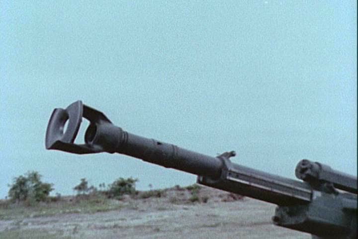

Posted: Friday, May 08, 2020 - 11:32 AM UTC
Some phots I found on the net. I just noticed the orientation of the muzzle brake.

Posted: Friday, May 08, 2020 - 12:16 PM UTC
[quote]Some phots I found on the net. I just noticed the orientation of the muzzle brake.
Hi Steve, thanks for checking in, I hadnít come across those photos.
Iíve seen the brake oriented both ways.
Here is a video in the horizontal orientation:
M102 movie
Here are some M102s with vertical brakes
Riverine Operations
Itís just tacked on, and I may switch it around as Iím starting to wonder if they were mounted differently for land verse riverine operations.
HeavyArty
Joined: May 16, 2002
KitMaker: 17,499 posts
AeroScale: 1,698 posts
Posted: Friday, May 08, 2020 - 12:26 PM UTC
...Iím starting to wonder if they were mounted differently for land verse riverine operations.
I have only seen the muzzle brake used on the floating firing platforms. All the land-based M102s I can find pics of have smooth barrels w/out the muzzle brake. That makes sense since the muzzle brake reduces the recoil, which would be needed on the "floating" platforms.
sherb
Joined: August 25, 2004
KitMaker: 708 posts
AeroScale: 14 posts
Posted: Friday, May 08, 2020 - 01:24 PM UTC
Even amongst the Riverine M102s the brakes are pretty rare.
The video I linked to above with the brake in use on land is from 1965. I've seen just handful of photos with land based Vietnam M102s (with brakes) in use with the 1st Cav. in '66 and '67.
Here are some 1st Cav. M102s in action with the muzzle brakes
Operation Crazy Horse Some neat high angle firing about 1 minute in.

Posted: Saturday, May 09, 2020 - 01:05 AM UTC
On the topic of muzzle brakes on land based M102s. They are out there, but seem pretty rare, as already stated:
Could the orientation of the brake have something to do with how the gases are reflected backwards, and effecting the crew?

Posted: Tuesday, May 26, 2020 - 11:37 AM UTC
Maybe there is a risk that the muzzle brake could kick up dust and increase the risk of being located?
The blast from the muzzle brake mostly goes sideways, the baffles redirect the hot gas slightly more than 90 degrees
