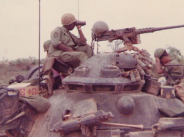

Building an M48A3 for a Vietnam dio and need some pics (if available) please.
Specifically:
- Looking for pics of the externally mounted .50 cal on the commander's cupola of the M48s in RVN (where and how was it attached to the cupola?)

Can't help with the interior pics, but can on the external gun mount. They were field expedient mounts.
Most were just a pipe welded on top of the commander's cupola.
Some welded an M113 gun mount to the cupola.
Or a cut down tripod welded onto it.

Seems the external mounts for the .50 cal were the M113 commander cupola MG mount, and the M-2 MG tripod mount minus the legs. Welded to the top of the M48 TC cupola/top of the MG mount. Note what a large hole is left when the .50 cal is not mounted in the cupola mount.

First of all, the fifty call mount was a field mod and not a factory revision. They were very different between units. You really need to see the tank your building.

I was aware that the .50 cal mount was a "field expedient" mod and not standard throughout the armor units in RVN. The photos that Frenchy provided + my own research gave me what I needed so, appreciate the input. I'm "good to go" on the .50 cal mount.
