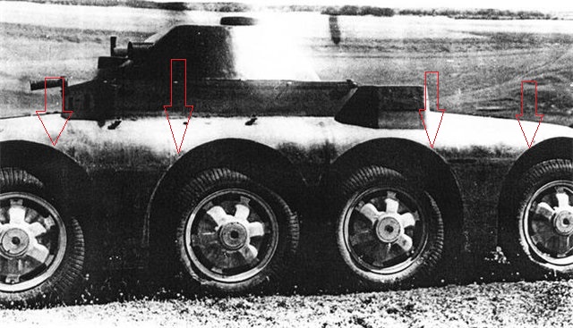

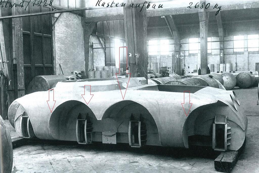

I see welds on this photos. So I have decided to make them. It was a difficult decision because it is quite hard to do welds in a such places. On a hull I make some grooves for putty.
I've decided to glue some plastic below and cut off a little stripes of plastic which would be filled by putty later.
