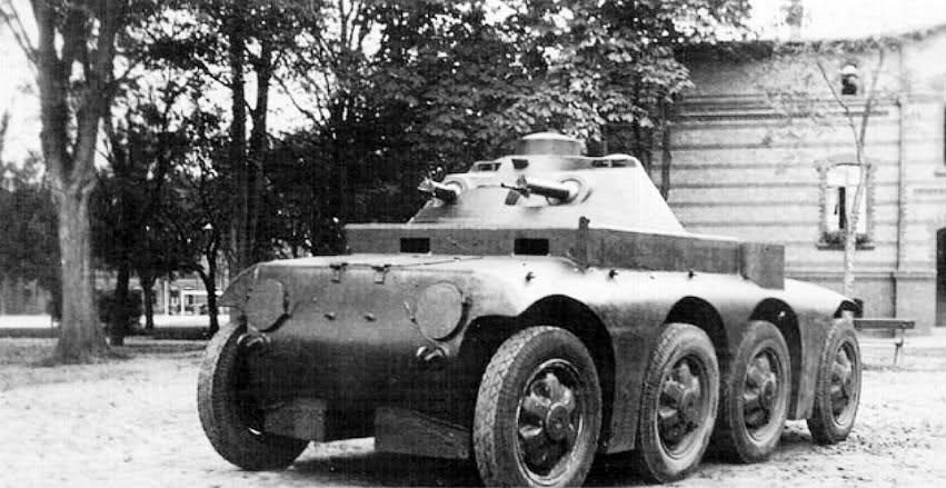

1. This was a prototype.
2. I read somewhere that the specified weight limit was to be 7.5 tons and the armour was specified as 13.5 mm
3. The rims were cast from some kind of light metal alloy to keep the weight down.
Casting something large is one thing, casting something large and with thin walls, 13.5 mm thick sides of a casting that is somewhere around 5.5 meters long is more difficult.
My guess is that the hull was not cast at all except maybe for small pieces. If I were to build such a prototype I would use steel plates. For the full scale production it might be better to use casting but considering the shapes of the hull it could still be easier to shape steel plates and weld them together. Maybe it was even a simple armoured box with rounded ends and the fancy shapes over the wheels was only thin sheet metal.
The welds you have made under the wheel arches:
would fit the armoured box theory. The flat sides is the armoured box and the rounded shapes on the outside are there to increase volume to try and meet the original requirement that the ARW should float ...
Maybe you have already seen this page:
http://aviarmor.net/tww2/armored_cars/germany/arw.htm
The answer to your question: My guess is that almost the whole thing was welded. Don't know what I should say about the turret though ...

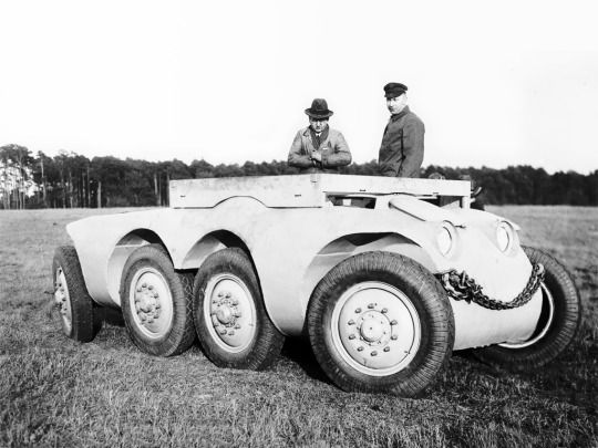

For sure another refreshingly rare subject, designed around 1928 but the Depression prevented further development and by the time Hitler had borrowed enough money to resume in the mid 1930’s the 231 was considered cheaper & more advanced. One thing Artyom – maybe it’s just the lighting in some photos but it looks like the curved edge along the sides of the hull is much softer in real life than the kit’s? The difference is best seen between the 2nd and 3rd photos in your most recent update.
Yes,you are right. Funny that they have tested Magirus in USSR near Kazan. And almost all photos of only one armed vehicle are from Russia. Amazing.
Hull is very difficult. I see the little difference but I have nothing to do with that.
It seems that there was two different hull types being tested.
The rounded one:
The slightly more box shaped one:
Lead Warriors kit (the boxy type).
Examples:
1. how the headlights fit into the front end
2. how the hull rounds inwards, or does not, between the wheels,
3. two different types of wheels (boxy hull has spoked wheels).
The Lead Warrior kit represents the boxy type.
/ Robin

Artyom, I see two different types of Wheels in your photos- Which style are you going to use?
