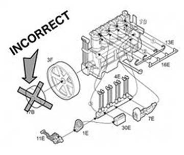

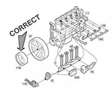

Slight Error Found in Roden - Holt Tractor Instruction Sheet - Step 14:
Cone clutch plate (Part 17B) needs be reversed 180 degrees to face the other way in order to be correct.

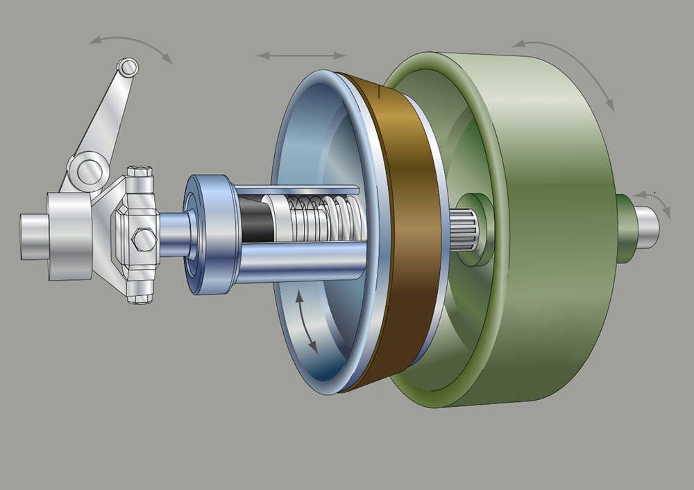

Main Clutch (Cone design) for Holt 75 Tractor Shown Below:
Photo and Color Drawing; authors unknown - used here for discussion purposes ONLY.

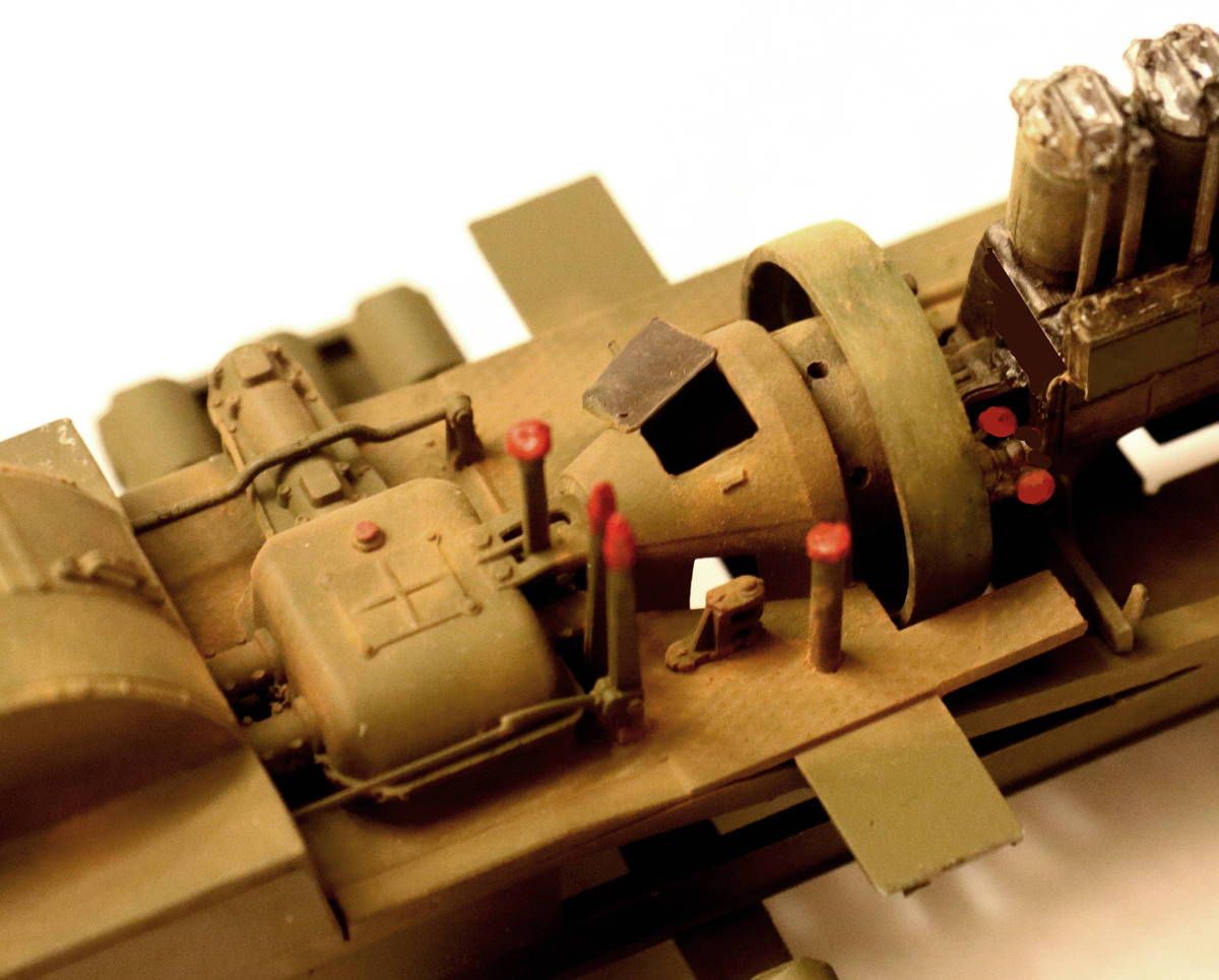

I want to model the cone clutch to better fill in that particular portion of the Holt driveline. I have already opened up the inspection panel on top of that tapered sheet metal housing for a little more light and visibility in that area. I'm thinking perhaps a properly sized model railroad wheel would serve as the male portion of the clutch.

Thanks Michael for finding the "cone clutch" drawings. So I guess I was right after all when I flipped part 17B around in my build (which makes sense from looking at the parts). But I had looked at another photo which seemed to show the hollow side facing the flywheel. I'm wondering if part 17B should just be a hollow "ring" with a wheel inside to represent the clutch as Michael shows in the diagram.
VR, Russ
Posted: Sunday, June 09, 2019 - 05:04 AM UTC
I too went with reversing the clutch plate on the kit build even before I found the research - just simply because the parts fit better that way and did not when facing the other way.
I agree with you Russ it might also be correct to have an open drum behind the flywheel instead of the cone clutch.

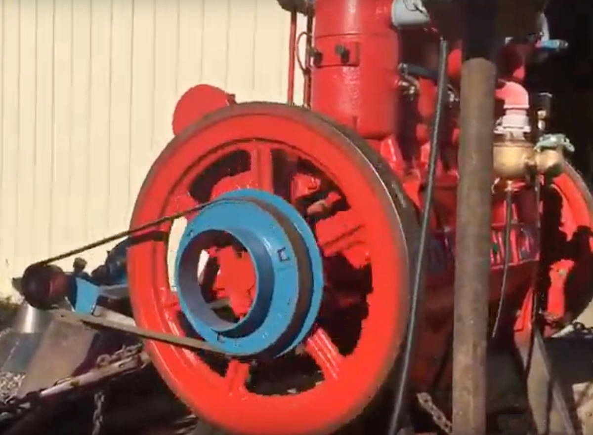

Personally I think the open drum wheel in the photo below is NOT part of any kind of clutch. I think the engine shown here was used as a stationary industrial engine rather than a vehicle mount. I suspect it was used to drive an overhead belt arrangement rather than a fixed shaft.
p.s. Note that in the O scale model photo I posted earlier it shows the cone clutch without the sheet metal protective cover.
Photo credit unknown - used here for discussion purposes ONLY

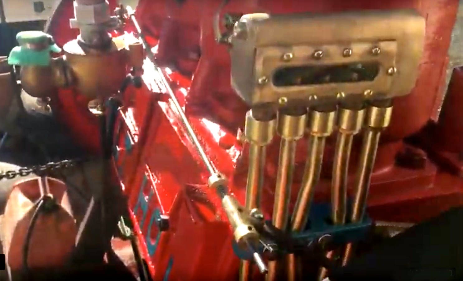

Interesting video of running Holt 4-cyl. engine.
Note open flywheel and brass/bronze oil lubricator.
https://www.thvideos.net/video/CCSsOZdJiCs/1917-holt-engine.html
In this case the belt driven accessory is a circulation water pump to cool the engine.

I opened up the clutch inspection plate just to add a little bit more detail. Still have not begun work on the cone clutch itself - looking now for a properly sized tapered cone for that construction.
(I am thinking a wheel off a properly sized model railroad freight car might do nicely for the clutch cone - now I only have to decide which scale.)

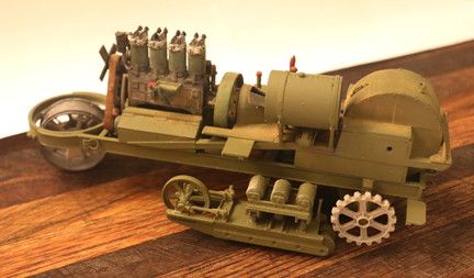

Posted: Saturday, July 06, 2019 - 11:00 AM UTC

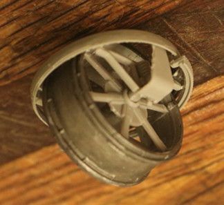

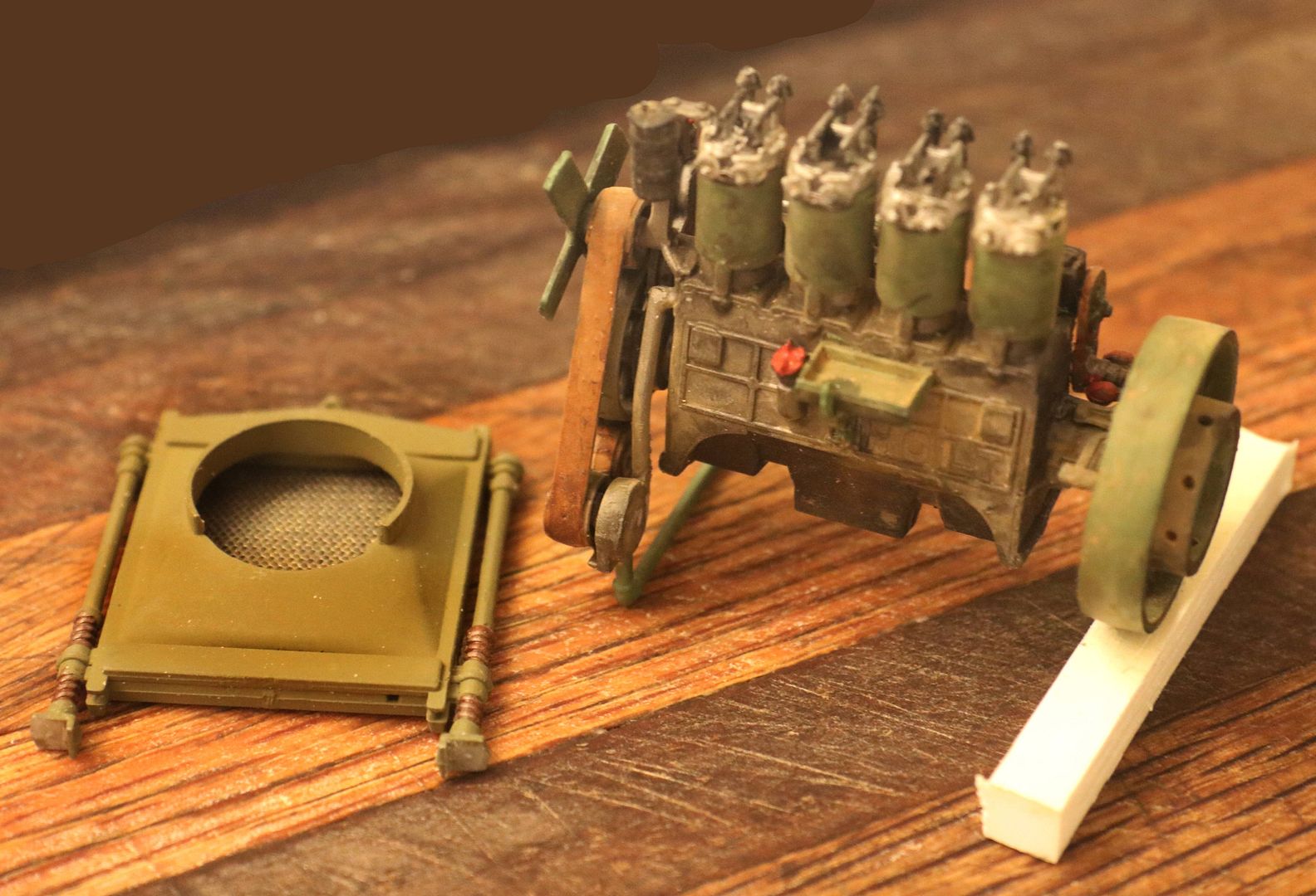

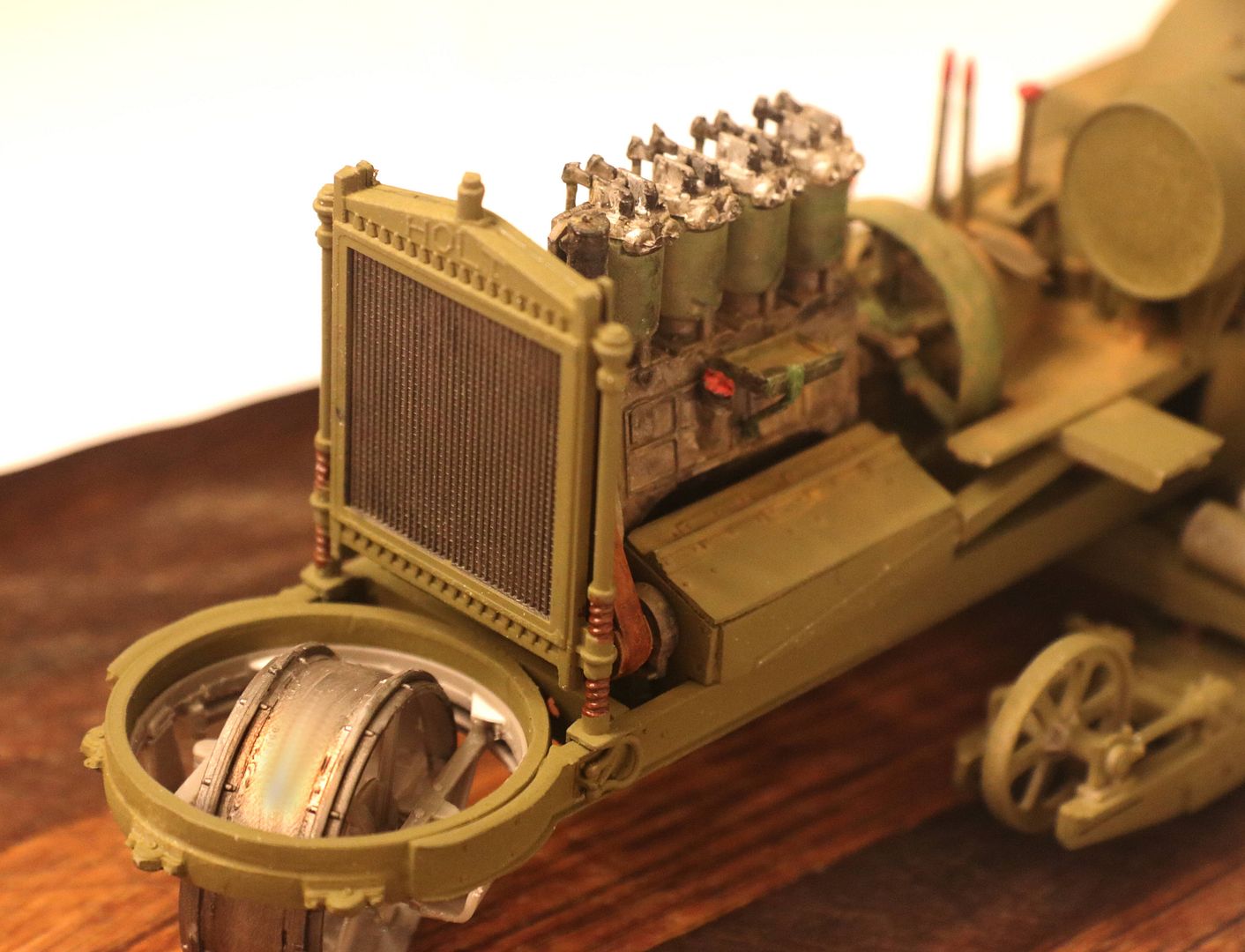

A few progress shots on my Holt:
I thought I would add some reinforcement triangles to that very delicate front wheel assembly.
If carefully assembled the front wheel can be made to roll as well as to steer.
Posted: Saturday, July 06, 2019 - 12:40 PM UTC

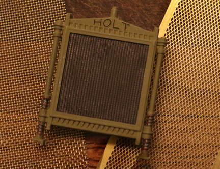

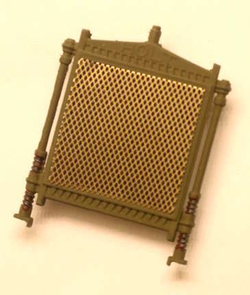

Whats the general opinion on my using a diamond pattern screening over the radiator front? It will look really good if painted green in contrast to the black radiator! I happen to have the diamond screening and it would certainly show up more but I admit from the outset - it is not correct.
Posted: Tuesday, July 23, 2019 - 02:31 PM UTC
Slow progress on the Holt these days.

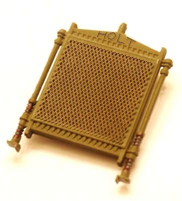

Metal screening cut and painted.
Please Note: - To my fellow modelers - Please know that while the above screen treatment may be more visible and/or look better on the model, This treatment IS INCORRECT as to the prototype! The actual vehicle employed a straight horizontal, square web radiator screen. I post this notice as a warning to not always follow one modeler just because he or she chooses to jump off a cliff.

Posted: Tuesday, July 23, 2019 - 03:12 PM UTC
Michael, I think the diamond pattern looks great and very distinctive, and a great alternative. On another note, a driver for the Holt may be on the way soon. The tractor seat is actually sprung, and the forecasted driver will come with a proper seat. More later.
