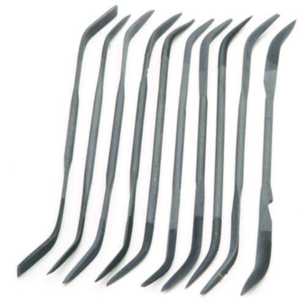

I managed to squeeze in a few minutes of quality time, i.e. modelling , and realised that I had forgotten to mention riffler files. These are double ended and bent at each end to allow getting into tight spots. There are multiple types of these, some with a file length of maybe half an inch and others that are larger. Different coarseness but 'fine' is the one we need, coarse is for wood crafting. There are also diamond files of this type but they are mostly useless for plastic. Photo-etch is another matter though...
Google for 'riffler file'. I would presume that Micro-Mark have a few sets.
The fret saw I mentioned before, there is something similar called a jeweler saw.
https://www.pjtool.com/hand-and-hobby-tools/hand-saws/3-adjustable-jeweler-s-saw.html
This can also hold a strip of sandpaper which can be very handy. There is also this tool so maybe they sell the file strips separately
https://www.micromark.com/19-piece-Flex-I-File-Set
In the cosmetics shop you can get sandpaper/file sticks used for polishing nails, very useful for fine polishing of styrene to get a smooth surface.
Don't use putty. Learn to fill holes and gaps with small pieces or strips of styrene. This will result in a filling of the same relative "hardness" as the surrounding plastic which makes the sanding/shaping a lot easier. If the filling is harder than the styrene it will resist sanding better and the result will be "valleys" gouged into the plastic on both sides. If there is fine sand in the putty it will ruin your files (been there, done that, Verlinden 2-comp putty ).
/ Robin

What Robin said-- but again, Micro-mark has all this stuff under one roof-worth a check-out, its where I buy my specialized tools. Paasche usually has ABs with interchangeable needles/apertures, but I don't know about that model you're looking at-- you might do some more research on the Paasche website. Robin's note Badger Compressor prices look good-- those are real bargains! I was at Home Depot recently, and they had two smaller compressors there with drain-cocks in the bottom of the tank-- mine just has a nut for an Allen wrench--not ideal, but the drain cocks looked great--along with a label that said "drain after every use" reminder in big red letters on the label--what I need at my age! I'm not happy with the HD or Lowe's regulators though, but you can find a good cheap regulator with a Moisture trap at Micro-Mark, which I think is interchangeable. The HD and Lowe's compressors are a lot more money than the Badgers Robin is referring too, but they can be used with impact wrenches and air tools too.
