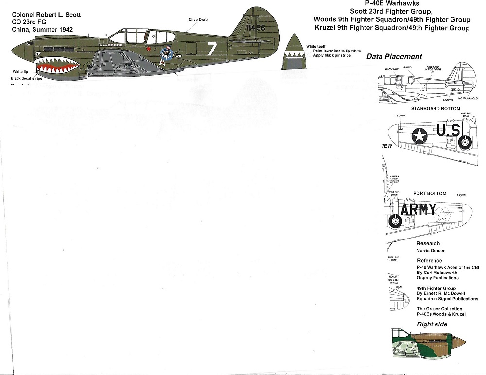

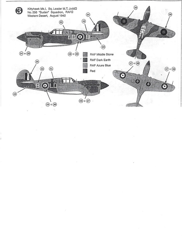

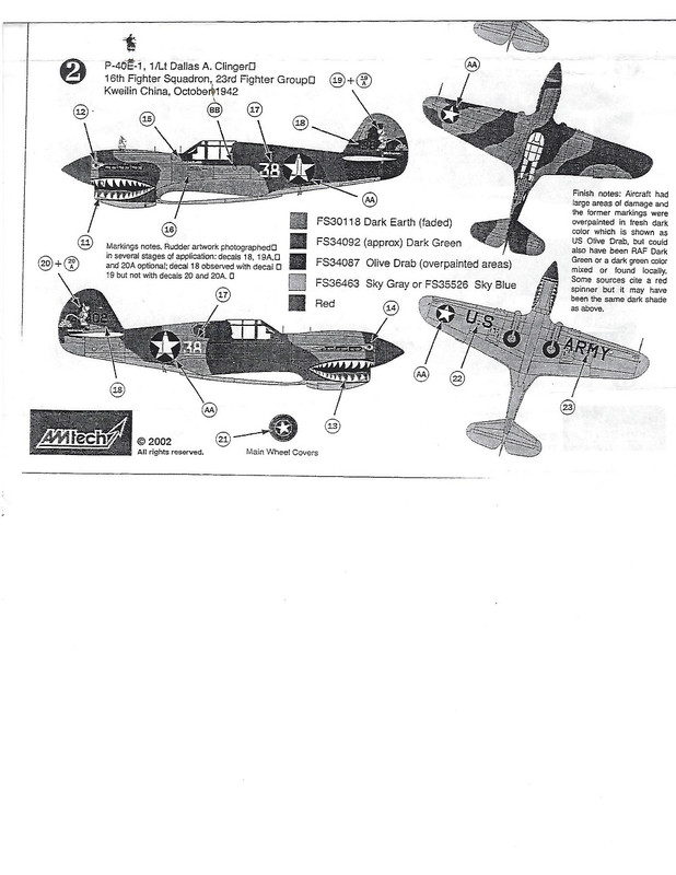

Finally settled on the color schemes for the P-40's
1. Robert L. Scotts no. 7
2. No. 450 Squadron, RAAF, Western Desert, 1942
3. 1/Lt. Dallas A. Clinger, 15th. FS, 23rd. FG, Kweilin, China, 1942

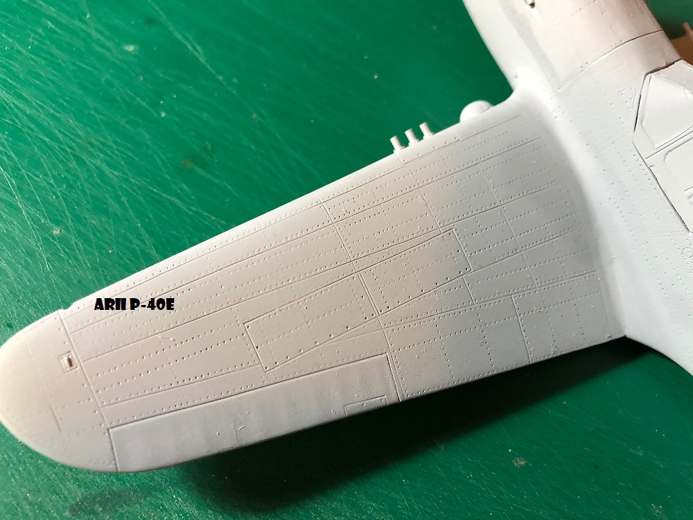

Christopher, here are a couple of photos of the ARII P-40E. The panel lines are engraved and the pips are not too bad and also engraved making it not a bad kit to work with. For the money they build up into a nice airplane.

Bob, I seriously doubt that there is any commonality between the Arii kit and the AMT versions, also boxed by Italeri. To get the smooth surfaces, someone would have had to remove the hundreds of little "pips" that form the rivets on the Arii parts and then polished the surface without doing serious harm to the raised lines that make the recessed panel lines.
Also, the rudders and wing tips are shaped differently, the lower fuselage trunk is completely different (and you'll find a major gap at the rear of the Arii wing/trunk join line, the Arii wings have significant sweep-back while the AMT have very little, the upper engine cowl is handled differently (and the Arii scoop is actually more like the P-40D), the AMT rudder slopes too much toward the top and the Arii is too rounded, and so on and so on. They're just two different kits of the same airplane.
Over the years many (all?) of the Arii molds have suffered negligent damage, especially KO pins punching through to dent the opposing mold surface, This is apparent on the lower wing surface of this kit in the flap area, and more obvious on the Ki-43 and Ki-44.
That said, I finished one of the the Arii P-40Es just before the Pandemic hit as GA•Y. I did add the QB landing gear doors intended for the Hasegawa kit, a Yahu instrument panel, and a Vector prop and spinner. I love the Arii kits for all their faults and have most of them - all of the Japanese fighters. They are lots of fun to build as long as you're not a stickler for accuracy.
