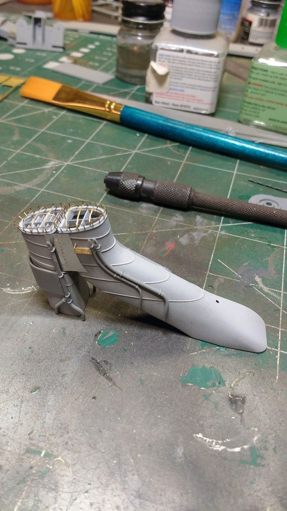

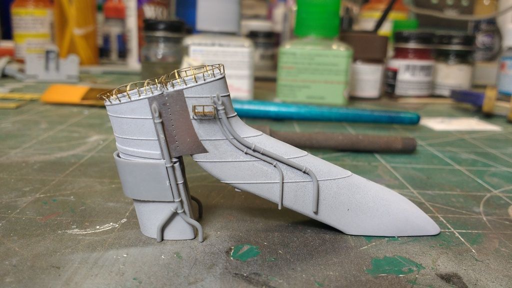

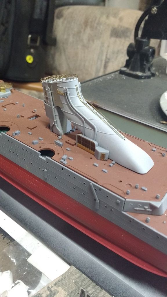

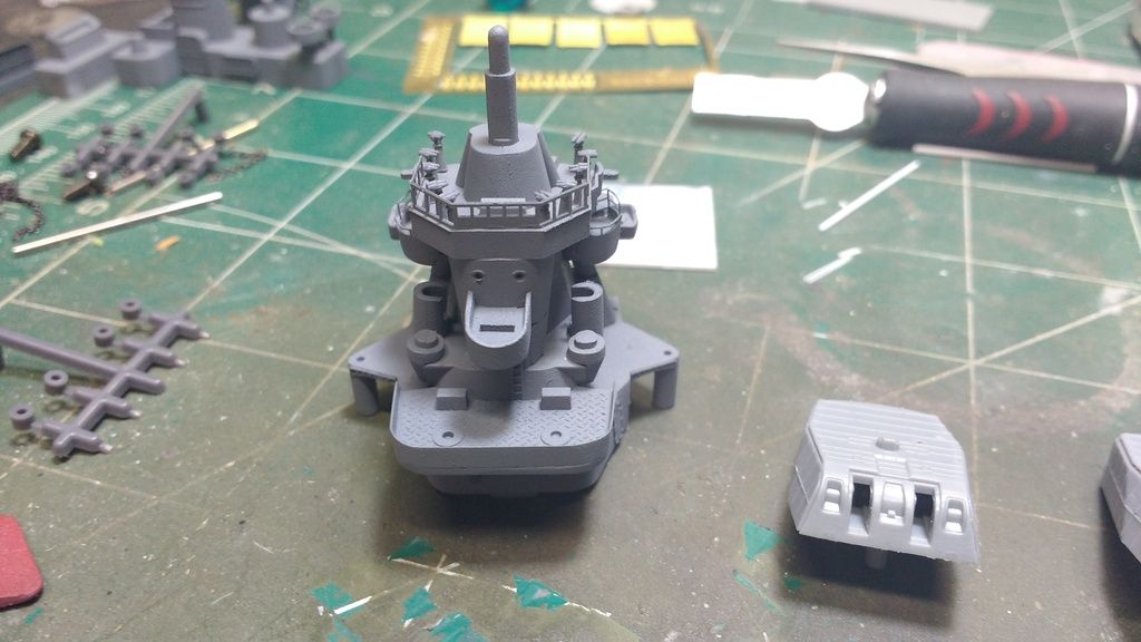

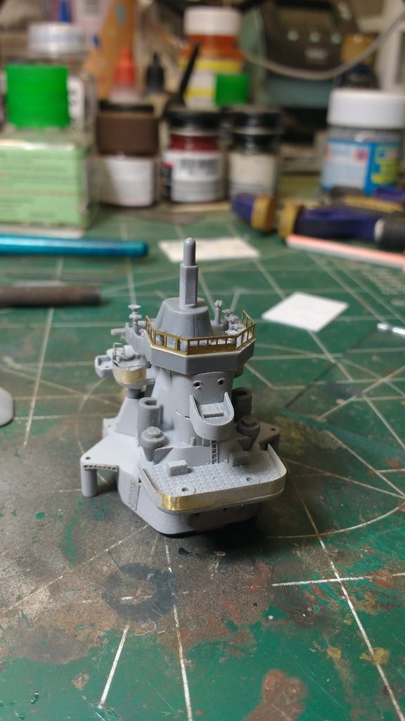

Update here, found some time to sit down and get a little done. Mostly working on finishing the funnel. Also I'll have some instruction issues for those that choose to use eduards photo etch set on this beautiful lady. So on with the pictures.

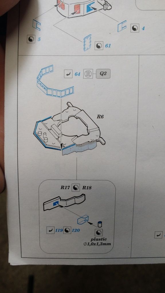

Ok here's the instruction info. So part R4 (circled) is the part in question. This isn't Tamiya's fault. Eduard will lead you wrong.
Now here's eduards instructions for the bridge.
Now Eduard will have you install the photo etch window without part R4 from the kit parts. Eduard is wrong and you do need part R4. You have to trim off the locating tab for the clear window part supplied in the kit. If you don't use part R4 then the roof of the bridge won't be able to sit flush with the top of the bridge windows eduard supplies. The bridge windows will be too low. Hope this helps future builders of this kit. Eduard makes a good set and the small parts are amazingly made very well. This set isn't for beginners. Lots of small fiddly parts to play with. Thanks for stopping in and as always comments and criticism (or mistakes) are greatly appreciated. Only way to learn is to make mistakes. Thanks

Great stuff Norman,
Good tip with the bridge front, she is coming on superbly

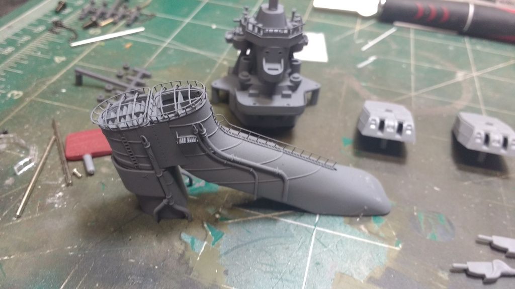

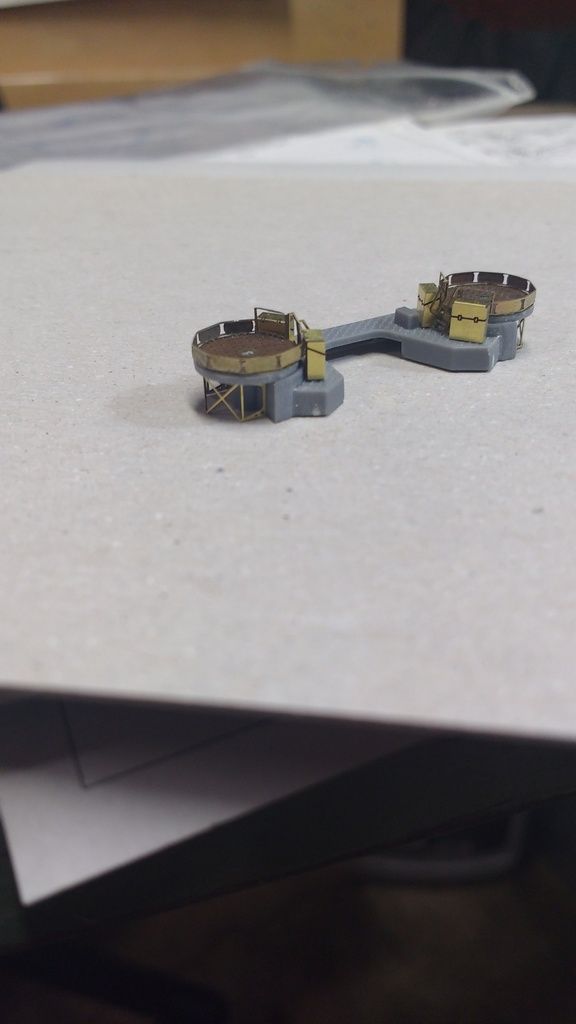

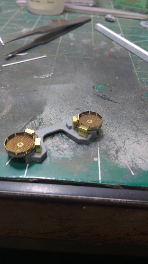

Thanks gent's. So here's another update, finished off the ladders on the funnel and built the aft AA platform. Also built the vents on either side of the funnel. Eduard makes a good set here and my previous statement of it being a bit thick has been shattered as the smaller parts are really fine. Care must be taken not to crush or distort. This is a good aftermarket set for a lower cost than others like pontos or flyhawk. Less detailed than other aftermarket sets but you can make a fine model with it. On to the pictures.
And here is one of everything built so far dry fit together.

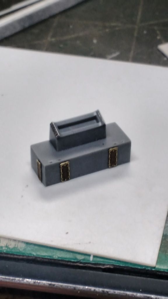

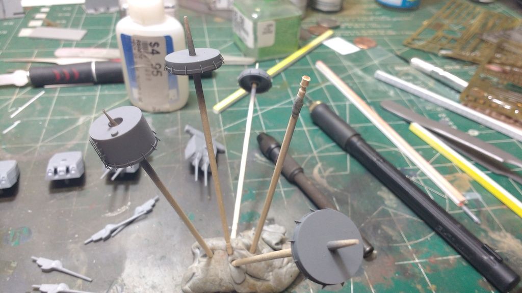

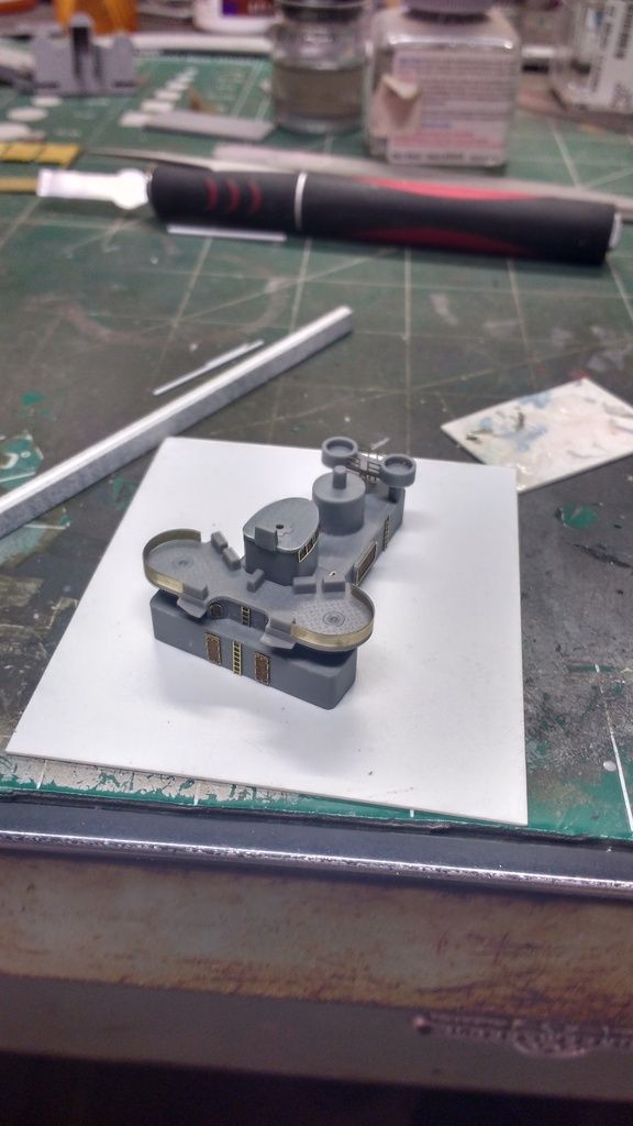

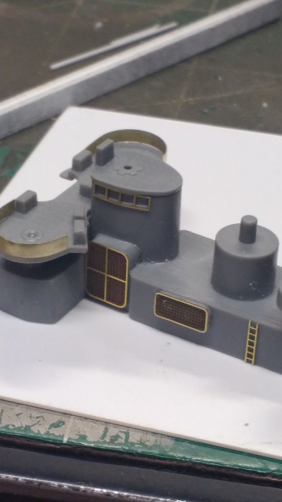

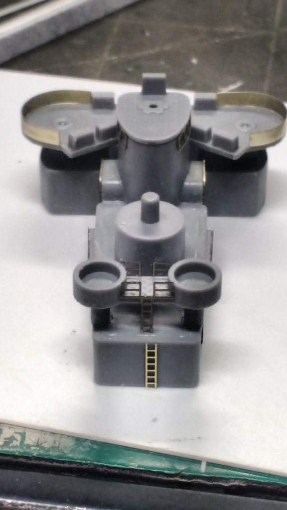

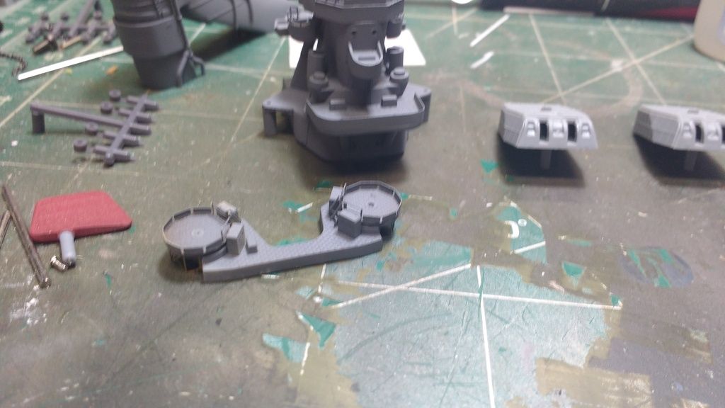

Another update here, this ship has become a main build here, having alot of fun with this one. It just falls together and the way Tamiya engineered it, this ship falls together. I worked on the aft superstructure. The etch here it's very fiddly and care must be taken here or you'll spend alot of time cleaning off super glue or looking for parts on the floor. Ask me how I know. I wish eduard included life preservers and better ladders than flat ones. Heads up, some of eduards ladders are just basic flat ones to replace molded on. They are better but the flat ladders don't give a good 3d effect. Maybe under paint and weathering you might be able to get them to stick out. Enough rambling, on to the pictures.

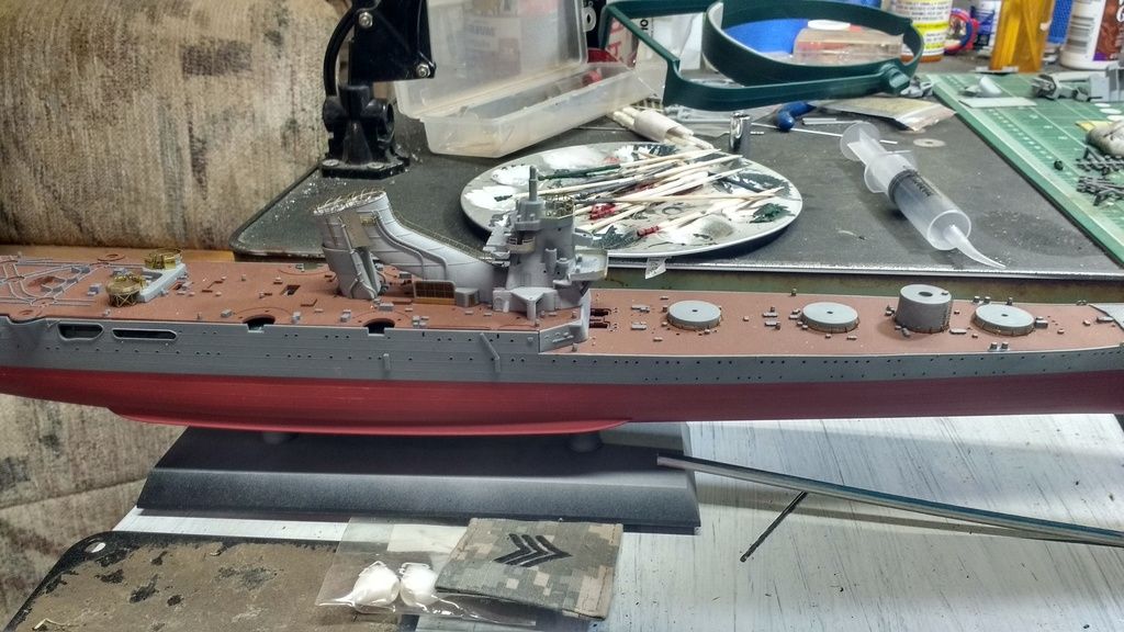

And here she is all mocked up and dry fit together.
Next time at the bench I'll be working on getting the deck glued down above the torpedo deck so I can start painting the assemblies and installing them. Thanks for all the follows on this and thanks for the nice comments. I'm working towards becoming a better ship builder. Thanks for stopping by.

Very impressive work. She is coming along at a quick pace. I am not a fan of the flat ladders myself, what I do to provide stand off is bend the two ends at a 90 degree angle and then mount them to the bulkhead. It provides some standoff and, in my opinion, provides a better representation.

You know Dave, I never thought of that, next time that's what I'll do. Great tip. It's the reason I post here the community is awesome. Thanks

Hi Norman,
Great progress, she really is coming on apace,
The supports for the after gun tubs look excellent

Thanks Si, those after gun tubs tested my patience. Worth the effort though in the end. I need to pay the brass strips but I'm afraid the hasegawa set I have doesn't have enough. I'd hate to have to mix match or rip up the ones I would lay down.

Those splinter shields look great!
Totally agree with Dave about the ladders. A small 90 degree bend at each end and then just attaching at those points will give a much more 3 dimensional effect. If you're feeling particularly brave, you could use some debonder and take the ladders you've glued down so far off, bend then ends, and then re-attach them

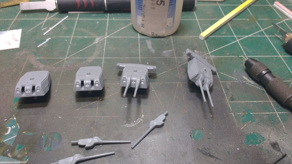

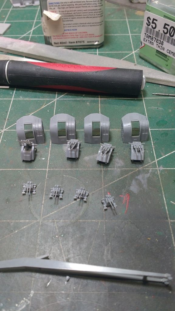

Small update. I Started working on the armament. Waiting to have the funding for flyhawk's brass strips. Building all the assemblies while waiting. I have also started some painting too. First coat of kure is laid down. On to the pictures.

Great looking ship. The color is really bringing her to life. The Flyhawk brass strip is really good, a little touchy but good.
Armament is coming along well.
