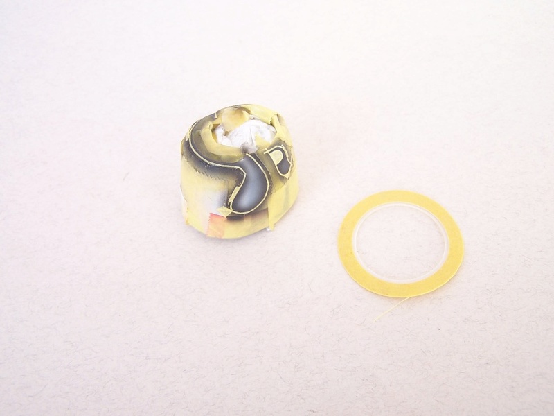

interesting method of making a paint mask. Did You stick the scanned decal onto the tape for cutting? I have to try this, too! The result looks really good!

Hi Oliver,
Yes, I stick the scanned decal onto the masking tape-in that way it's more stable for cutting.
For such shapes, this method I think, is very good.

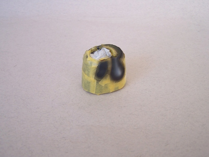

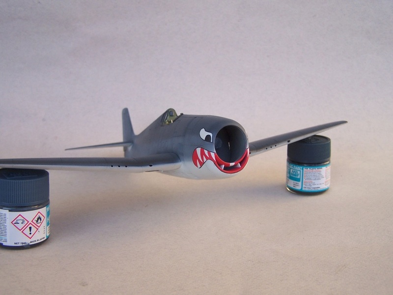

Well, I didn't like the first result, so some corrections I made
-First spraying the black outline":
-masking the line with Micron masking tape 0.5mm:
Now I like it better, although again there's overspray here and there, but this will be fixed (Sorry but never manage to catch the red color right on photos, but in reality is fine ) :

Same procedure as with the nose art . Some touch up will be needed at some places, but overall I like the result. Insignia blue is Gunze H-326 (FS15044), which is darker than the decal one, and looks better.

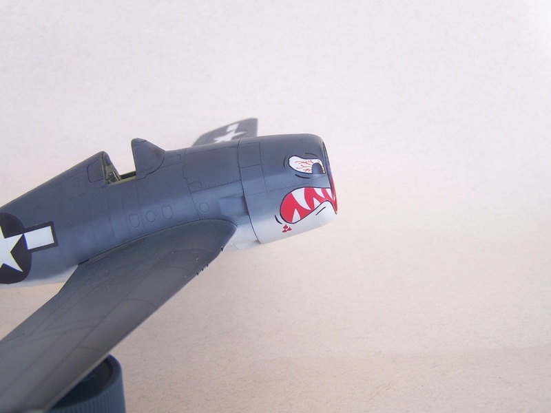

Sorry for the slow progress, but that nose art is complex to paint
Almost finishing, only have to decide how to represent the bloodlust in the eyes-maybe with fine brush, but I will think about it

I decided to make the bloodlines in the eyes by the following way:
-bought a thin red marker (non-permanent) and sharpened it a bit with sandpaper;
-then drawing the lines in the eyes one by one;
-as the one side is finished, immediately sealed with Aqua gloss, so to not destroy the painting;
-then same with the other side;
-you can wipe the drawing with wet cloth, if you not like it, BEFORE sealing, as many times as you wish.
