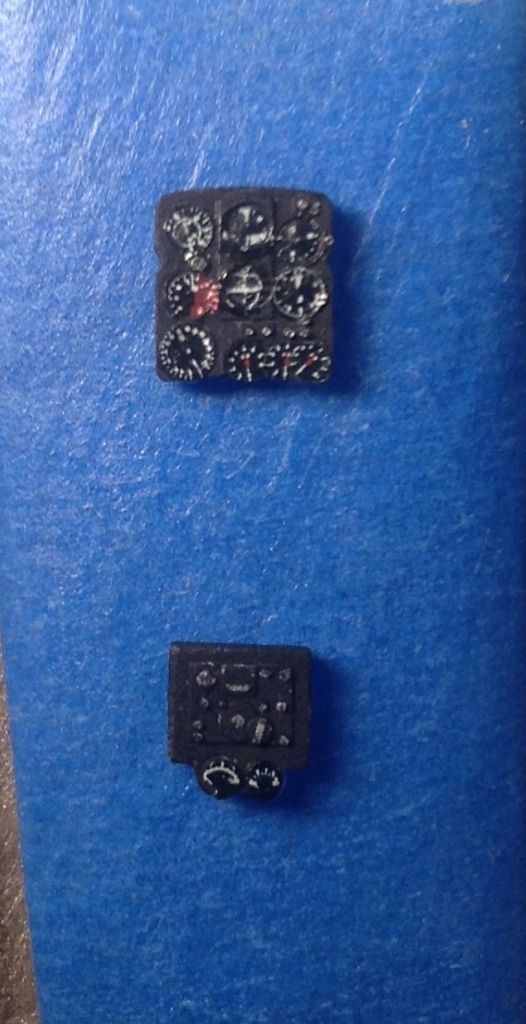

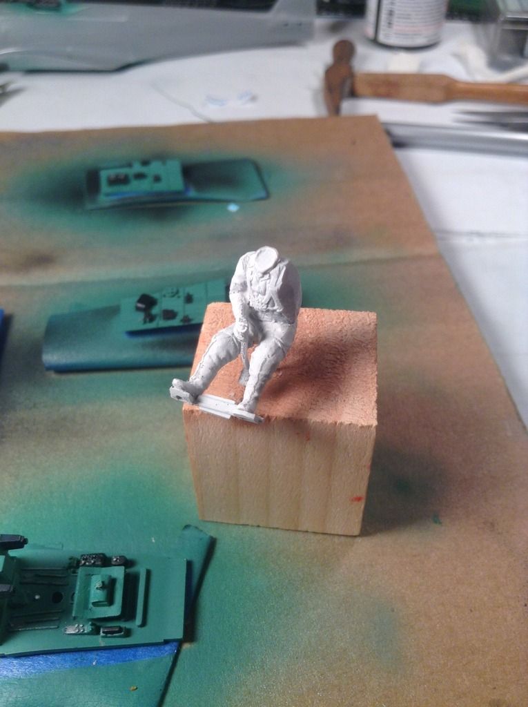

A brief update -

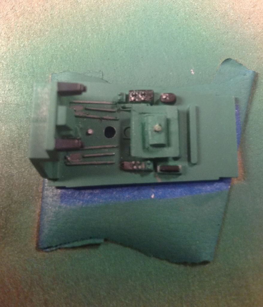

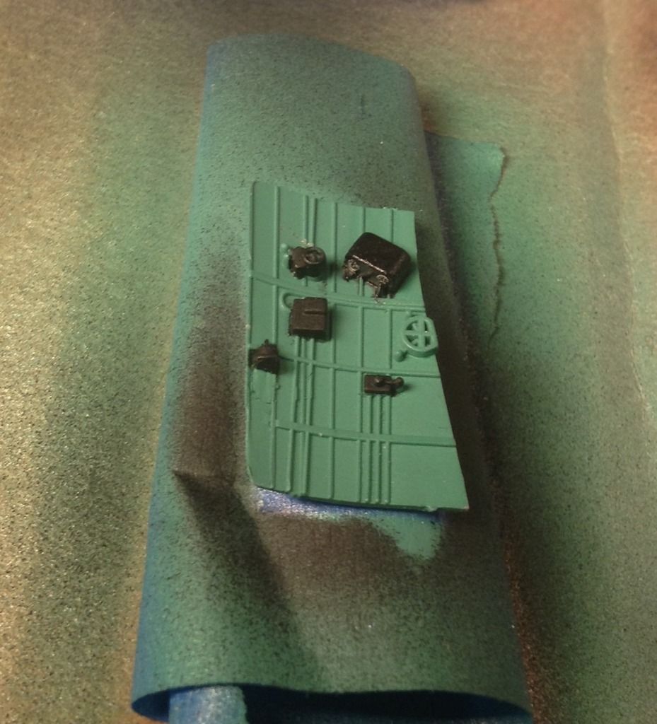

I've been chipping away at the cockpit - sidewalls , floors and front bulkhead shot with Vallejo Model Air Aluminium as was the fuselage and cowl interior. These were then oversprayed with Vallejo Aotake - color looks good but the clear gloss base looked out of scale to me so I dusted all with a very thin mix of Tamiya flat blue and flat deep green and flat yellow to match the Vallejo Aotake.

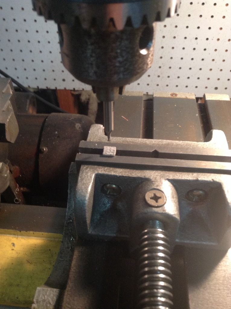

I spotfaced the raised instrument detail on the panel with a small end mill-
The IP, Radio and various boxes on the sidewalls and floor were done in Tamiya flat black and gauges and panels were detailed with Airscale Japanese Instrument decals -
Still some details to pick out then light dusting overspray to tone things down a bit.
The pilot figure was shot in Tamiya Flat white as a base and this revealed it needed more work on joints, mold seams etc. so it will need another go around-
I've been playing around with making the oil cooler but nothing to my satisfaction yet - more to follow.
Thanks for looking- all input welcome - Richard

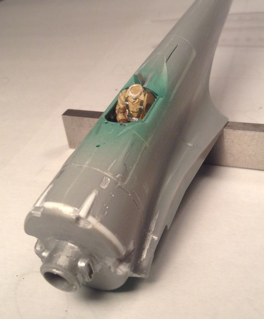

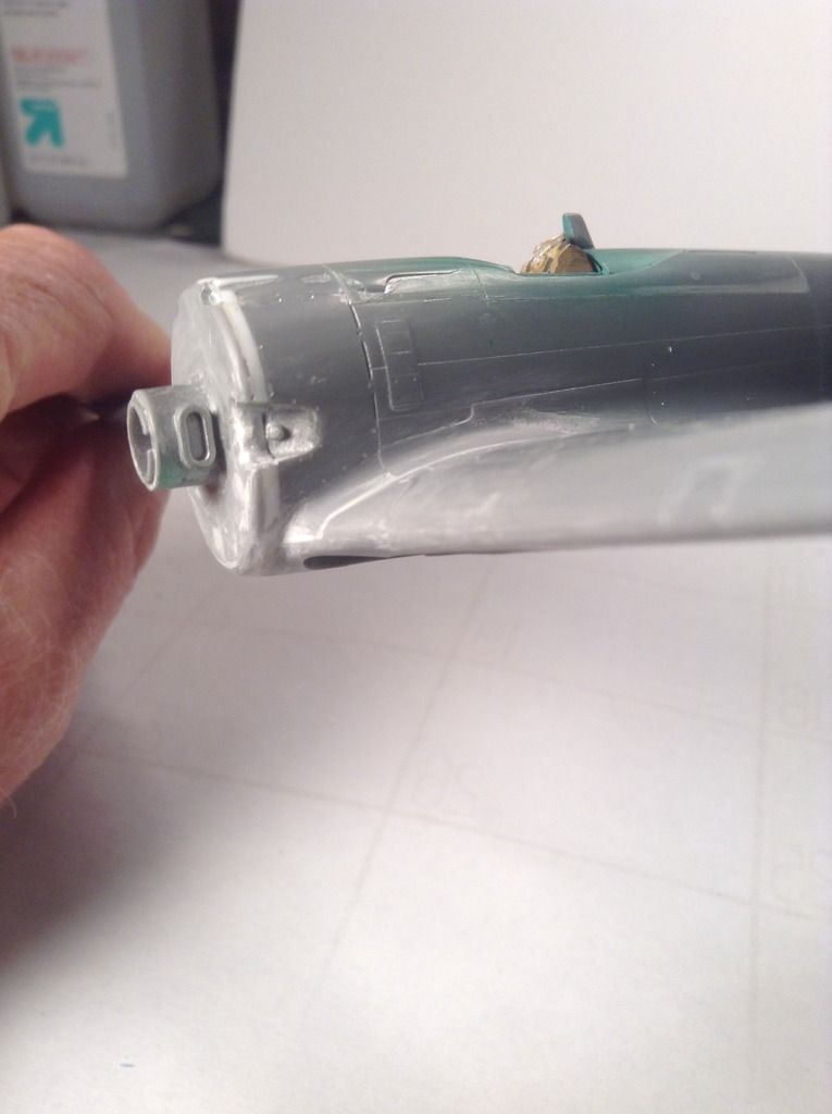

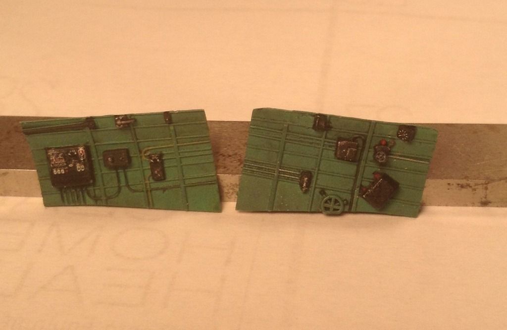

Posted: Wednesday, January 04, 2017 - 04:44 AM UTC

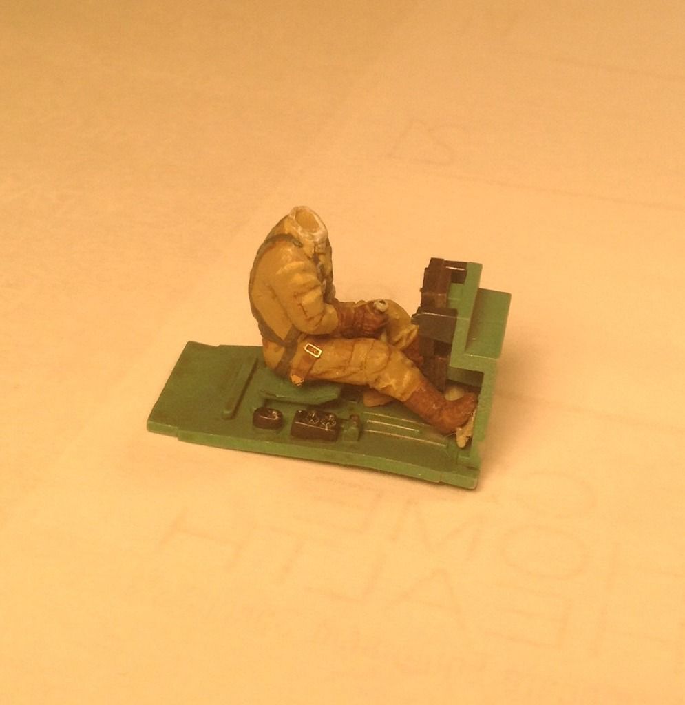

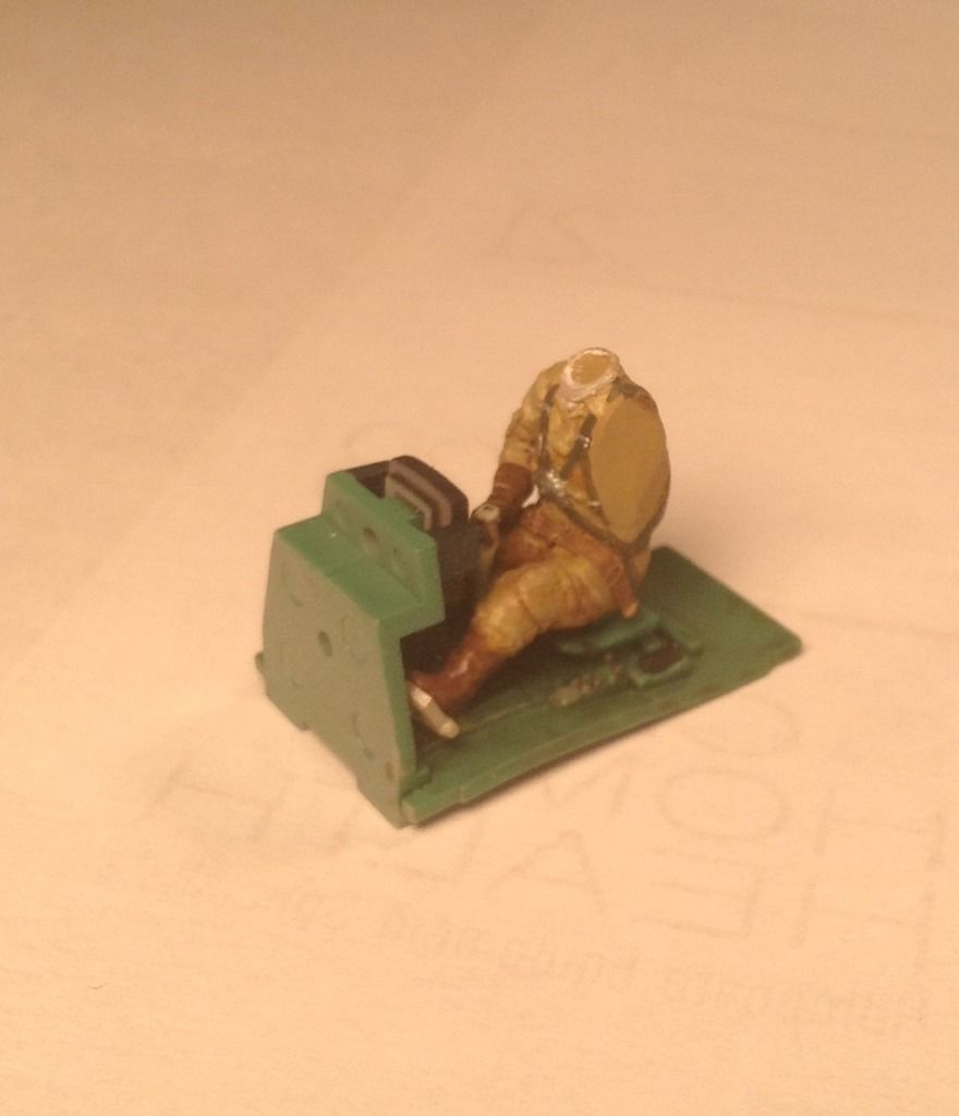

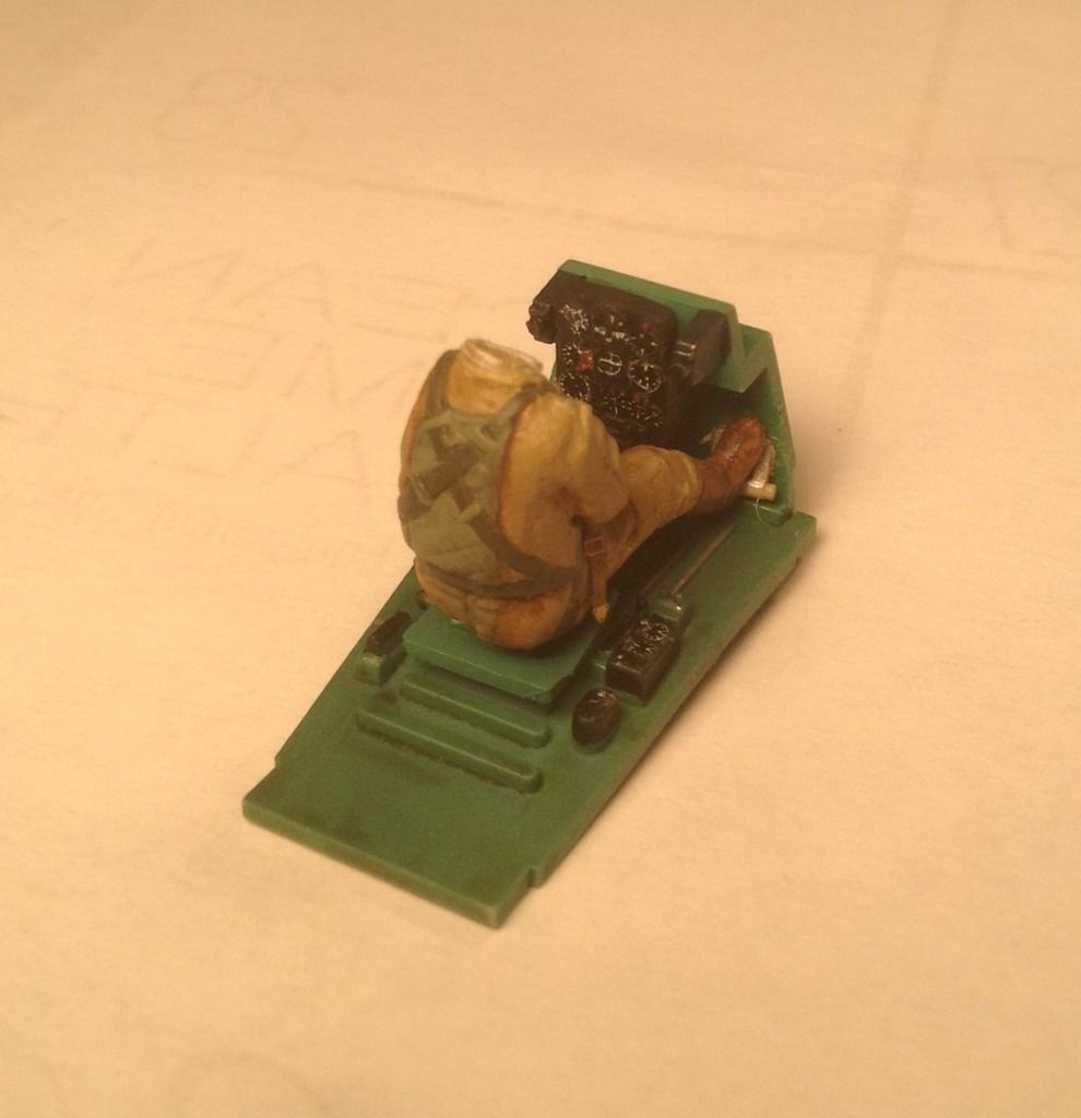

A little progress to report-
The cockpit and partial pilot have been completed.
Here are the side walls after detailing and dirtying up a little:
and some shots of the pilot seated:
and in the fuselage - not much can be seen as the cockpit is extremely confined- just as it was in the real thing :
This may be the pilot Flight Leader Ichabod Crane reported seeing on Oct. 31, 1943 while leading his group " The Sleepy Hollow Boys" somewhere in the Pacific . I believe this squadron operated off the carrier
U.S.S Washington Irving .
Working now on the engine and next up will be attaching the wing.
Thanks for looking and as always , all input welcome !
Richard

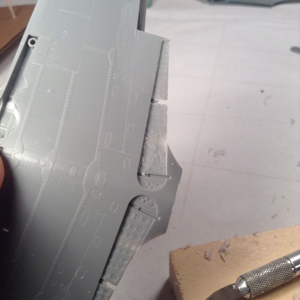

Posted: Friday, January 06, 2017 - 03:26 AM UTC

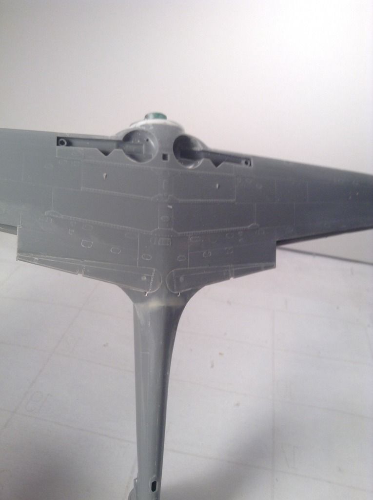

Hi to all -
A short post here - I've been doing some work on the butterfly flaps to have them in the retracted position. I was not happy with the fixed rudder, ailerons and elevators so I cut them away . Hasegawa very nicely saved me the trouble by molding the flaps separate so what did I do to show my gratitude ? Like a spoiled child I decided I wanted to have them retracted !
Both the upper surfaces of the flaps and the undersides of their bays in the wing needed careful scraping to get them to fit flush-
Getting ready to fit the wing next -
Thanks for looking - Richard

You did some job on thinning out those flaps, as they fit perfectly.

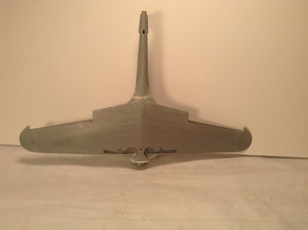

Posted: Tuesday, January 10, 2017 - 07:18 AM UTC

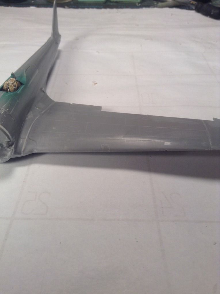

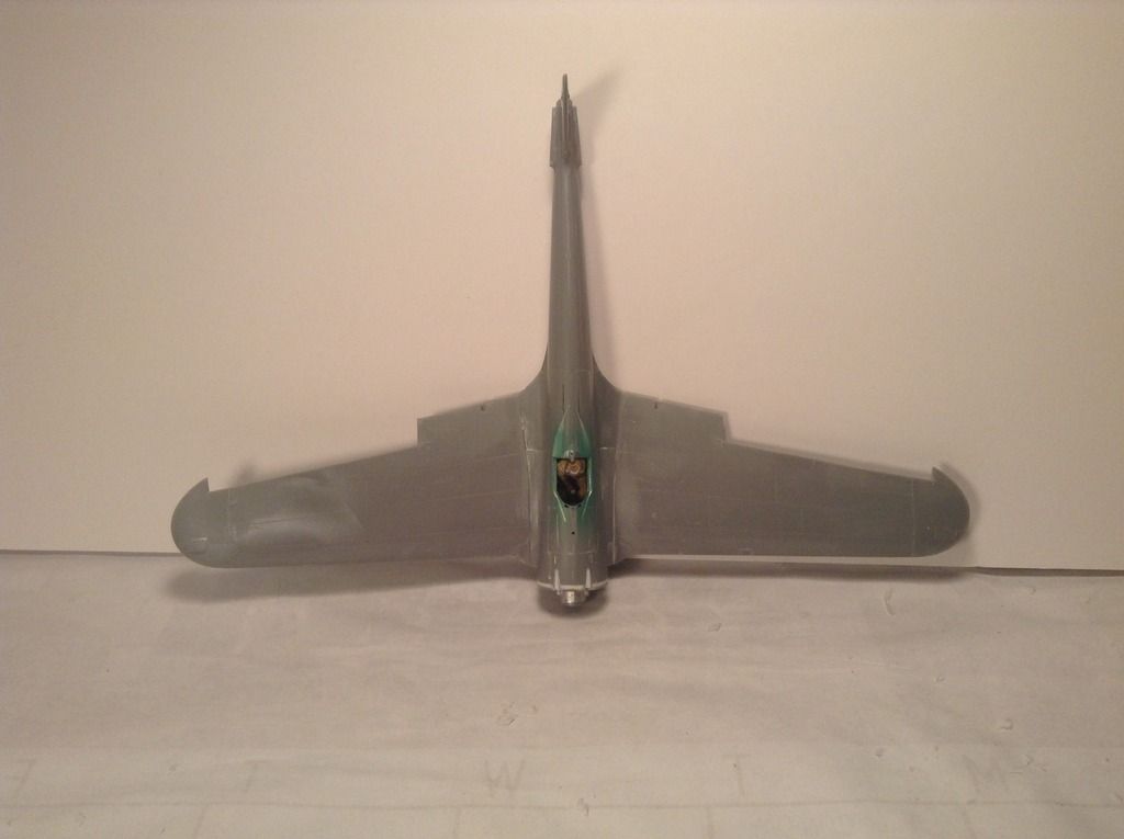

Update - It's now a thing with wings !
Lots of fussing, shimming, filling , scraping, rescribing - you get the idea - and still more to do-
Landing light filled in as this did not appear until type II Otsu
