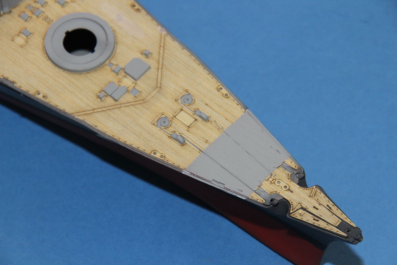

Thanks Todd,
I am pleased with the fit of the deck, was very good.
A bit nervous about overspraying the wood, especially over the anchor ways, may mist another flat coat over the tape when I have it down.

Looks great, Si!!
The wooden deck really makes a difference!! And the over-sprayed baltic camouflage looks good, as well! The hull already resemble a Bismarck without doubt!!

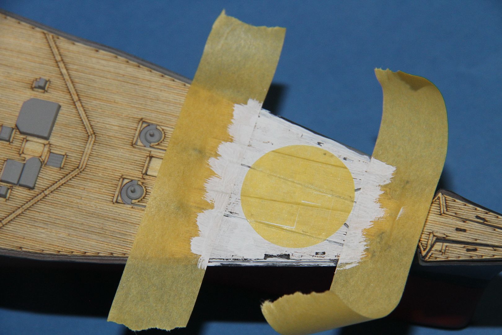

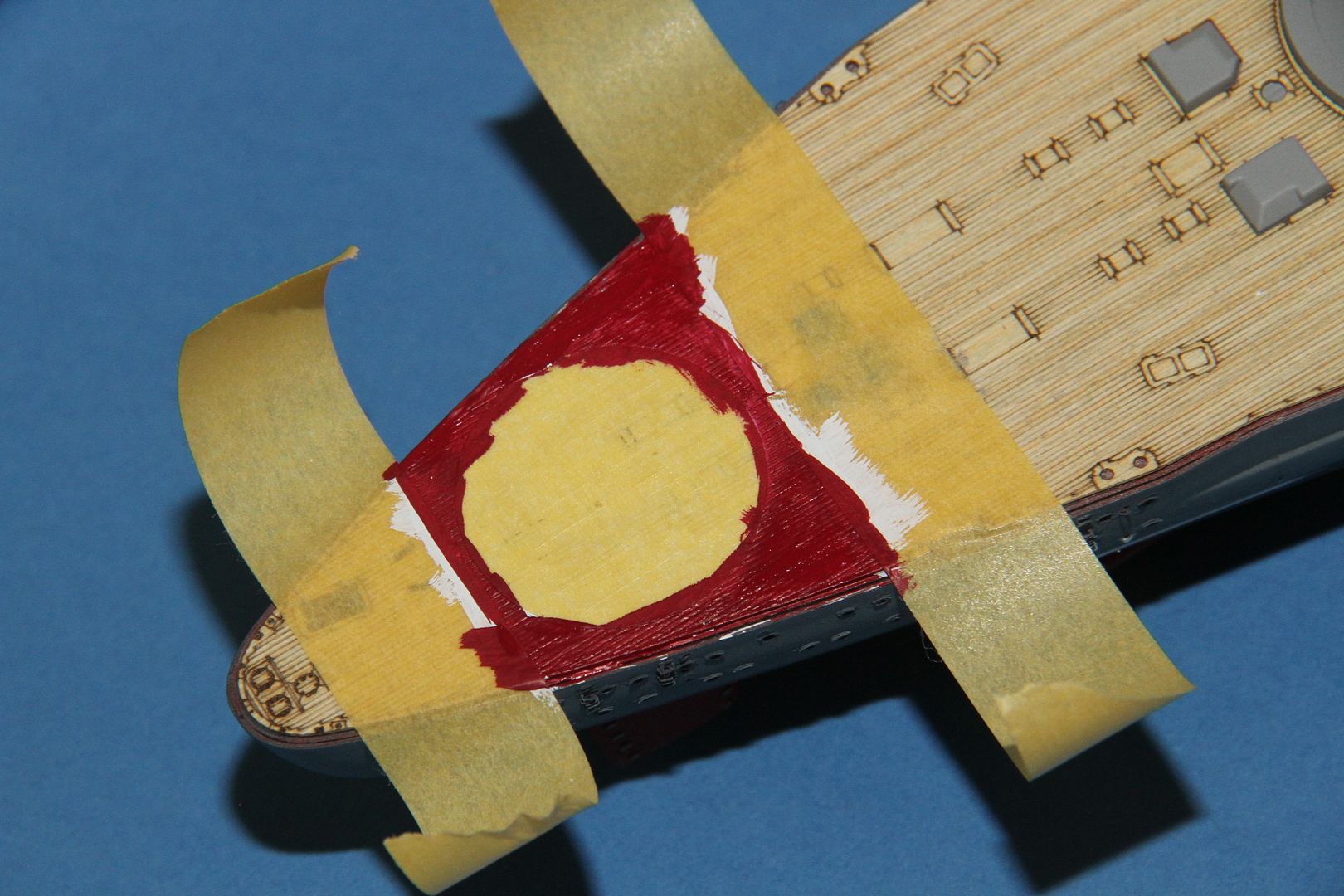

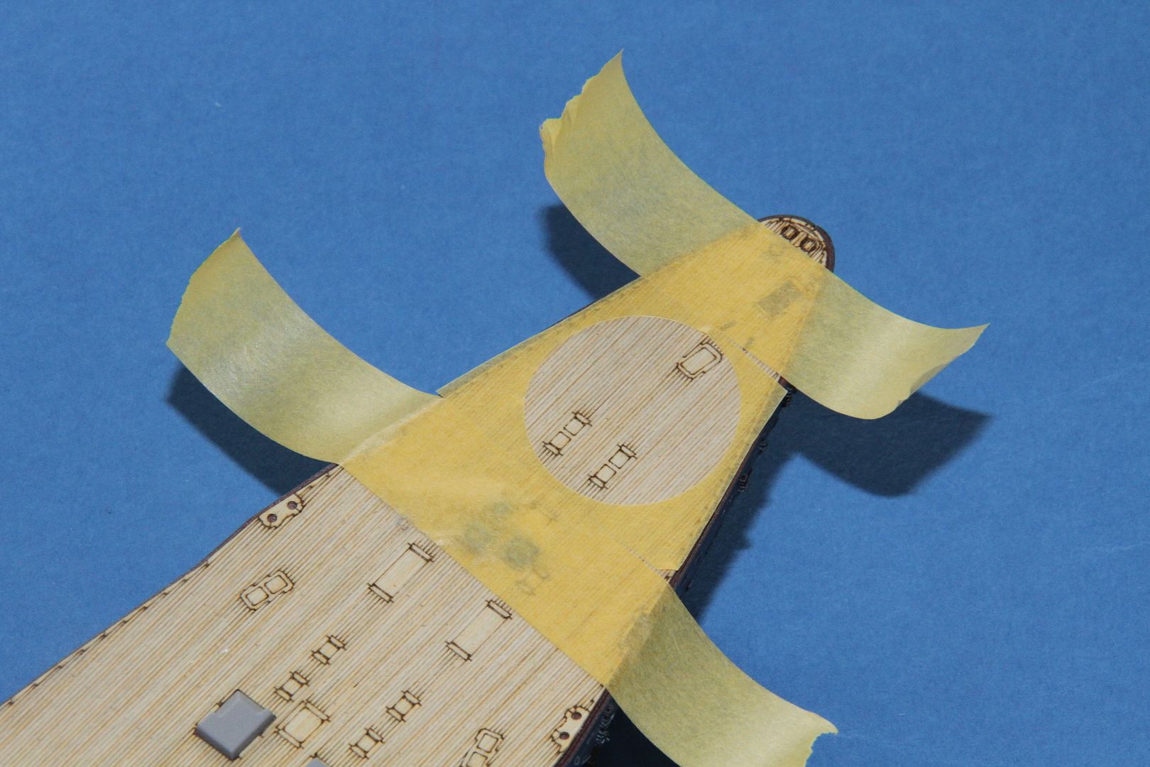

Todays job, the overpainted air recognition stripes.
Masking off, the kit masks were used to measure the strips.

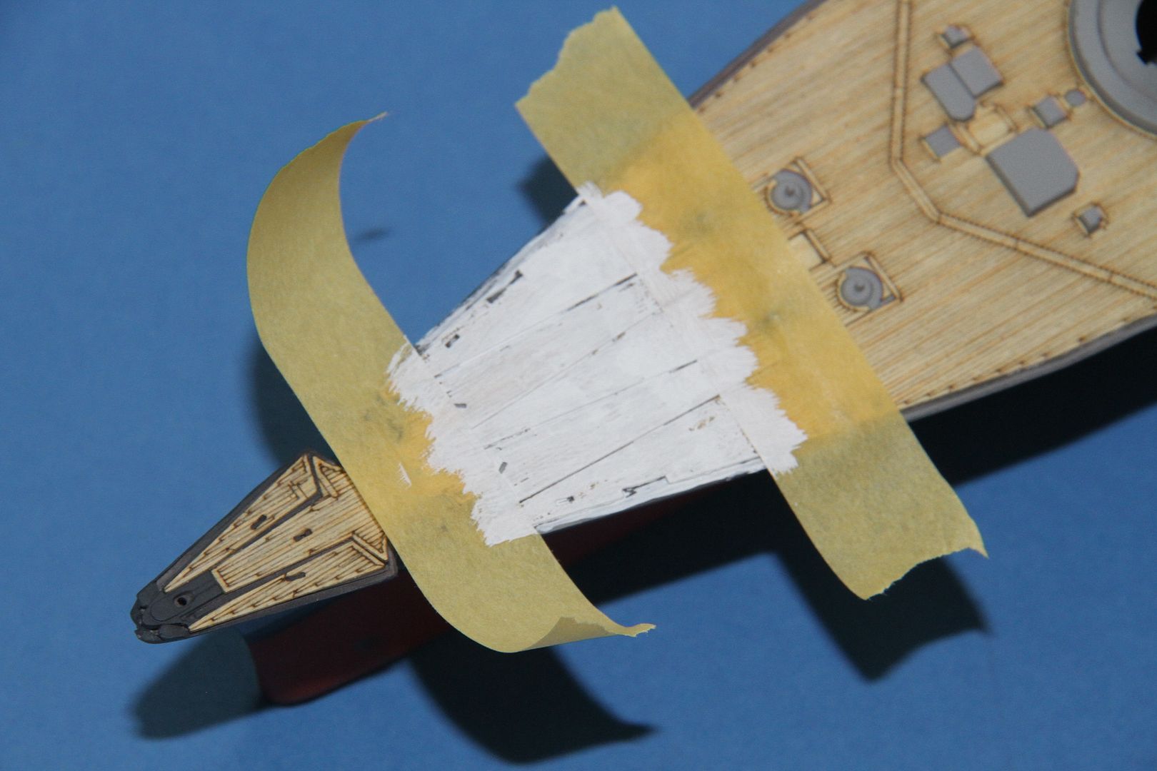

The whole trip painted white.

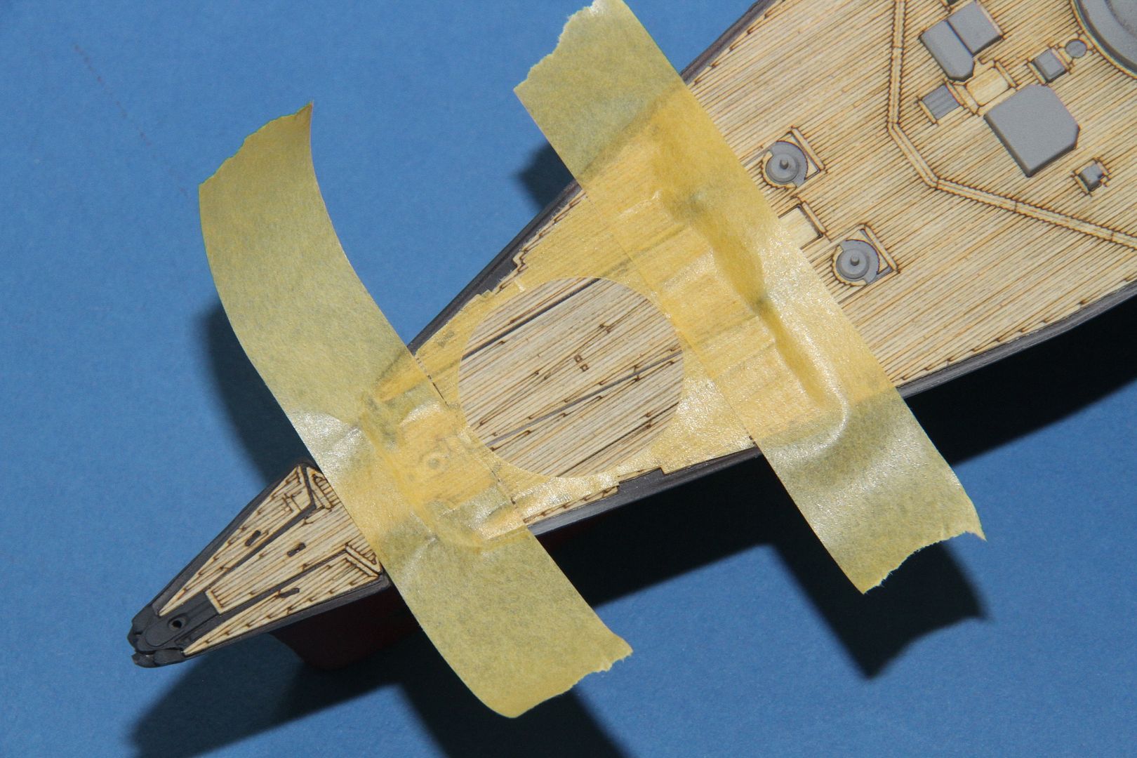

The white circle masked.

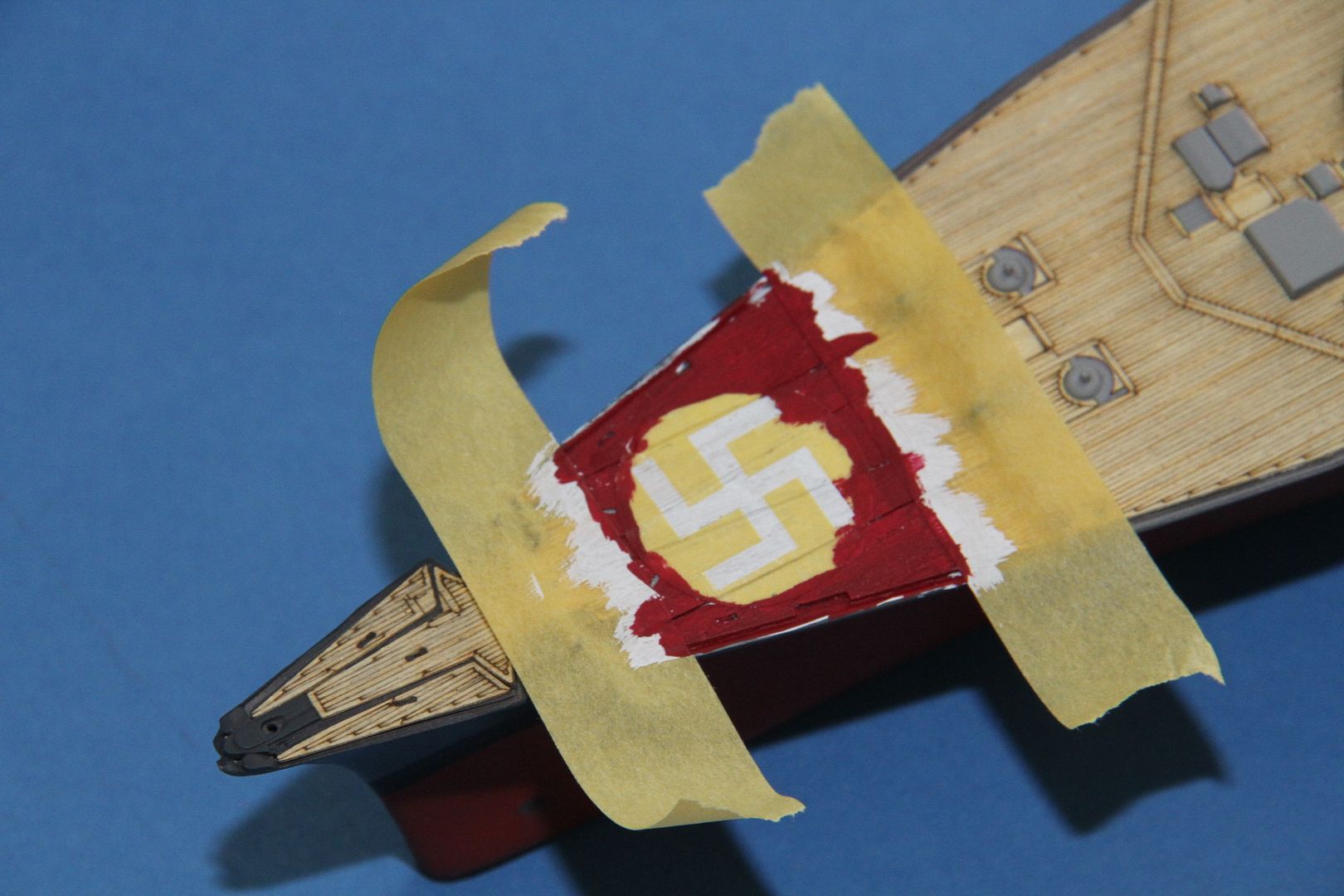

The red painted in.
mask for the swastika removed.

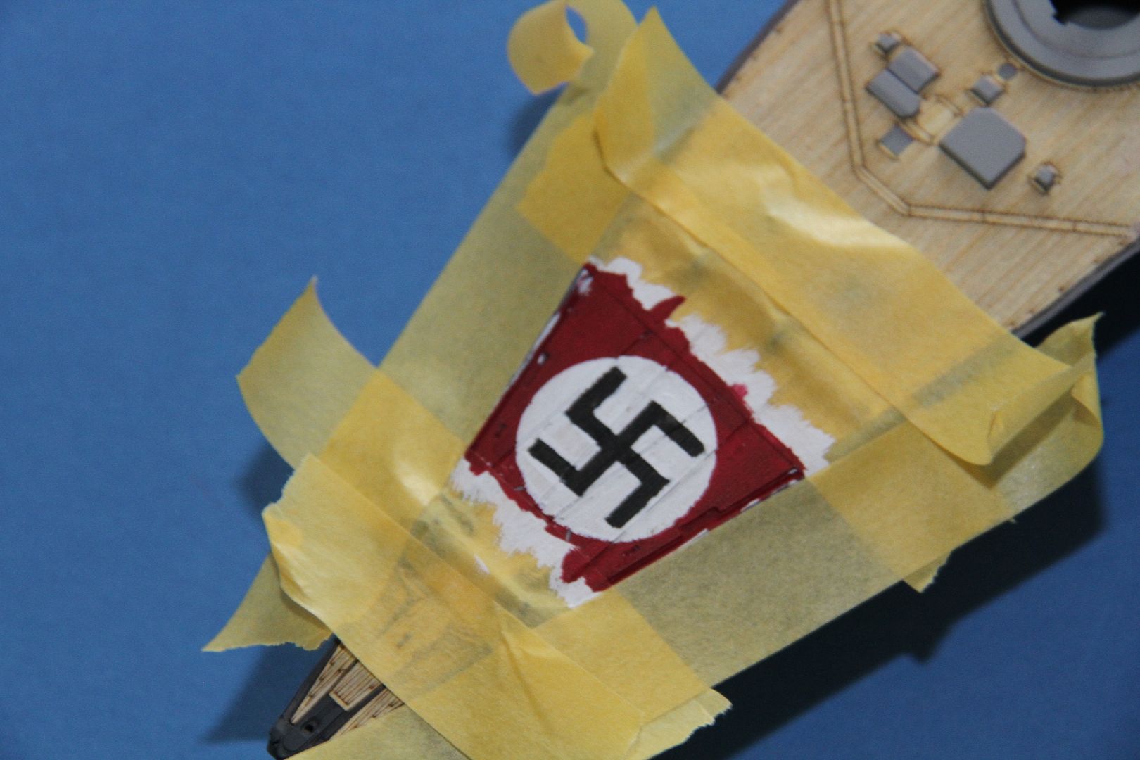

The swastika painted and the masks removed.
a bit of additional masking to protect from overspray.
Oversprayed and masks off, bit heavy on the bow.
just about right on the quarterdeck.
Si

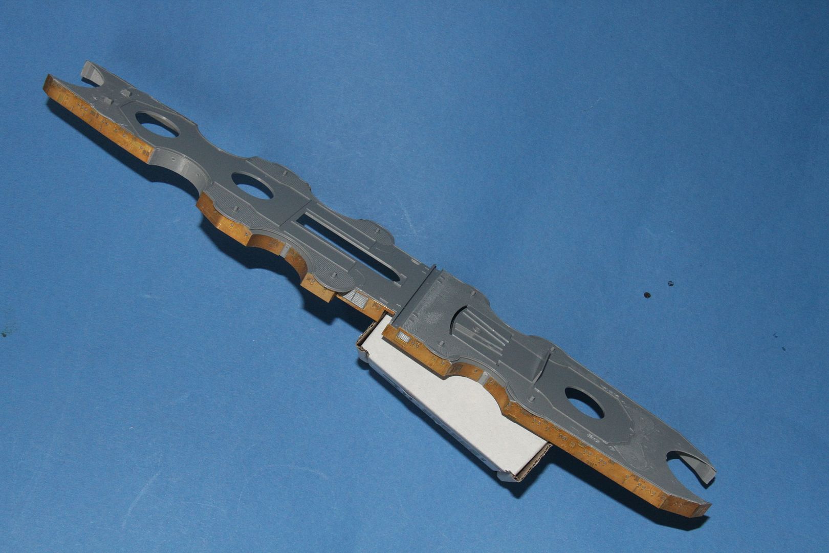

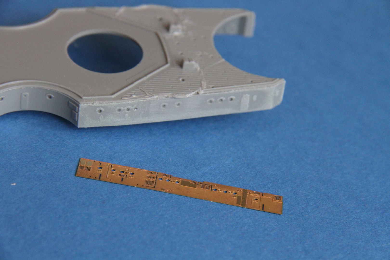

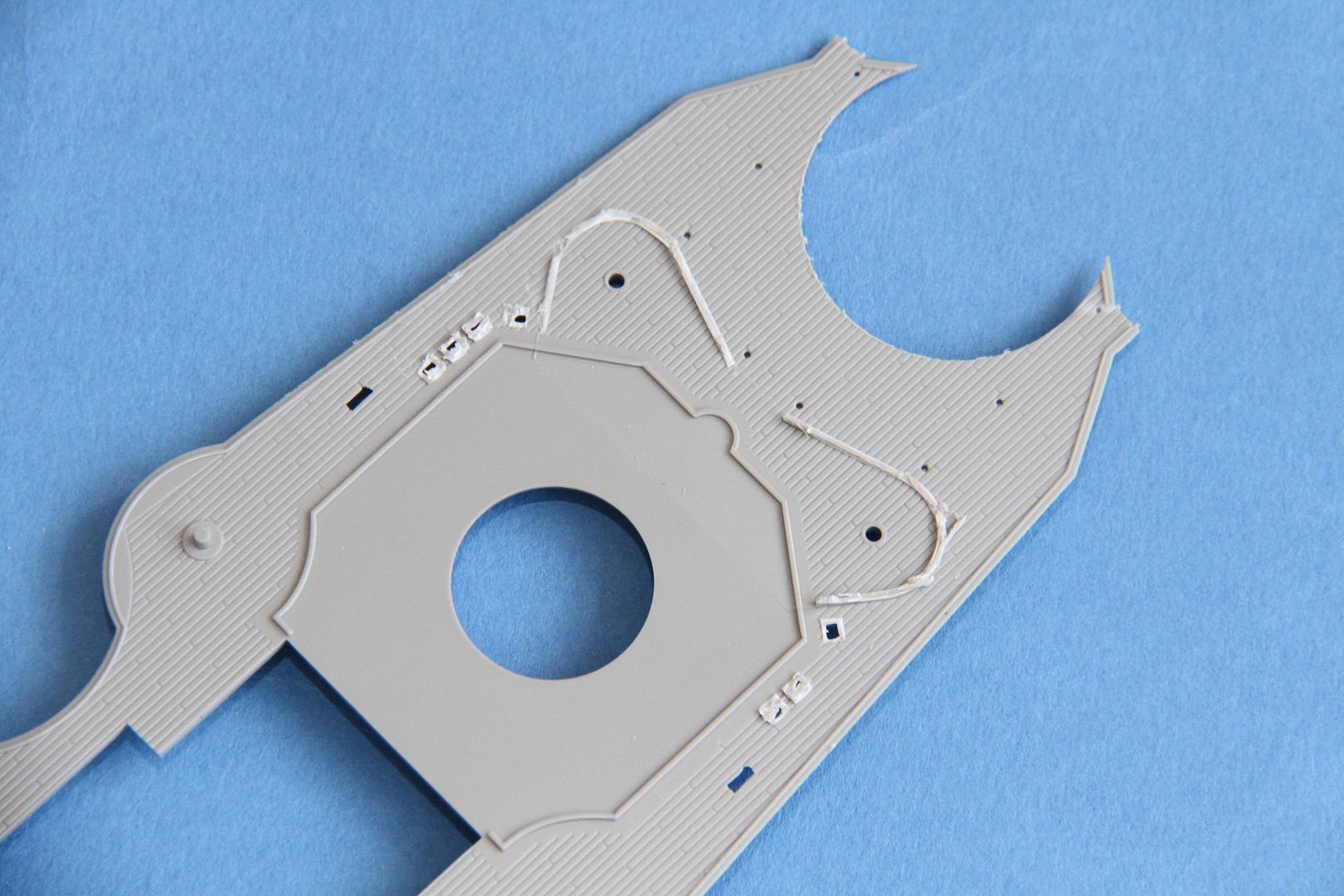

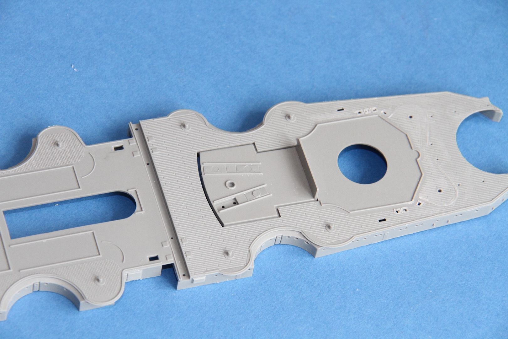

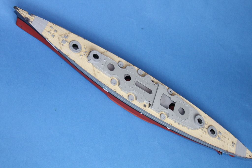

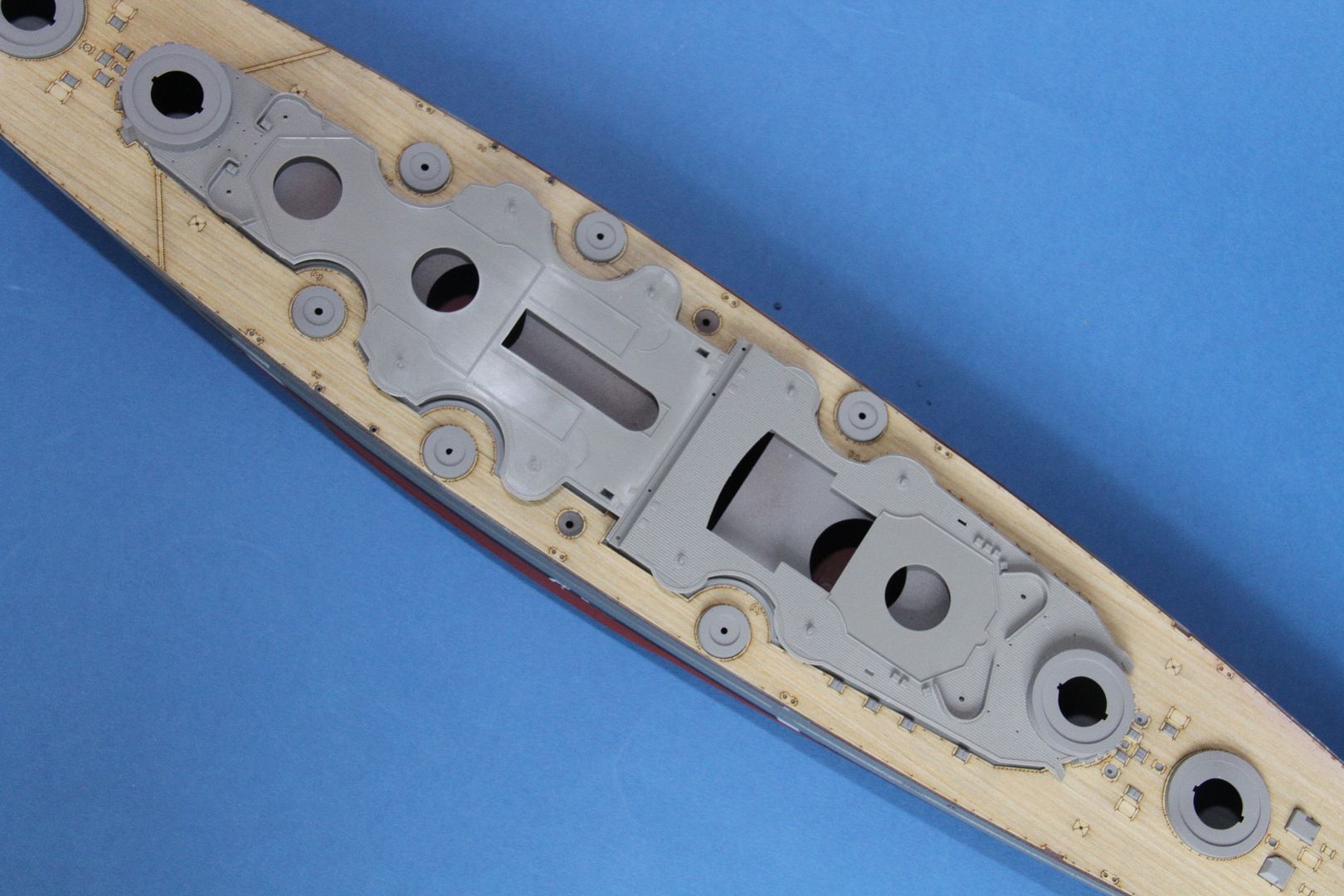

Today's update.
The shelterdeck removed from the sprue and test fitted. a lttle fight but good.

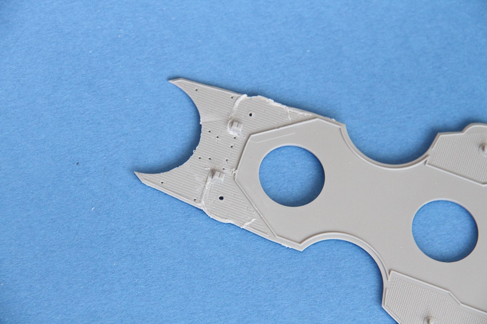

Removing the detail to allow fitting the wood decks. The forward 37mm splinte shielding.
The after ones come off too, this time along with the stowage boxes.
and cleaned up.
The shelterdeck built up and test fitted.
so far so good.
The interior hanger deck fitted.

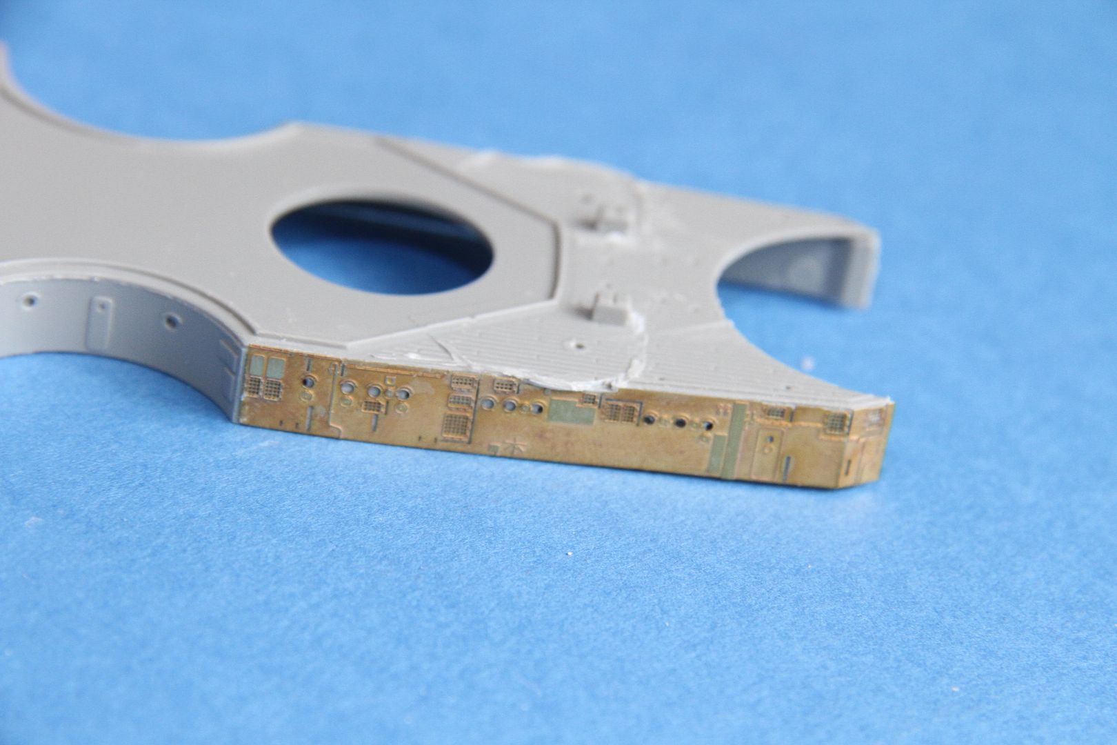

Brass cladding for the exterior bulkheads.
Part one.
in place.
As far as got today.
The inset for stbd No.1 15cm mount goes up another dek, so that will wait until the lower bridge structure is fitted.
Si

Si, that brass cladding looks great. certainly easier than adding doors, vents, portholes etc individually.
On your your covering for the air recognition strips are you going to try and further wash the covering away to bring through the insignia a bit more? I think it would look better with a bit of thinning.
RedDuster
Joined: March 01, 2010
KitMaker: 6,817 posts
Posted: Sunday, June 12, 2016 - 11:30 PM UTC
Hi Michael,
Good thought, certainly on the anchor ways, the fo'c's'le can be a busy place, with cables and chain stoppers rubbing as the ship moved in the seaway.
I think I will leave the quarterdeck as is, as the markings just about show through.
Thanks for the idea.

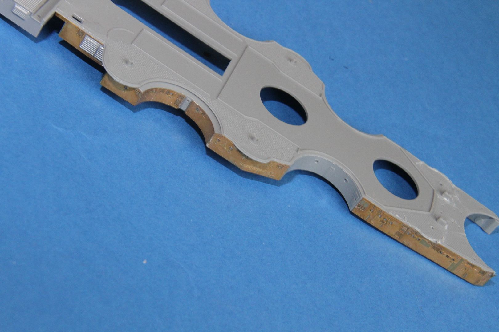

A small progress today.
The skins all on the starboard side.
Started on the port side.
Lumps and bumps removed from the after port side.
Good thing about posting, just noticed the door just aft of the catapult that needs sanding off before I go any further.
Si

The 'skin' is looking good, Si - at some areas it looks as if there is more stuff needed to be added on top, or ist that a wrong impression? But even as it it seems quite an improvement over the original parts...

Hi Jan,
Yes there is, lots of lovely little bits to go on, gatches, lockers, mounts for booms, paravanes etc.

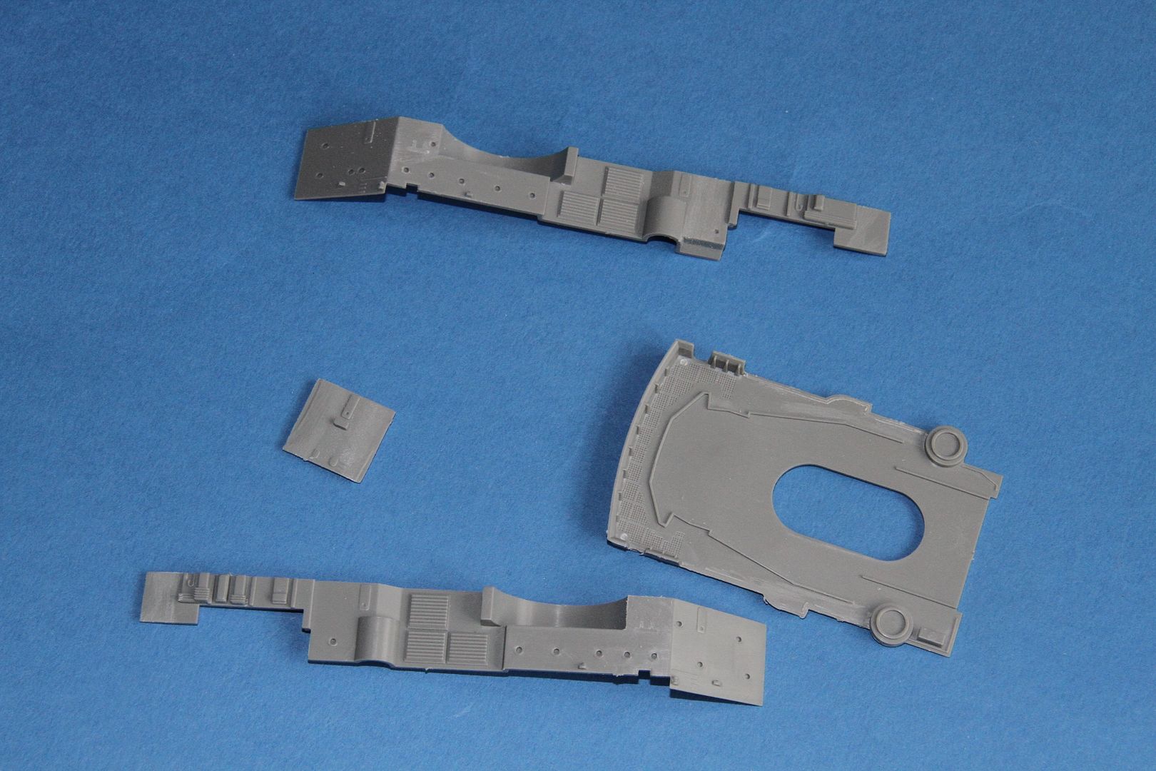

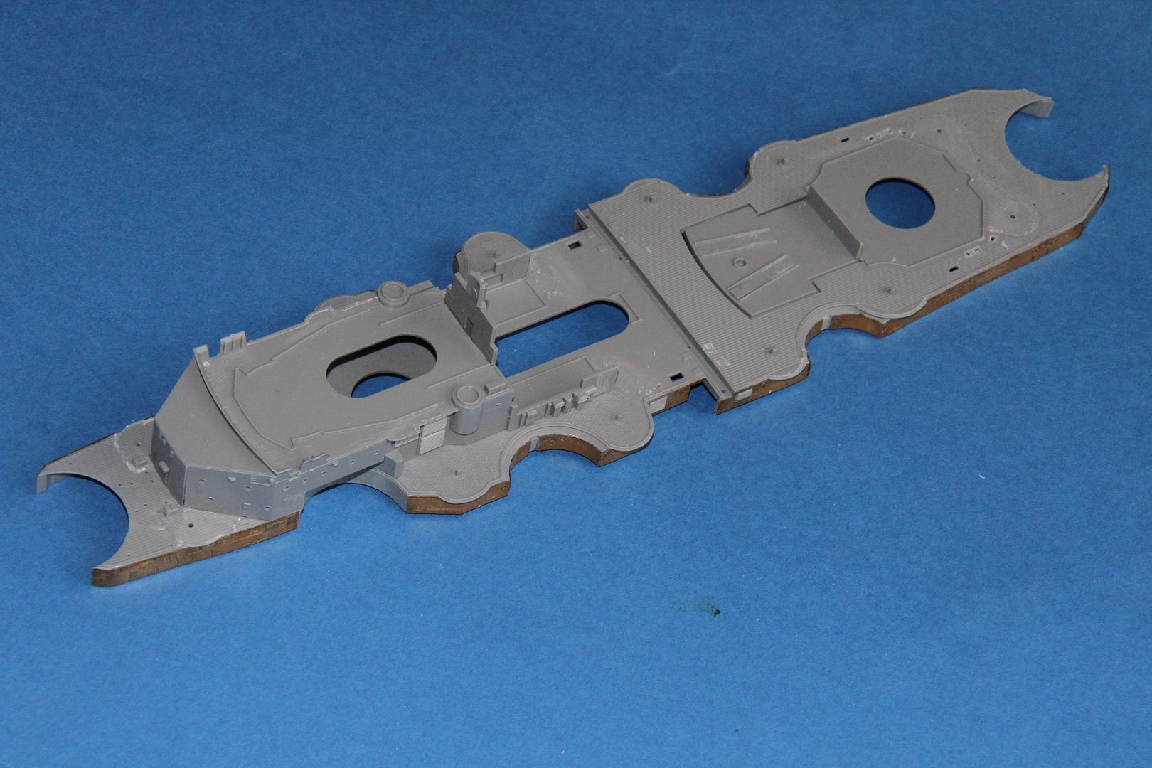

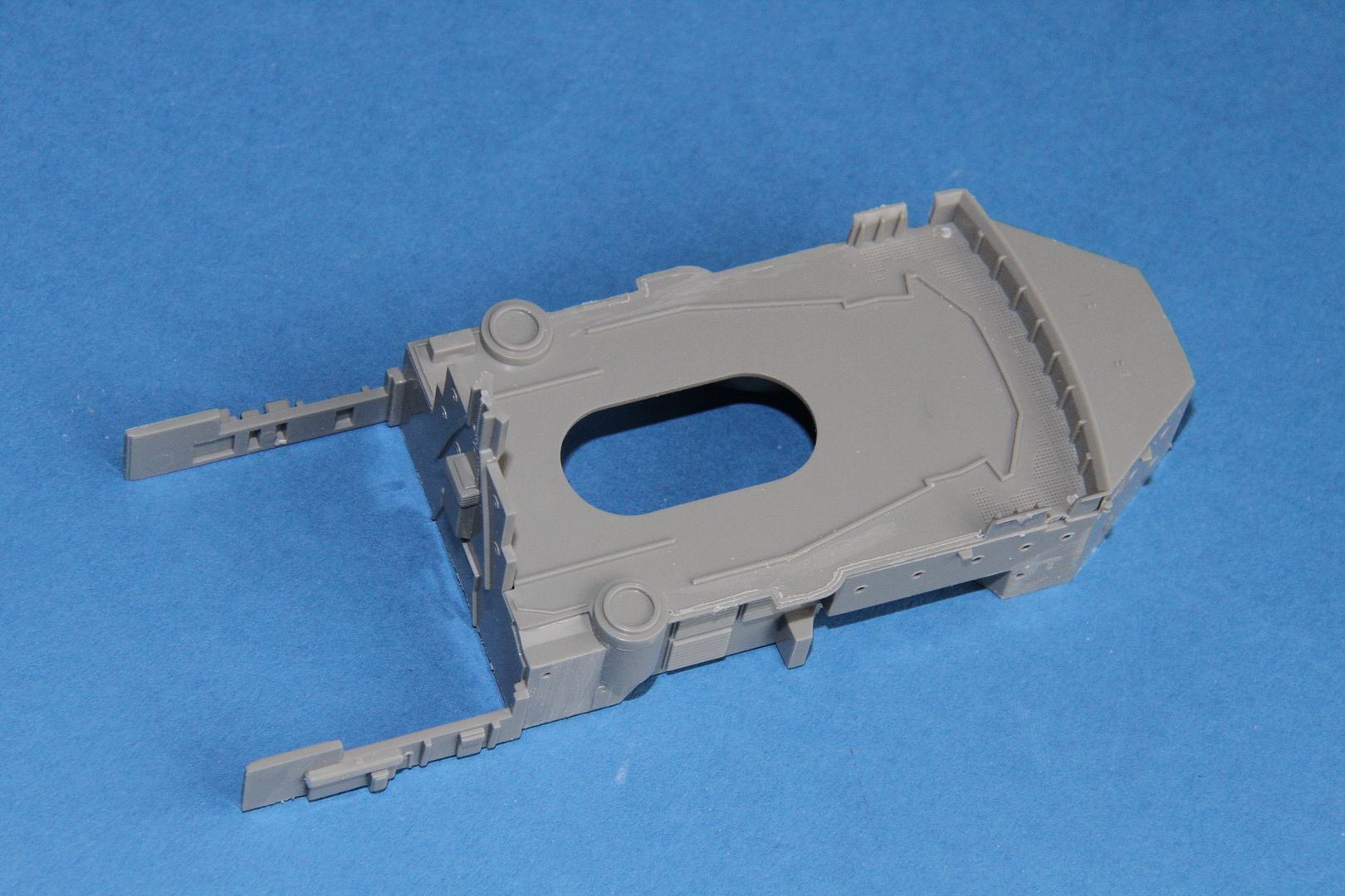

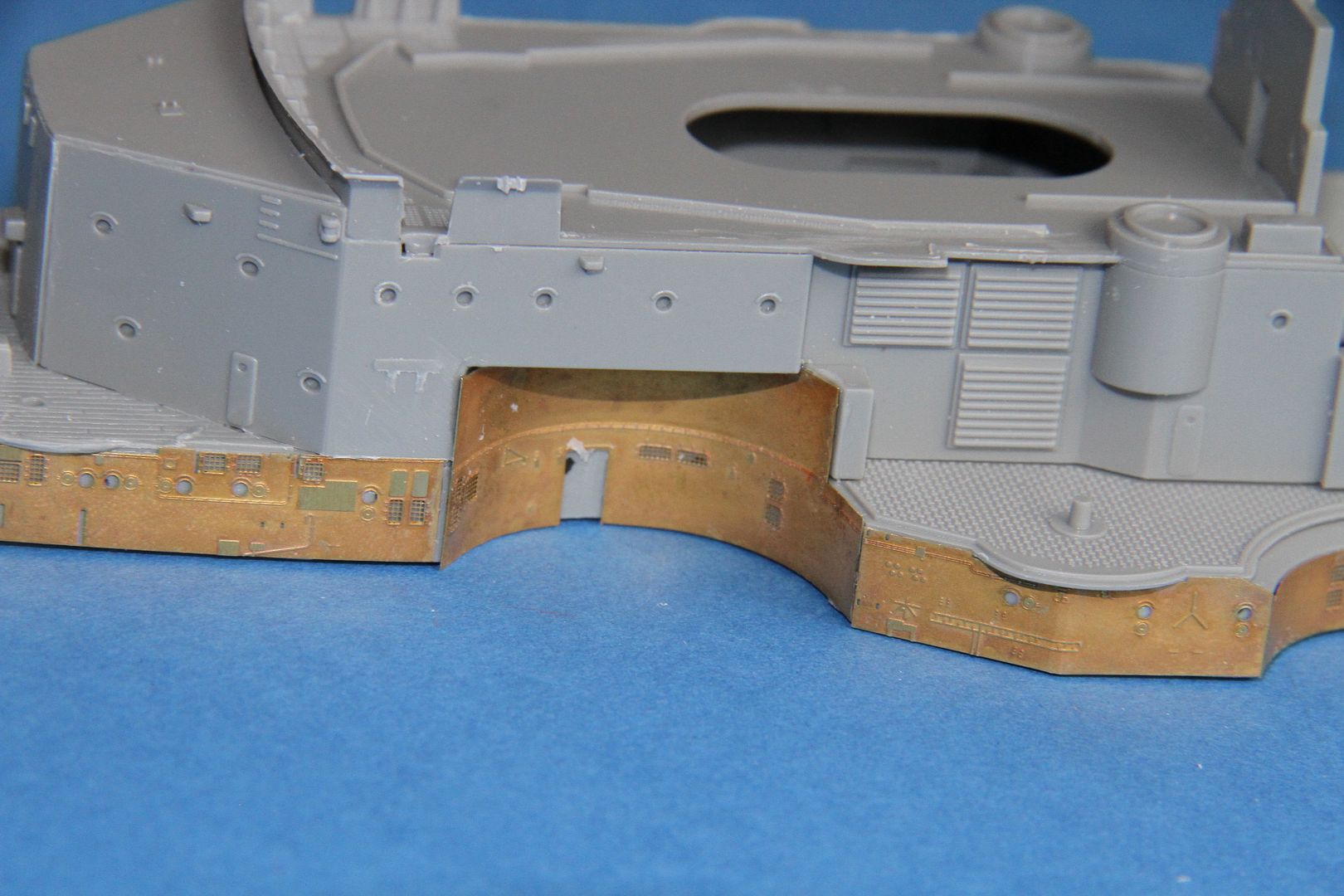

Today's progress.
Cladding on the port side completed.

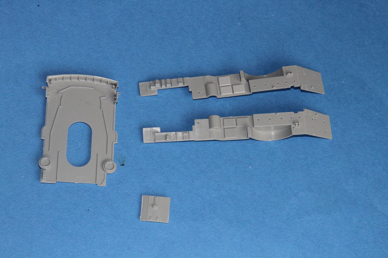

The lower forebridge components, need a few details need removing prior to assembly
Done.
Assembled
fixed in place.

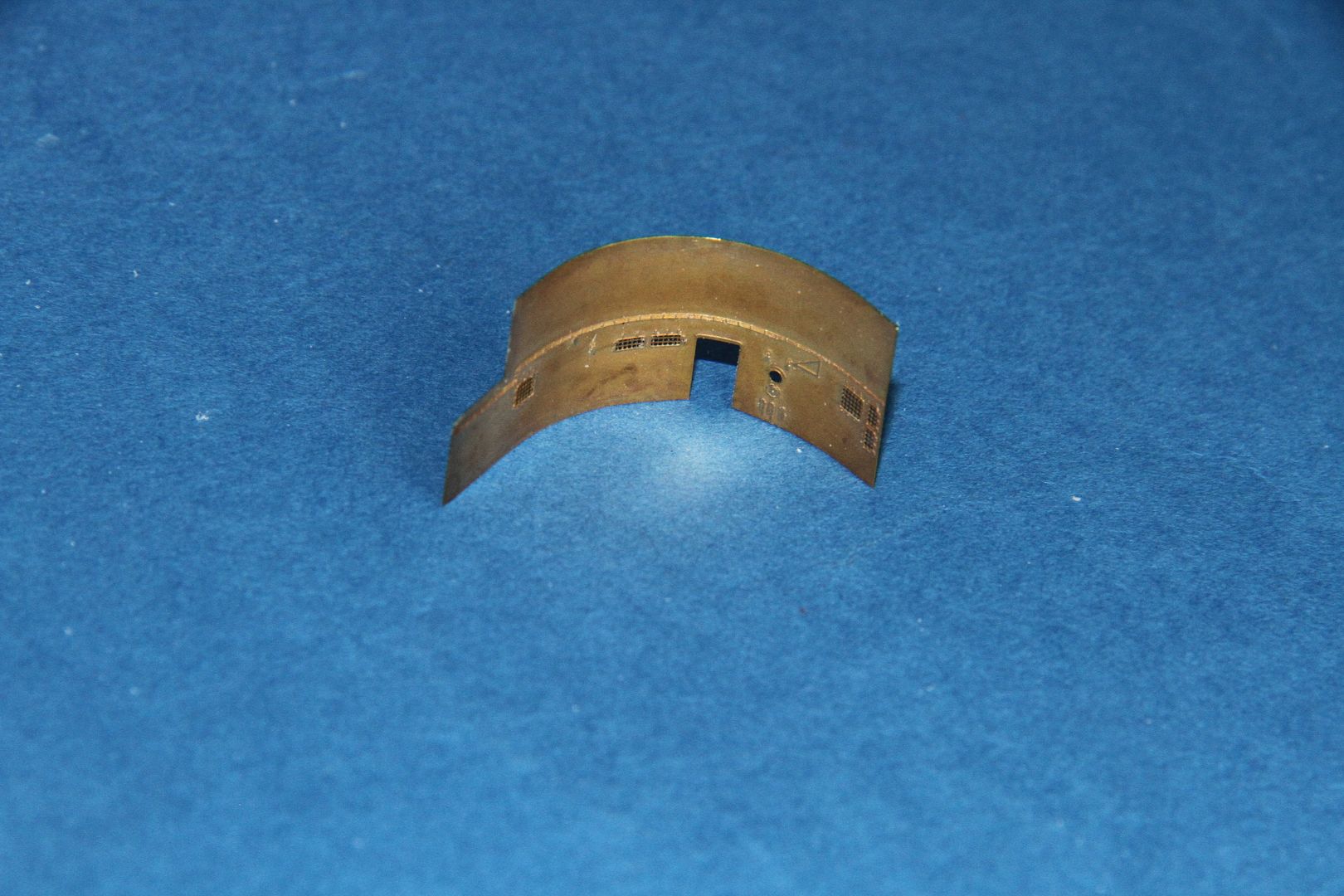

The cladding that goes behind the forward 5.9" mounts bent to shape.
Fitted, needs a little bedding in.
And the catapult deck piece in as well.
More tomorrow.
Si
