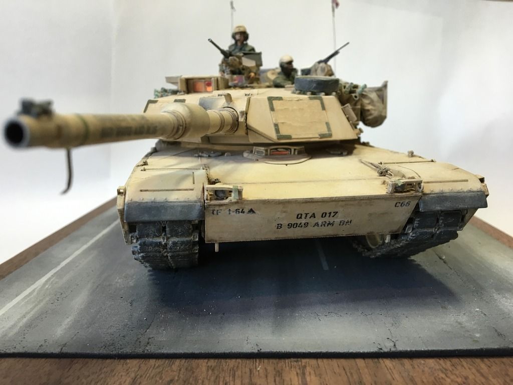

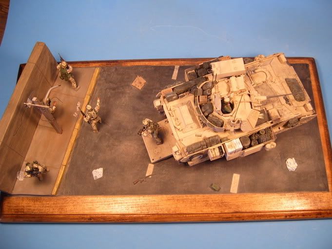

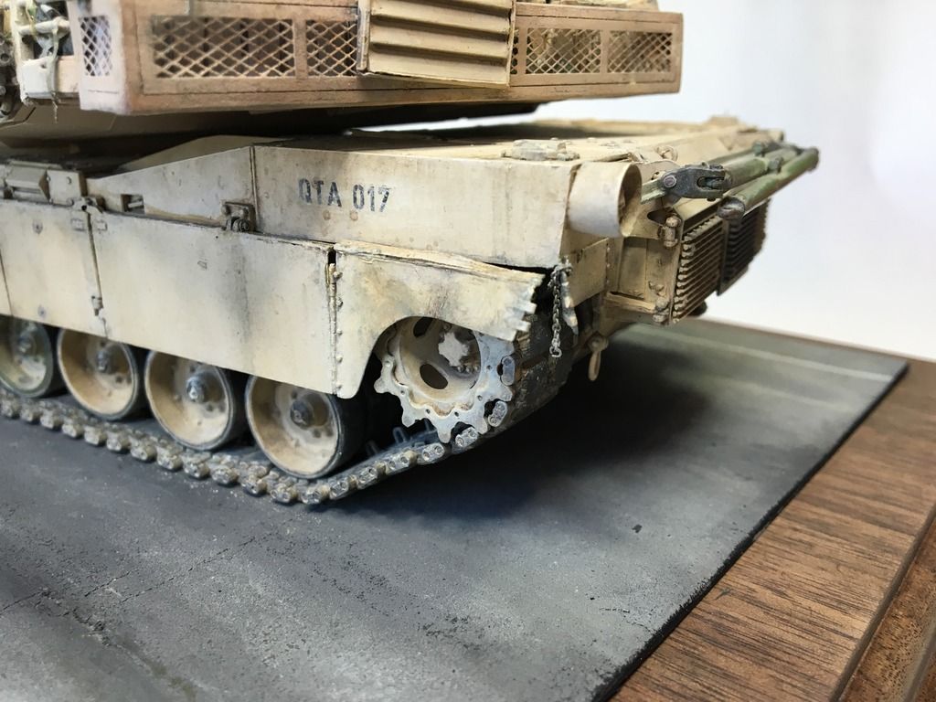

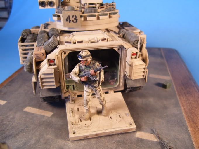

I use a thin layer of wall spackle (plaster, wall repair, etc.). Spread it on and smooth it out. In 1/35 scale, you can't se the individual pebbly texture. When dry, sand smooth and paint it with a dark grey. Then weather and it will look great.
Some examples.

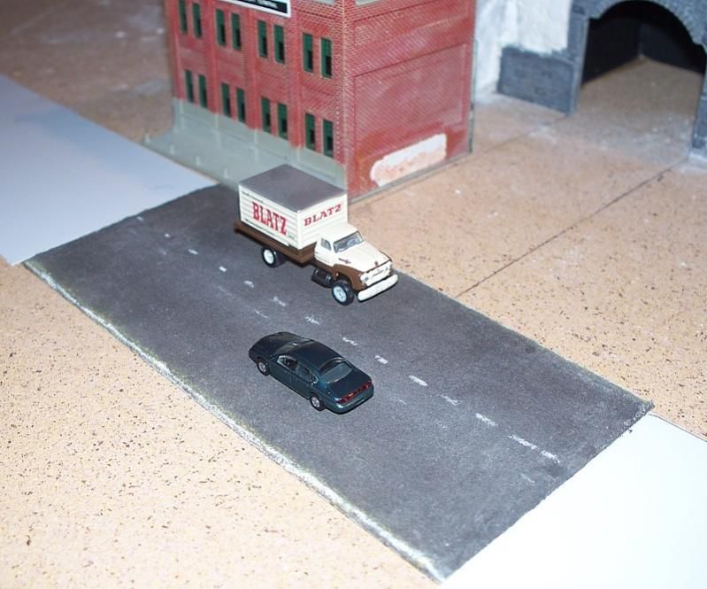

Arizona Rock and Mineral's Asphalt paving material is rather good. I use this stuff for model railroading. Just scale your road width to the correct size, cut a strip of styrene sheet to the dimensions and lay the rock product over it. Bonded with 1/3 water, 1/3 alcohol, 1/3 matte medium.
here's all the info you need for correct road dimensions.
http://mutcd.fhwa.dot.gov/
Fifer Hobby sells the product.
http://www.fiferhobby.com/html/arizona_rock_and_mineral.html
This was a test strip I worked on when I first got the product.
Compare to actual asphalt
al asphalt.
