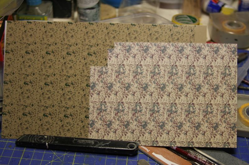

I also did some comparison shots of the decal sheets. The first up is the Steppentarn camo- the Trumpeter sheet is on the left and the Crossdelta sheet is on the right.
As you can see they are a good bit different. The Trumpeter one, to me, appears too dark and the pattern doesn't seem to be correct either. The Crossdelta one gets it right I think.
The Flecktarn sheet from Trumpeter in the photo below is on the left and the Crossdelta one is on the right.
The Trumpeter sheet here is definitely a better effort than their Steppentarn with decent colors but the pattern itself appears too large compared to the Crossdelta one. Although the Crossdelta one here appears a little faded but I think it will work nicely in terms of scale.

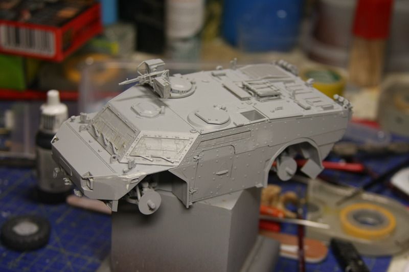

I've also got some paint on the Fennek itself.
Tamiya Primer was up first.

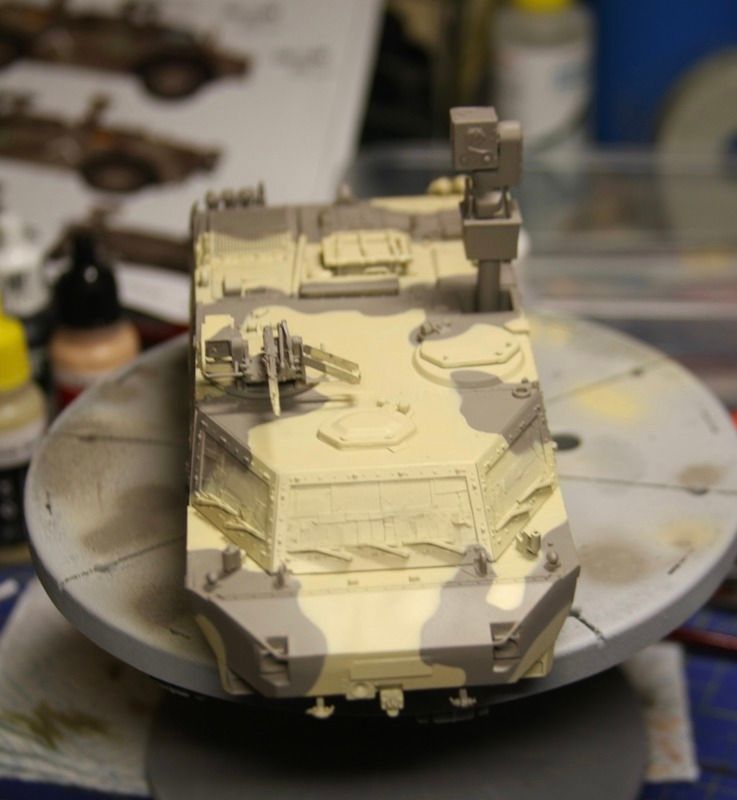

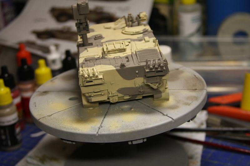

So I have an update of the camo painting.
I used the AMMO By Mig smart set for the colors.
For some reason Fennek's only seem to use two of the colors in their patterns so both Sand Beige and Grey Beige were used here, with silly putty used to mask the pattern. I followed the pattern set out in the kit itself. For the most part the pattern is good- I tackled it by doing the sides, front and then tackling the top deck and rear. Problem was some of the pattern didn't add up- this is a common and very annoying problem with color charts in kits (at least I find it is). If the vehicle is split in three, the front third and rear third are where some extra planning is needed- nothing major in all honesty- just a slight re-working of the pattern so it flows properly.
I will say a few words on the AMMO paint because I've had trouble with their paint in the past and I know others have too. My problem was getting a 'fish eye' effect when i first used their paint (on a GAZ Tiger)- several things were blamed- surface tension, surface dirt, oil from fingers, mould release agent (unlikely since for me the problem occurred over primer), in-correct air pressure, atomization issues, paint improperly mixed etc.
That was with their orange cap bottles- since then their bottles now come with a yellow cap- denoting that an agitator ball has been placed inside the bottle for easier mixing- and it does work very nicely. The only problems I encountered with the paint this time was a slight bit of surface tension- where going with a light coat seemed to solve the problem. The other problem was 'fish eyeing' again- but the worst cases of this were caused by me spraying too much paint in one area- i.e. over-saturating the area with paint. Once dry, the fish eyeing could be covered up with a further spraying of paint. An added bonus of these paints is that they hand-brush very nicely so tidying up fiddly areas (the MG Mount for example) is nice and simple.

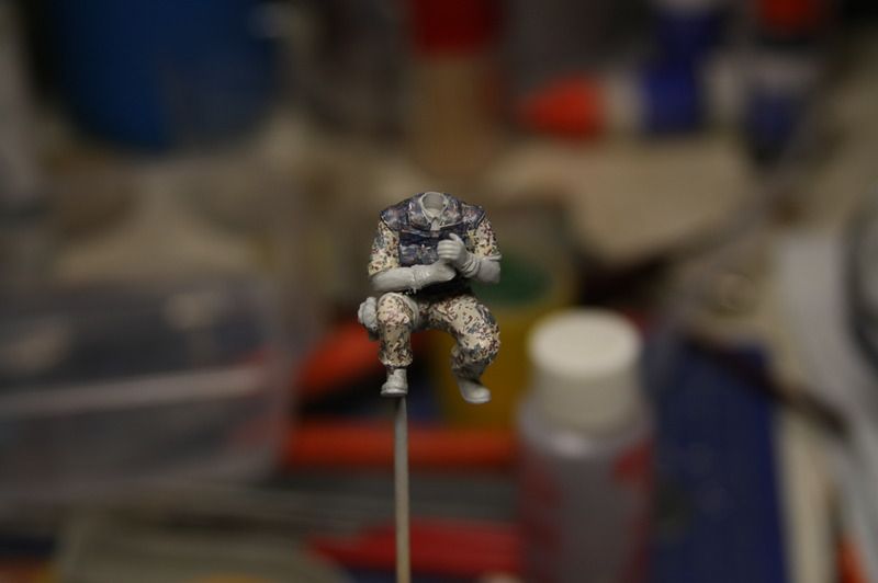

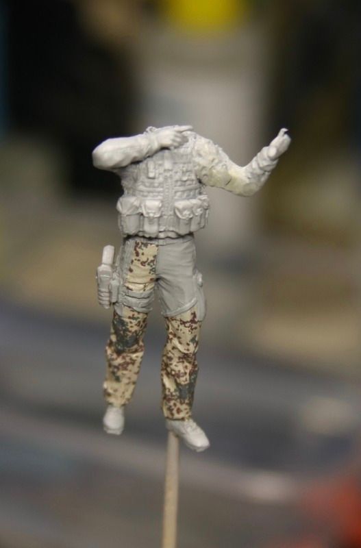

I have to start this update with an apology for yet another delay in this build! Since the New Year a few things have been keeping me away from the bench. The delay has also been compounded by my underestimation of the time it would take to put decals on the figures.
A few of you expressed an interest in figure decals so I will explain a bit about how I tackled them.
For a start I will say it has taken far, far longer than painting would and it is very tedious and annoying- making Fruil single link tracks is one of those long, boring jobs but even that is more enjoyable than doing these decals. The problem is partly to do with modern figures and their multitudes of equipment.
Equipment and pockets on uniforms, seam changes, straps etc- they all require a different approach. A leg pocket, for instance, will not be cut from a continuous piece of cloth- it won't match the pattern coming up from the ankle or down from the thigh because it is sowed on top of that. So wrapping, say, the whole leg in a big bit of decal is a no-go. Same for pouches on the vest- two pouches side by side will not have a continuous bit of camouflage pattern between them because they are made from separate bits of material. This requires cutting small decals- sometimes smaller than 1/72 'NO STEP' aircraft decals. And then you have to make sure all these separate small parts look correct and don't look like a load of strips cut and pasted on.
So far I have fully decalled one figure- but it is still not finished as various solid color areas need to be painted in- strapping and edging etc- and after that the decals need some further treatment to blend them in better.
As you can see the pattern is probably more accurate than you might achieve with a paint brush- but I reckon with time and patience you could get a very nice result with a brush and it would be a lot simpler and less annoying to do.
The above figure was one of the resin Blackdog figures and it took the decals very nicely with some Micro Sol. The Crossdelta decals sat down very nicely even around awkward areas.
However, on the Tamiya figure I had to do the vest and pouches in the old Flecktarn pattern- and even though it was by Crossdelta it didn't conform anywhere near as well as their Steppentarn sheet and it looks very dark and indistinct for the pattern it is supposed to represent.
The vest was a particularly awkward shape and required lots of small strips- the problem is you can notice this quite easily- not much I can do about that though. I am hoping with a coat of Future and some acrylic washes it will become less noticeable.
I'm not entirely sure, but I reckon the Tamiya plastic doesn't take quite as well to the decals- even with plenty of Micro-Sol- the sharper detail on the resin seems to show up much better under the decals.
My approach to this is partly why it is taking so long- so many tiny pieces of decal to cut, wet, place and let dry- its monotonous and very annoying. I did use a slightly different approach on the other Blackdog figure- I was thinking to myself that there must be a quicker way and then I realized if I put tape on the area to decal and then pencilled in where the decal had to stop- then I could place the marked tape onto the decal sheet and cut out the shape. That worked nicely- but only on areas where you could use larger cuts of decal- for the pouches and other smaller areas it will likely be back to using small bits of decal.

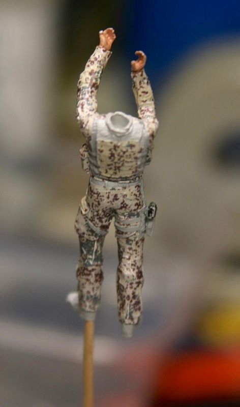

It may have taken inordinately longer but the result looks great! Those patterns look harder than erbsenmuster to paint so the decals may be worth it.
Nice build and not what I am used to so very interesting as well.

Masterful work, they look amazing. I'm totally stealing your idea with the tape. I've also found a lot of inconstancy in the quality of CrossDelta camo. Some are opaque and white backed, and some are clear. Like you noticed, the quality of the printing varies too. Their woodland sheet was meant to have faded versions as well, but mine didn't.

Thanks so much for the comments guys.
Hans-Hermann- you should definitely consider giving the decals a go- just be prepared for it to take a while! I understand your comments about the figure- I guess I should explain why I picked the kneeling guy. Basically I'm going to have the UAV about to launch up on a hill and behind that will be a small stone well. The UAV Control systems will be set up around the well which is also up on the hill to give a good view of the surrounding area. Thats if I actually manage to scratch build decent control units as my scratch building skills aren't exactly brilliant! The kneeling guy will be placed just beside the controls, ready to take control once the UAV is launched. Then the other figure with the rifle will be placed down on the road-way near the Fennek keeping watch.
Jerry- Thanks for the comments bud- I think you are right on the money in terms of the detail of the pattern the decals provide- its just the monotony of doing them takes away the enjoyment I usually get when I paint figures!
Simon- Very kind of you to say- thanks so much!! You should definitely use the tape thing- it makes covering some of the larger areas much easier. I think you are right about the decals- the Flecktarn sheet just doesn't want to conform the way the Steppentarn one does- it seems thicker. Luckily both patterns weren't opaque so I could easily lay them down over a coat of primer without worrying about the color coming through. The faded decals sound interesting- was this for US Woodland camo?

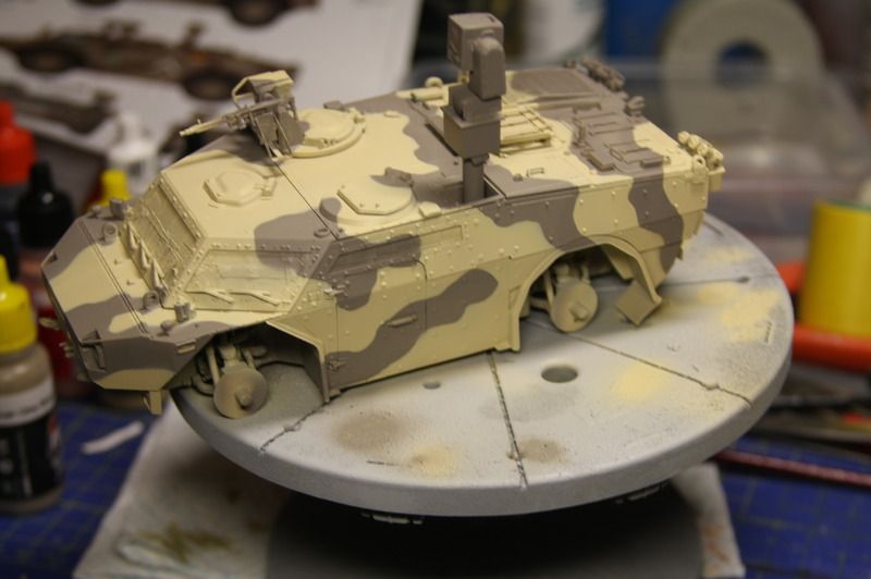

Those look stunning, especially with camouflage on the Fennek and the soldier.

Thanks for the kind words SpaceX. I'm looking forward to seeing what the camo on the figures and the Fennek is like once I have some paint on the base. That is, when I get finishing the base !
