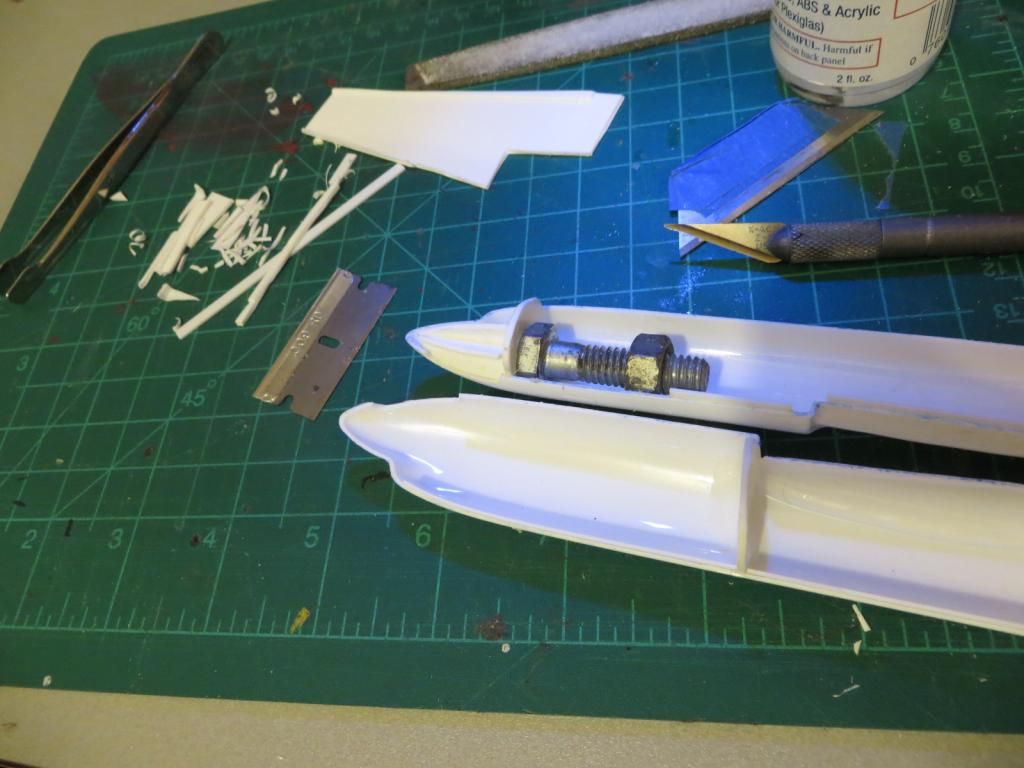

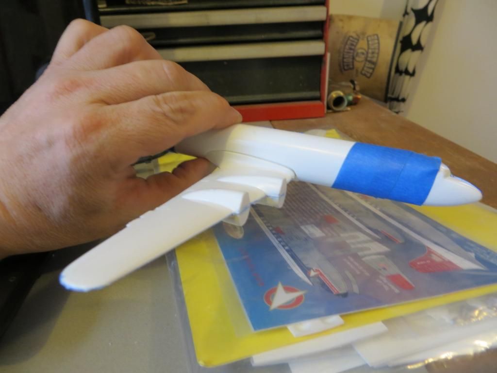

Posted: Sunday, February 15, 2015 - 05:12 AM UTC

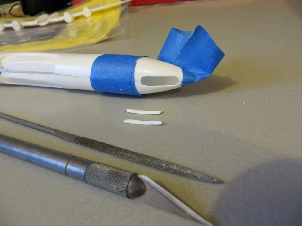

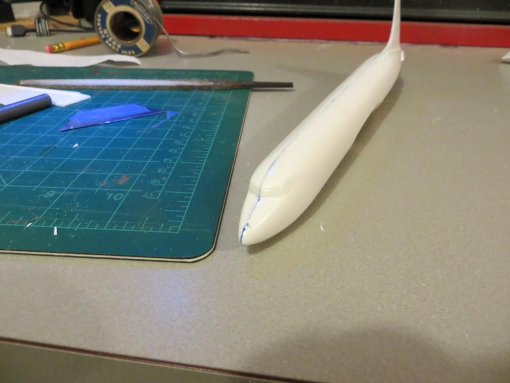

nose wheel doors cut out and set aside
bulkheads and nose weight epoxied in place, and a box for the nose wheel well installed

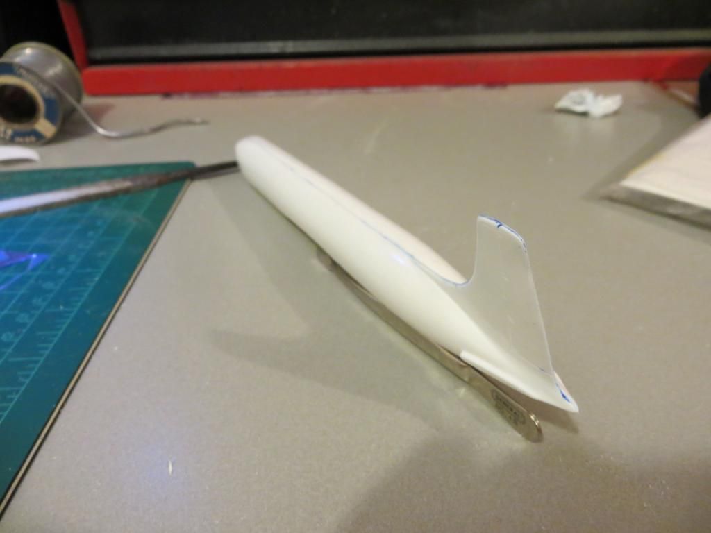

Fuselage welded shut
that's a nice thin fin and rudder.

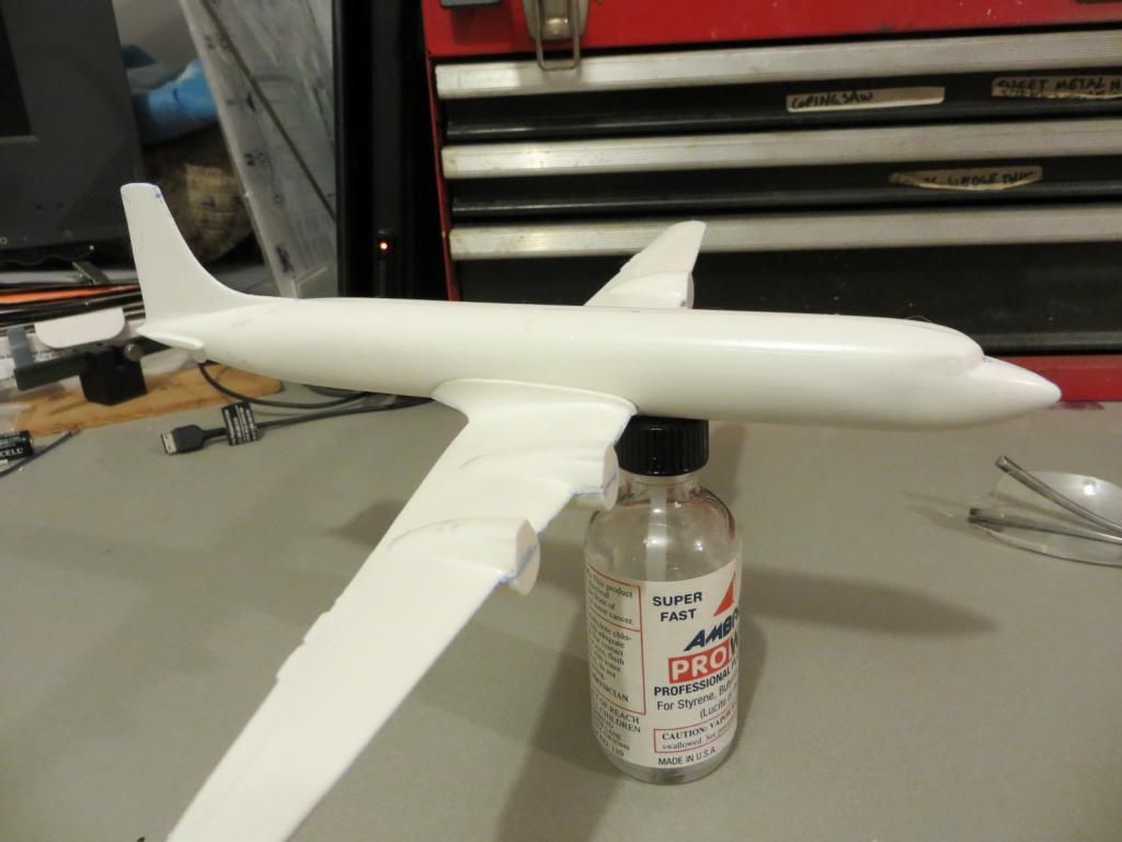

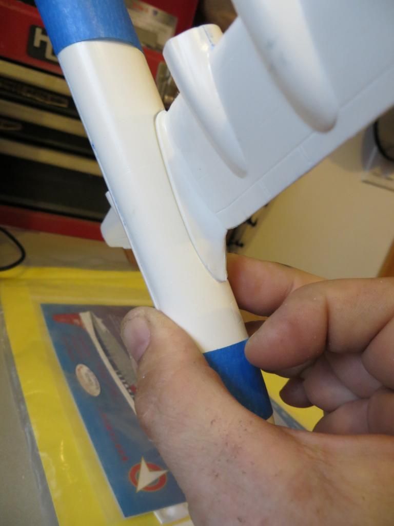

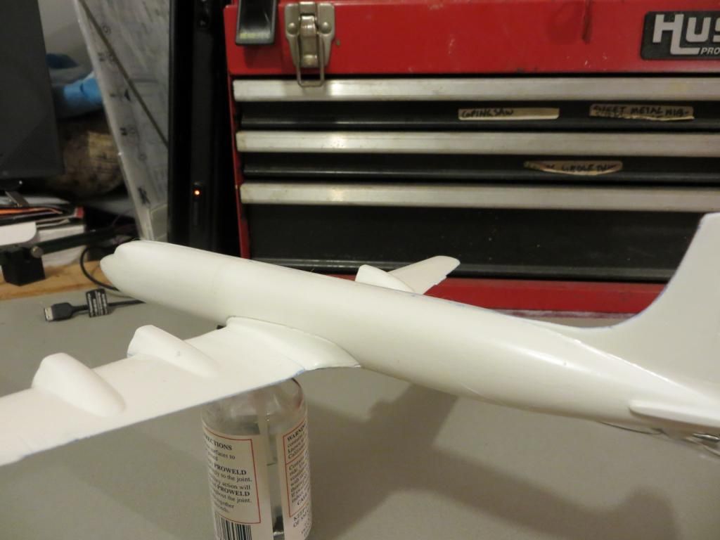

Went ahead and welded the wing to the fuselage
starting to look like a DC7.

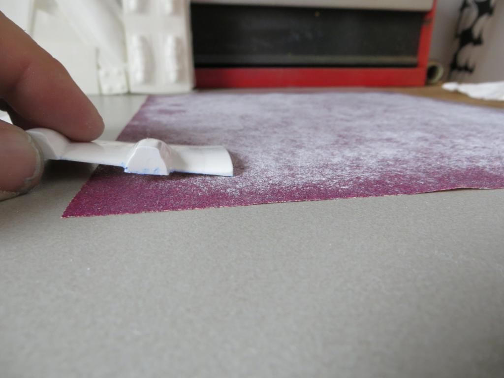

In any case it's important to keep site of the plane of reference while sanding your way toward it.
if one side goes faster than the other, you can work 'over the edge' until the slow side catches up.
Yup, a vertical fin may take as much time as the rest of the part, and is basically treated as a separate part.
Some people recommend wet sanding, to prevent potentially hazardous respirable particulate. I don't like wet sanding. I find going slowly with the 100 grit, the dust is course enough to stay on the sheet, and I can just vacuum it off periodicly.
I do keep a damp paper towel at hand to wipe the table and my hands.
The DC-7 fuselage halves complete
and the dry fit to the wing looks good.

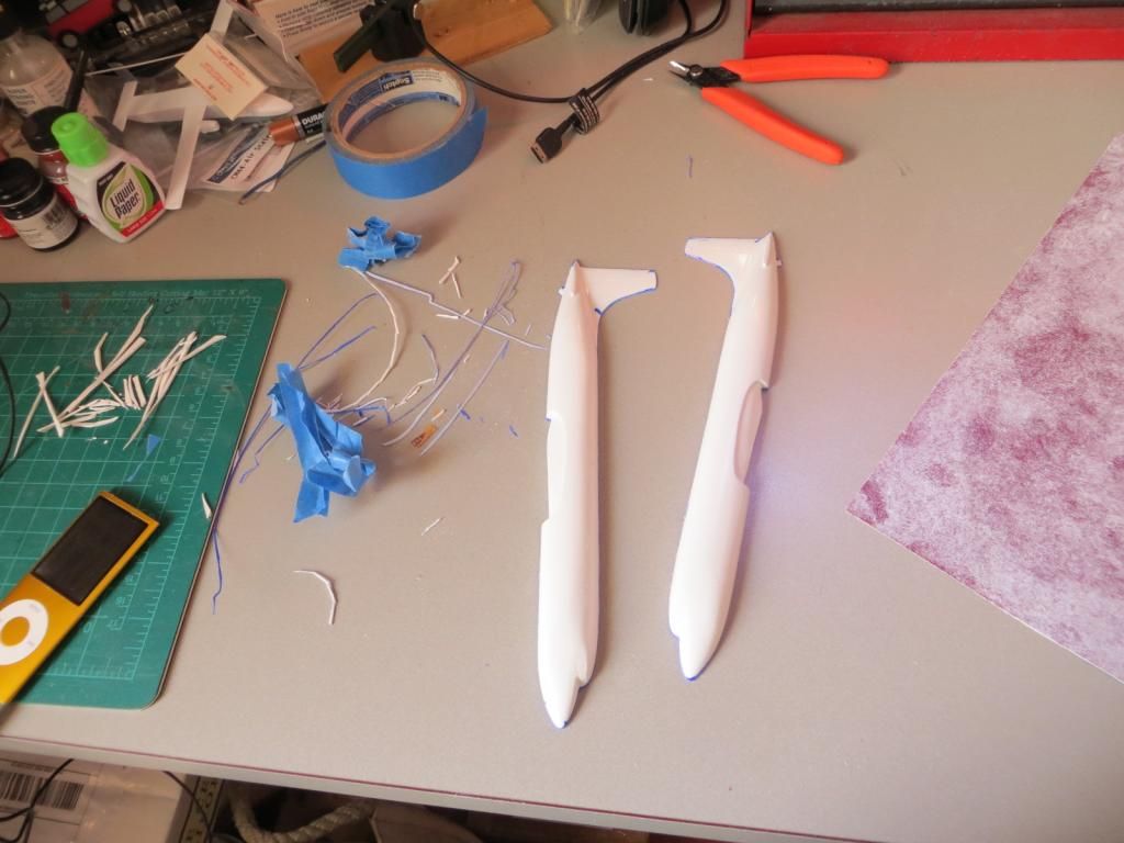

Posted: Thursday, February 12, 2015 - 08:53 AM UTC

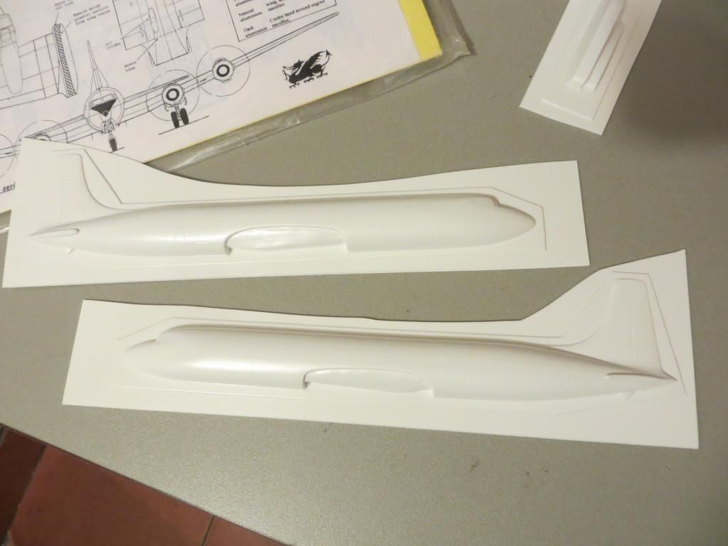

Here's my trick to sanding out fuselages. You don't need to leave as much waste around the edges. I also like to spray my fuselages with primer while they're still on the sheet to make the waste very visible. Score around the edges of the fuselage halves at a 45 degree angle, then snap off the excess plastic.
Now you see it
Now you don't
It took me less than 15 minutes to sand out both fuselage halves. Most of that time was spent getting the trailing edge of the fin acceptably thin
Before you glue the fuselage halves together, you need a bit of re-enforcement inside. Bulkheads (given in some kits, and scratch built for others) and tabs give the glue something to grip to. Don't forget nose weight if your kit will need it.

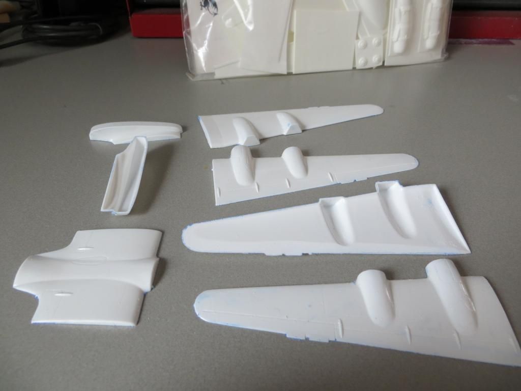

Now an update on the DC-7

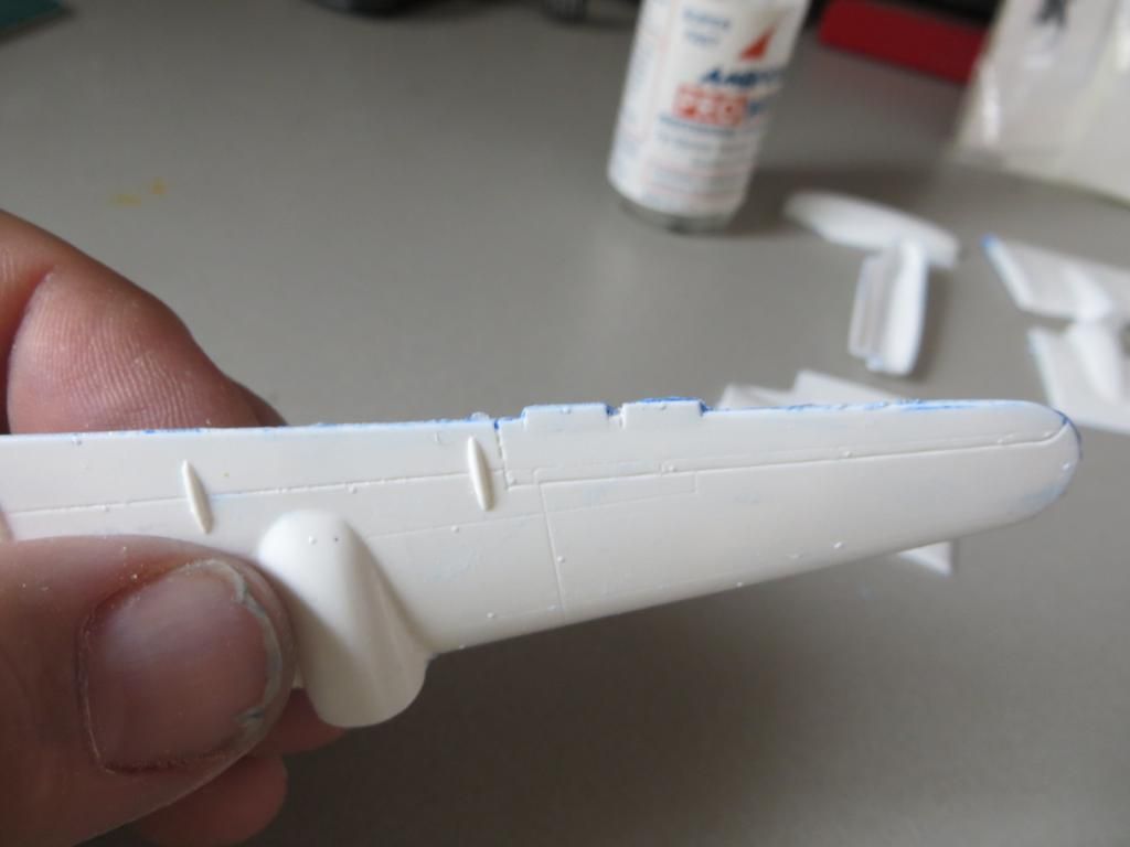

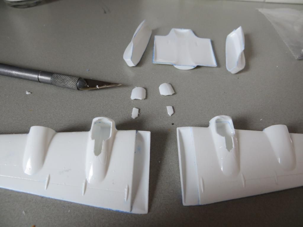

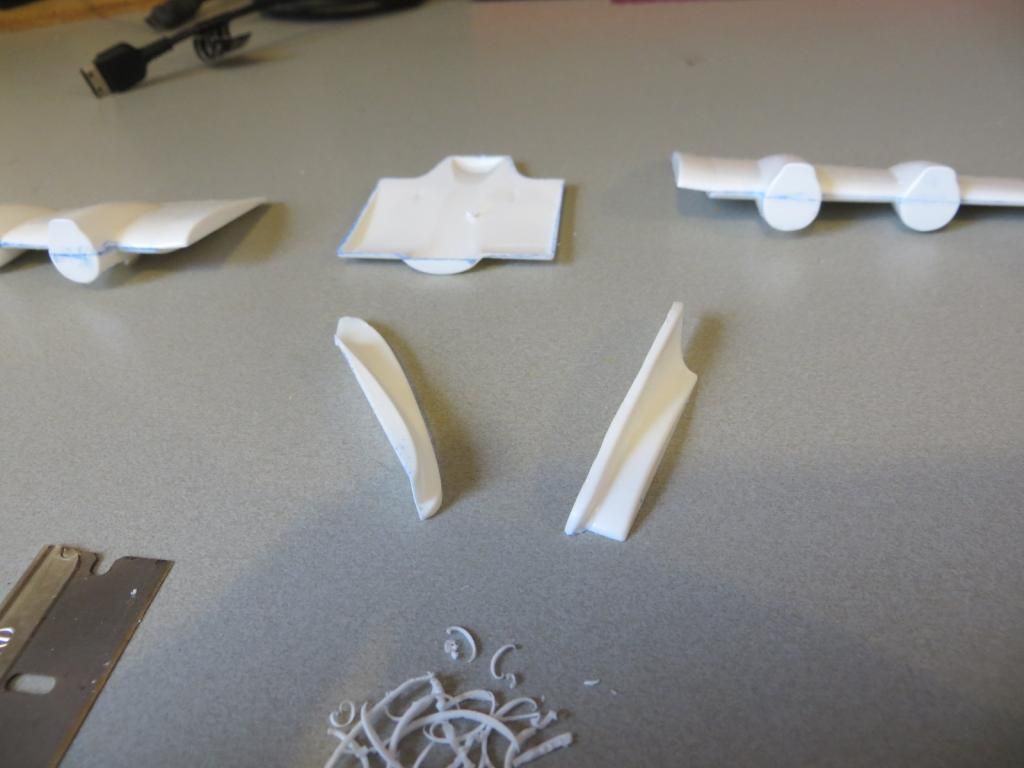

Ive sanded out and cleaned all the wing parts.
the outer wings have a dihedral, so an angle must be sanded onto the upper surface where it overlaps the center panel
the kit has nicely inscribed panel lines, and the trailing edge is nice and thin.
the wheel well doors are closed on the part, so have to be cut out. Ill pack some Milliput in the hole later.
the wing root fillets are separate parts that had to be cut in two planes.
I got it wrong and had to weld back on a sliver that I had cut off.

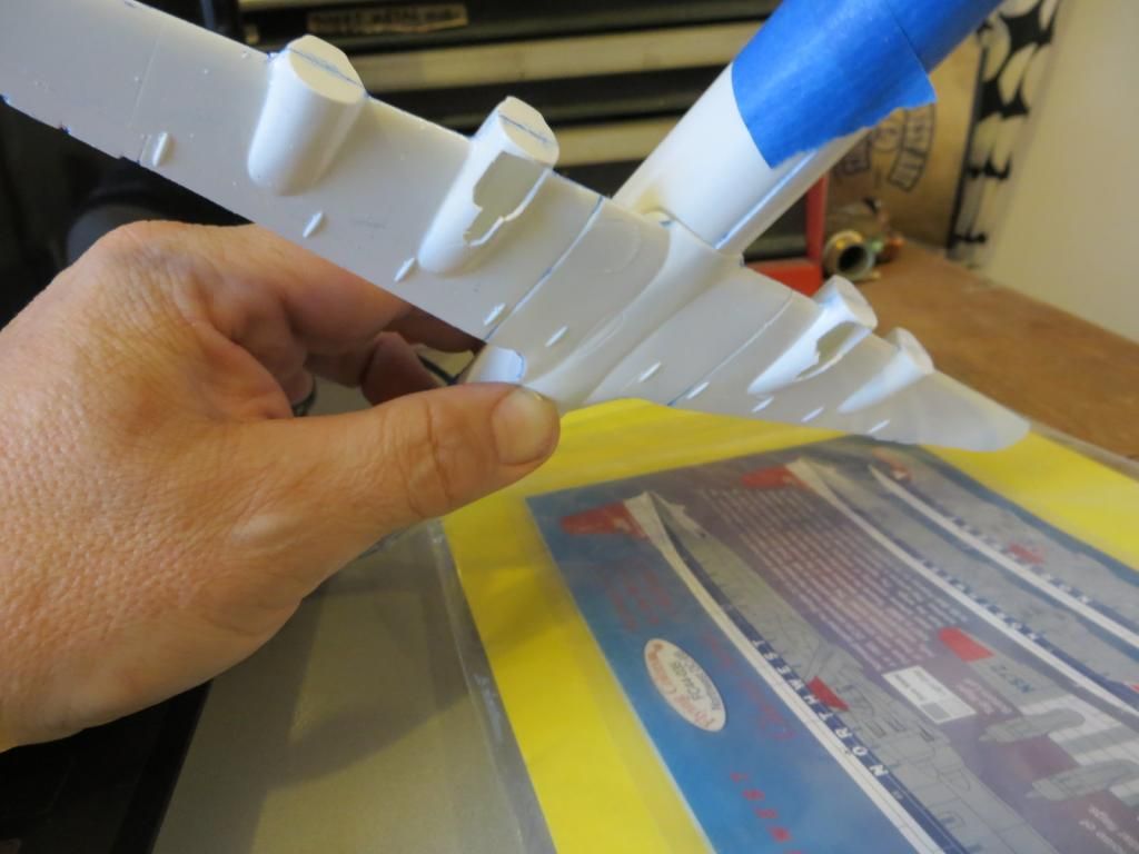

the wing all welded together.
The assembled wing has a good solid feel.
tomorrow Ill get the fuselage halves sanded out and see how the wing fits on.

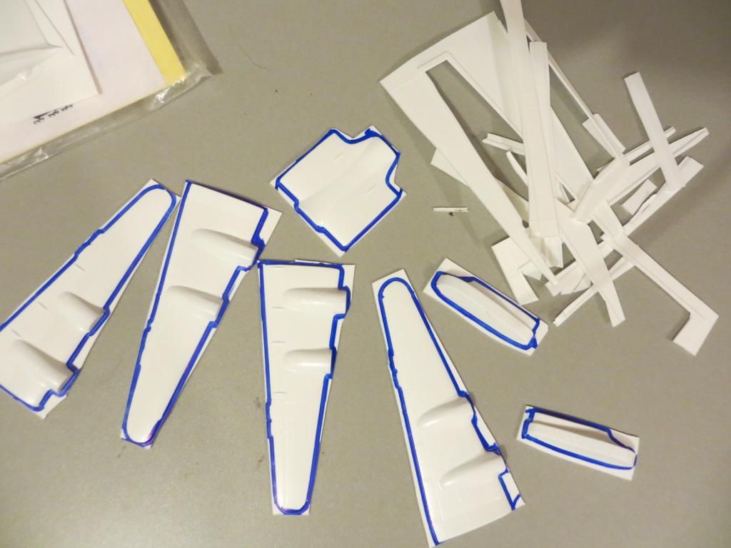

At this point, for the benefit of the curious observer, Ill lay out a very brief how-to. first, here is the key piece of information to unlock the vacuform parts from the sheet

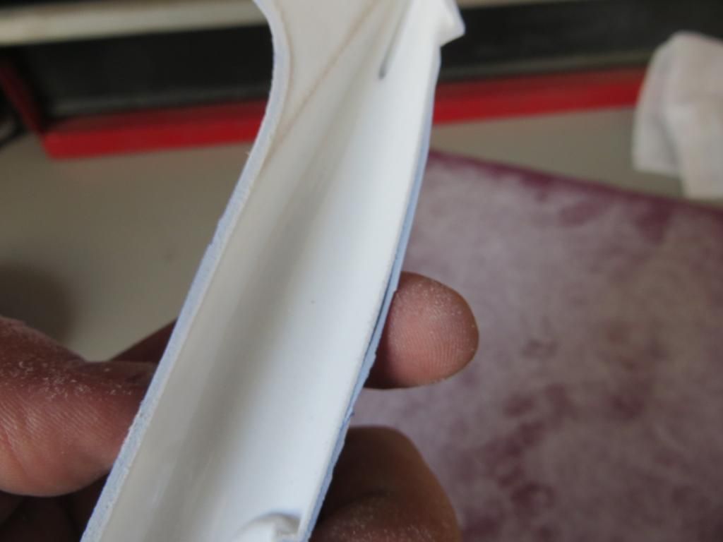

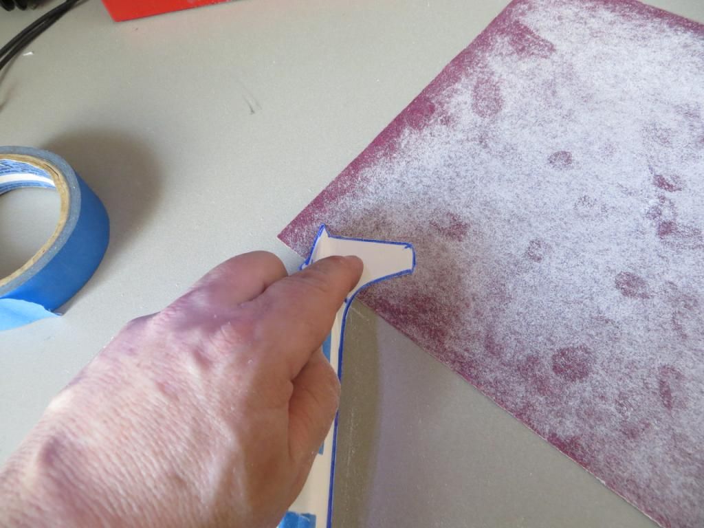

Since it is virtually impossible to cut parallel to the sheet, we cut out around the part leaving a narrow flange, and then sand the flange off. Use a Sharpy pen to color the intersection of the part and the backing sheet.
The masking tape handle makes it very easy to rub the piece around and around on the sheet of sand paper.
keep checking the bottom, as the flange gets thinner, the color ink will begin to show through, revealing the true outline of the part.
little by little, it becomes the thinnest flash and drops away.
you will need to apply different amounts of pressure and time to different edges. the wing tip and trailing edge need alot more material removed than front edge.
I like 100 grit sand paper for this. it cuts fast, holds alot of dust,and the finish it leaves on the mating surface loves liquid welder.
when done sanding, the ink wipes right off with isopropyl alcohol on a paper towel.
