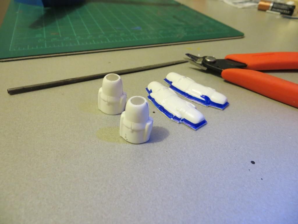

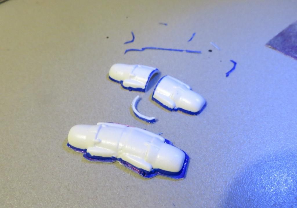

Posted: Friday, February 20, 2015 - 05:51 AM UTC
Today I made up a couple of the engines.
They'll look better with some paint on them, and the intakes opened up.

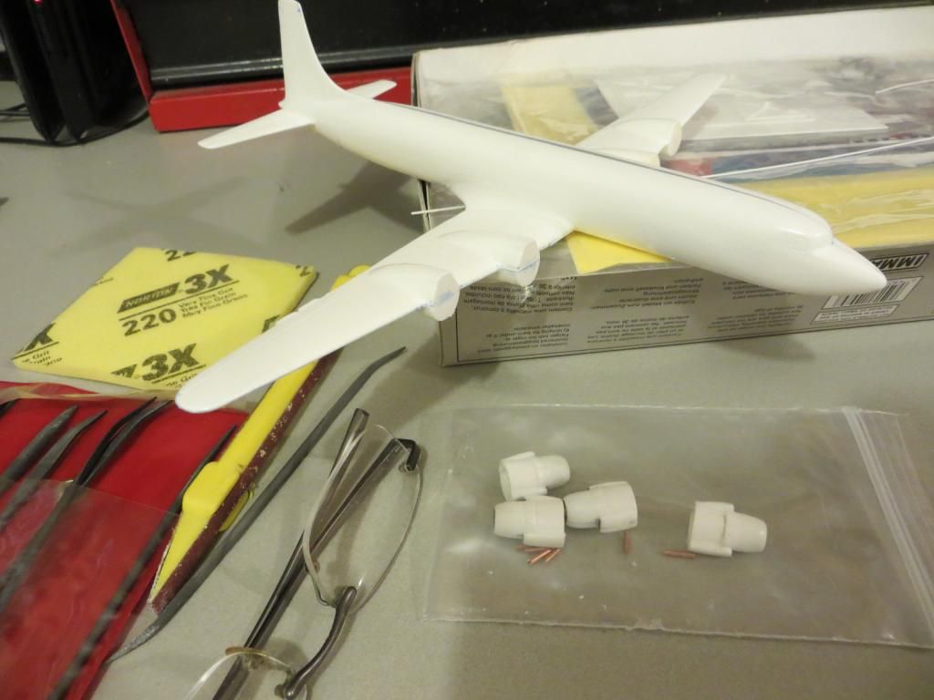

The airframe is complete, and I've had about enough of fairing the wing root joints.
I also finished the engines. the vacuform part just had little nubs to represent the exhausts. Ive been looking at pictures of DC-7 engines, and they have cool looking obliquely cut exhaust pipes, so I cut up some bits of 1/16 dia copper tubing, and drilled holes for them. they look ok, I think.

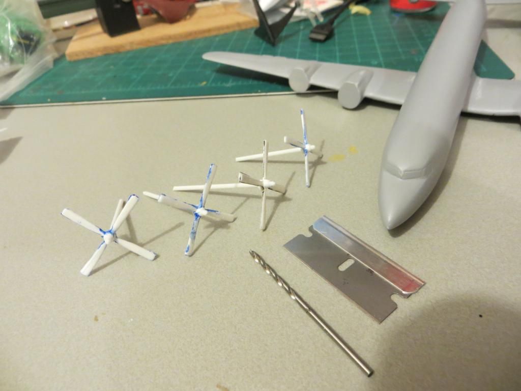

Today I built the props for the DC7. possibly the most difficult vacuform task,
sanded out the vac parts,
welded some .030 half round to the backs of the blades,
added a disc of .040 to the back of the spinner,
drilled .064 hole through the centers,
inserted 1/16" dia rod.
I have started to sculpt the resulting spinner tips to a point. bit of work left there.

Jonathan! Thanks for enlightening me: I never thought the props in vacforms were for actual use, I have always had the impression that they were included as patterns only !
Magnus
Posted: Wednesday, March 04, 2015 - 11:30 PM UTC
Even provided with a pattern, I could not possibly fabricate a better looking prop, much less four identical ones.
The props on this C-47 were also cut from the vacuform sheet.

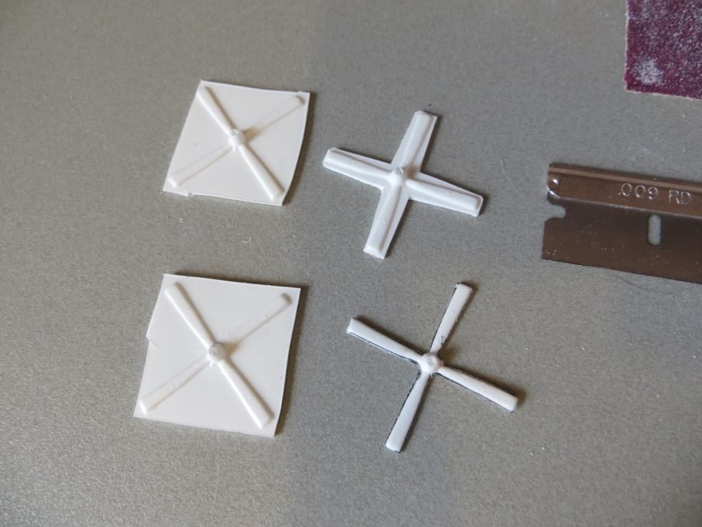

With the vac props, you just sand away everything that is not a prop? Do you do any thing else other than shape them. My Boeing B-9 kit has the vac props, so I was wondering. The other vac kits on which I worked had metal props.
Jeff
KitMaker: 6,954 posts
AeroScale: 6,239 posts
Posted: Friday, March 06, 2015 - 02:05 AM UTC
You may find that you need to fill in the rear of the blades with epoxy putty to give them a little thickness, especially if the plastic is thin and flimsy. Otherwise yes, just sand away everything which doesn't look like a propeller
Posted: Friday, March 06, 2015 - 05:15 AM UTC
I welded styrene half-round strong backs on to the backs of the blades, and sanded them down a bit toward the tips. the solid disks had a cross filed in to them before welding.
this is quite sturdy. I'll do some more filling and fairing before painting.
These 1/144 scale blades sanded out completely flat on the back.
Sometimes the sanded out part will actually be concave on the back - ie., thicker than the sheet. In that case you can weld in half-round with the round part in the groove. If you flood the groove with solvent, you can back-blade with the tip of the exacto knife, and sculpt the semi-soft styrene filler material into a fair shape before it sets up.
