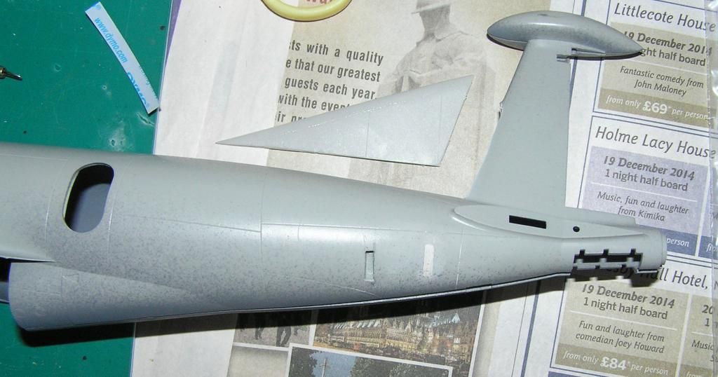

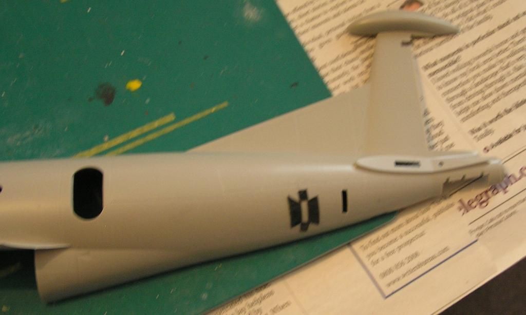

Time for a progress report, methinks! The Nimrod is proving to be slow work, but I am determined to do this huge kit justice. Since the campaign started, I have acquired Eduard's PE set for the exterior, as there are a lot of useful grilles, windscreen wipers etc. I really couldn't see the point in getting the interior set, as you will never see the inside anyway. At the moment, I am working on a few minor corrections that need attending to before I seal the fuselage up. Firstly, a slot near the tail is too far aft, so needs moving forward and down a little:
In this second shot, the slot has been moved to the correct position, and the original slot filled and sanded. Also, the fin fillet in front of the tail has been removed on both fuselage halves, ready for a resin replacement as you can see here.

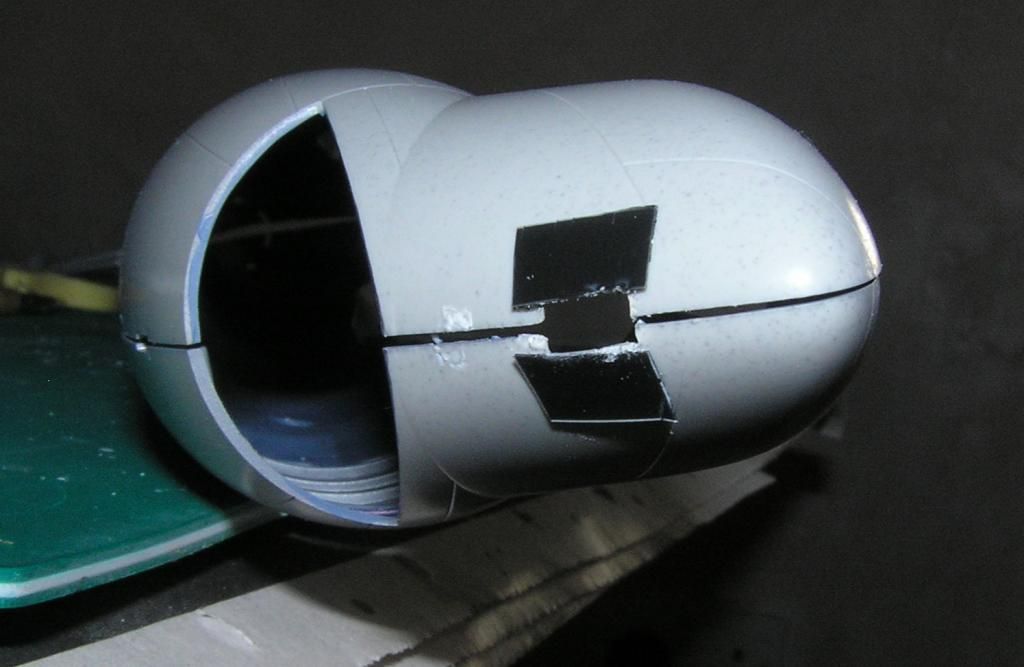

Next, the nose light aperture is too high, so I have opened up the gap further down, and will be filling the upper space with plasticard.

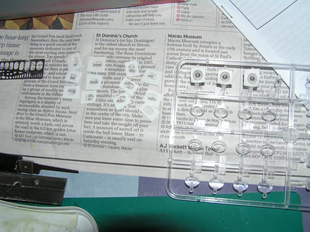

All the fuselage windows, emergency exits and observation domes sit too proud of the fuselage when fitted, so today's job has been to cut out plasticard shims.

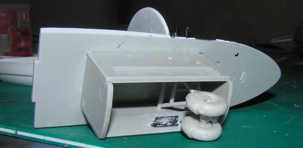

Here, the nose gear bay has received some attention. The Oleo has been shortened, and replaced with brass tube, the wheels and wheel guards have been replaced with Alley Cat resin items, and a pair of PE blade antenna have been added.

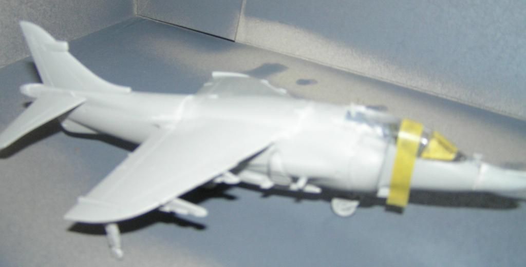

While all this has been happening, my other build, the Harrier GR.3, has moved on apace - the build is more or less done, I'm just masking up, ready for priming - please excuse the terrible photo!

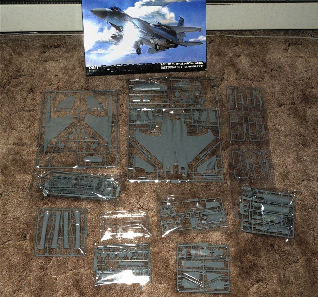

Well, I bit the bullet and upped for this campaign. Being an American, I opted for the iconic F-15C single seat fighter aircraft. The model is the new GWH 1/48 scale F-15C.
Present plans are to build it mostly box stock with just added homemade details where needed. But from the look of the kit, not much has been left out. My current building philosophy is to detail just what can be seen as the model is displayed on a base or shelf from a foot or so away.
I do have a Legends Aces 11 ejection seat, but I'm planning on seeing what I can do with the kit seat and some PE shoulder harnesses and seatbelts.
Below is the mandatory picture of the kit. Just about every plastic sleeve contains more then one sprue tree. Honestly, I've never seen so many parts before for a 1/48 scale single aircraft kit.

Lee,
The Nimrod is really looking quite good. I do appreciate the small corrections as much as a few larger ones, as they tend to help define the overall build rather then just concentrating on one or two areas.

@Lee - Good going on the Nimrod. I like seeing alterations to incorrect kits; there's a real educational element in this type of effort.
