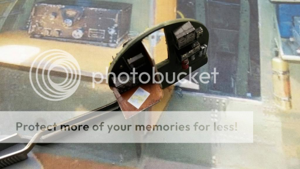

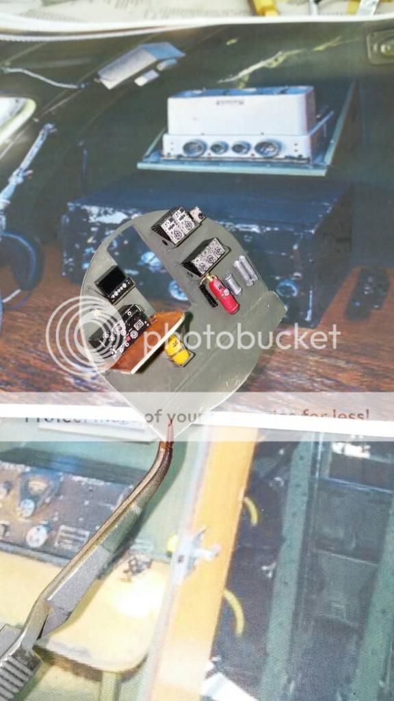

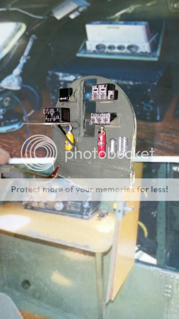

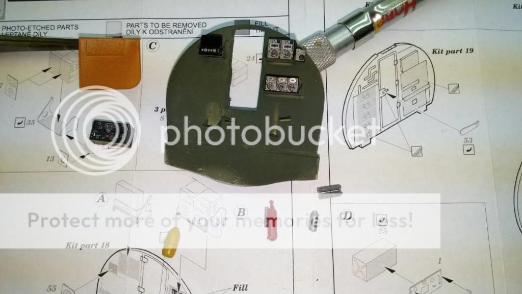

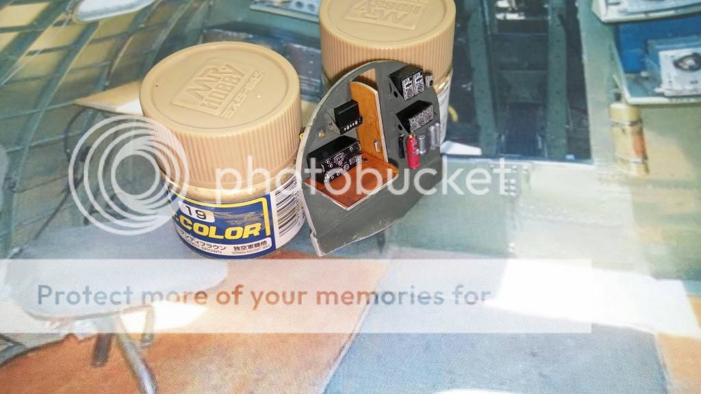

RADIO ROOM FRONT BULKHEAD: ALMOST DONE
The only thing left really at this point is painting the door and gluing it in the open position. Here are two views of the work so far.
When I get the door done and installed I'll show the completed part in comparison with the Monogram kit part, which is what this resin bulkhead is supposed to mimic.
Below is a better shot of the lower background picture that is the backdrop to the build bulkhead above.
I like the floor here! I have decided to paint the floor in the model in aluminum, but there will be segmented nonskid over the central door in the floor. [This leads to the belly camera that takes bomb strike shots, and to a large nest of oxygen bottles to port. And NO, I'm not opening that one, no way, no how.]
The other thing I will do on the radio room floor is glue segmented rectangles of painted sheet styrene that will look like a light series of plywood floor coverings, as in the above picture. It will break up the area, and look pretty good, I think.
But before that there is the little matter of returning to the bomb bay and finishing it.
Ah, did I say before that the next 17 I build (a G model) will be with the bomb bay closed and all other doors leading to it closed too? Doing one of these open is enough for one lifetime. Trust me on this!

Another fine lesson in modelling Brian ! The wireless and the extinguisher looks almost operable.
Redhand
Posted: Tuesday, November 18, 2014 - 09:06 PM UTC
Thank you Bernd. There were, of course, the usual frustrations with tiny parts dropping on the rug, manipulating things with tweezers, etc. but I do like the radios.
The fire extinguisher is a donor part from the AM Vindicator kit. The black horn off to the left was originally on the Monogram bulkhead. I simply cut out that section and sanded the rear flush, then bent some wire to join it to the extinguisher.
Same with the drinking water dispenser to the right of the extinguisher. Cut it out and sanded it flush at the back. The things to the right of the water dispenser are supposed to be drinking cup holders. They are also from the Vindicator kit, and match other "cup holders" to the right of the top turret.
I am going to try and get the door done tonight.

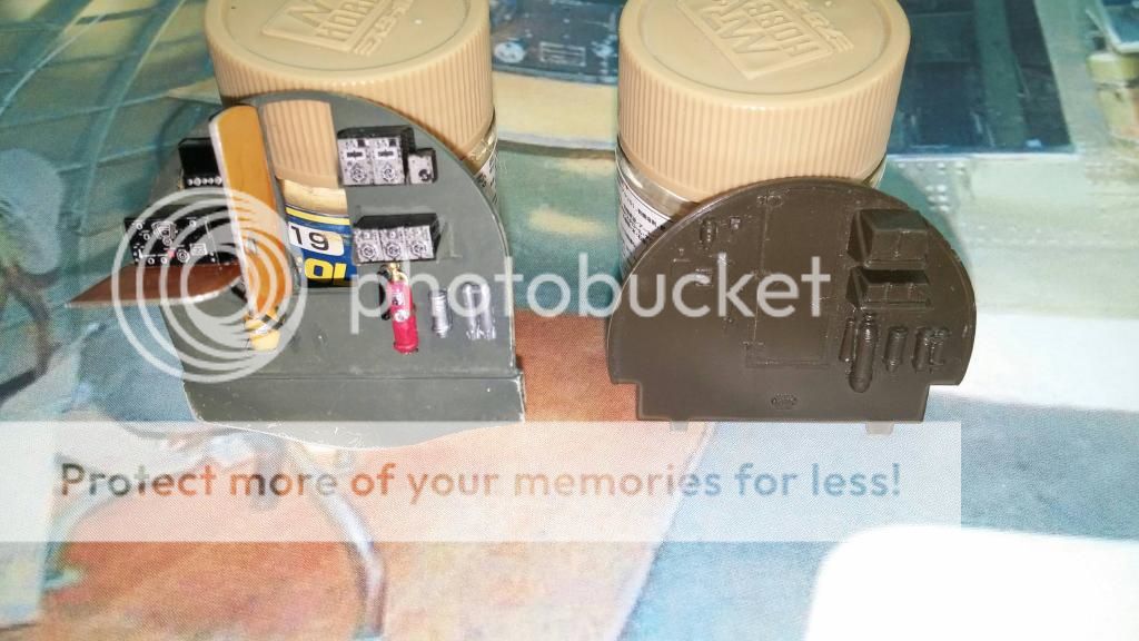

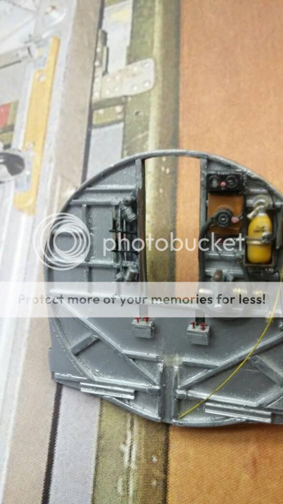

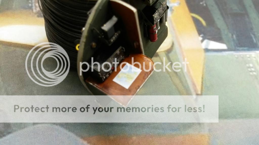

RADIO ROOM FRONT BULKHEAD: COMPLETE
Well, here it is with the door attached and the B-17G kit part for comparison.
And here it is from another angle.
I will say that I'm happy with the viewing possibilities that the open door will afford to see into the bomb bay from the open radio room hatch. That will give some real "depth" to the completed build!

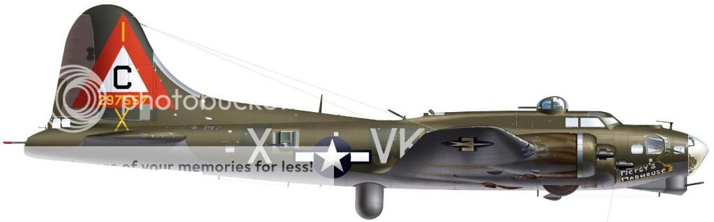

Dragon164
Posted: Wednesday, November 19, 2014 - 07:32 PM UTC
Brian,
I found this:
http://www.8thafhsoregon.com/archive/Oregon-Chapter/Lawrence-Fick/Middlebrough-Gee-Map-Feb-1943.jpg
from here:
Excellent work so far!
Cheers Rob.
I found this:
from here:
Cheers Rob.

The differences are like night and day. The kit parts look like a bad toy. Yours looks like a true miniature.

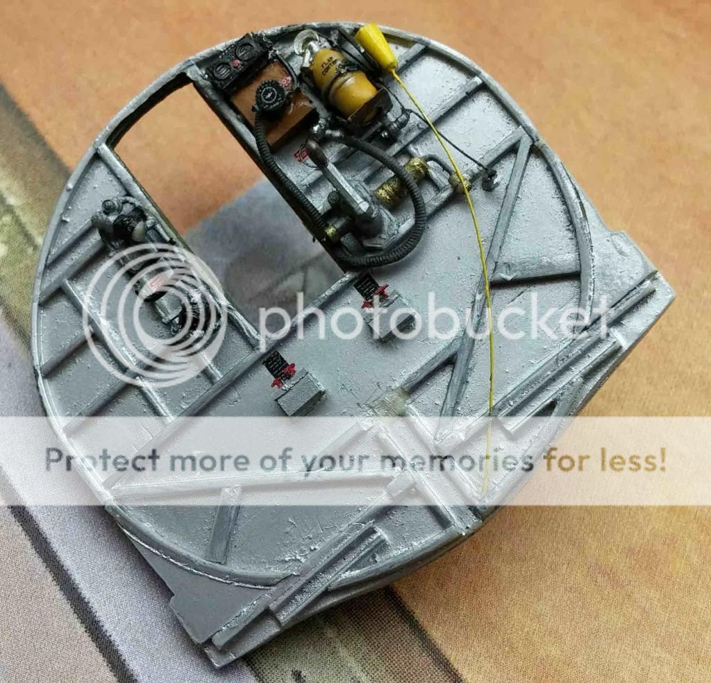

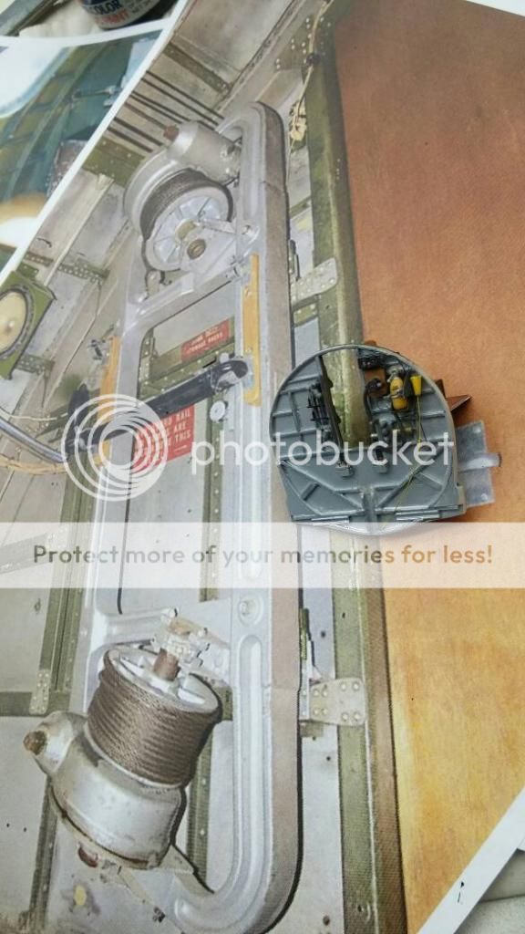

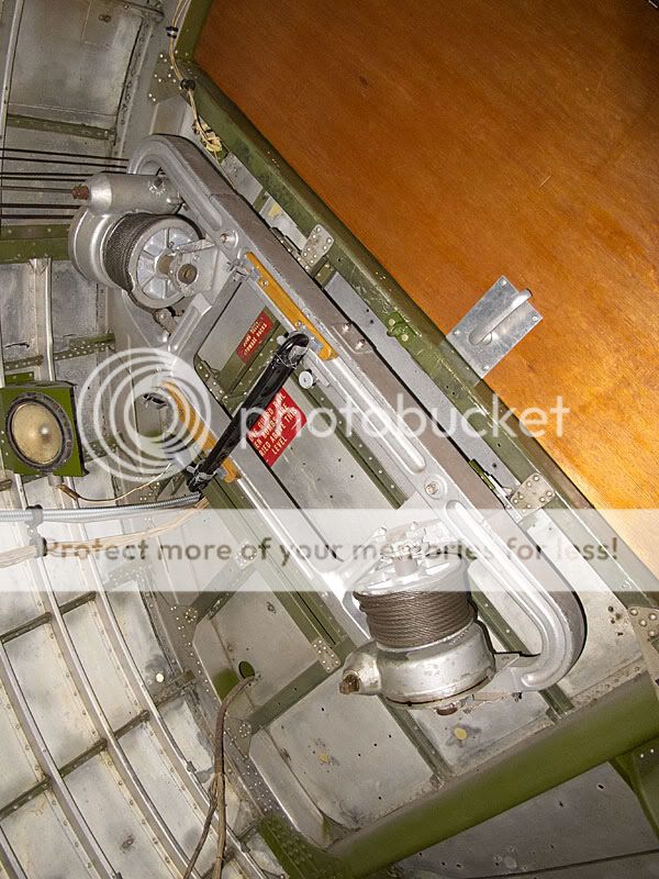

Of greater significance to me is the bomb hoist on the after bulkhead. See real thing below (again):
And here is my "get it over with" scratchbuilt version with wire, some styrene bar and bits and pieces from the True Details connector sets.
"Not my best work," but the dimensional outlines are correct as are the major parts, if you look closely. But the point of this is that one will NOT be looking closely. The only way it will be visible is through the open bomb bay doors looking up, and there the view is constricted. I decided to add this because (1) it is a genuine wartime B-17 fixture and (2) it does add an element of balance to the after bulkhead, what with all the stuff off to the right. So it's a "build for myself" part.

BOMB HOIST TAKE 2
I suppose when I write "I build for myself" it really means I am unhappy with the finished work. Anyway, I really hated the first bomb hoist I made and popped it off the bulkhead. I made a second one using different materials and techniques. This one is acceptable IMO, though I will tell you that few things have aggravated me more than putting this subassembly together. I lost no less than two motor and wire drum assemblies to the carpet monster.
Anyway, here it is. Now it's glued on, I hope never to touch it again.
The big picture:
A close-up:
I'm going to take a short break, clean up the desk and then press on.

Posted: Monday, November 24, 2014 - 02:02 AM UTC
Brian,
The bulkhead looks great, as does the new and improved winches. Now go clean your desk. My son's room is cleaner, and I thought that was not possible.

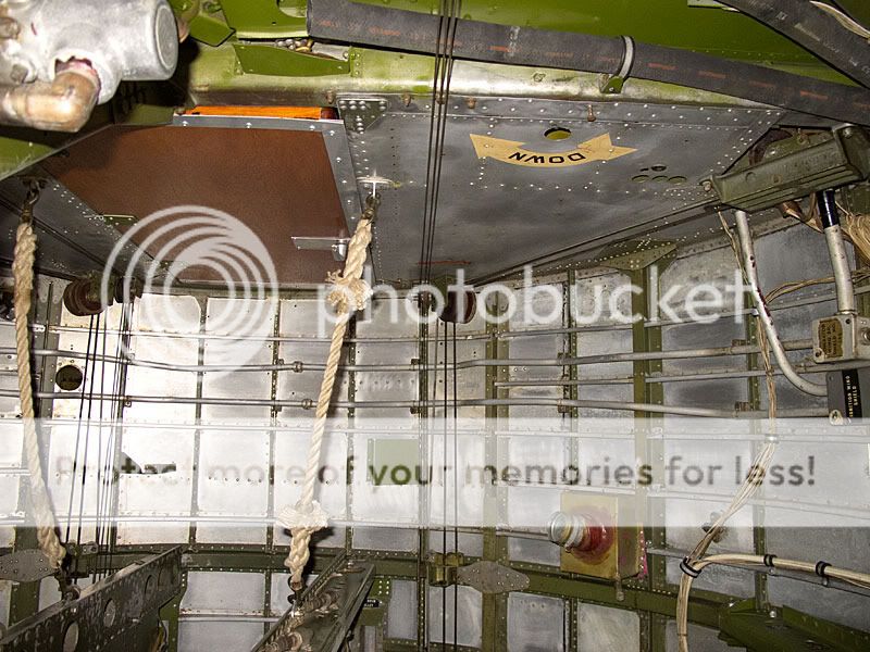

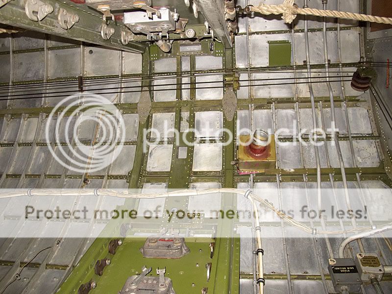

BOMB BAY SIDES
Happy Thanksgiving to those in the USA and Happy Thursday elsewhere. I cleaned the work table and am about to start on the bomb bay ceiling and side bulkheads. But first, a look at what I am modeling.
Best source is this shot from the B-17F pilot's manual:
Note that the space is almost assuredly metallic. I'm opting for aluminum on the fore and aft bulkheads (as you've seen) and the bomb bay door interiors. However, these shots of the interior of the unrestored "Memphis Belle" suggest a grey on the side bulkheads. What I'm going to do to do is leave the resin parts in the Tamiya primer grey that comes in a can. Looks "close enough" for me.

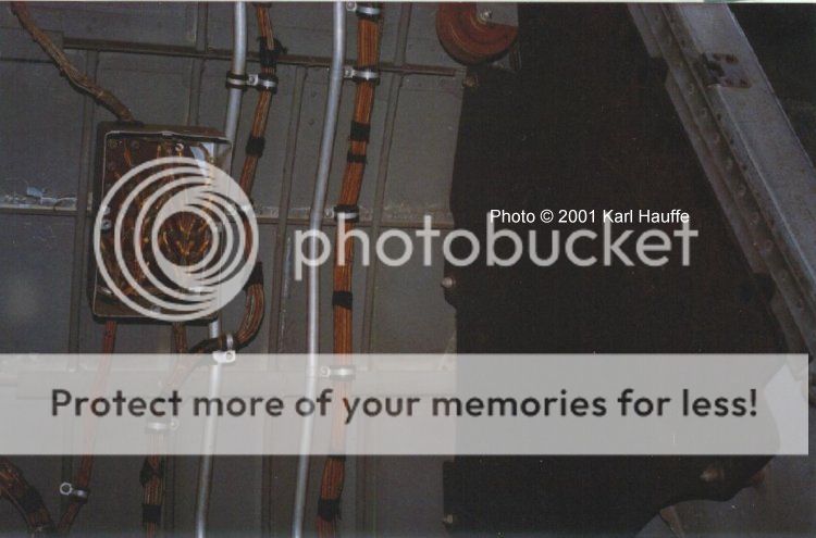

You can also see from the above pic that there is a ton of crap that goes forward. On both sides, unfortunately. That plus the overhead
is what I will be tackling first. I hope to have a build post later today.
