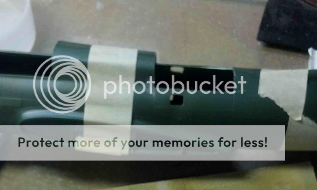

Well, I made my trip to North Carolina to visit my modeling friend (he wishes to remain anonymous) to get some "out of my labor grade" help on the B-17F radio room hatch cover details and U-shaped gun bracket; and some help on the exterior details of the early Sperry ball turret on "Luscious Lady": the one with the rounded sides. He and I also discussed detailing the ball turret interior. As you will see in my next post, he literally "opened the door" to that possibility.
The trip was a smashing success and I learned a tremendous amount. So I will walk you through the progress made now. This post deals with the radio room hatch and U-shaped gun bracket.
I was concerned about taking the actual fuselage I'm working on so took the Revell of Germany B-17F kit I have instead. You will immediately recognise it from the dark green color of the plastic vs. the OD of the older Revell issue.
You will also note immediately that one of the first things we did was decide to cut open the radio room roof (like the cockpit roof) so that we would have a template to measure the coaming and internal hatch-ceiling structure.
We started with some thin stainless steel sheet he had for the coaming around the rear hatch, because it can be cut just like styrene with a #11 blade, a ruler and geometric templates, and for a while it looked great. Note also that he hogged-out the deflector bay base. (Aluminum foil or styrene bar stock will clean that up later.)
However, the material proved too pliable and prone to creasing and bending when we tried to add strips to build up the coaming sides, and after almost a full day and evening messing with the metal we were forced to admit that styrene was probably a better choice.
I was beat that evening after a long drive and went to bed around midnight but my friend said he wanted to "study" the problem some more.

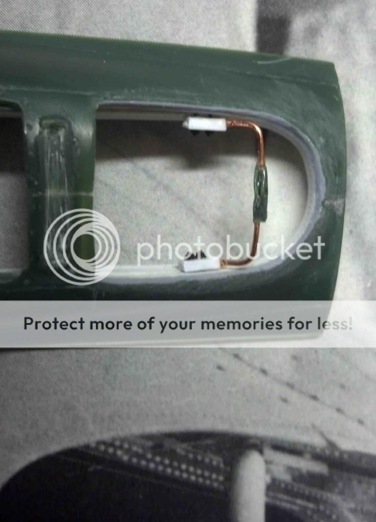

When I woke up next morning this is what greeted me:
You can even see where he put rivets in the border of the coaming like the real thing had! Note also that there is a pair of sliding rails for the U-shaped gun bracket.
The Pièce de résistance was the gun bracket itself. A picture is worth a thousand words.
The center part is the diamond shaped center of the kit part from which the straight edges of the part extending to each side have been clipped and bent copper wire substituted. (He even put a longitudinal cut to the diamond to simulate the fact that it actually is two plated enclosing a ball and socket swivel). The sliding brackets are just styrene bar stock, and the securing nuts come from his supply of HO "railroad bolts."
Here is the after hatch opening with the gun bracket test fit before sanding away the grey primer at the coaming edges. The fit is so good that it actually slides fore and aft on the rails!
And here is the completed subassembly compared with the real thing:
Needless to day I was quite pleased as Day 2 came to a close.

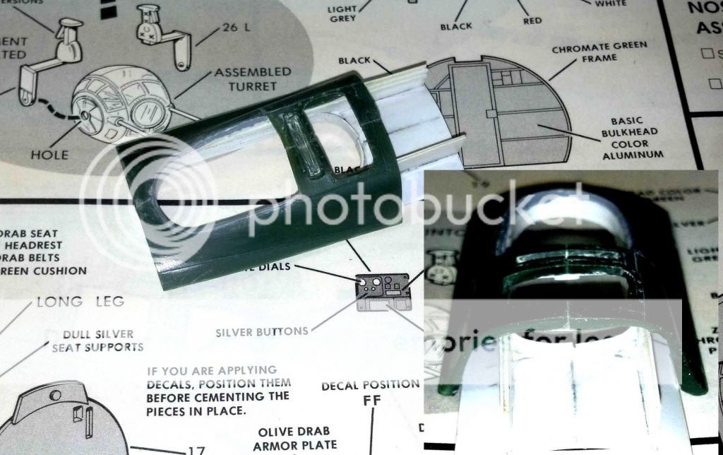

This is a brief update on my work on the top turret. Below you can see a collage of modified turret parts, mostly from thr Monogram G kit, against a background photo showing the rear of the Sperry K-3 gunsight, and an inset showing some gunsight detail.
You can see how I modified the shapeless kit gunsight -- from the rear. I didn't realize until the picture was taken that the data plate was a bit off-center. I will replace it with a smaller decal later, and also show you what the front and top of the sight look like after modifications.
Going back to the main picture, I removed the center from the top turret ring, where the guns, gun feeds and sight were. The resin gun bases pictured are from the Verlinden set: I already drilled out the holes in front for the Karaya metal barrels and blast tubes.
Next, take a look at the unpainted turret dome and compare it to the real thing, which is the last picture in the prior post. This part is from Bill Koster's excellent "B-17F Nose Job" set. It doesn't look like much unpainted, but when you compare it to the Revell kit part in the picture -- the one I built in the 1980s -- you can see how very different it is. Here is a better picture of Koster's work from his instructions. If you want to do an accurate B-17F, the Koster part is a must!
To free the dome from the vacuform backing, I cut it out leaving a 1/4 inch border around the edge. (None of that scoring at a 45 degree angle around the base for me: too dangerous.) Instead I put the part on a flat sheet of 320 grit sandpaper and sanded the base away with a light circular motion. After a while it thins to the point where it just cracks and falls away from the part. I do like this method.
