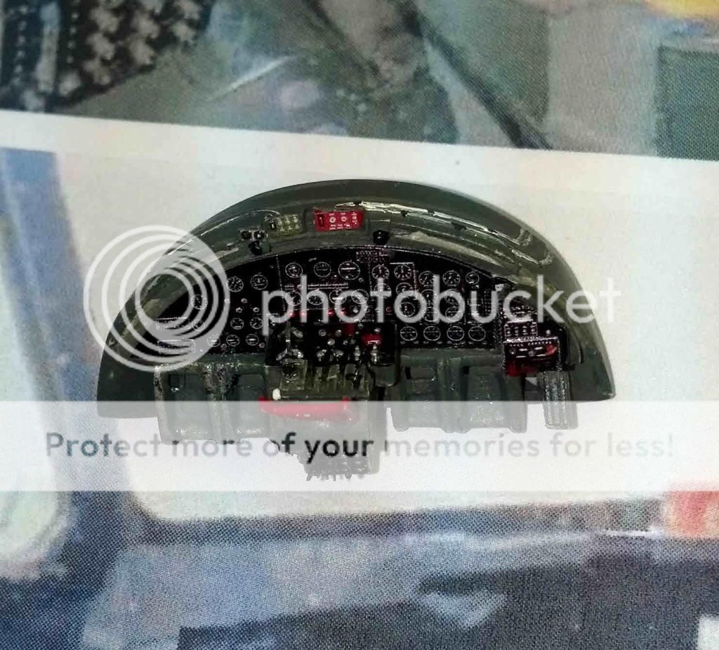

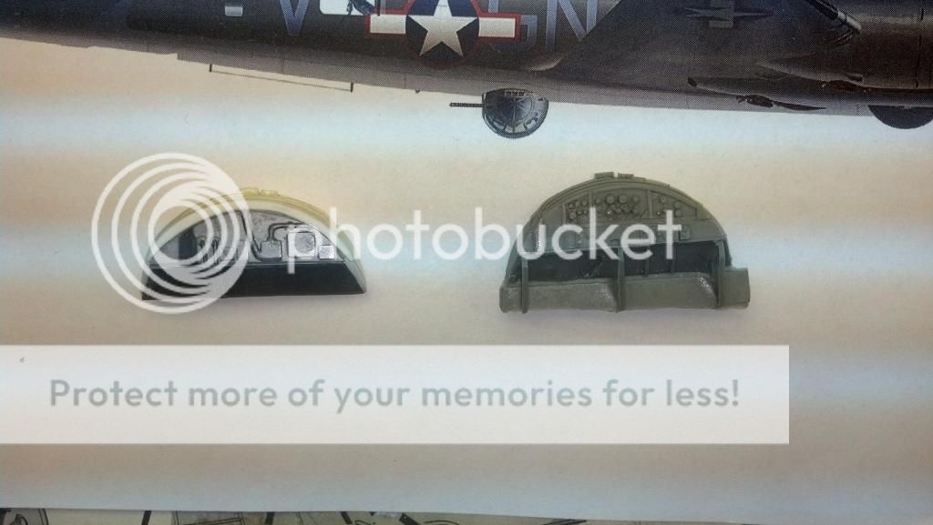

Building the Cockpit, or "When measure twice, cut once, doesn't always work."
At the outset let me say that this part of the build is reason enough for me to stick with the "advanced journeyman," or "knows just enough to be dangerous" label. I had to re-do many things, and at one point when going backwards asked myself, "Are you losing the build?" But more on that later.
Here's what I started working with: The True Details B-17G cockpit (TD set) and the Eduard Brass set. Let's look at the TD set first:
How I planned to integrate this into the Eduard Brass set can be seen below.
The idea was to cut out the tunnel access doors from the Monogram kit floor (what I call the "basement doors" because they look like old-timey exterior basement doors, see below)
and place that in the TD set hole between the pilot seats to close it off, just like I cut out the Monogram curtain at the rear end of the navigator's compartment to close off the hole there. I wanted to do this, because I preferred to use the Monogram pilot seats and Eduard brass to the TD set parts.
Suffice it to say this was not a linear process! But let's get started.
I begin with the TD set instrument panel. I used the white resin part to left, below
Yes this is also the heavily modified rear navigator bulkhead.
If you look at the white resin instrument panel view above you will see that one can't just pop in the Eduard brass instrument panel. Much has to be cut away from the TD part (compare the grey instrument panel above to the modified white resin one) but ultimately you can get there.
This interim view of the instrument panel is a bit of a mess still, true "work in progress" (WIP):
Before it was finished I had to detach the throttle pedestal, re-do the throttle controls using styrene stock, correct the t-handle installation at the far right of the instrument panel, and last but not least, detach the rudder pedals (cut out from the Monogram instrument panel part) and heavily sand the tops and bottoms so that it would fit against the floor.
(Let me digress. The Eduard brass set contains an incredibly fiddly set of rudder pedals, but I had had a nightmare using a similar design for their cockpit set in the HC P-35A kit, and decided it wasn't worth the pain.)
Ultimately the instrument panel, throttle pedestal and upper floor looked like this, and it is as good a place as any to end this post.
