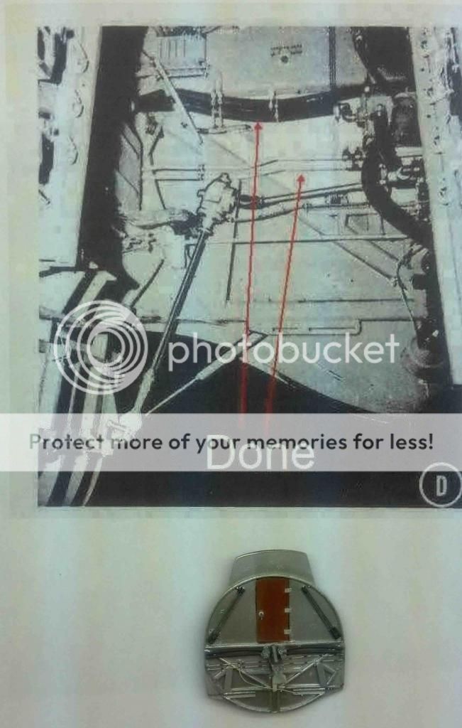

FINISHING UP THE TOP TURRET AND COCKPIT ROOF
Well, the Cockpit is 99% done. The first three pictures show what I added to the top turret, and how the cockpit roof glass looks from the exterior.
The principal additions are the silver wire from the front of the turret to the left side of the K-3 sight, and the two on the right leading over the sight, which terminate underneath the top behind the turret controller.
On this close up you can see a small electrical wire from the front center of the K-3 sight running under the large wires to the right. This I believe is a power connection.
Finally here is an overhjead shot showing the turret top in the roof apetature with he glued-in windows forward.
I was happy with how the glass came out, seeing as I used crazy glue!
Next we go to the cockpit roof shown off against Gil Cohen's painting about Second Schweinfurt, "Almost Home." Interestingly, the prints available for this picture bear 10 veteran signatures from that raid, and one of them is by the late Bud Klint, Luscious Lady's copilot on that infamous mission.
You can see that I dressed up the boxes with some spare photo-etched wire at the top left and bottom center right. If somebody sneaks a peak at the interior cockpit roof, they'll get a hint of the wiring. That's as far as I want to go.
Tomorrow I'll do a final shot showing two changes I made to the cockpit itself, and then it will be on to the Bomb Bay, though first I must cut the radio room roof out and fit-up the one I did with my friend in North Carolina. That's because the radio room ceiling extends into the space above the bomb bay. Gotta make sure there are no clearance problems!

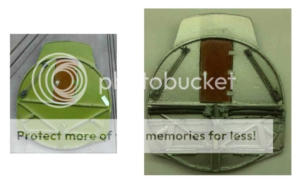

In the first you can see, just off the right front corner of the copilot's seat, that I added a long handle extending down to the floor. That's a manual hydraulic pump lever. Just ahead of it on the side bulkhead is some oxygen hose I added. It's kind of dangling to the floor, not the best housekeeping, but * * * I didn't want bare oxygen regulators.
Finally, in the right rear, I repainted the two cylinders the richer "foilage green" present on the turret. (They had popped off earlier and had to be cleaned up and re-positioned so they wouldn't interfere with the after starboard bulkhead.) I think the richer green makes for a nicer contrast, and is just as probable as bronze green.

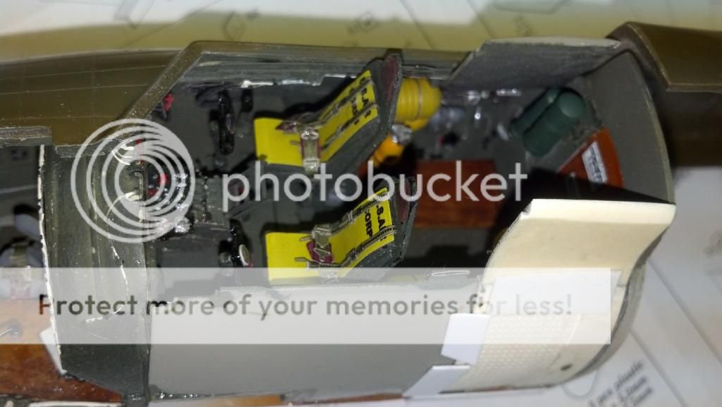

Below is a forward-to-aft shot of the cockpit with these additions, and after that a similar view with the roof loosely placed in position. Unfortunately, one really won't be able to see much with the turret installed. I'm toying with the idea of making the whole turret removable, but probably not.
This definitely feels like a milestone, BTW.

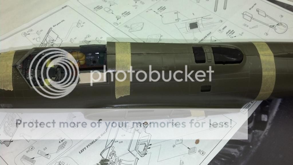

I remember what I'm about to show you from my build of this kit in the 80s. The fuselage fit ranges from marginal to horrible.

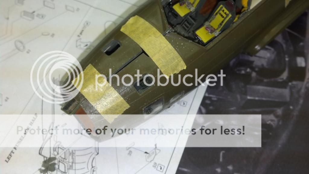

It is at its best near the tail, and gets progressively worse as one goes forward. The worst area by far is the nose, which just happens to me the immediate focal point of the model.
Here it is:
I think the solution will be filling the gap with bar stock. Alternately, I could squeeze the top shut and leave a gap in the bottom, but I don't think that will eliminate the problems topside. I am absolutely sure this is not due to any obstructions from the nose interior, but instead the result of built-in parts warpage.

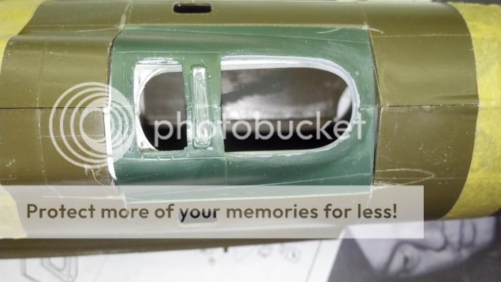

The fit of the roof over the cockpit isn't much better. Here you can see how the decking behind it also splits despite tape pressure.
I tried fitting it a while ago and getting the fuselage deck to conform to the roof part contour will be another challenge.
Here it is:

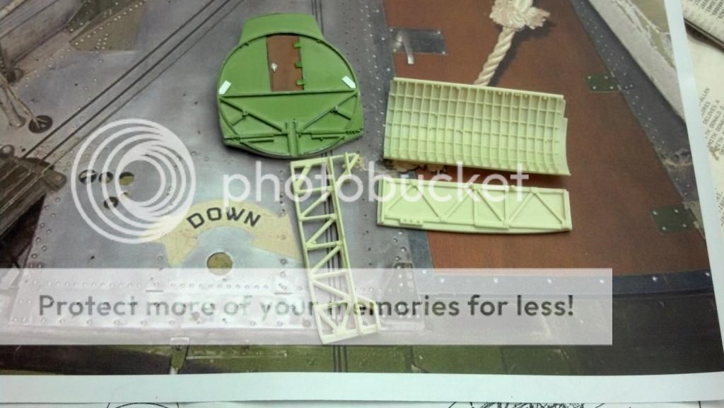

INELEGANT UPDATE
This is a warts and all look at the forward bulkhead of the bomb bay so far. It's one of these things best viewed from afar, through a gauzy lens, but my cellphone camera won't oblige.
I'm trying to do this A/C system by A/C system. The Detail Models set is itself no more than a skeleton of what the real A/C held.
Below pic is from the B-17 Pilot's Manual. The large black pipes at the top marked "Done" are from a complex fuel transfer system located in the bomb bay. I still haven't figured out what the smaller pipes below, also marked "Done" are: my guess is they are also fuel lines, not shielded electrical cables.
Below is an OMG comparison shot between the bulkhead as originally painted in "interior green" and how I am now convinced it appeared in real life: naked aluminum, with details in progress. More on my reasoning about the bomb bay colors later. For now I shudder at how messy the part is. My only defense is the the real thing was grungy as hell, and that digital pics of metal paint pick up absolutely every blemish.
Much more detailing to follow to obscure things further and distract the eye.
