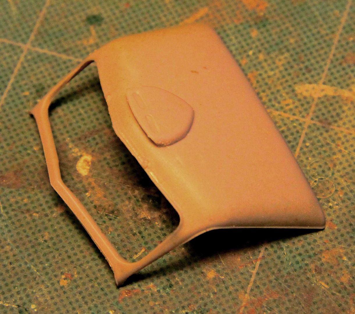

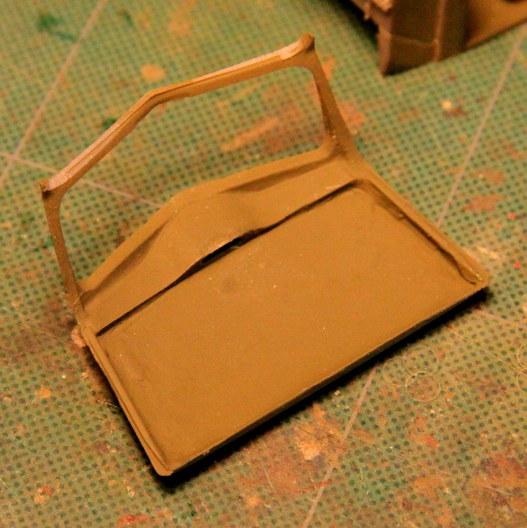

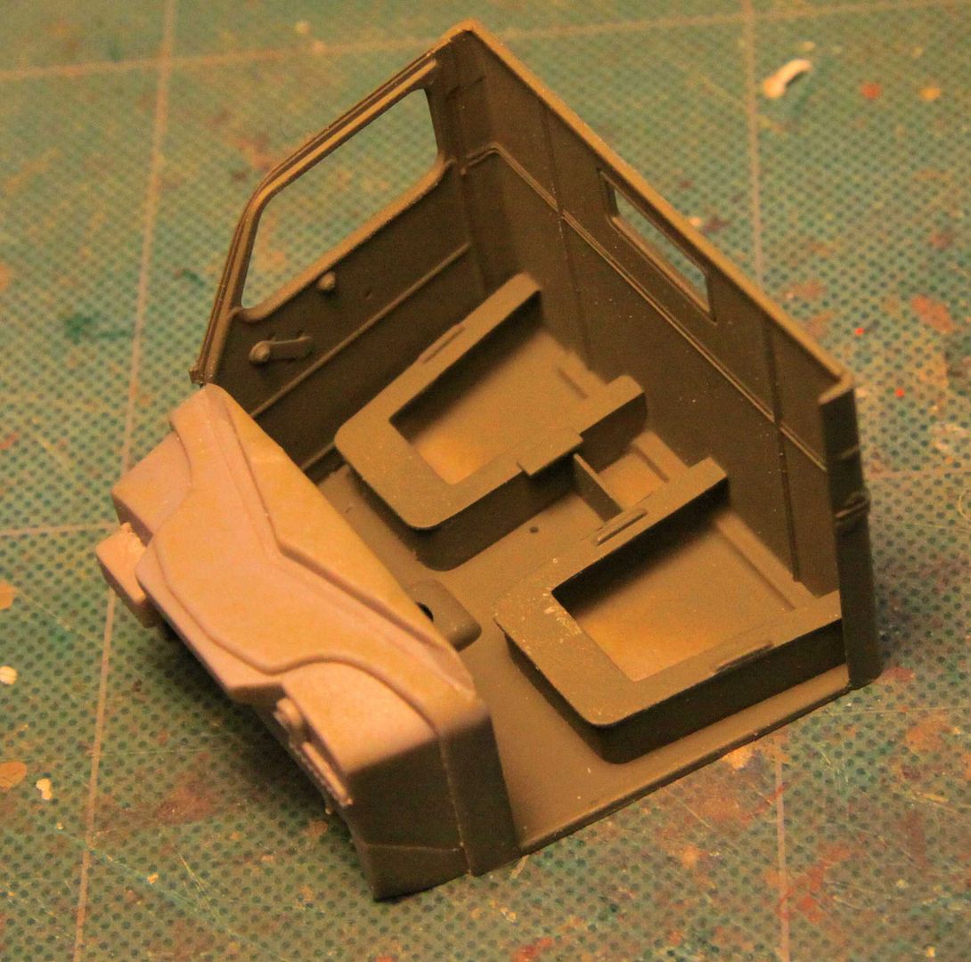

The hard cab builds up fairly easily! The fit is very good and everything is nice and square. One thing that really helps is that the base for the seat cushions forms a 90 degree gusset between the cab floor and the back wall of the cab. I suggest making this your first assembly step. Lots of glue can be added in this unseen area for a solid bond.
The underside of the cab roof is one of the few places where you will find ejector pins marks on this model. I filled these in with a light coating of body filler putty over the entire surface of the ceiling to easily hid these.

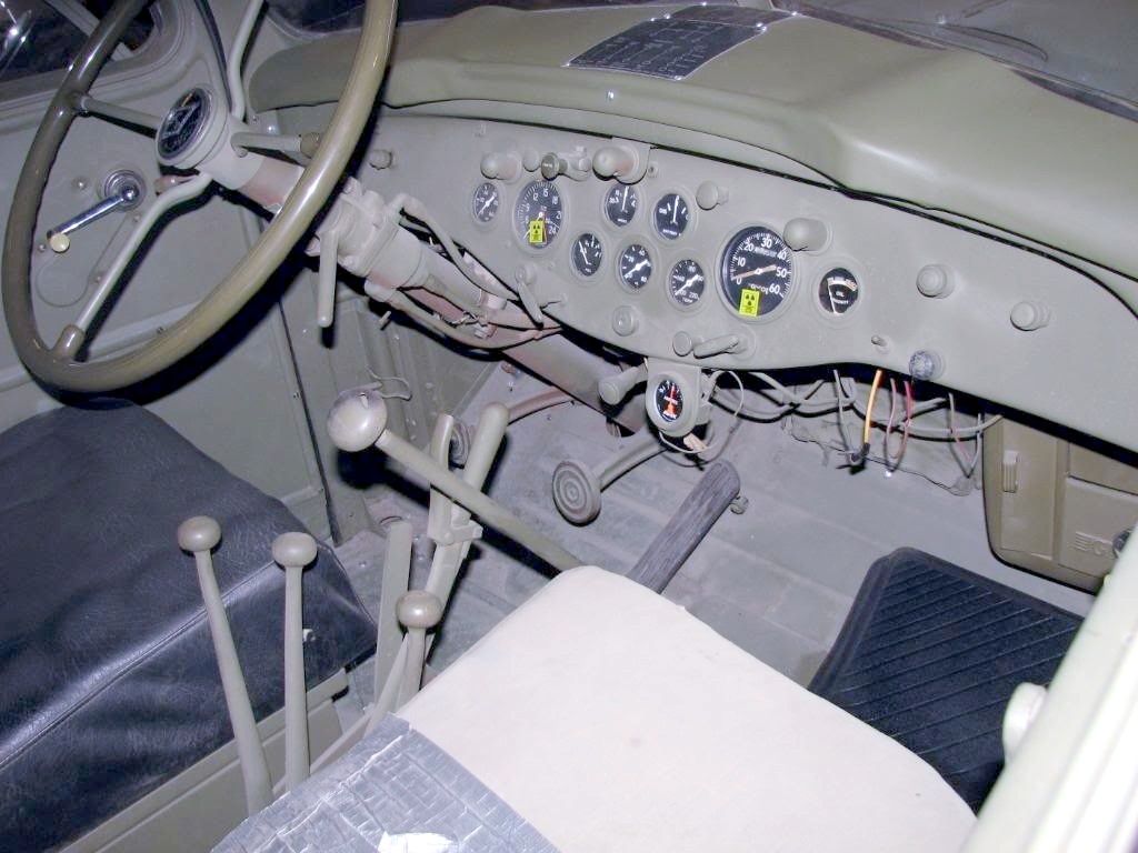

Note location of assorted data plates, ventilator damper in ceiling of cab, (open oval cut out is glove box) and the four equalizers needed to support the two-part opening front windshield. (As far as I know the hand cranks to open the front windshields were limited to only the civilian Diamond T trucks.)
Additional note: Notice the lever handle just to the left of the auxilary gauge hanging under the dash. This lever operated the cowl mounted ventilation damper.

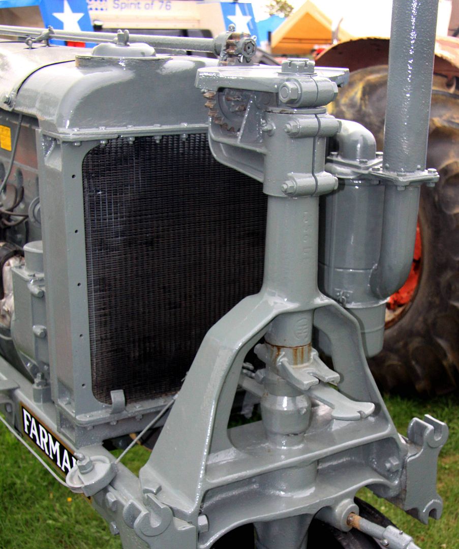

I forgot to mention; you should plan on adding some body filler putty to the vertical sides of the radiator structure. This piece is made up of three sections and just about the only way to create the one-piece smooth metal effect is by using putty and some light sanding.
Above I am showing a similarly constructed radiator on a restored 1937 Farmall tractor.

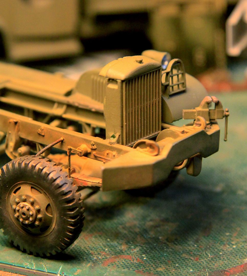

One final look at the T's weathered frame before I add the front fenders, gas tanks and running boards. I use pastel chalks for weathering and rarely use a setting overspray because the overspray kills too much of what I consider to be a very pleasing dusty effect.

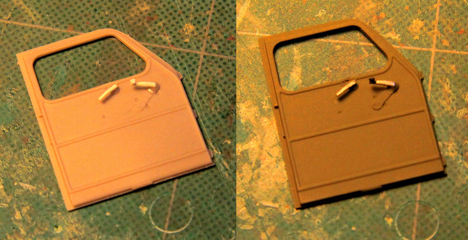

Mirror Models suggested representing the interior door handles on the enclosed cab with short pieces of wire. I felt I could do better with small pieces of plastic:
Most photos of restored vehicles show the inside door handles painted O.D. but original construction photos show them as having been stock civilian chrome handles.
