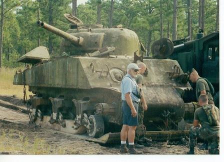

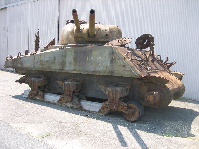

Heres about where I want to start Joe, these are two pictures of the M4A3 that was found in the woods at Quantico VA in the past couple years, only mine will be buried at angle covering the running gear with just the tops of the drive sprockets showing above ground.
I'm hope'n to try the hair spray thing, but I'm alittle leary of it even though I've seen great results from it.
