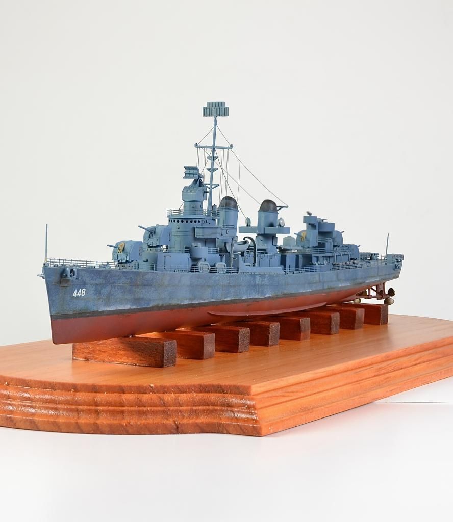

I've finally reached the main point of this build - the weathering. As I mentioned at the start I struggle with this area and chose to focus on it with this build (along with improving my rigging). So with that in mind, all suggestions are welcome.
I started by adding a brown pin wash all over the model. I didn't like the look over the blue paint but couldn't think of a better color to use. What do folks normally use for a blue-painted ship?
Next I went to work on the starboard side with oils to create staining along the boot topping, rust streaks, etc. I also added some random areas of blue to try to add life to the paint. For those who have used the AK Interactive products for ships, what do you think of them? I've held off on buying them because I have zero experience with enamels.
Finally, I couldn't resist getting started on weathering the deck. I've only done a small area at the bow using a combination of grey oil paint and MIG pigments. I think my general approach is fine but I need shades of paint and pigments more suited to naval subjects.
At any rate, here are some photos all input is welcome.

On my Fletcher build I used a brown oil wash too Bill, works fine.
Are you going to do any weathering under the waterline?

Thanks for the comments, gents. I'm generally happy with how it's coming along but I appear to have made the same mistake I always do - using too dark a shade of paint that only gets darker with weathering. The photos conceal this fact because they were taken under good lighting but viewed from 3-4 feet away under "average" light conditions I'm sure it will appear too dark. Does anyone else struggle with this - modeling for the camera versus modeling for the shelf?
Julian - I'm thinking about it but I'm not entirely sure how to go about it. Streaking from grime, salt stains, fuel leaks, etc. doesn't seem like it would carry below the waterline. Ditto for the sort of stains and discoloration commonly found at the waterline. Basically, I had hoped to address below the waterline with chipping earlier on ... didn't happen and I had to keep moving.

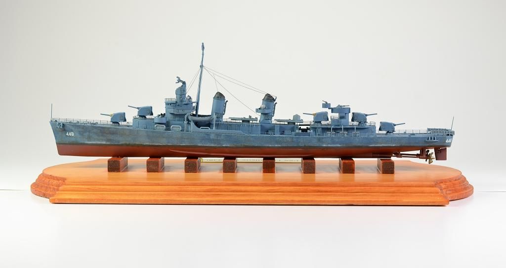

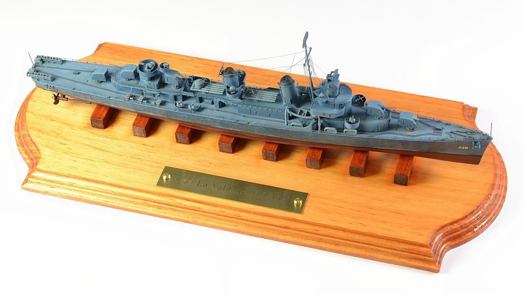

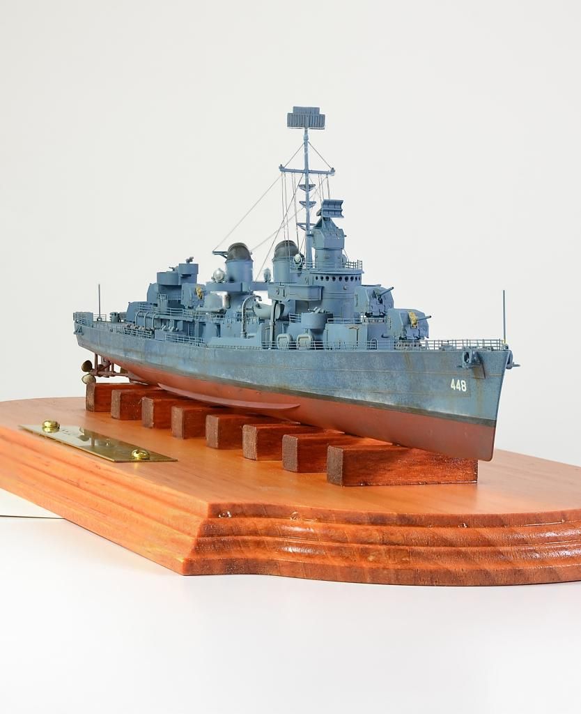

Wow, it's been more than a month since my last post. You know you're slacking when you have to search for your own build log. I had hoped to put up more progress photos but I guess DD-448 developed a mind of her own. Finished photos are below (all input is welcome) but here are my parting thoughts:
1 - The Tamiya kit is a great starting point for modeling an early Fletcher. It goes together easily, it's nicely engineered, and the instructions are near idiot-proof. Add an after-market detail set and you've got a really nice model. I just wish Tamiya produce a square bridge version.
2 - I challenged myself to weather this model more aggressively and I'm mostly happy with what I achieved. I'd appreciate input in this area. I was aiming for more discoloration, chipping, etc. below the waterline but that was my initial area of experimentation. When it didn't work out I kept moving. I received the AK Interactive DVD for Christmas so I'll be looking to that for ideas as well.
3 - I attempted a replacement mast out of brass rod and tube but I don't think it was worth the effort. First off, since I used sprue (which didn't put any load on the mast) the brass was overkill. Second, going with brass meant that I had to cut off and reattach all of the small mast details. I ended up with a slightly wonky mast for no real gain. Ugh.
4 - I had a tougher time than expected with the railings. In part this might be because I attached the deckhouses to the model first (normally I don't). I also found the Alliance Modelworks PE to be very fragile. I'm not ham handed and I had a tough time handling it without deforming it. My main problem was dealing with a generic railing set. Maybe I need to go back to school but I struggle to measure and cut railings to length accurately.

Just some ideas from my personal experience with ships weathering and corrosion: The chipping in the WW2 ships occurred mostly in the bow area (up to the second turret in this case) due the water and wave pressure at high speeds.. In other areas the pain comes off due to touch of boats or when moored. in the most areas you have vertical streaks form grime, salt and rust, especially heavy under anchors.
In the waterline you have potentially horizontal oil streaks and underwater patches of barnacles and other growth which looks brown grey from a distance. You can look at Navsource for docked ships they have some colored pics.
Just my personal opinion, not criticism of your really nice work
