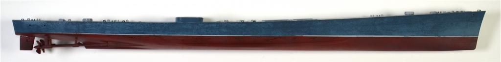

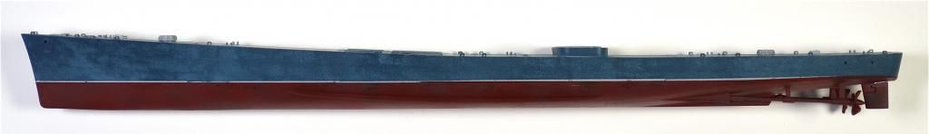

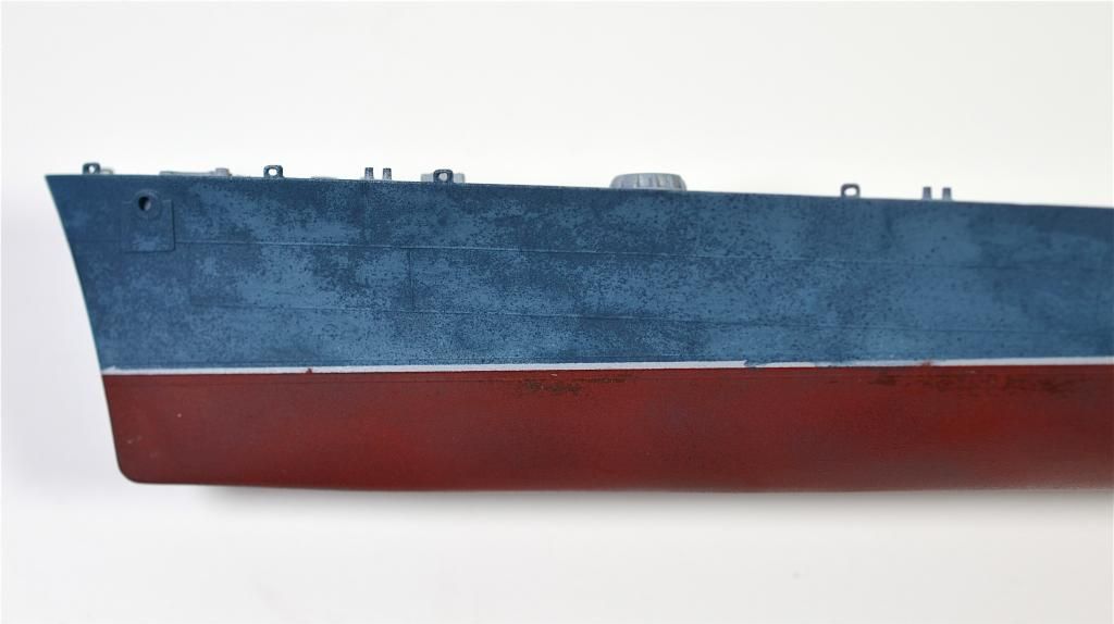

So more progress ... I sprayed the hull starting beneath the waterline because I figured that was the safest place to experiment with the hairspray technique. The first two times I made a variety of mistakes: Too much hairspray, too much water, and too much opacity in the top coat. On the third go round I still didn't get it right but settled for modest chips along the waterline. My primary self-criticism would be the lack of chips at the bow, but oh well, it's an experiment.
From there I moved on to the hull sides. Tamiya suggests the following colors for 5-N Navy Blue in a 1:1:1 ratio:
Royal Blue (X-3)
Medium Blue (XF-18)
Flat Base (X-21)
I'm not a fan of Flat Base so I decided to try my own formula. After a lot of testing the following colors in a 1:1:2 ratio are a close match:
Sea Blue (XF-17)
Flat Blue (XF-8)
Medium Blue (XF-18)
To replicate the faded 5-N Navy Blue in my guide photo I added Sky Grey (XF-19) for an overall ratio of 1:1:2:12.
The effect isn't exactly the same as in the photo of USS Jenkins, but additional streaking and fading with oils will blend the colors together. Also, I expect the effect will be very different when viewed on a shelf from 2-3 feet away. So here are a few photos:
