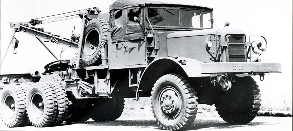

Posted: Thursday, December 17, 2015 - 05:34 AM UTC
Fellow modeler Alex Hill* did a masterful job on his Mack NO, starting with the Azmuth resin kit and adding and/or rebuilding literately thousands of parts on the vehicle.
Here below is an image of the Azmuth front axle with Alex's hand made front axle gearboxes:
* I have tried a number of times to track down Mr. Hill on the internet. If anyone happens to know this modeler please ask him to contact me through this Armorama thread regarding the Mack NO.

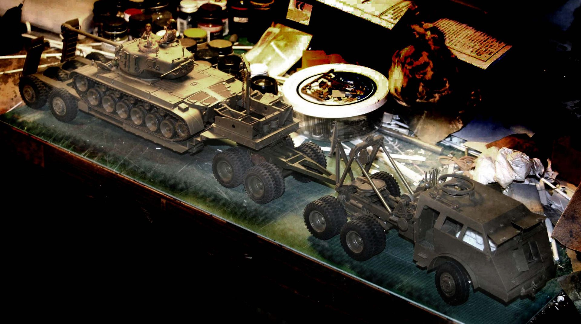

Posted: Sunday, December 20, 2015 - 11:00 PM UTC
Gotta build em both, plus the trallier!
One problem though. You need two rear differentials for the Mack, since it is not chain drive. The DW Recovery only has one! I was lucky enough to find a junked DW on eBay but you could probably clone one of your own since you have a good one to go by.

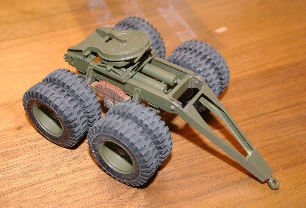

Posted: Monday, December 21, 2015 - 06:10 AM UTC
A brief F Y I: post war they had a two axle dolly for the DW trailer. Used the same wheels and tires as the DW. This way any heavy tractor could pull the trailer. My point here is to build the DW tractor as the recovery vehicle, also build the stock trailer and use the dolly to allow the recovery tractor to still pull the trailer. You then have the best of all worlds!
p.s. I found out too late that this dolly actually had four smaller leaf springs, two per side and NOT the one big spring on each side as shown here!
Posted: Monday, December 21, 2015 - 10:53 AM UTC
As you can probably tell, the dolly is made up of the rear section of the DW frame and uses the standard DW fifth wheel. The leaf springs are scratch built as is the front drawbar. The air tanks have been cut off the forward part of the DW frame and relocated here.

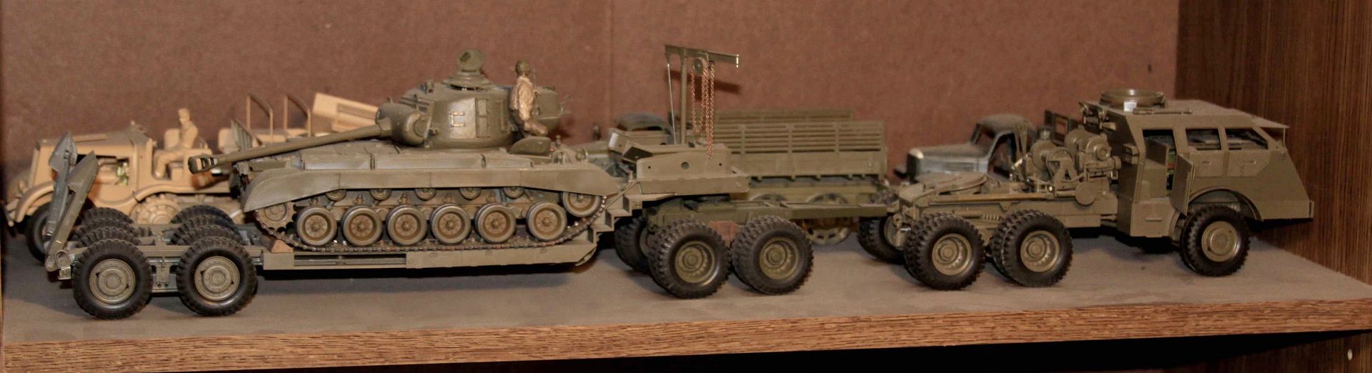

Posted: Tuesday, December 22, 2015 - 05:32 AM UTC
This big rig has been sitting on the shelf gathering dust for many moons, not quite finished.
When finished the recovery frame on the tractor will be raised. As you can see this crew is using the M199 dolly to allow them to still pull the recovery trailer even though the fifth wheel on the tractor is blocked.
In the background can be seen an 18 ton Famo, a GNC Deuce and a Half converted to a British railroad locomotive, and a short bed International 2 1/2 ton truck all under construction.

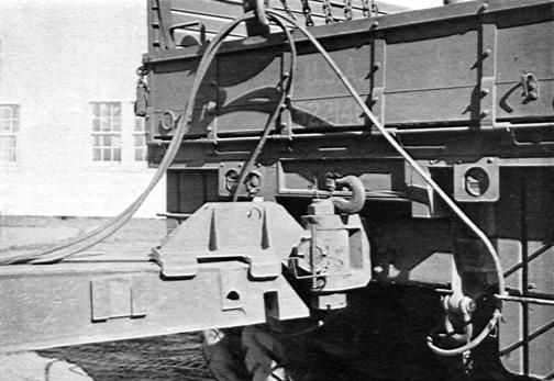

Every now and then, usually when searching for something else entirely, you come across photos that while never seen before still seem very familiar . . . .
Mack NO with unique Mack designed hitch allowing the gun trails to be connected directly to the vehicle without the use of a towing limber.
