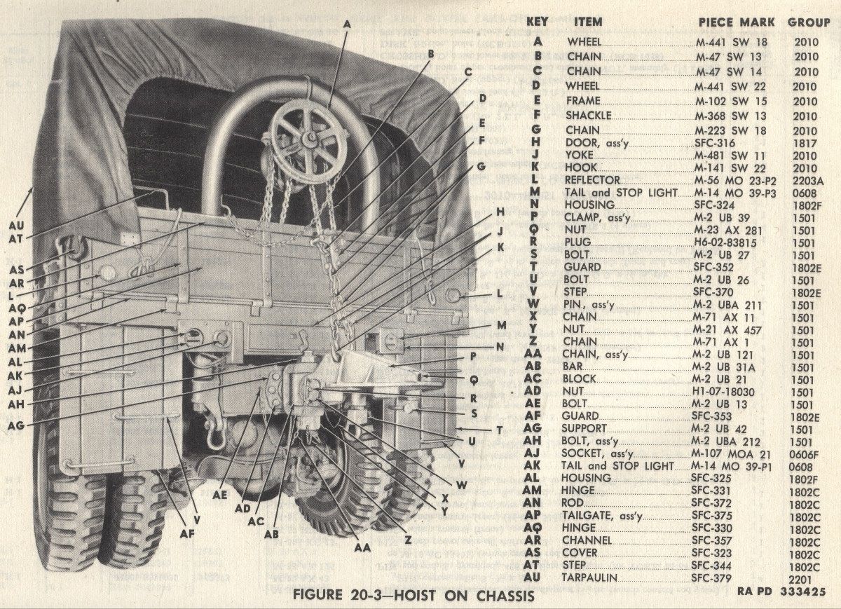

Semi-scratch built chain hoist. Large pulley wheel is from Dragon Wagon trailer kit. U-shaped gallows beam is bent section of aluminum toilet float rod which was previously serving as my gun cleaning rod.
The chain hoist was employed to lift the heavy gun trails onto the custom Mack hitch.
Posted: Wednesday, October 16, 2013 - 01:53 AM UTC

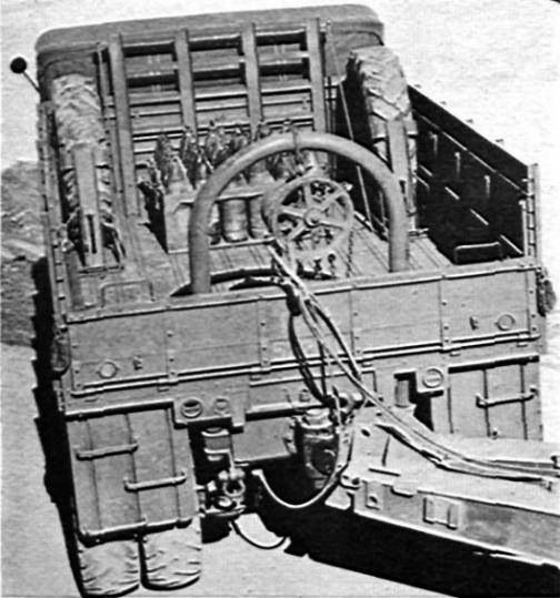

From the Tech Manual:
Rear view showing both the Mack designed heavy duty hitch/receiver and the towing fixture for the 155mm and 8 inch guns.
The above image comes from the collection of EASY 1 Productions - From the disc entitled "TM 10-1679; 7 1/2 ton 6x6 Prime Mover Mack NO"
Follow them on Facebook at:
https://www.facebook.com/Easy1CD/

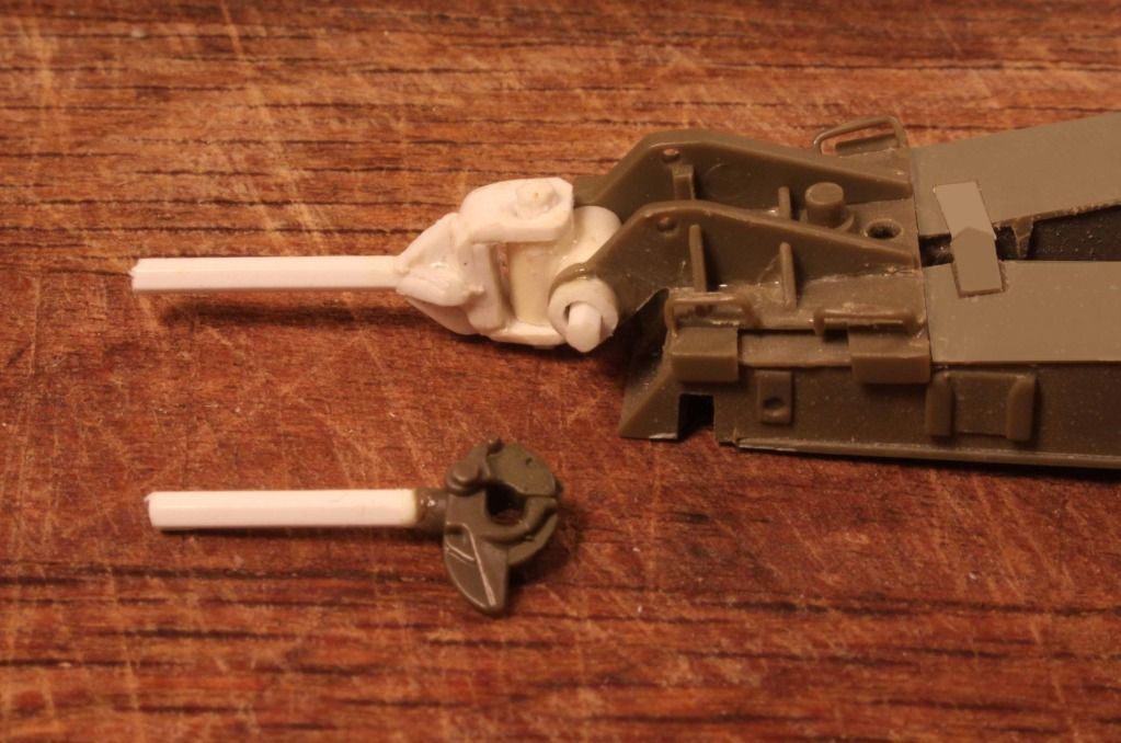

My version of the Mack custom hitch and receiver.
The standard tow pintle is shown below and just as on the real thing, may be exchanged for the custom hitch.
Hex rod seeems to work better than round for helping the hitch assembly stay in the receiver which is just a press fit on the model.
In this photo the retaining nut is missing from the custom hitch. Another piece of larger hex rod drilled and cut to form a large castle nut that press fits onto the hex rod.

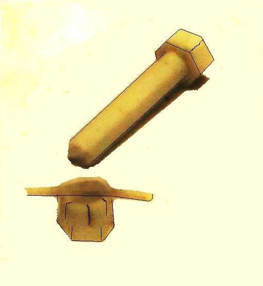

Retainer bolt and castle nut with spot welded on spinner for Mack custom hitch. Sorry for the poor quality of the photograph. It is such a great enlargement I had to draw in the details.
This is my reference source for adding the welded on spinner to the retainer castle nut. The small photo is from the Tech Manual for the M23 Ammo trailer built by Utility Trailer Corp, which also utilized the same custom hitch and was often pulled by the Mack NO.

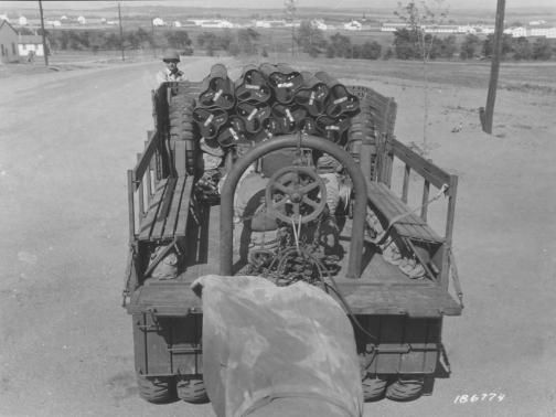

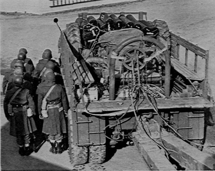

New (as in not seen before in my research) photo of the Mack NO, found today on the Olive-Drab website:
Nice to have a reference that shows the Mack all loaded up for a change. Also note; those ten guys are gonna have to fit in the back as well, with either 3 or 4 more in the cab!
Also check out that rack enclosure loaded with 155mm ammo.

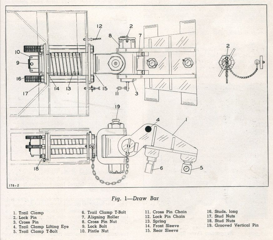

Mack custom drawbar assembly as shown in the Tech Manual:
( This fixture could be exchanged for a standard army hitch pintle in the received when required.)

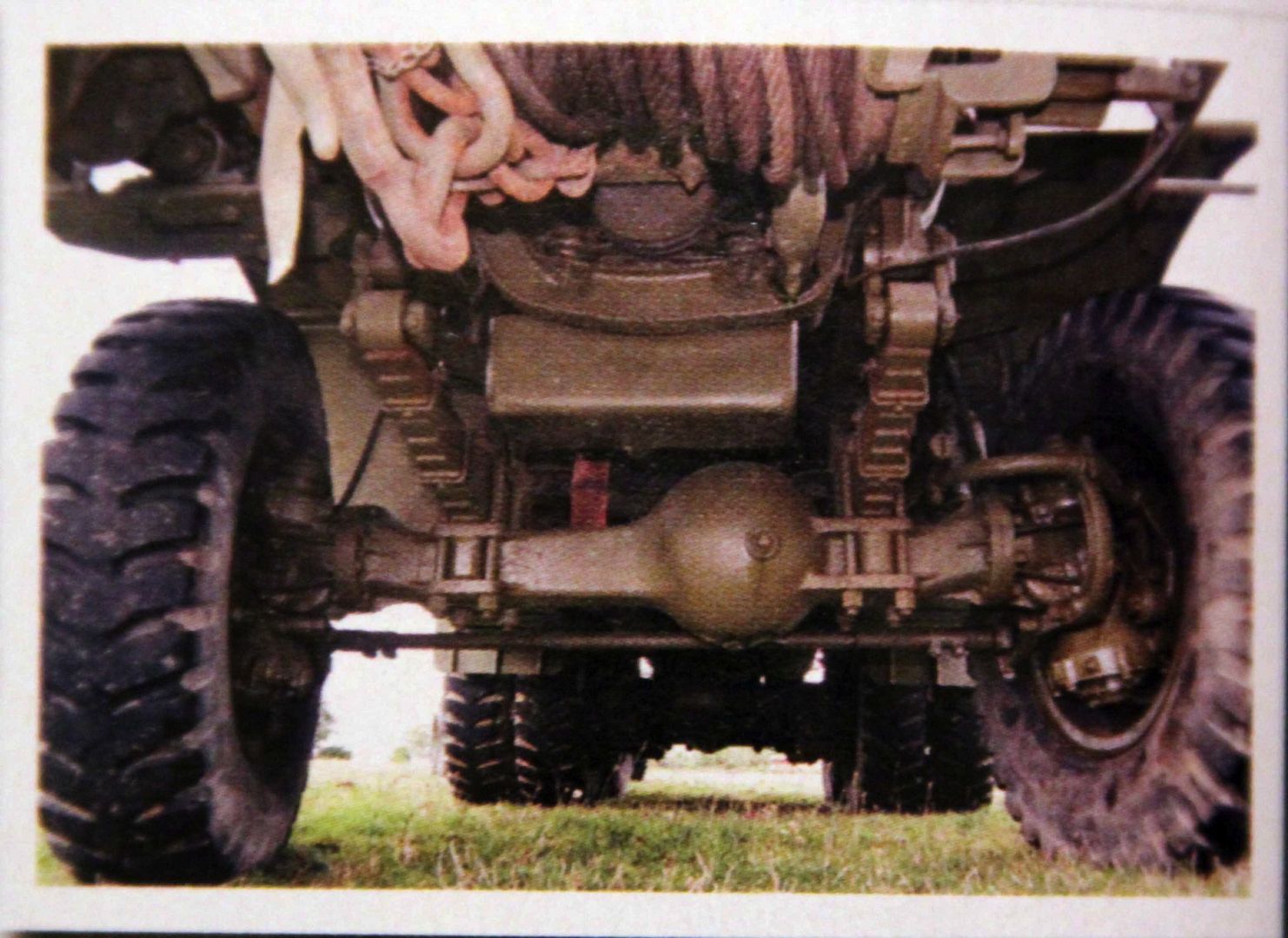

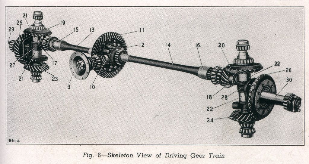

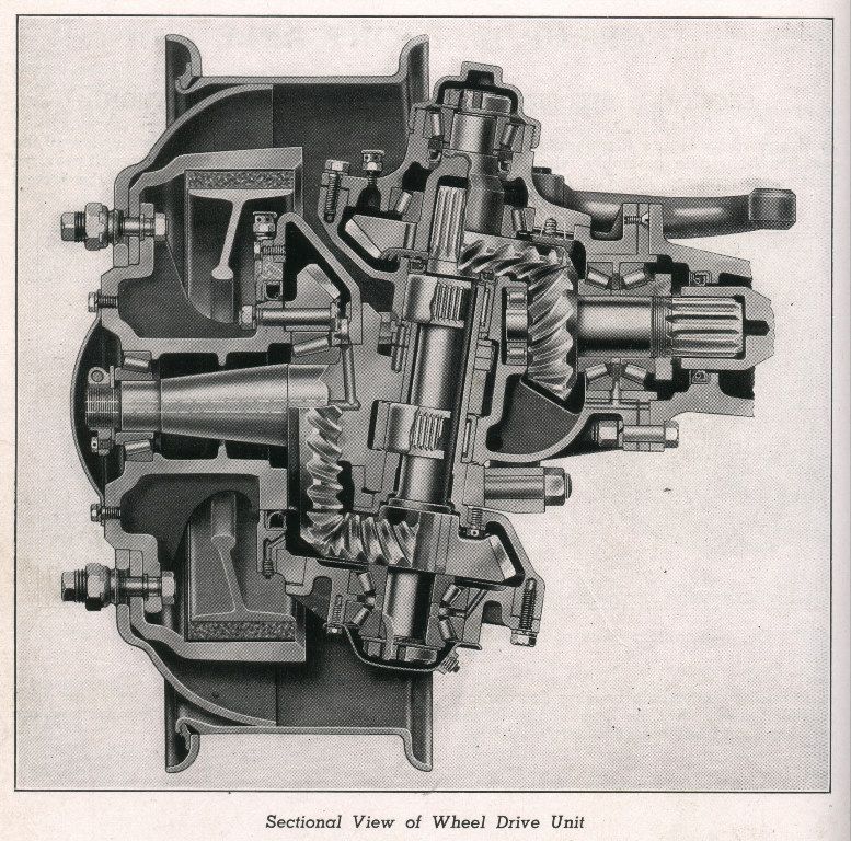

Challenge: Design a front wheel drive unit that DOES NOT require universal joints or CV joints. You would probably say IMPOSSIBLE. (I know I did!)
Mack did it and did it with style. This is innovation!
F.Y.I. - The latest Kubota 4 wheel drive tractors use this very design to produce a tougher front end without employing U-joints in the design!
Amazing
The above black and white images come from the collection of EASY 1 Productions - From the disc entitled "TM 10-1679; 7 1/2 ton 6x6 Prime Mover Mack NO"
