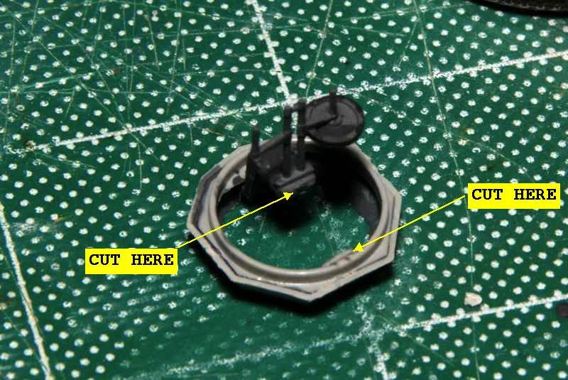

tread_geek
Joined: March 23, 2008
KitMaker: 2,847 posts
AeroScale: 144 posts
Posted: Tuesday, October 18, 2011 - 05:34 AM UTC
Appreciate you taking the time to comment, Bill. As I mention earlier, I have started the second vehicle in the kit and perhaps because of the experience with the first, the second has come together a bit easier.
For AJ and anyone else building this kit, I used a simpler modification process to deal with the second turret interior. While not 100% historically accurate, it is closer to "the truth" than my first modification and also I believe simpler.
Part B17 has a crossbar to which the seat support (A34) is meant to attach. In the second vehicle, I cut this crossbar from just behind the seat frame mounting holes and at its rear most area. For the purposes of this option, I consider the turret front to be the end where the opening for the MG-34 is located. Here's a picture of the surgery.
The real 223 has a single seat/saddle mounted on a support and it is somewhat centrally located but offset to the left. I used the simple disc shaped seat for the gunners seat and left off the second chair-like seat.
Comments or questions are always welcome.
Jan

I must also say thanks for the last picture of how to handle the turret interior and the link to pictures of the real thing. It's seems like a fairly simple solution and a lot simpler than either the first method or trying to create the real thing. Just wondering but do you think that the second seat fame should be removed from the main frame?

@AJB - I haven't totally decided what to do with the frame for the second seat but it should probably be removed at the point where it attaches to the vertical piece. As for the seat that is supposed to go there, one could place it just forward of the turret in the interior as the radio operators seat.
