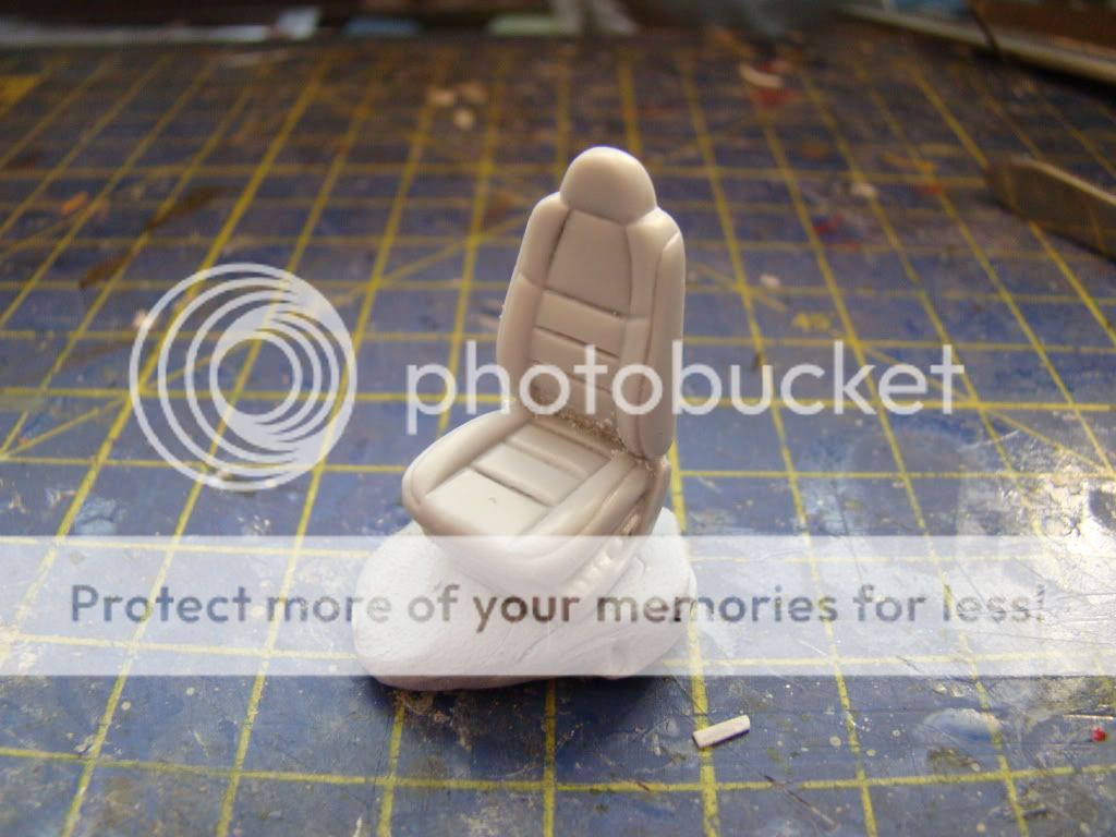

Last night I had poured resin liquid into the seat cast to let it set overnight
Today I removed the seat, you can see it here next to the cast. I'm happy with the result!
I didnt bother casting a second seat because the original seat I used for the mold will do perfect!

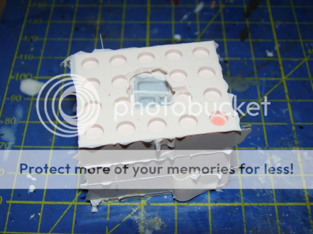

Hi Harm
The rubber is quite thick & strong, it can take alot of mauling.
You can't see in the photo but I did run a scalpel across the upper section where I removed the seat. The slice was very shallow and not deep, just enough to allow me to crack open the surface & assist in the removing of the seat inside.
The rubber as I mentioned is quite strong & durable so it always closes clean again after opening! The rubber silicone is so dense that hairline incisions from scalpels would rarely show up on the resin pieces after casting!

Just wondering how you got the seat out of the mould, since you do not seem to have cut it open... Is the mould flexible enough to allow for the original piece to be ripped out without the mould itself losing its shape/detail?

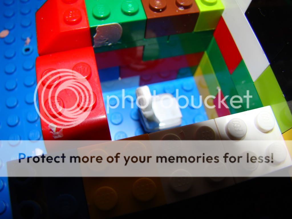

I want to cast a copy of this seat so I can dublicate it easily and ensure both seats are the exact same!
So I sanded down the seat and dipped it into Future about 6 seperate times between drying to give the seats a smooth finish.
To begin the casting I built a little lego box around the seat allowing plenty of room surrounding the seat. The seat is sitting stable on some blue-tac in the center of the lego square.

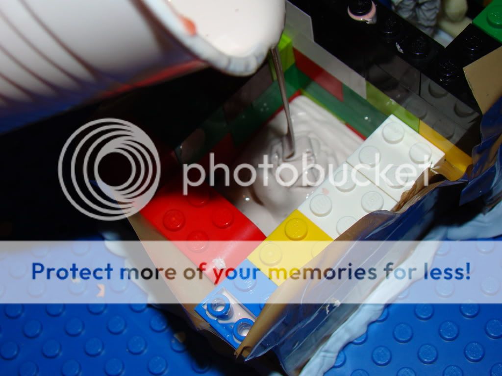

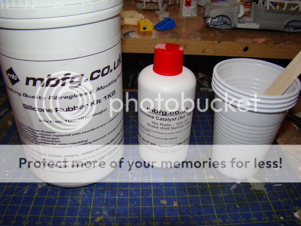

next i got the Silicone rubber mix out

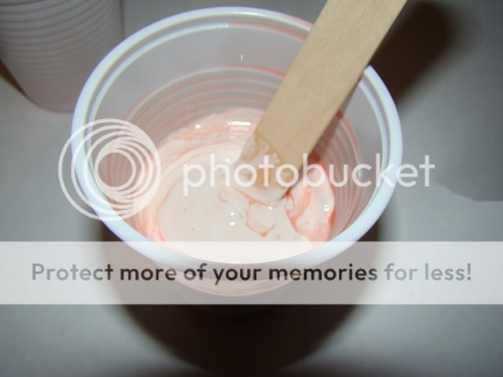

you have to mix two seperate liquid chemicals 100:10 ratio. So the little weighing scales came in handy!
I added both liquids together, stirring until I was sure both ingrediants were mixed thoroughly.

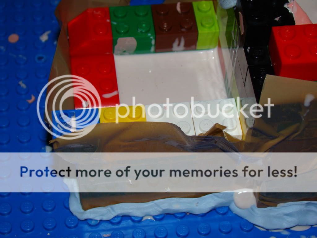

Satisfied with the mix I carefully poured it in on top of my converted seat. Trying to limit the amount of airbubbles that would be forming as I was pouring I poured from a generous height and very slowely!
I made sure to add a little extra liquid above the surface as these things always tend to leak a little, dropping the level of silicone liquid.

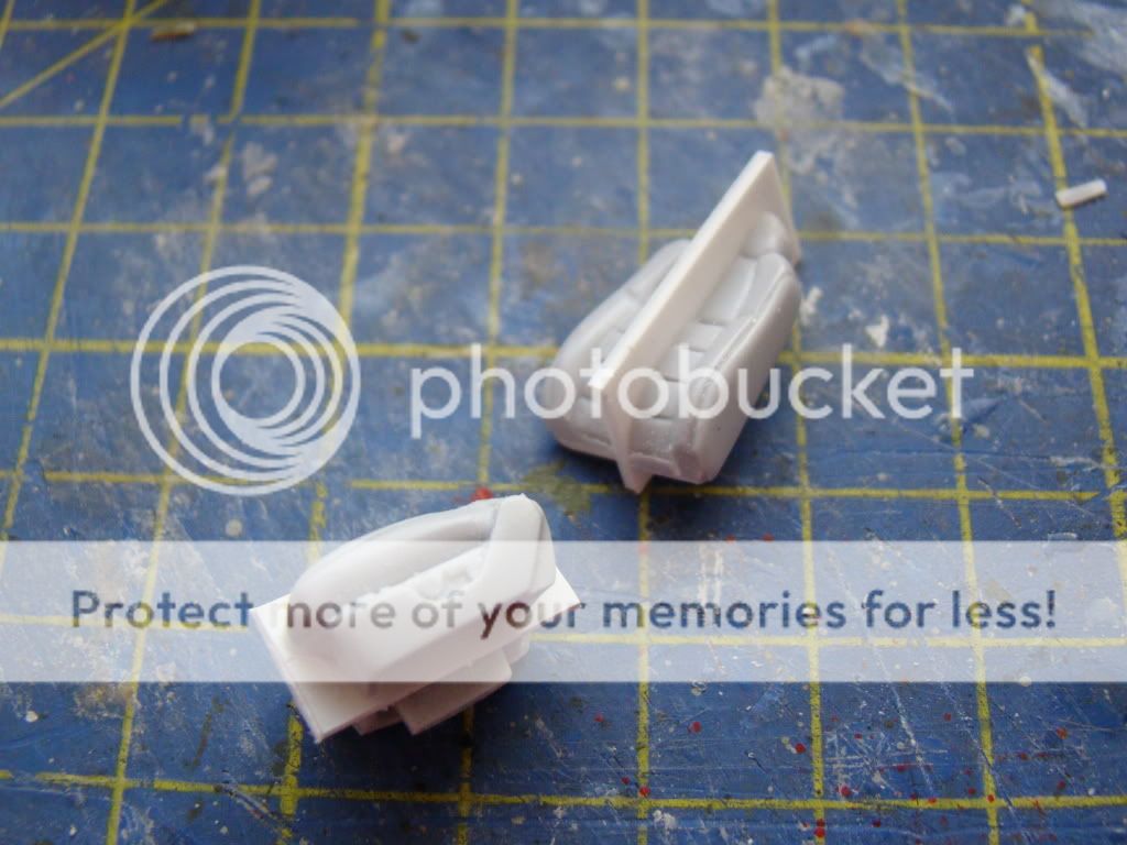

The next day the silicone mix had set and I removed the block from the lego.
I removed the seat and was left with the silicone cast
I'll leave the cast for another day before i add the resin. More on this later..

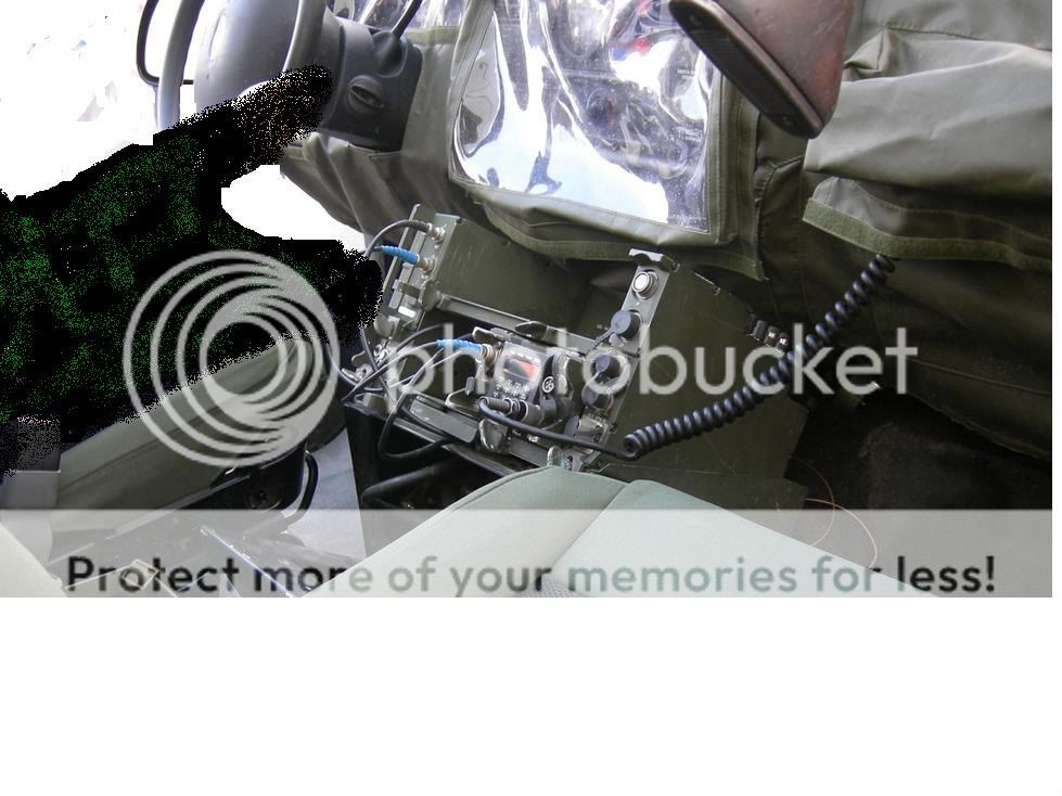

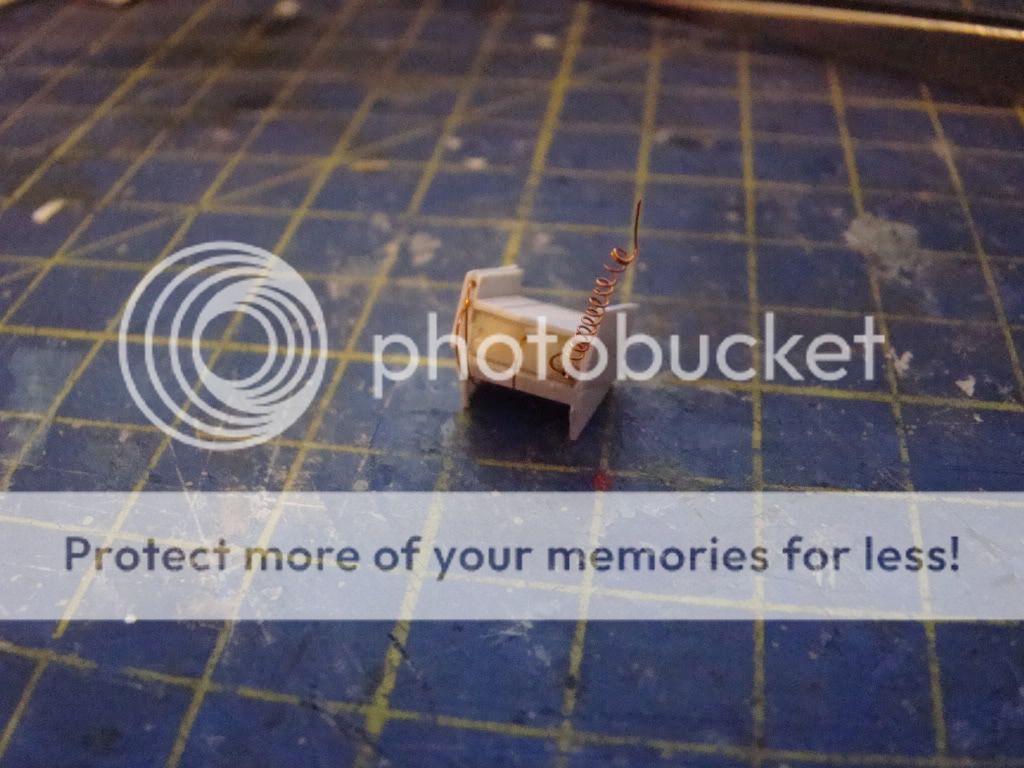

Whilst all this was going on I decided to get some work done on the cab interior. I went ahead and built the Sincgars/coms mount.
For this I used the Pro-Arts communtications set. I decided to go with a full Sincgars instead of the illustrated baby sincgars. No real reason, I just thought the big set looked better and I would have less work to do adding the bigger set.
to be honest having trained on both sets I can actually tell you I like the older and bigger one better
I scratch built the mount and added the pro arts resin sincgar set. The photo doesnt do it any justice, pro arts did a fine job with detailing the small set!
To finish I just added some copper wiring.

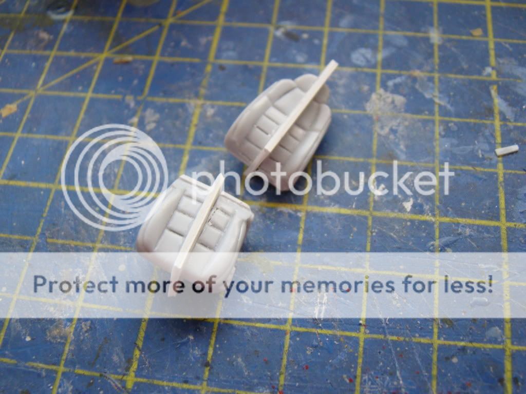

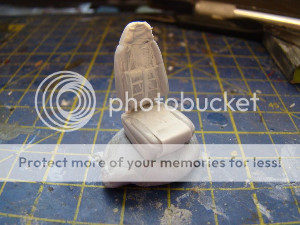

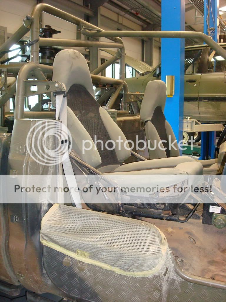

Next I decided to start work on the crew seats. These are Ricardo seats on the Irish variant.
I had to do some scratch converting and in doing so I decided to enlarge the seat because as i mentioned earlier the Vajra seats are just a little small looking for 1/35 scale. (although the original kit does seat 3 in the front compartment).
I began by cutting one of the seats vertically in half and into two sections, back support section and seat section.
Next I added some thick plastic sheet as a spacer.
I glued both halves back together with the plastic card spacer between both halves.
they would now need some shapping
I cleaned up the plastic card and sanded all the surfaces down evenly. You can see the seats are a little wider already.
With a bit more sanding and using some filler you can see the Ricardo Seat taking shape
I couldnt do anymore here as I had to let the Filler dry. but here are the comparisons between both seats already
The idea is to make a mold of this seat and reproduce two new ones in resin, more on this later..

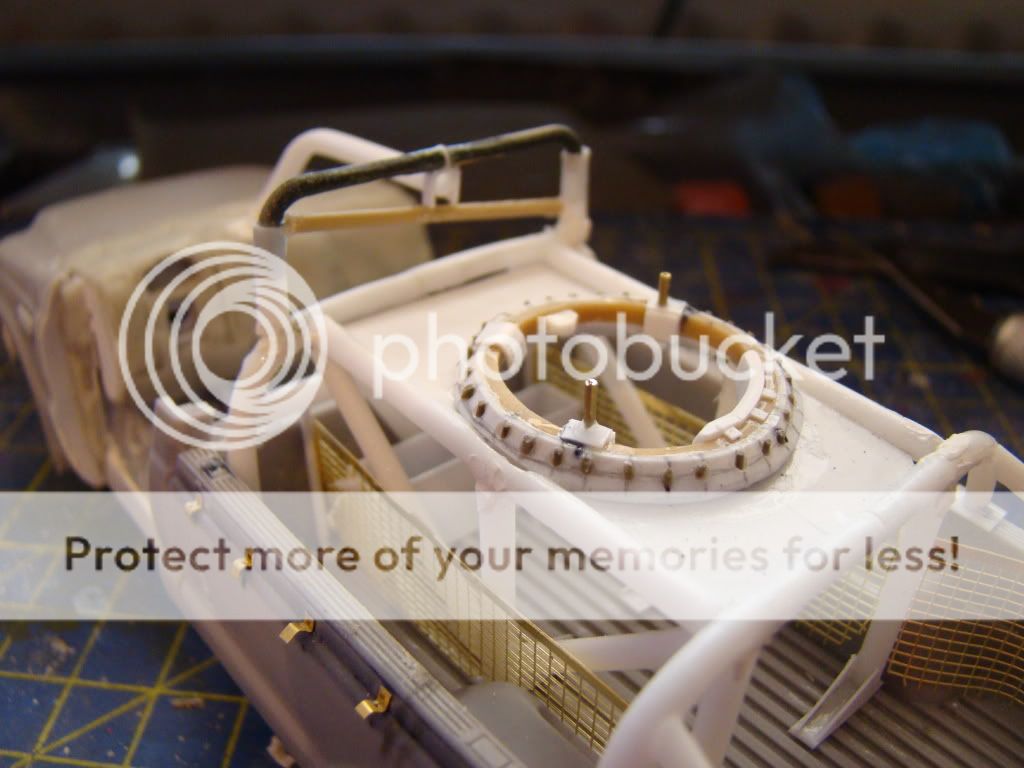

The last thing I decided to do today was finish detailing the ring mount section too. I added the crew handles and the base for the weapons mount (I'll be srctching this later in the week..

Next I decided I'd build the crew ring mount on the top of the roll cage. I began By measuring out the exact size ring I'd need, the results eleminated everything in my spares box so i had to scratch built one.
Lucky for me the inner circle of the ring I was going to have to scratch is just a little smaller than the standard plastic inner ring used on Tamiya Humvee roof turrets. (The bit used in between the the roof hatch and the internal roof ring)
So begining with this Humvee piece I began building the ring mount seen below in this photo
I began by scratching a base for the humvee ring using plastic card.
This ring section would be a little bigger than my spare humvee ring allowing me to build up the wall and surface properly.
First I used some filler, then when it dried I applied the outter skin of the ring using more plastic card (seen here in a cone shape)
Next I cleaned off the cone shape leaving the ring to take shape a little
..a bit more sanding and cleaning later
..and another bit of sanding and cleaning later I'm left with the general shape..
Next I measured out the bolt marks that you can see running along the ring mount in the photo and I drilled little holes around the outer circle
Lastly I added some stretched sprue to each hole. leveling out the heads of each one with sharp cutters to illustrate the bolts.
it looks messy because of the pen and pencil marks but I was happy with the result and it should look better when primed!
There was a very slight fit issue mounting the ring onto the roll cage but a bit of sanding here and there managed to allow the ring mount sit comfortably in its cradle.
I have to come back to this later to detail the ring mount but thats enough for one day
