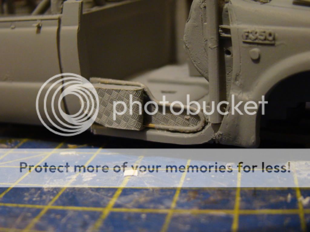

Today I actually got a whole section completed, I was pretty chuffed!
Remember the front bumper section and the Bull Bar?
Well I went back to correct the dodgy looking small horizontal bars that are just in front of the main headlights!
I used some Griffon Models Copper Rods, they did the trick nicely!
I also finished detailing this section by adding the two hooks at the front and, a small mechanical device blonging to the winch on the RHS of the bull bar Frame. Finally adding the smoke dispensers to complete this section!

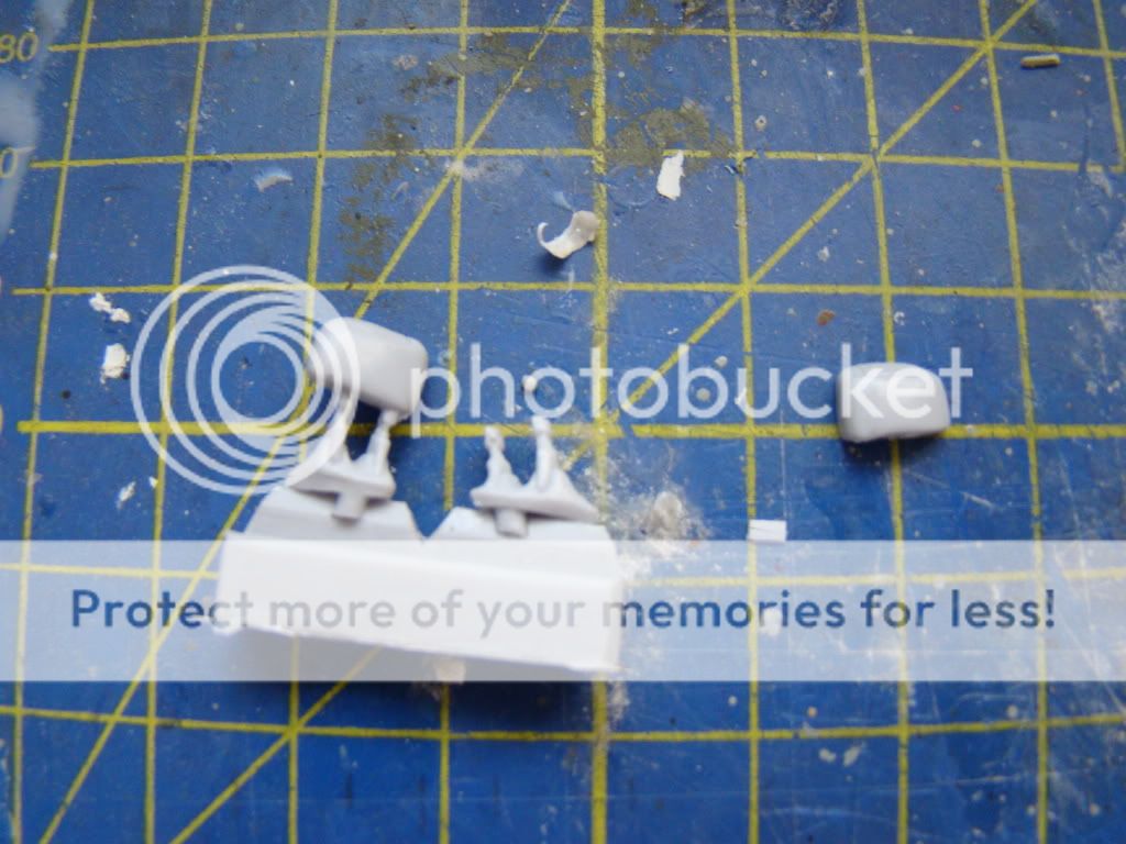

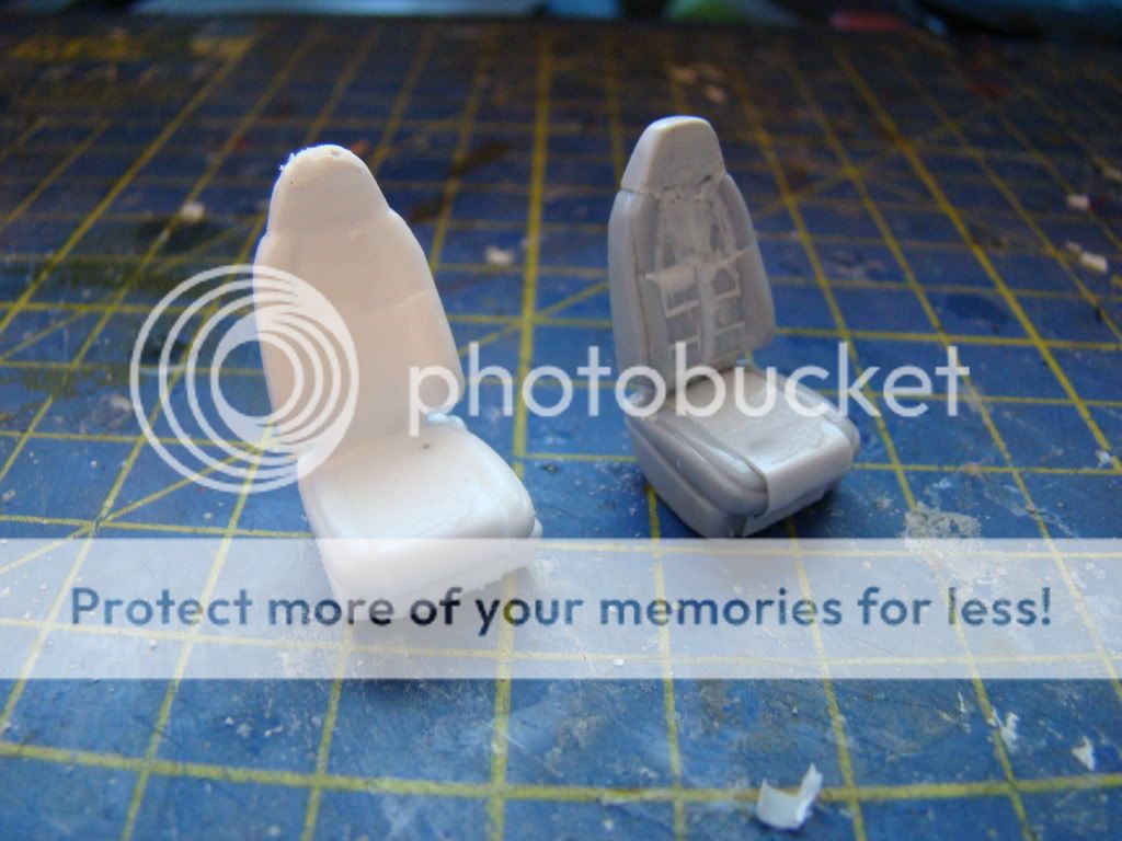

Next I decided to start work on the crew seats. These are Ricardo seats on the Irish variant.
I had to do some scratch converting and in doing so I decided to enlarge the seat because as i mentioned earlier the Vajra seats are just a little small looking for 1/35 scale. (although the original kit does seat 3 in the front compartment).
I began by cutting one of the seats vertically in half and into two sections, back support section and seat section.
Next I added some thick plastic sheet as a spacer.
I glued both halves back together with the plastic card spacer between both halves.
they would now need some shapping
I cleaned up the plastic card and sanded all the surfaces down evenly. You can see the seats are a little wider already.
With a bit more sanding and using some filler you can see the Ricardo Seat taking shape
I couldnt do anymore here as I had to let the Filler dry. but here are the comparisons between both seats already
The idea is to make a mold of this seat and reproduce two new ones in resin, more on this later..

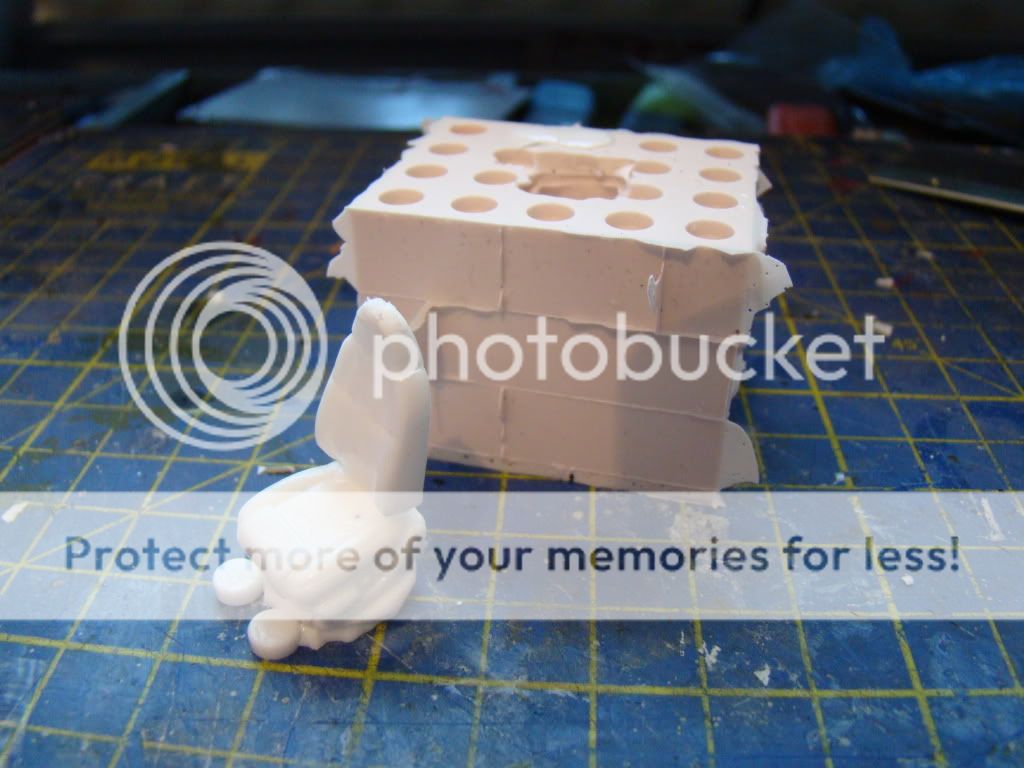

Anyway I got back into things the other day starting back with the seat conversion.

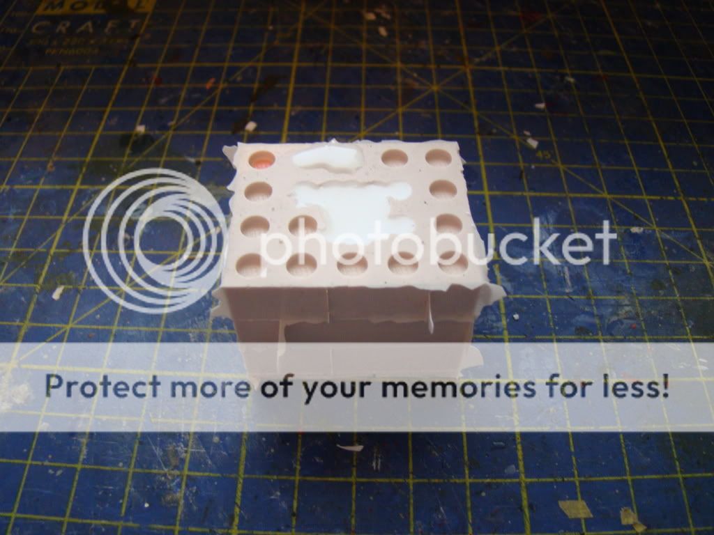

I want to cast a copy of this seat so I can dublicate it easily and ensure both seats are the exact same!
So I sanded down the seat and dipped it into Future about 6 seperate times between drying to give the seats a smooth finish.
To begin the casting I built a little lego box around the seat allowing plenty of room surrounding the seat. The seat is sitting stable on some blue-tac in the center of the lego square.
next i got the Silicone rubber mix out
you have to mix two seperate liquid chemicals 100:10 ratio. So the little weighing scales came in handy!
I added both liquids together, stirring until I was sure both ingrediants were mixed thoroughly.
Satisfied with the mix I carefully poured it in on top of my converted seat. Trying to limit the amount of airbubbles that would be forming as I was pouring I poured from a generous height and very slowely!
I made sure to add a little extra liquid above the surface as these things always tend to leak a little, dropping the level of silicone liquid.
The next day the silicone mix had set and I removed the block from the lego.
I removed the seat and was left with the silicone cast
I'll leave the cast for another day before i add the resin. More on this later..

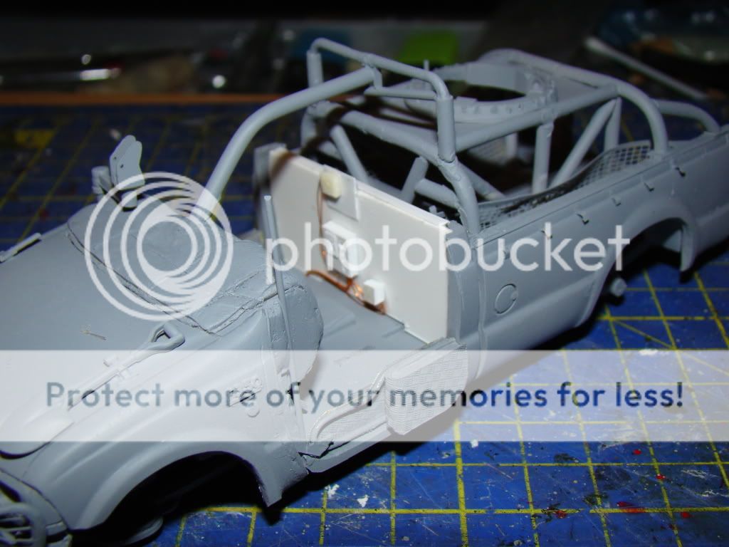

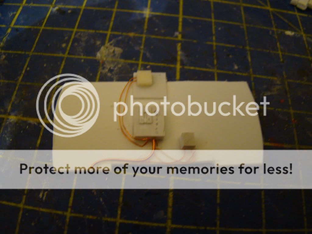

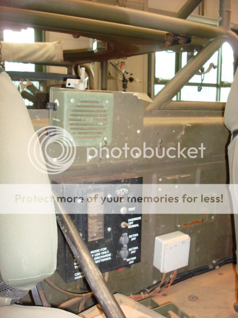

Whilst all this was going on I decided to get some work done on the cab interior. I went ahead and built the Sincgars/coms mount.
For this I used the Pro-Arts communtications set. I decided to go with a full Sincgars instead of the illustrated baby sincgars. No real reason, I just thought the big set looked better and I would have less work to do adding the bigger set.
to be honest having trained on both sets I can actually tell you I like the older and bigger one better
I scratch built the mount and added the pro arts resin sincgar set. The photo doesnt do it any justice, pro arts did a fine job with detailing the small set!
To finish I just added some copper wiring.

Just wondering how you got the seat out of the mould, since you do not seem to have cut it open... Is the mould flexible enough to allow for the original piece to be ripped out without the mould itself losing its shape/detail?
Harm
RKinsella
Dublin, Ireland
Joined: September 29, 2007
KitMaker: 603 posts
AeroScale: 11 posts
Posted: Monday, March 14, 2011 - 11:25 AM UTC
Hi Harm
The rubber is quite thick & strong, it can take alot of mauling.
You can't see in the photo but I did run a scalpel across the upper section where I removed the seat. The slice was very shallow and not deep, just enough to allow me to crack open the surface & assist in the removing of the seat inside.
The rubber as I mentioned is quite strong & durable so it always closes clean again after opening! The rubber silicone is so dense that hairline incisions from scalpels would rarely show up on the resin pieces after casting!

Last night I had poured resin liquid into the seat cast to let it set overnight
Today I removed the seat, you can see it here next to the cast. I'm happy with the result!
I didnt bother casting a second seat because the original seat I used for the mold will do perfect!
I still have some detailing to do with these seats, more on this later..

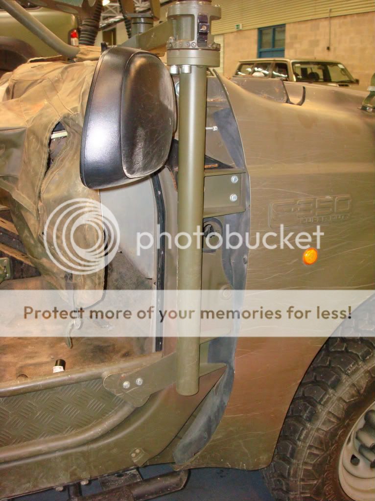

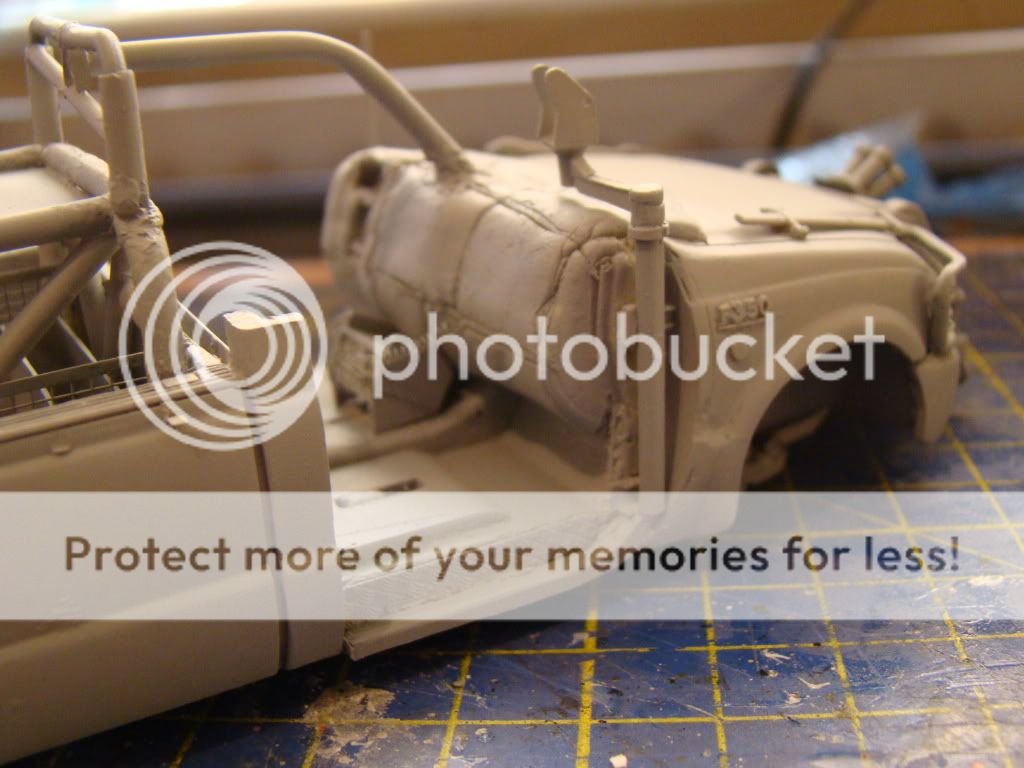

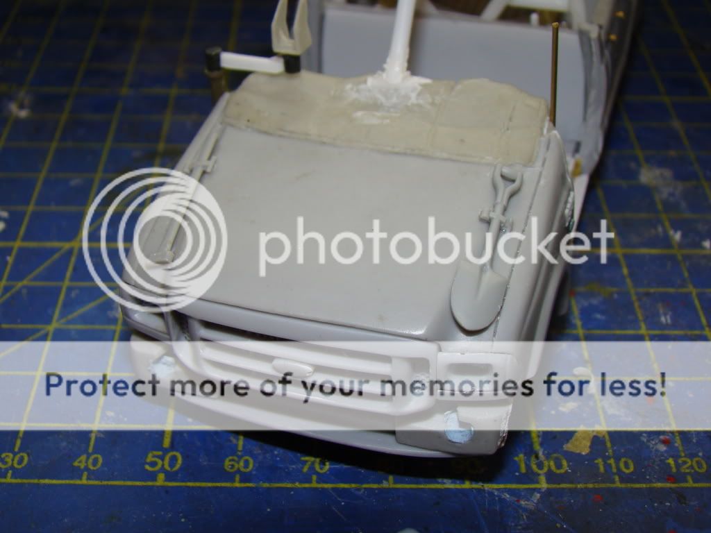

Next I added some tools to the bonnet (front hud).

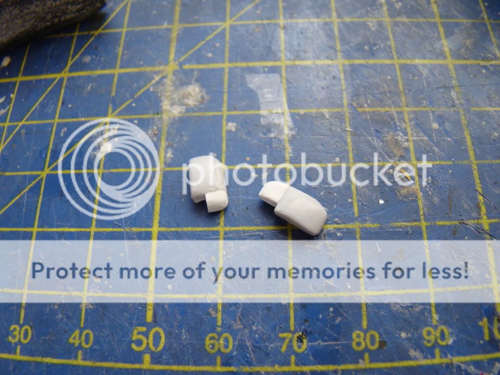

I was working on the passanger side weapons mount and letting a few bits dry when I decided I'd attach the wing mirrors, only to discover they are incorrect to the Irish F-350!
So working with what I had I scratched new mirrors from the old ones. I'll have to make new arms tomorrow..
Next I finished the passanger side weapons mount with swinging arm.

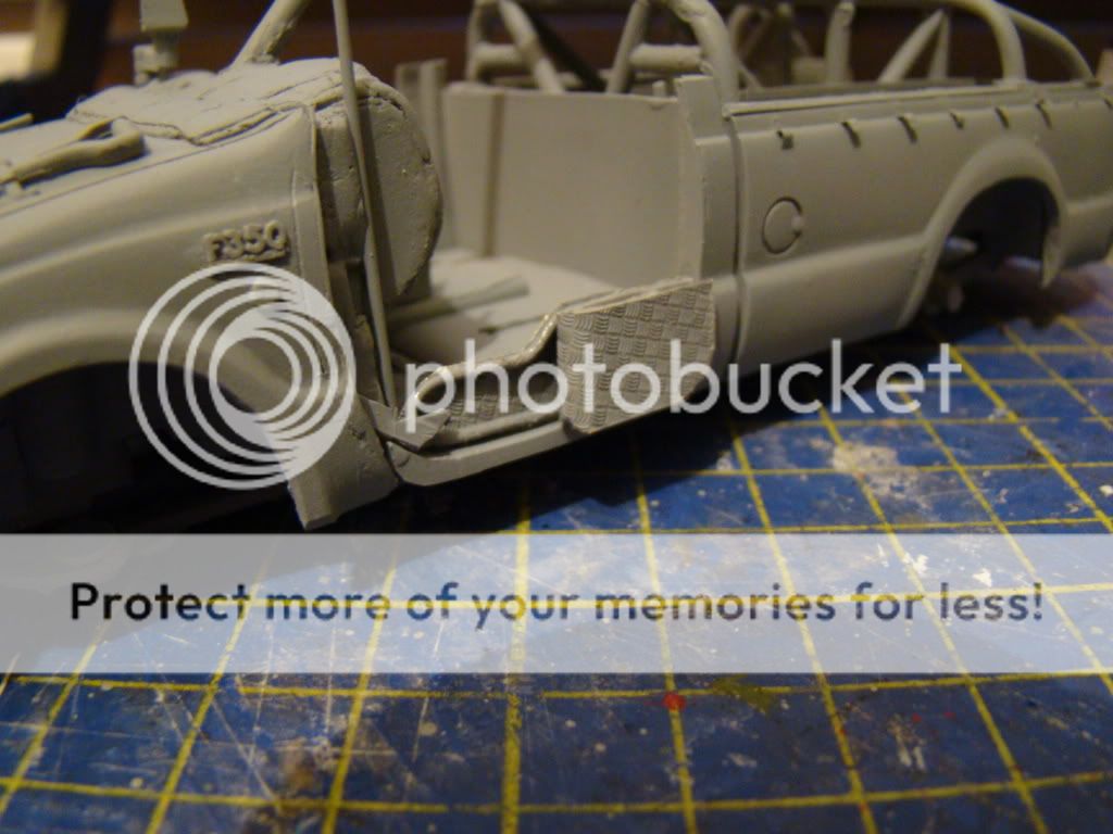

Whilst the weapons mount was drying I started building the storage bins where the doors usually are.
I was having some major problems gluing some brass bars to PE plate so I decided to prime them first.
After spraying the parts and having the primer out anyway I decided to crack on with giving the entire model its first coat of primer! I got into at all the nooks and cranny's and left it to dry. The benfit of this is now I can see more clearly where I have to clean up (some places obviously more than others!).
I went on to finish the door side storage bins and aligning frame steel.

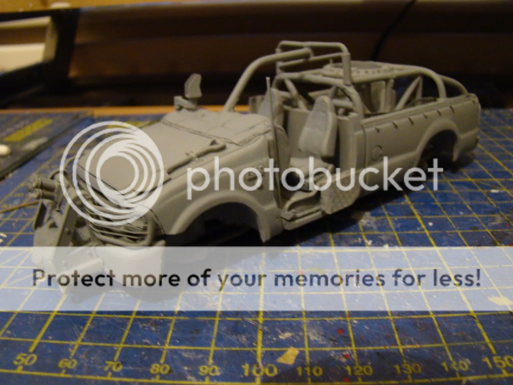

Posted: Sunday, March 20, 2011 - 04:11 AM UTC
KoSprueOne, Sven, Terry, Karl and Scott, Thanks for the support guys
..just a quick update, I had a hectic week so didn't get much done!
However I managed to squeeze in time and get the new mirrors attached
