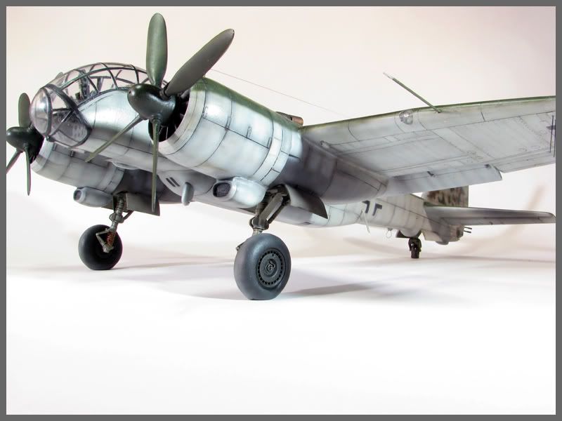

Posted: Monday, March 07, 2011 - 03:19 PM UTC
Life has been busy- and unpredictable lately! here's an update, at long last.

Posted: Sunday, March 27, 2011 - 08:08 AM UTC
Shucks- and thanks!
I would have posted this last week if not for a monsoon rain that caused a short in an outside receptacle that could have burned down the house! As it is, all is well with just a few scorch marks- whew! I was two-thirds done with the intro cartoon, too- lost that when the circuit breaker tripped. Oh, well, Hauptmann Hannah's back to introduce this much-delayed update- read on!

Posted: Sunday, April 10, 2011 - 02:37 PM UTC
Thanks, jhoog!
I just couldn't switch back to my other build, so here's a bonus update- enjoy! BTW, the seat cushions in the last pic are milliput, and are a work in progress.

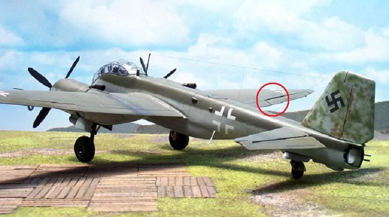

Posted: Tuesday, April 19, 2011 - 06:36 PM UTC
Hello again Chuck!
I just considered purchasing this kit but gave it a pass for now: It is actually excellent but just a bit too expensive, and the clear parts require epoxy resin glue which, as I mentionned above, I am not too familiar with...
In my research I came up with this amazing build on the "Hellenic Modelling" site, and a comparison led me to observe an easy to fix problem that could be of use to you: The spinners look either like they are a bit too long, or like they put the prop blades a bit too far from the cowling:
A pretty easy fix for you I would imagine... It's a very good kit kit generally, and said to be easier than the Dragon kit by Brett Green!...
Gaston
P.S. Beware of something else: I noticed on Brett's kit that the gap over the top of the right aileron is uneven, and this has been confirmed by the Greek modeller: The wing is out of straight in section at the aileron there:
This is also visible in plan view... There was also a surface "dip" reported by the Greek modeller on the underside of the left wing here:
http://www.helmo.gr/index.php?option=com_deeppockets&task=catContShow&cat=24&id=1143&Itemid=36
Strangely enough, I think the upper right wing problem is only mentionned here in this other version of his WIP:
http://www.helmo.gr/index.php?option=com_deeppockets&task=catContShow&cat=30&id=996&Itemid=36
I hope this helps!
Gaston
Posted: Wednesday, April 20, 2011 - 03:40 AM UTC
Thanks, Gentlemen!
Gaston, alignment was a key worry for me- that's why I built that foamcore jig. That should eliminate a lot of guesswork when it comes to that fateful day of assembly!
The spinners are smooth castings, so trimming the rear to match the photos will be relatively easy. Your sharp eye saves the day here- I would have missed it! I've saved the photos you've linked here- I'm curious to see if my kit has the same depression in the wing- and I'll definitely have a look at that aileron facing!
I'm embroiled in a big storyboarding project at work that may well spill over into my modeling weekend- and my next update will be on my 1/35 diorama project that's running over on Armorama. linkname http://armorama.kitmaker.net/modules.php?op=modload&name=SquawkBox&file=index&req=viewtopic&topic_id=167483&page=1

Posted: Sunday, May 01, 2011 - 03:35 PM UTC
Thanks, Daniel!
Raptor, you have some work ahead of you, it seems! The wings have very different nacelles, but I think you clear past the firewalls. Hope you do post pics when you get going!
Kind of a quickie today- fighting crazy allergies!
