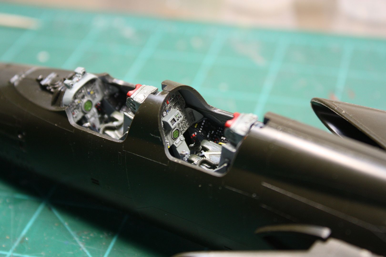

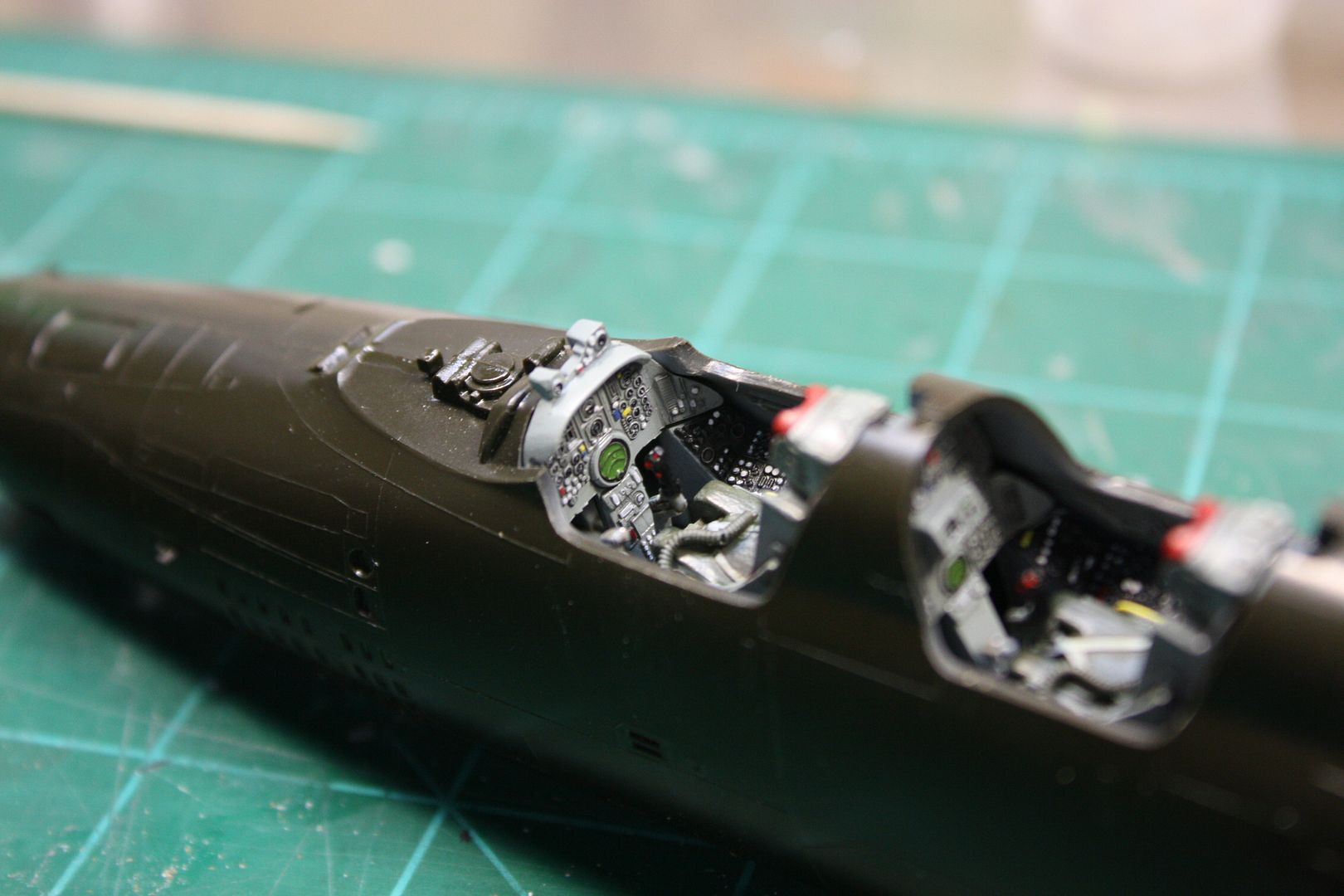

Howdy all. Just thought I would share my build of Monograms venerable F-105G with the group. While a more recent release has made an appearance in the modeling world, I still feel the Monogram kit is better. For its age the Monogram kit holds its own quite well. Your mileage may vary.
Thus far I have assembled and painted the instrument panels and most of the consoles for the pilot and his weps officer. I detailed out the seat a bit more than what comes in the box by adding some additional material to the belts, and some wiring along the sides and back of the seats. This still needs to be painted in my pictures. Also added the oxygen hoses using fine copper wire wrapped around a smaller piece of wire and bent to shape. Everything you see in regards to the instrument panel are the kit parts. Compared with my references, these are about as close to the real deal as one could get. Extremely accurate.
Painting was accomplised using Model Master aircraft gray overall with the details being picked out with Vallejo acrylics and a fine brush. Still plenty to of painting do as yet. Thanks for following along and stay tuned for more.

I can see your point regarding the Monogram kits! When I started modelling as a kid in the early 80s, Monogram kits were state-of-the-art without much competition really. I was a cockpit-freak then and when it came to that part of a model they really delivered, every time! The same goes for details on ordnance, landing gear and engines. Sadly they were hard to find and rather expensive in Sweden then.
Those were the times!

Looking fantastic, I particularly like your method of constructing the oxygen hoses, looks very effective. Keep us all posted.

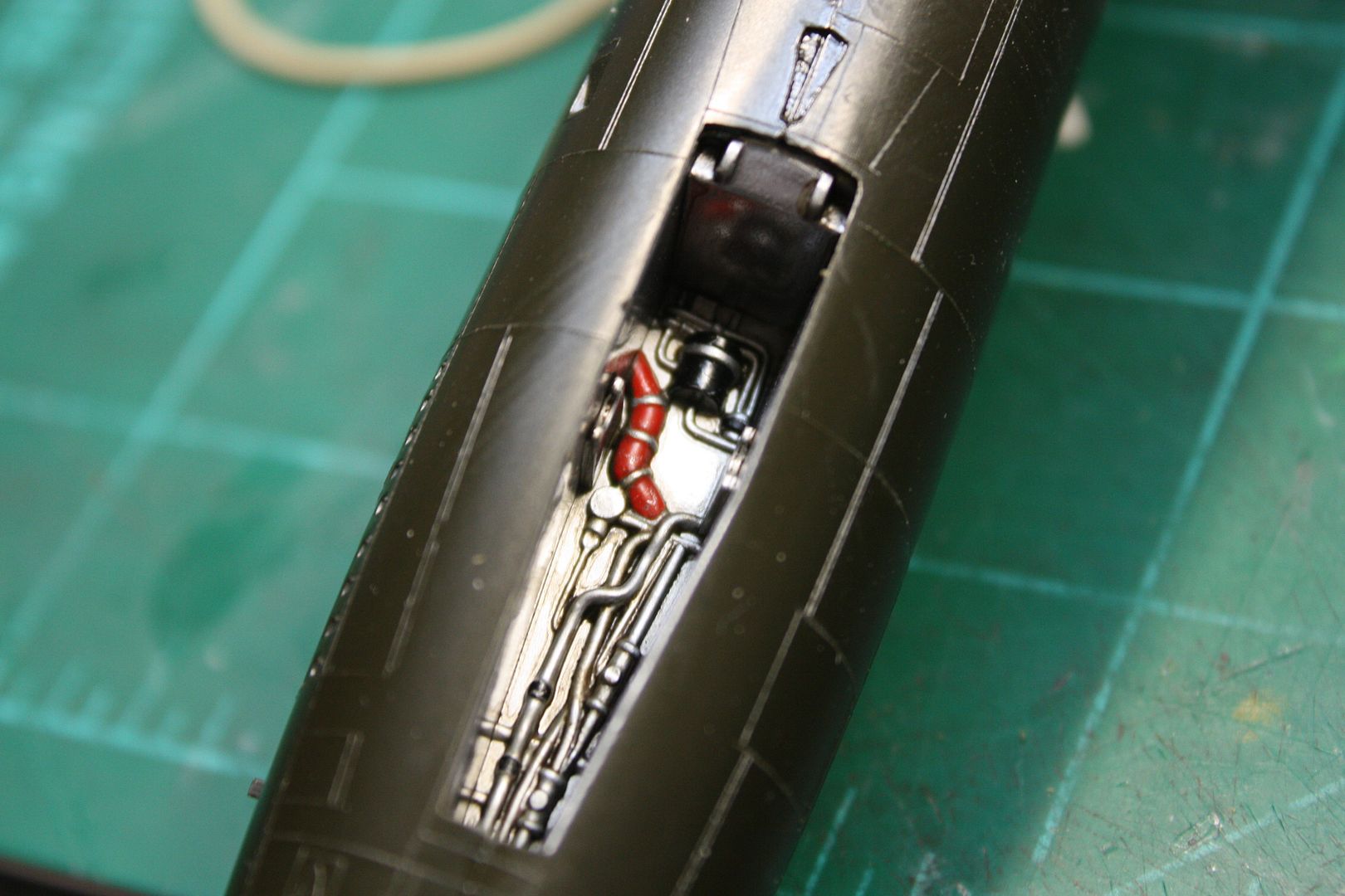

Glad you all are enjoying the build thus far. Here is an update for today. Late last night I painted, glossed, and weathered the nose wheel well. I painted it silver as most of the pics and 1:1 items I have come across show this to be the predominant color. I used the small square testors bottle of silver. This stuff sprays so well, just need to be sure and seal it before doing anything else to it as it will lift easily.
I picked out the largest line in there in red leaving the securing straps in silver for some contrast. I believe this was the fuel transfer line from the refueling port located on the nose. If not...oh well, it looks good in red and adds some visual appeal. Picked out some smaller items in black, and then finally sealed everything under some Future in preparation for an oil wash to better define the lines etc.

Looking really good. How do you do the O2 hoses? And where did you find the mesh? I had some a while back but I can't find it now. Had to use som ribbon last time.

Thanks Mark. O2 hoses were made using fine copper wire wrapped around a piece of flexible wire then bent to shape and glued in place with CA. The inner wire is pretty much the same as those find on bred bag ties. Just remove the outter paper and you're good to go. I scored the brass screen years ago at a contest. Every wedding reception I go to, they seem to like putting ribbon out on the tables. Extremely fine mesh it is, and I always end up leaving with yards of it. Works great for all kinds of things other than decorating candy dishes. Glad you like the progress thus far. Thanks again, "Q"

Just realized after going over my references that I painted my seats incorrectly Not a big deal; will just have to be careful with the re-touch. Getting ready to add some paint to the ole girl. Had to wait overnight for some putty work to dry around the radome. Just need to mask the cockpit off and I should be ready for paint this afternoon. Stay tuned and thanks for watching.

The back of the seats should be the same gray as the rest of the seat as the pilots carried the chute on them as opposed to being an actual part of the seat. Not a huge thing to change, just missed it when I initially started. "Q"
