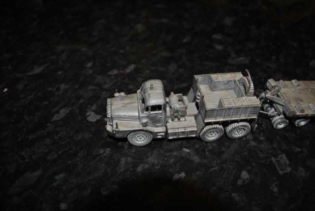

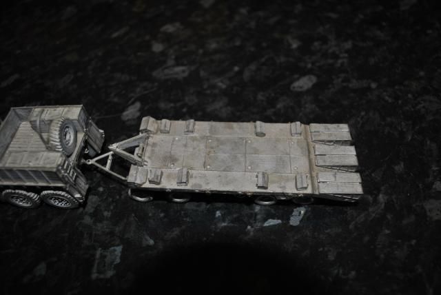

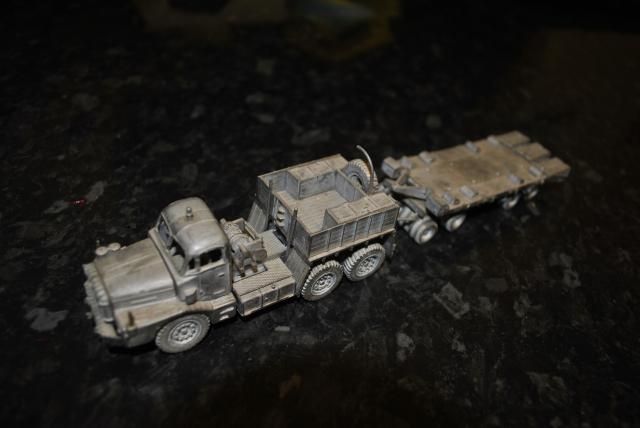

As some of you may know i had an alcohol fuelled impulse purchase (or two) at Telford.
Progress so far on some of the white metal 1:76 RAF Antar Mk3 Ballast tractor and Dyson Trailer. (next year in Resin)
I've taught myself how to solder doing this. It's kinda fun.
Andy

Hi, I don't want to be disparaging, I am only try to help. I owned the RAF C6T Mighty Antar and 50 Ton Dyson Plant Trailer for 13 years and I know them intimately.
There are a few problems with the way you have assembled the kit, It may be too late to change, and you might not feel it necessary to do so anyway.
The spare wheel is mounted in the wrong place in your ballast Body, The lifting derrick for the spare wheel can be mounted ib sockets either to the left or right of the wheel, as on my model.
The chocks on the trailer mount into a series of keyhole slots. These holes are down the side of the trailer deck. Although they can be adjusted along the trailer, they can only be fitted at one width. as on my model.
The Ballast body in the BW kit is the same one offered on the Mk2 Mighty Antar, and thoug largely similar, the rAF body did not have the cross bulkhead 1.3 the way back. This was too retain 55 lb weights, and to stop them moving around but this Antar have just six 2 ton weights in the back, and they were so long the cross divider was cut out so they would lay in.
If you want further details I have a vast number of photographs that may help you get it correct. Also I have full data sheet on the trailer. If you need any help, I have works photo, Photos of its time with PSA and throughout its life with me. If you want ant help with this please say, and if you give me you e-mail address I can send stuff directly to you rather than posting on here. Mike

PS the angle of the beaver tail on your model seems tail down. The top of the folded up loading ramps should be almost level.

And the Antar is NOT a Mk3. It is a model C6T (or R6) The Mark 3 had a straight 8 Rolls Royce C8SFL supercharged engine, six speed gearbox arrangement. With Third diff and removable ballast body over a fixed fifth wheel. The C6T was an export Model, Only one RHD vehicle was built, This one. It had the mK2 12 speed dual gearbox, Rolls Royce 6 cylinder Turbocharged C6TFL engine, A fixed ballast Body, No fifth wheel, Nickel Iron batteries, not Lead Acid Batteries. It had no third diff in the first bogey axle, It has different steering gear to the Mk3. It has paper air filters on the front wing, not the oil bath filters of the Mk 3. Although it looks basically similar it most definitely is a seperate mode.
It was a one off, and although it has the cab of a mk3 It is not a Mk3. The model is officially a Thornycroft Mighty Antar model C6T.

Looks like i've some work to do on that. wish i'd known before i started. That old check your references clause bites me on the bum again...
Thanks for the pointers Mike. It might be this one needs to be destined for the scrap heap, not sure whether i can resolve all the mistakes....
