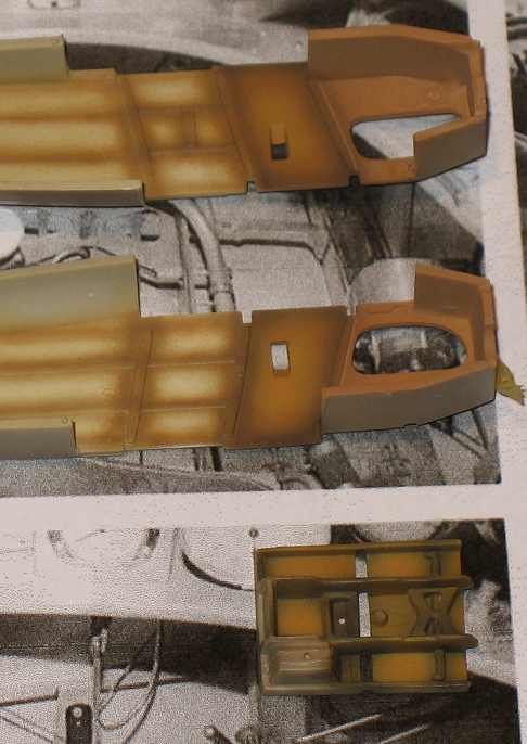

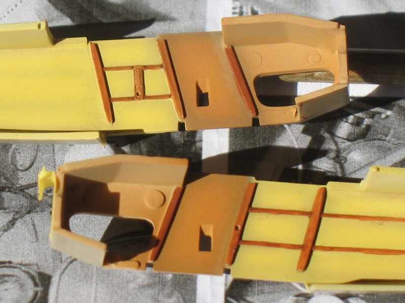

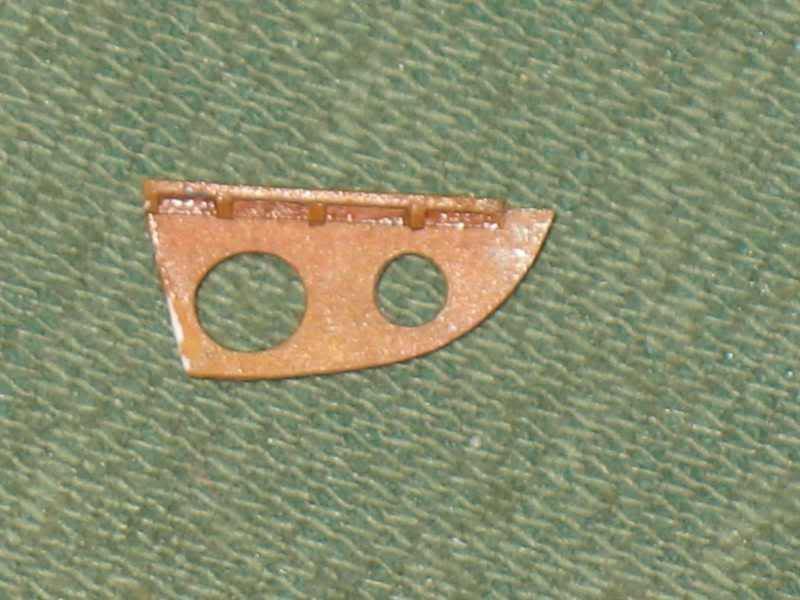

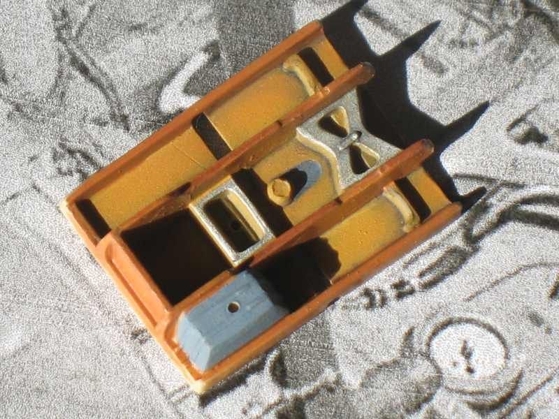

Everything is made in the airbrush ( humbrol paint 62 "orange brown" and 71+24 ) and oil paint for finishing.
Reinforcement in metal (lead) on the ruder.

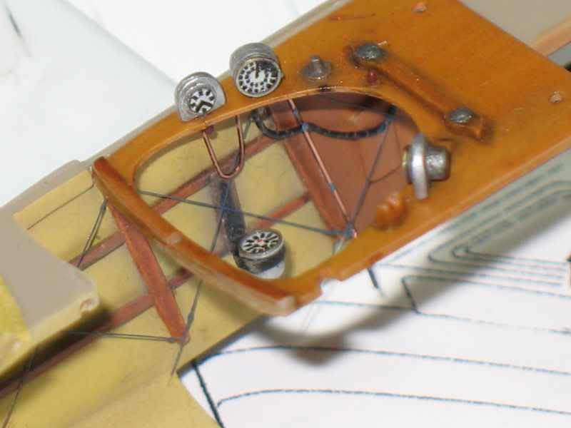

The bridge is painting with Humbrol 62. When dry we put clear and darker oil painting to make veins of wood and shades.

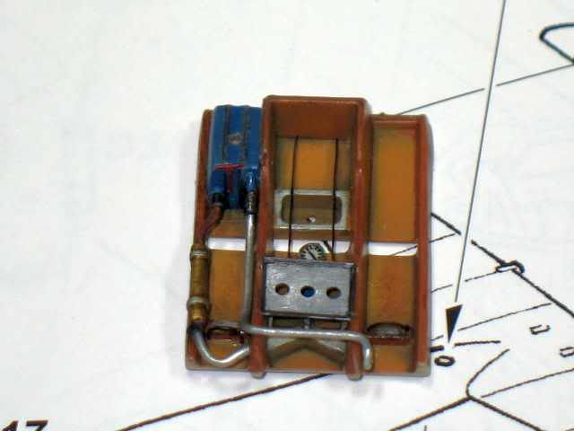

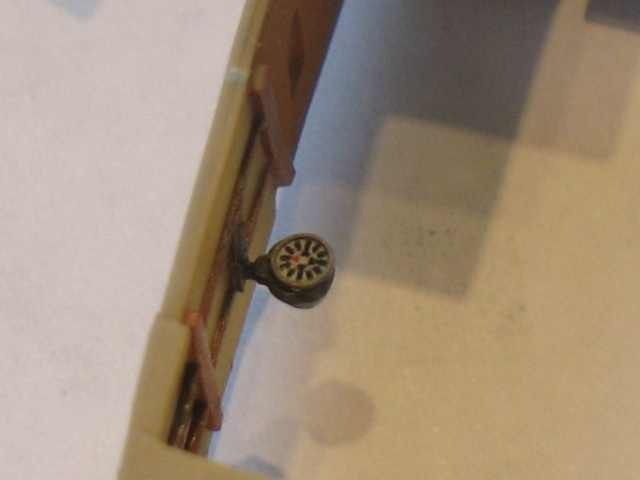

I added 2 stems on the left side. They are not "into the box"...

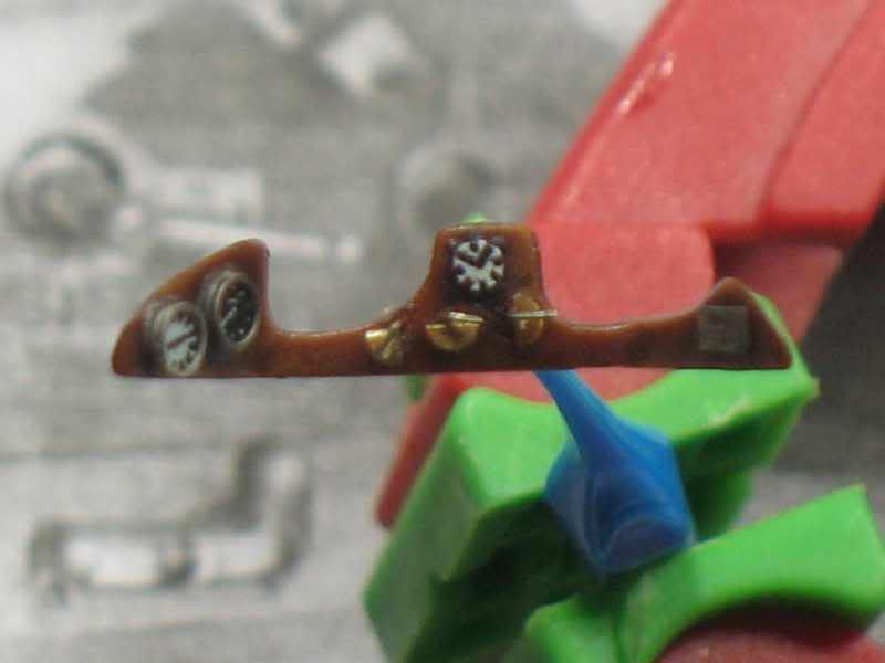

Pressure gauge and other one are very very small...

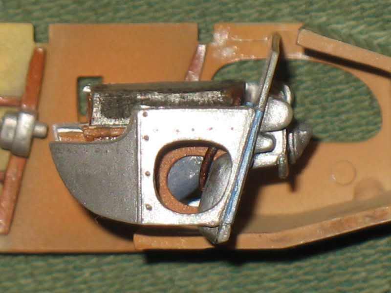

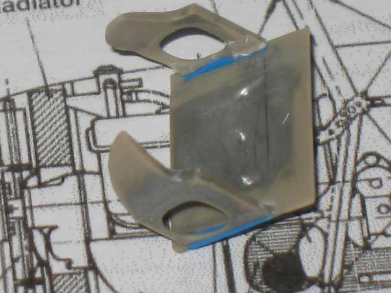

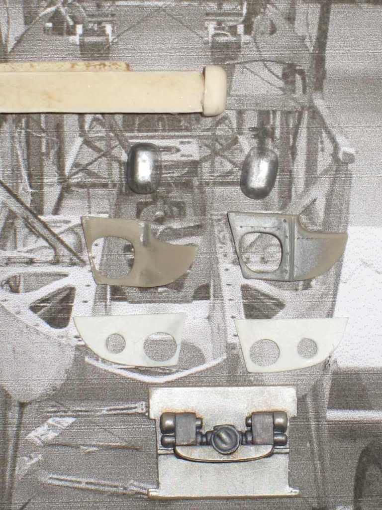

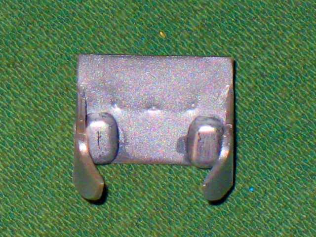

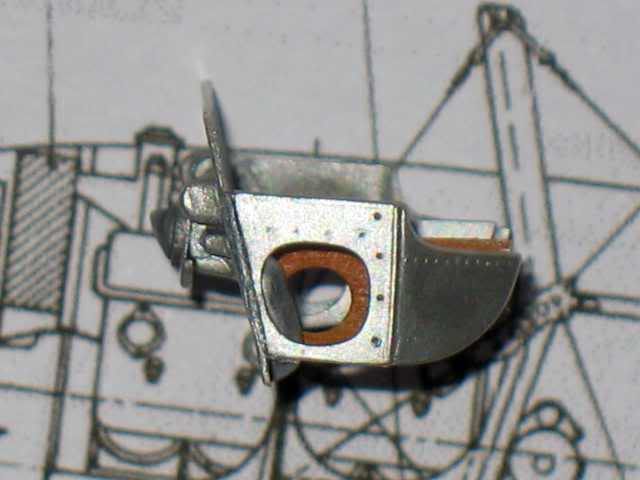

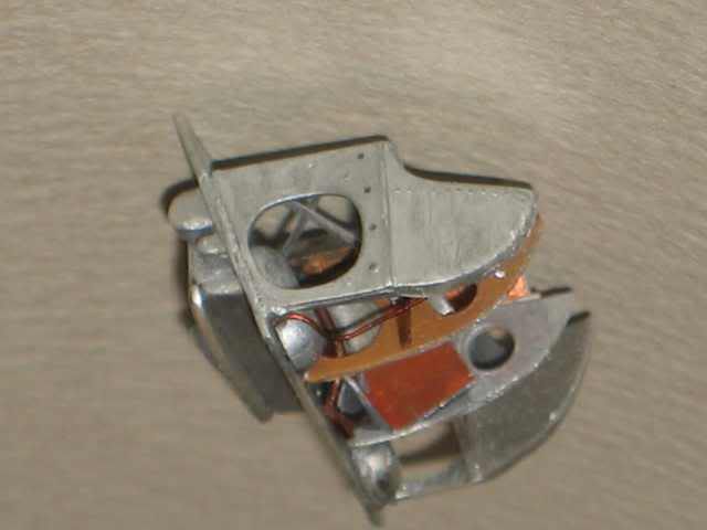

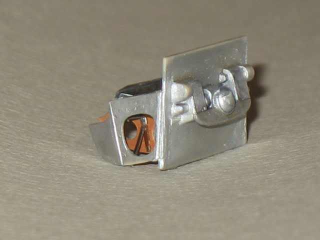

We can see many things by the holes of ventilation on each side from the hood. I want to leave them opened so I thinned both steel plates a bit by inside and blocked the hole with some plastic (blue).

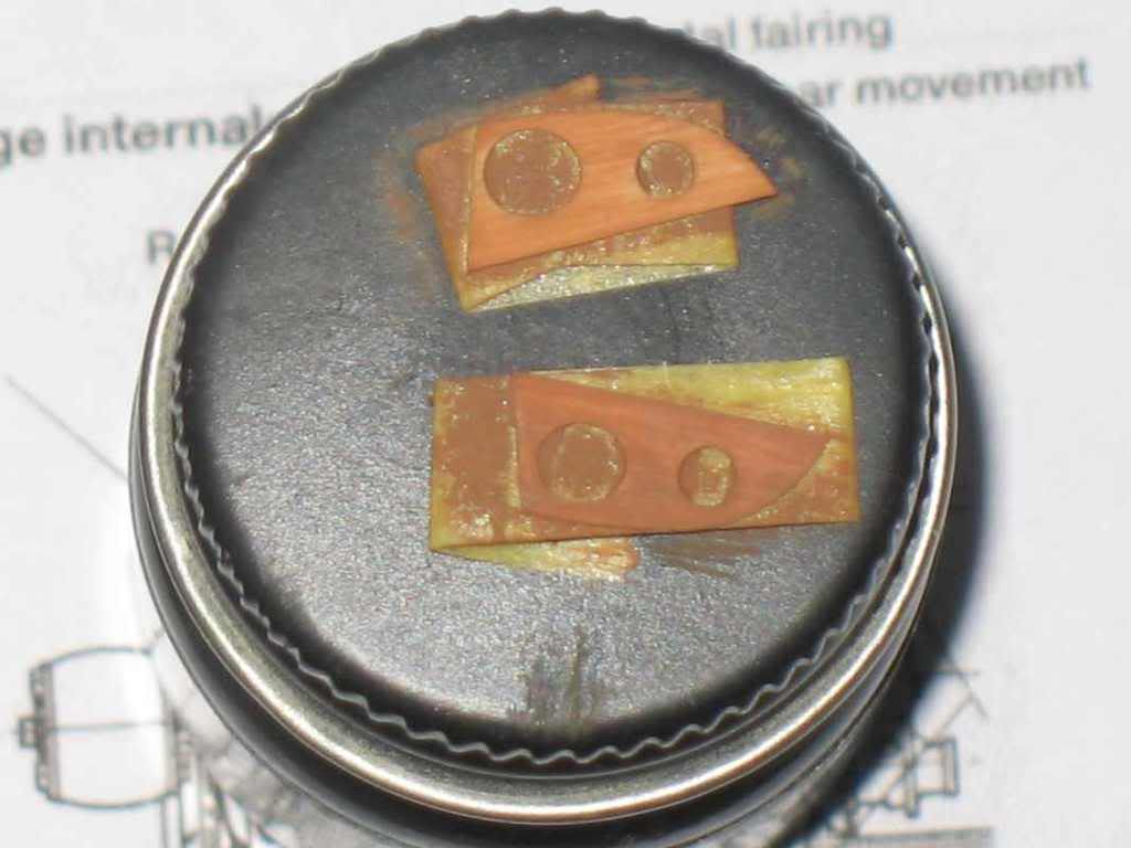

Both oval protuberances are "thermoforming" on a shaped fragment of resin or plastic and the engine bearer is cut up from the plastic card.

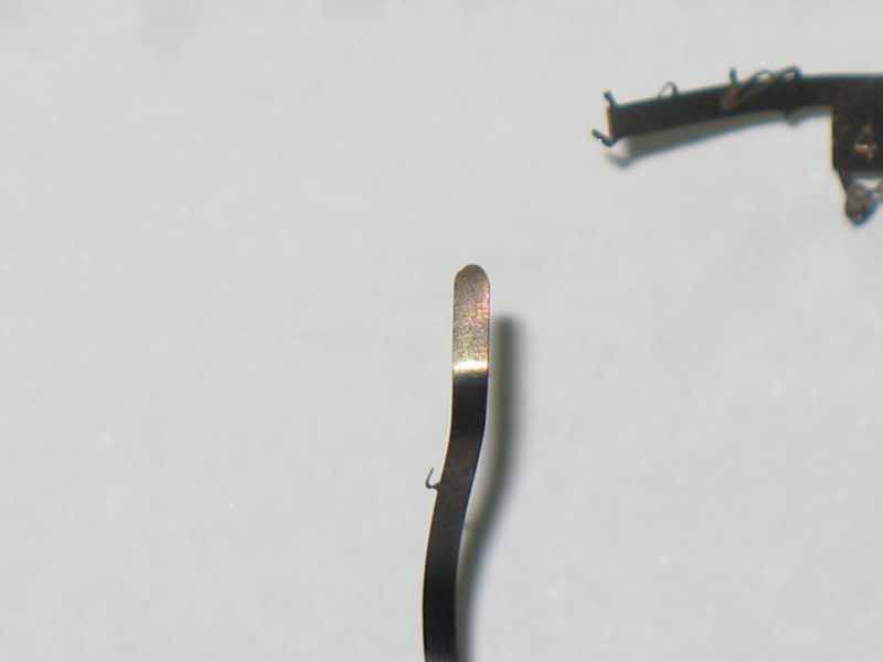

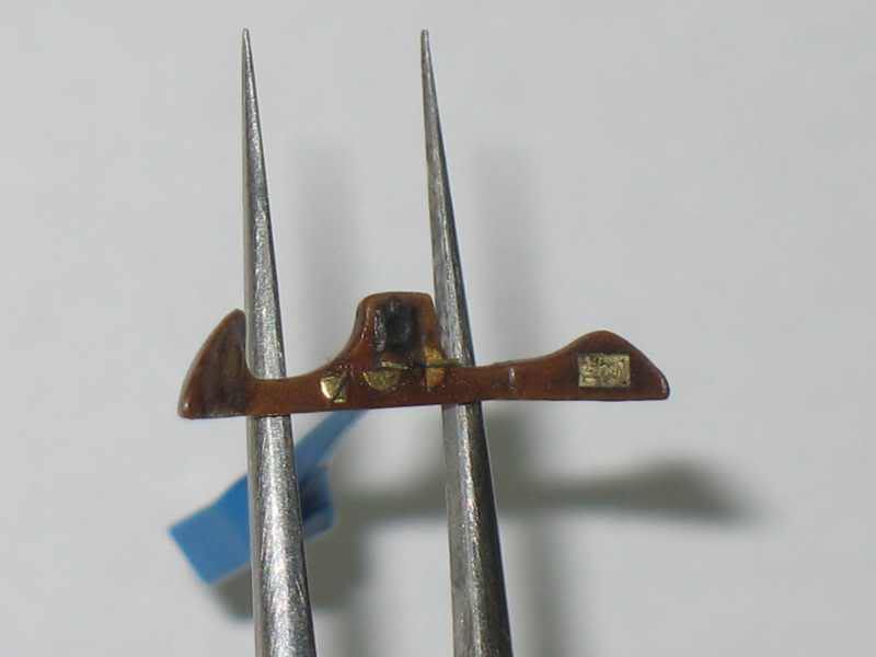

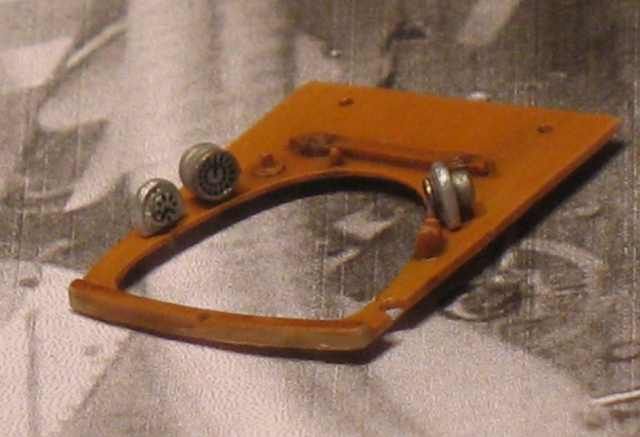

I did again "levers" with photo etch parts "rounded up" in sandpaper. The lever in her even is a small piece of photocut.
The plate is photo etch parts.
The stem blue is a piece of "square" plastic stretched above a flame. It keeps its square form.

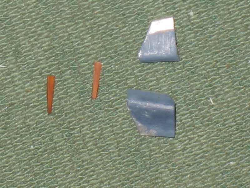

Always slower:
I returned the edges of the opening more slim and added some raidisseurs in metal and pieces of plastic.

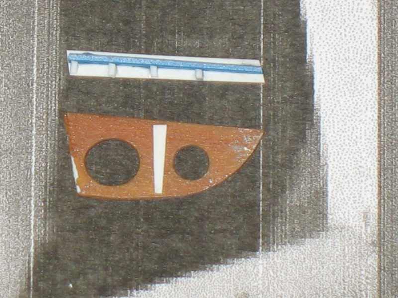

Some pieces of copper and tin:
The plate in alu (too big here) comes from a dish to industrial pie:

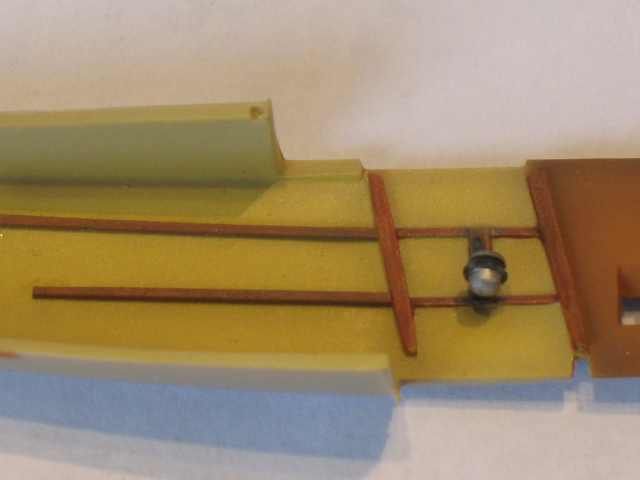

Small pieces of plastic and thread of copper:

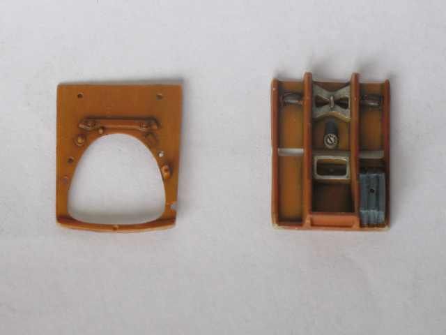

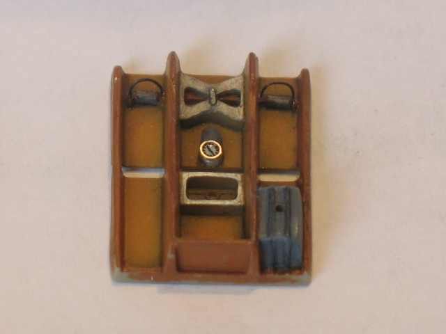

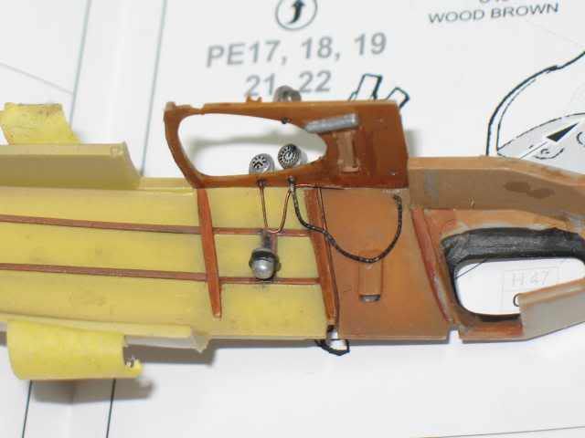

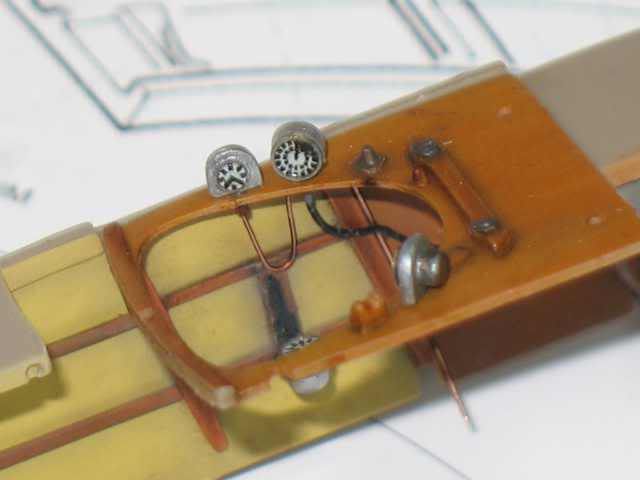

The post of piloting is finished. The handle which opens the shutters of hood is a plastic triangle painted in brown, left grey is painted by top. The lever is a fall of photocut and the handle a stretched edge of plastic cut in the blade of rasoire.
The maul is plastic stretched.
I chose to glue together the bottom of post on a side of the airframe what seems to me less risked than to glue together it on the wing inferior and its girders (as stated). I however tried. I could not even take in the bottom of post into the airframe...

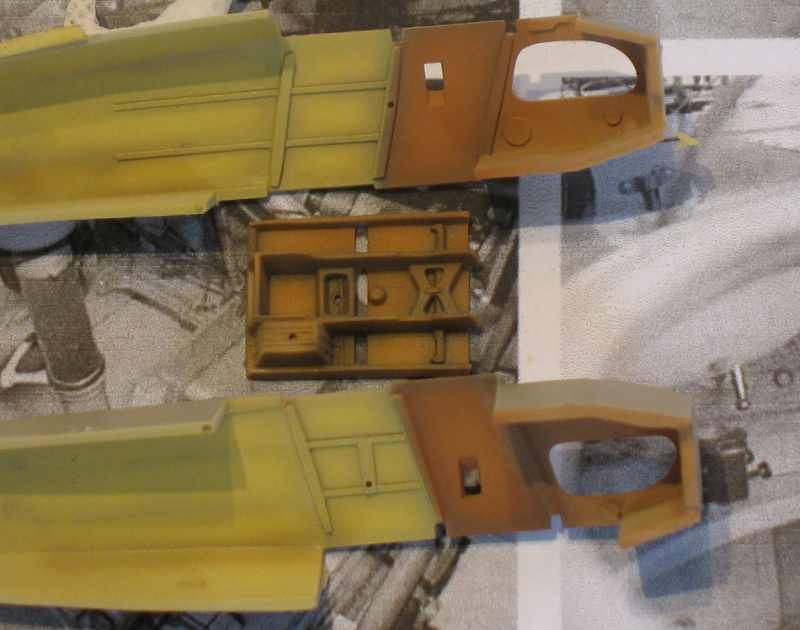

It looks like the upper cowling deck is arched too high.
Louis
Bas-Rhin, France
Joined: May 21, 2006
KitMaker: 472 posts
AeroScale: 471 posts
Posted: Saturday, February 21, 2009 - 06:56 PM UTC
Hi
N°1 is just put down but not glued together. Or is it second one?
JackFlash
Joined: January 25, 2004
KitMaker: 11,670 posts
AeroScale: 11,012 posts
Posted: Sunday, February 22, 2009 - 08:18 AM UTC
Its like a bridge that is too high and needs to be pressed down in the middle to spread out the legs wider. The "second one" or "instrument shelf" may need beveling at the outer edge. But After bending open Part #1 I would cut down the inner edges too.
thegirl
KitMaker: 6,743 posts
AeroScale: 6,151 posts
Posted: Sunday, February 22, 2009 - 10:48 AM UTC
Could this be a flaw in the kit and something for other builders to watch for ?
Louis your work is outstanding ! The blue in the cockpit really draws your eye into the detail . Looking forward to more .................................................
Louis
Bas-Rhin, France
KitMaker: 472 posts
Posted: Sunday, February 22, 2009 - 11:37 AM UTC
Thank you
The kit is not "conceived" (?) correctly!
I sanded a lot the inside of cover (the one,1) and taken down a little (1/2mm) the second one (2).
It's ok now.

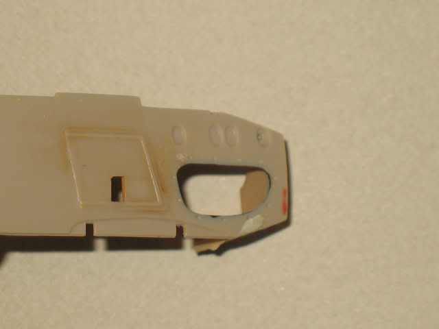

I repair holes today:
I glued plastic card (0.4mm) on the front of the plane. Left side was too short....
I 'm carving and sanding plastic card, and....It's not good:
I glued an other plastic card (0.15mm):
and an other on (0.15mm)
I sand the "nose" of the plane on a piece of sandpaper layed down flat (?)
I put a little glue (in red) on the angle to consolidate the whole and sand it.
On your left it's OK, on your right it's NOT OK (white):
We must glued both side together very strongly, and hope...(The underside of the plane is not glued together).
I ask myself if I am not going to take away the plate to do it again in plastic card. The top of the plate is difficult to sand and the angle must be right-angled:
Any sugestions ?
