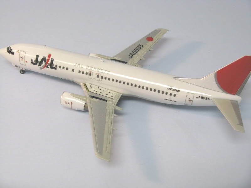

Whether you use flat or gloss white the deal is put it on in thin coats and build up enough coats until you like the coverage.
The back end of this 1955 Bel Air was sprayed with gloss white lacquer built up with numerous coats and then polished out.
This Boeing 737-400 was also sprayed with successive coats of white until I got the coverage I was looking for.
HTH
Glenn

Posted: Sunday, September 07, 2008 - 09:01 AM UTC
So, if the paint is pooling is it too thin or being sprayed too heavily? Nice work!

Posted: Sunday, September 07, 2008 - 09:16 AM UTC
It shouldn't be pooling or dripping or running. I'd say either it's too thin and/or you're holding the airbrush too close to the item being painted or holding it on the same spot too long so that the paint builds up too fast and runs. For me successive coats means misting it on, maybe, 8-10 times or more. Depends on what color you're covering up underneath. Wish it were a science but it's more an artform. You'll get the idea. Keep at it!
Glenn
