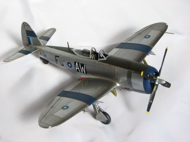

For priming under Alclad I use Tamiya Gloss Black Acrylic.
I Future the Alclad before and after decalling, and it doesnt effect the paint job.

That is a Kick ass Thunderbolt Nige.
Really kicks it and i n 1/72 even better.
