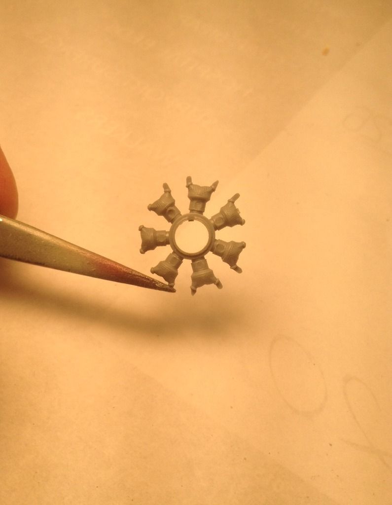

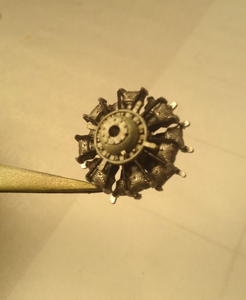

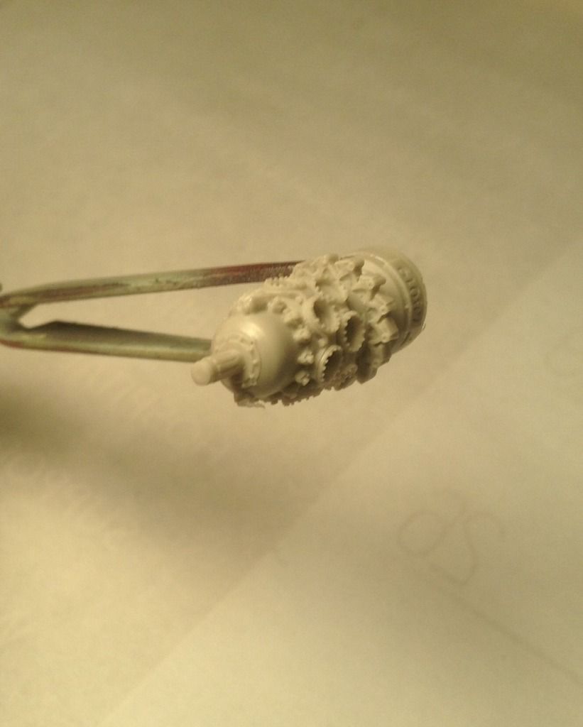

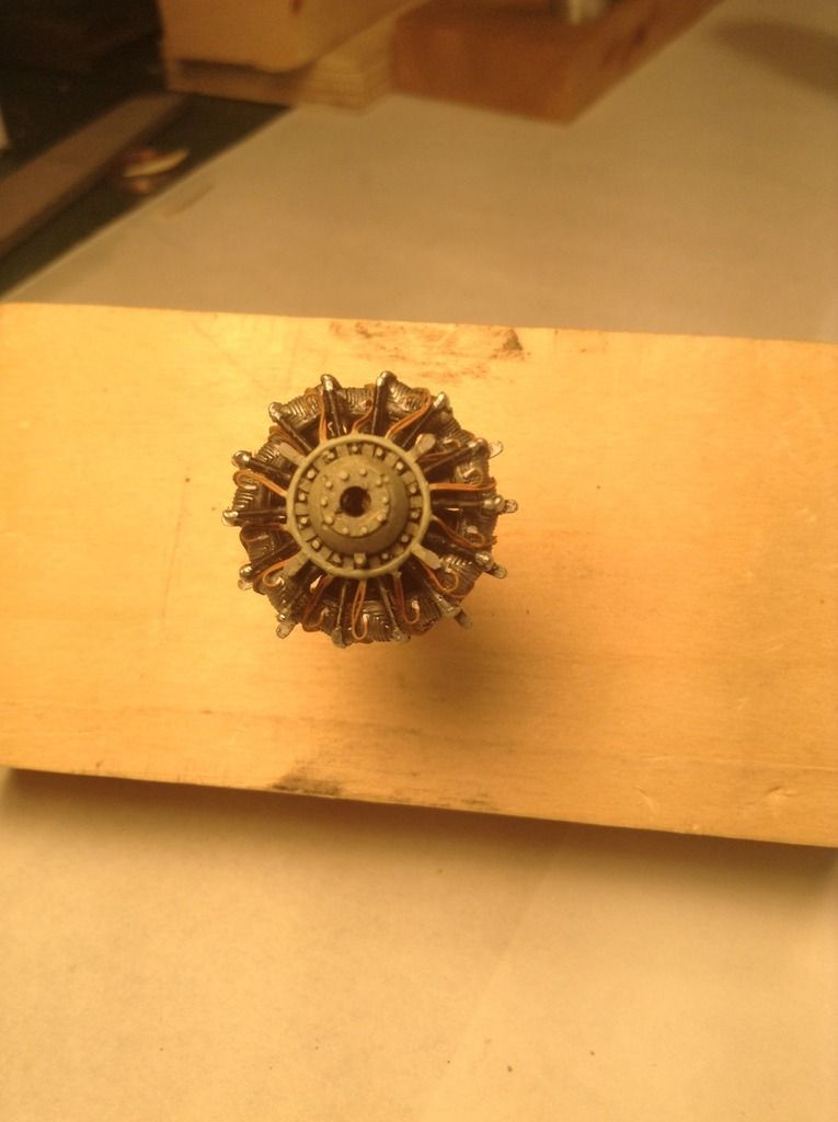

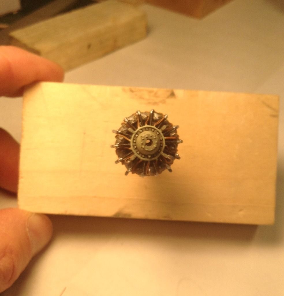

A little more work on the engine - Nakajima Sakae
The kit cylinders suffer from pin marks on the cylinders - not a problem on the front bank as the marks face the rear but on the rear bank they can be seen between the cylinders of the front bank.
This was cause for concern as it marred the fin detail which is difficult to replace. Then I found this -

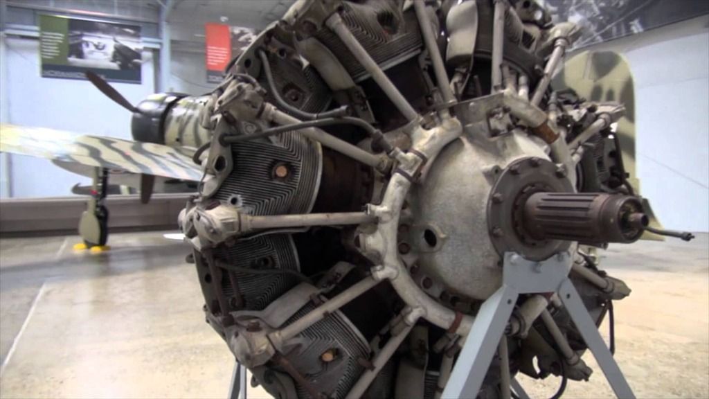

This is an original in the Flying Heritage Collection and as can be seen there is very little finning evident on the cylinders themselves which are likely cast iron- prominent finning only on the aluminum cylinder heads.
The solution was then very simple- I just sanded all the cylinders.
Here is the engine in paint ready to receive the spark plug leads-
I drilled 14 holes in the outer circumference of the ignition harness tube for 14 pairs of wires - two leads for the dual plugs in each cylinder.
I had purchased a Vector engine as a possibility for this build but as most of it will be hidden by the spinner and the oil cooler I will save it for an early zero project that is resting in my someday pile. Thought I would share some pics of it though for comparisons sake - it's incredible !
As can be seen the crankcase is complete down to the cylinder base flange nuts , splines on the prop shaft , cylinders complete with rocker shaft oil feeds - all of the engine accessories on the back side of the crankcase are supplied as are all the induction runners. The only thing missing is
exhaust manifolds which of course would be different on each aircraft type any way .
Thanks for looking in and as always all comments welcome -Richard

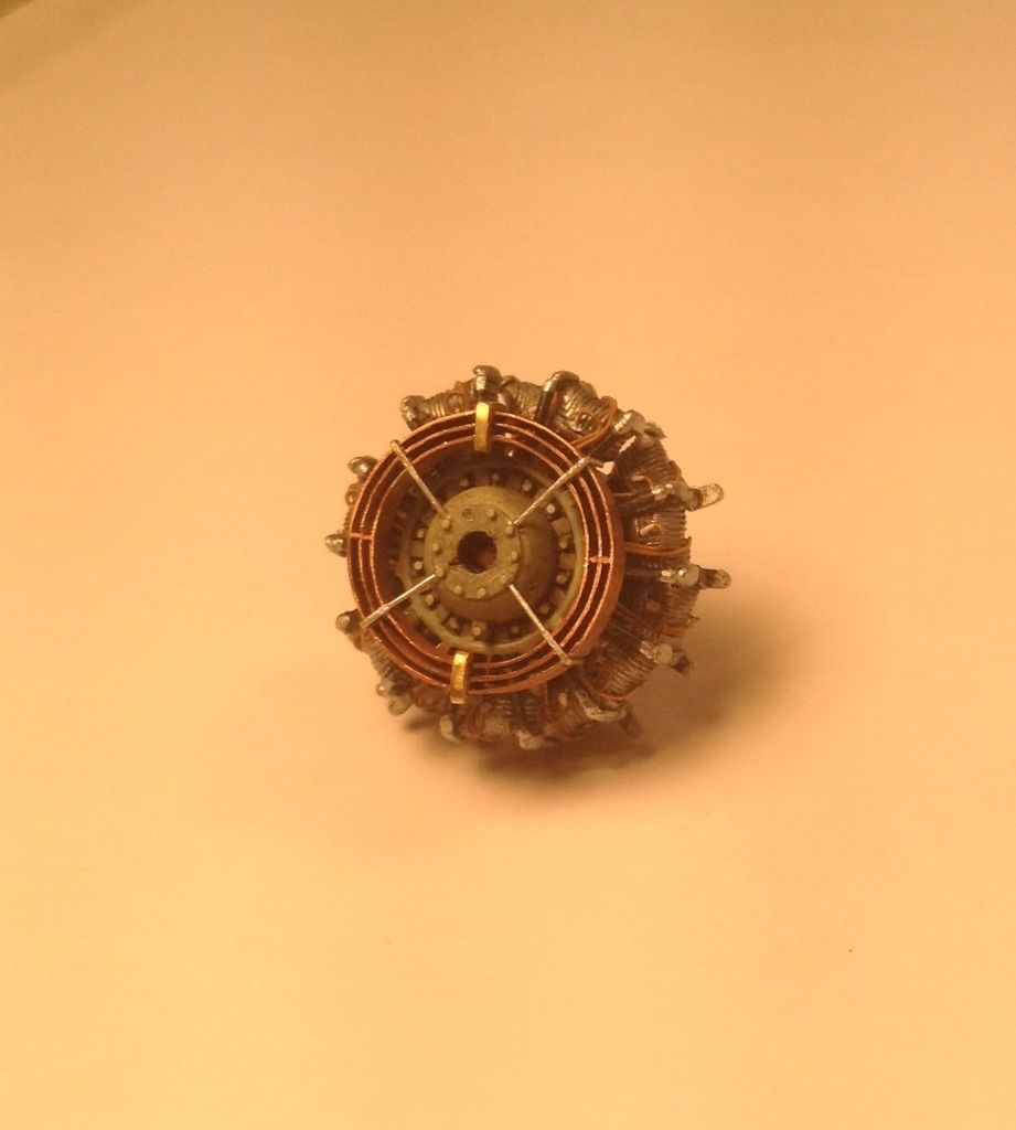

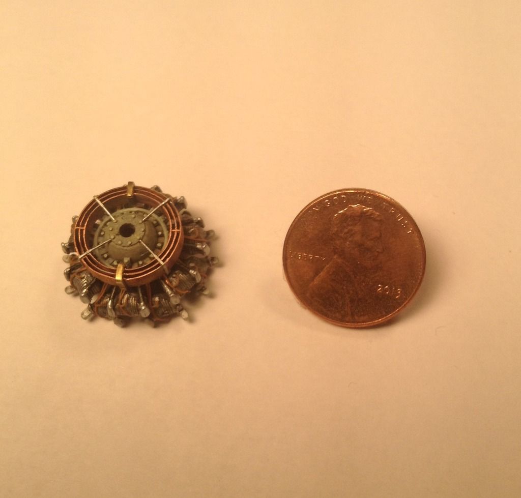

Here is the engine with all 28 ignition leads while they can be seen -

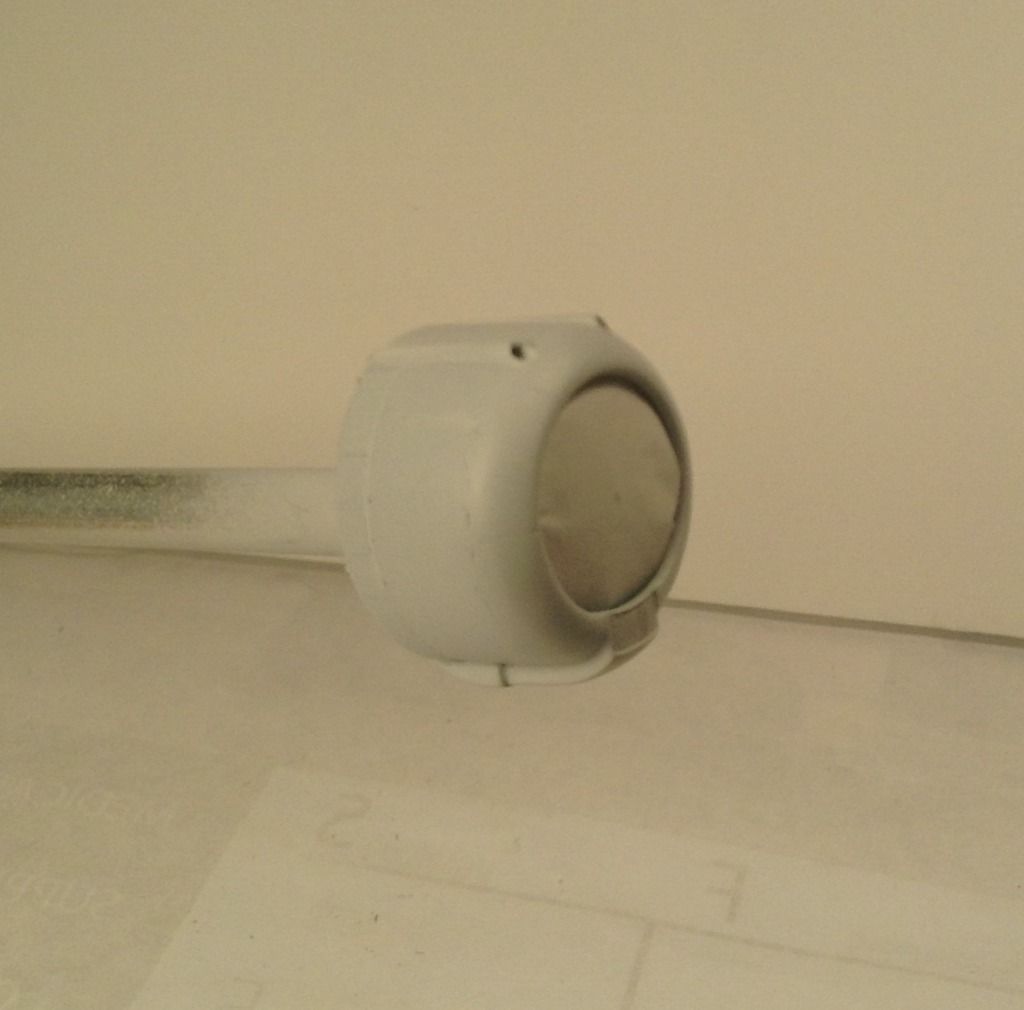

And here it is with the annular oil cooler installed . The mounting clamps/struts were made by flattening one end of a piece of brass wire and bending the flat part around the radiator coils and inserting the round part into predrilled holes in the propeller boss. All was fastened with medium CA.
I still need to add the oil feed and return lines to the cooler.

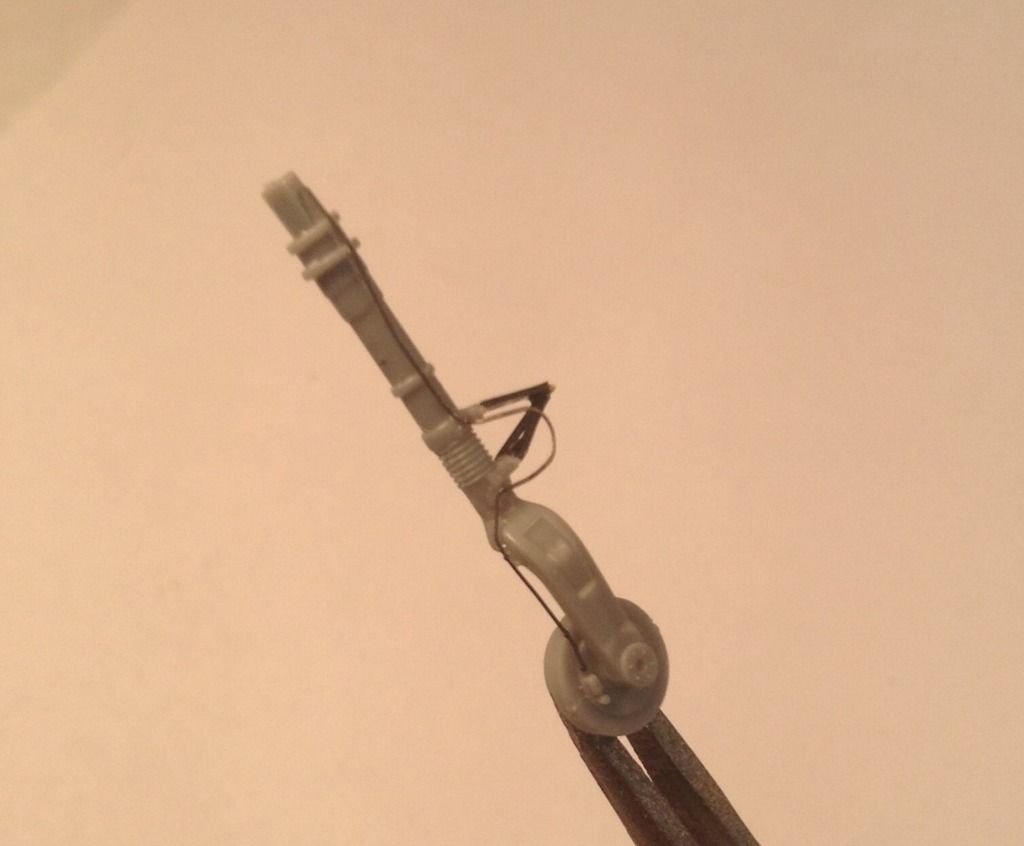

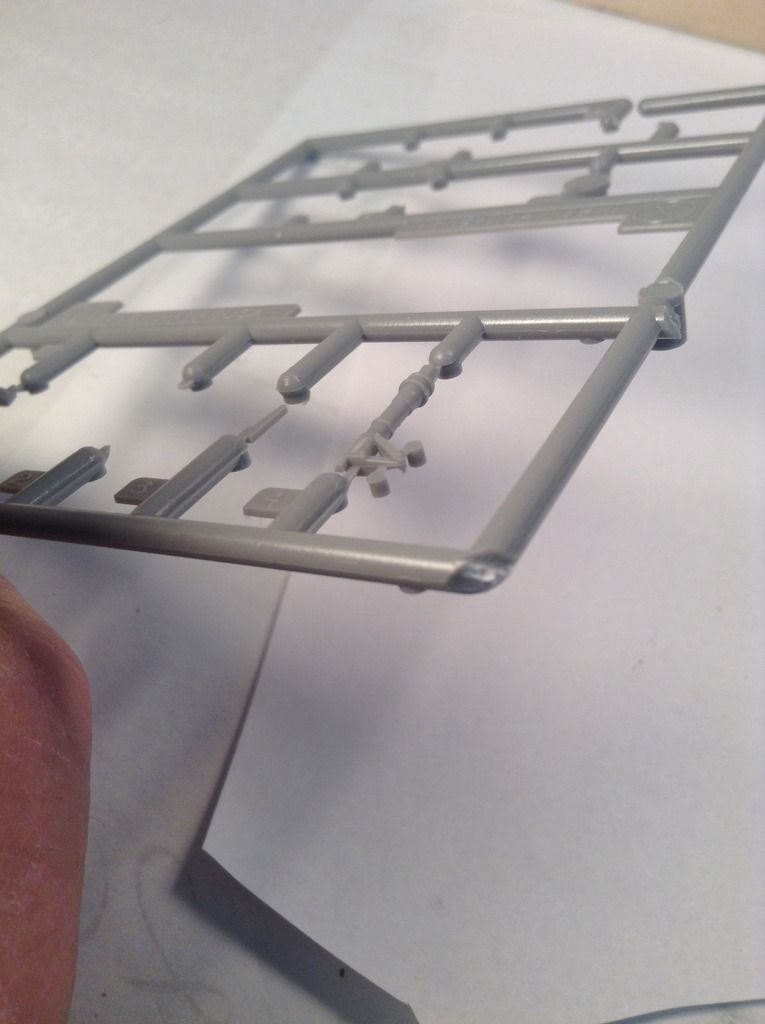

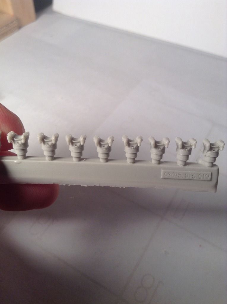

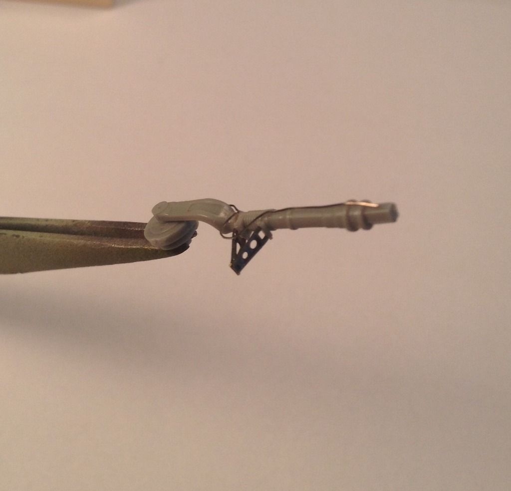

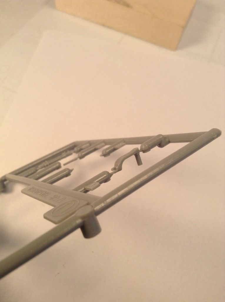

I have started on the main gear - Hasegawa molded these in a clever but structurally weak way so that both the left and right gear can be made from the same molding - duplicate sprues. The yokes are joined to the bottom of the oleos below the torque links with a cruciform interlocking butt joint that allows the yoke to be rotated 180 degrees. This allows the spindles to face outward on either side with the torque links trailing aft . I suppose this saved Hasegawa a few bucks in tooling but I wish they hadn't done it this way as it is not only weak at a critical area but it also makes axial alignment between the oleo and the yoke difficult as the keys in the butt joint have considerable play in their fit.
here are the components -
Here is one main gear leg with Eduard's photo etch torque link scissors and brake line added-
I have also added more photo etch to the fuselage - rivet detail wrap and gusset plate to the headrest area and actuator horns for the flaps.
As it is nearly time for paint I am going to have to choose which unit/markings. I have it narrowed down to three from two different Lifelike sheets.
Thanks for looking in ! Richard

Richard,
Agreed that the almighty dollar played a big part in the decision to do the gear the way that they did, as the geometry does lend itself to it. The result can't be the strongest strut.
With you machining skills why not drill a hole from top to bottom after the glue joint is dry for a steel rod. That would make the strut 100% stronger.

Richard,
Joel -
Reinforcing the joint with metal would definitely be stronger but drilling all the way through the oleo from the top to the bottom would be very difficult to do without the bit wandering off and coming out the side , and the wheel spindle prevents drilling from the bottom . In hind site the thing to do would have been drilling down through the yoke and up into the oleo before they were joined - but alas I didn't.
I let the joints cure a long time before proceeding so I hope they won't be problematic.

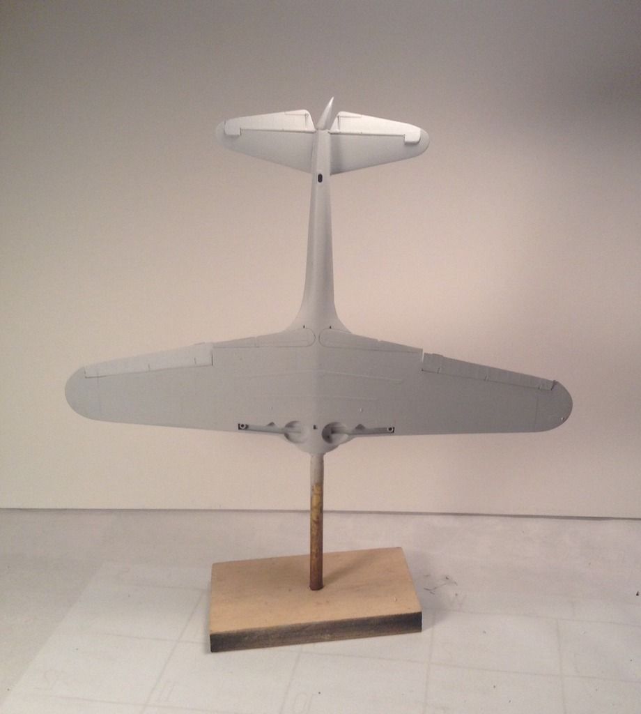

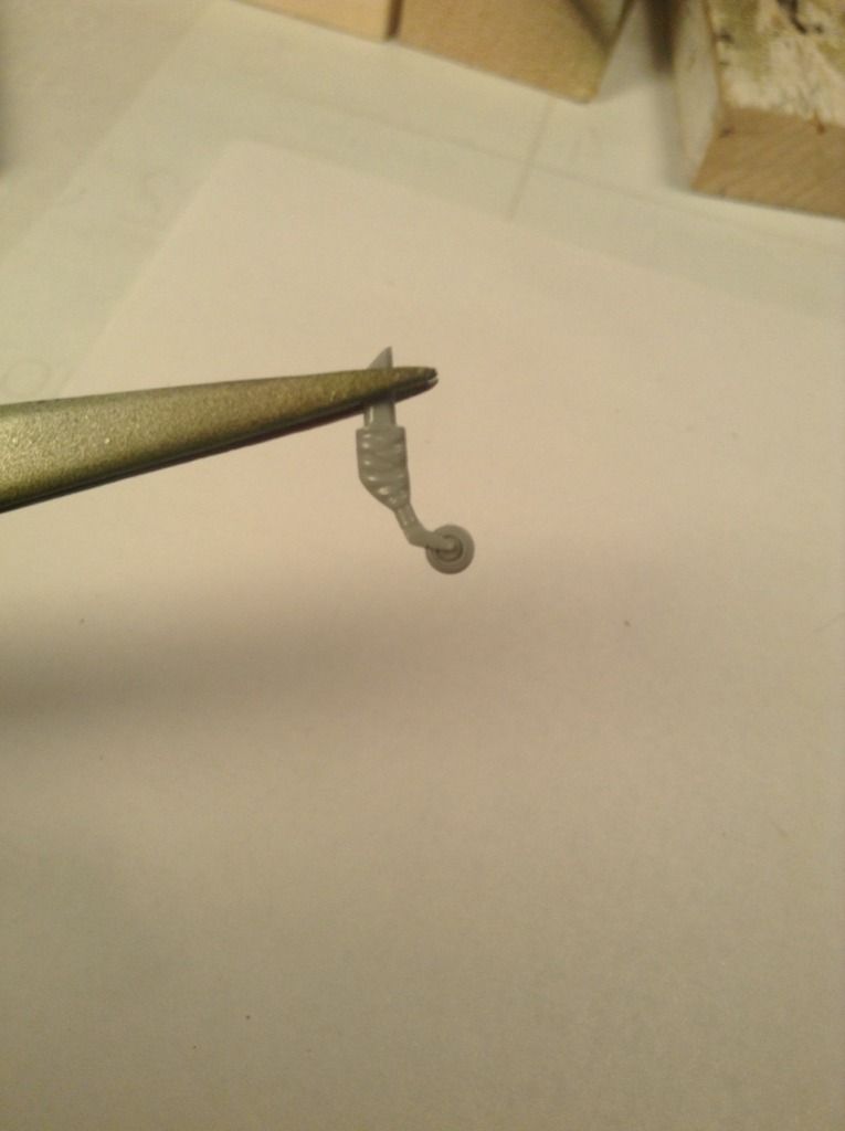

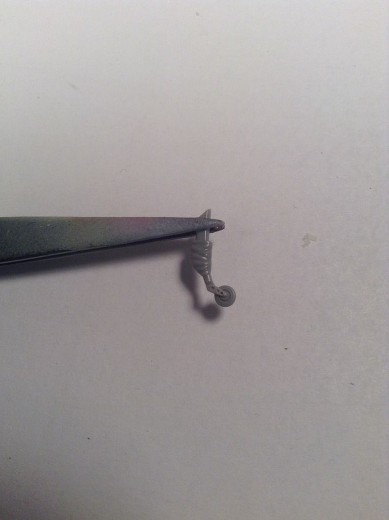

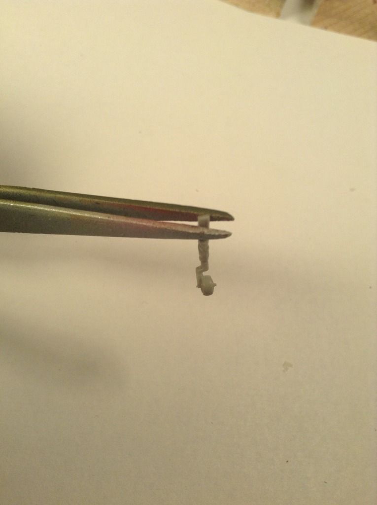

I've spent a few minutes improving the tailwheel by carving the top of the yoke away from the tire and ading the three lightening holes in the side of the yoke - don't know how much will be seen with the wheel in the grass .
here is the tailwheel as it comes from Hasegawa -
and after tweaking -
I've decided on this scheme - A/C # 1 on Lifelike's sheet 48-041-
Flown by Major Kinshiro Takeda , Commander of 1st Sentai operating out of Hanoi AB/Indochina 1942. I like the overall IJAAF dark green wrapping around the leading edges /wingtips and on to the lower wing surfaces and the lack of the anti- glare panels on the fuse deck and no yellow ID panels on the leading edges. This speaks to me of early Hayabusa.

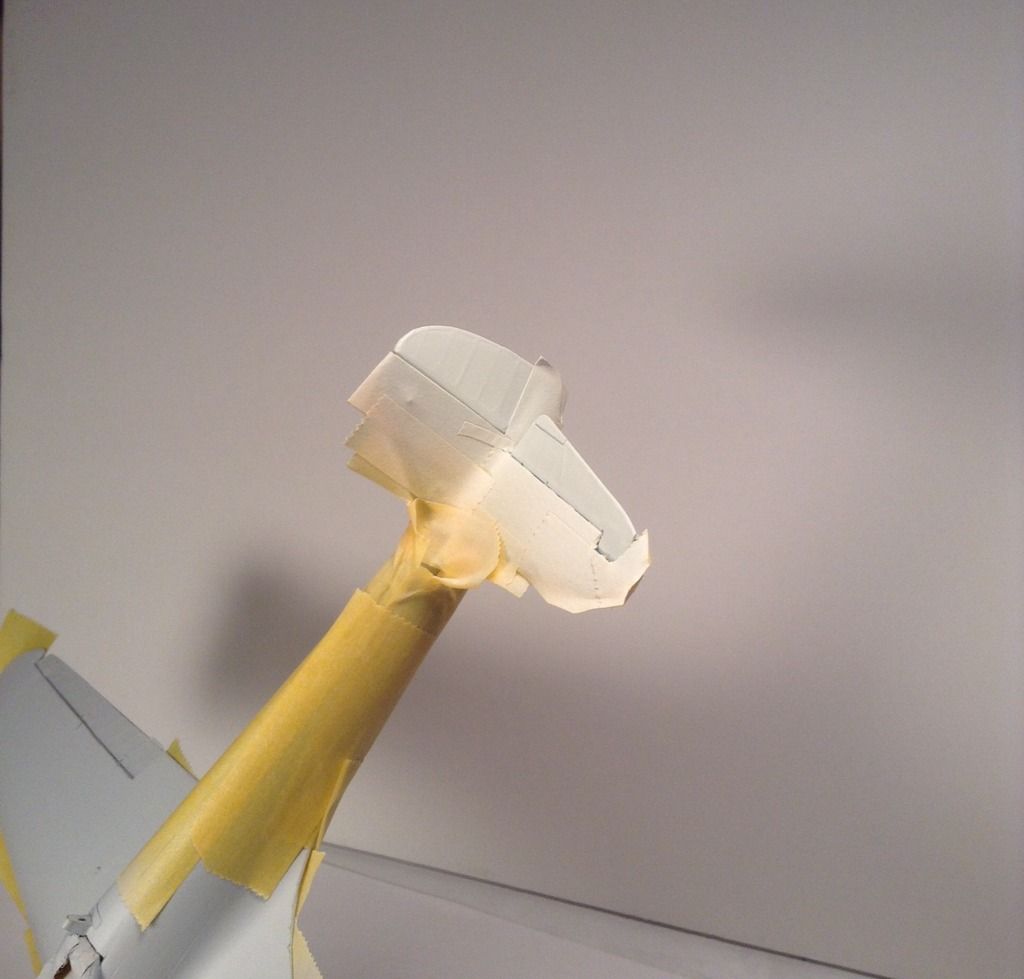

I've sprayed the control surfaces at the tail in white as a base for the yellow -
and the underside of the ailerons in IJAAF light grey green -
All colors so far Vallejo Model Air.
Thanks for looking in - Richard
