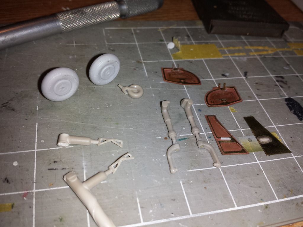

The most fiddly bit of this kit is the landing gear. It doesnt have positive joins for any of the involved pieces, so care will be needed to ensure things are strong enough to support the kit and stay somewhat symmetrical. Ive elected to replace the featureless kit wheels (right) with some nice resin units from Armory (left). The detail is very subtle but should look just right with careful washes and dry brushing.
And just to ensure I dont lack for things to do I've decided to shorten the landing gear oleos a touch as they are portrayed at full entension. Not sure which way to go about this yet but Ive got some workable idea's
RhinoSpit

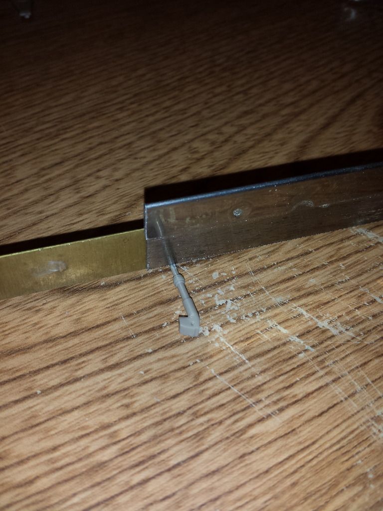

I was successful in my shortening of the gear leg oleos. To do this I first drilled a hole up from the bottom of the wheel yoke into the oleo.

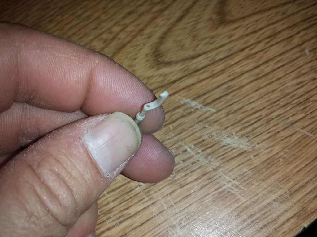

Next I may an index line with a sharp pencil do they can be realigned correctly. Then using a brass rule along with my mini saw, whose combined width was about 1mm, exactly what I wanted to remove, I cut through the bottom of the oleo.
After a clean up with sanding sticks I cut some small brass dowels and pinned them back together using CA making sure the were properly aligned beforehand and voila' shortened gear legs!!!
I also got my resin wheels flattened nice and evenly, my oleo struts thinned and hollowed out (Id like to try these before resorting to the photo etched ones) and I used my drills and xacto to sharpen up my tail wheel a bit.
The etched gears doors lacked a bulge that was found on the plastic parts and the real thing. So I shaved these of the plastic bits and CA'd them to the doors and some more CA later to help fair them in. Followed by some careful sanding. These doors are super thin!! Possibly too thin but Im using them now, Im commited
