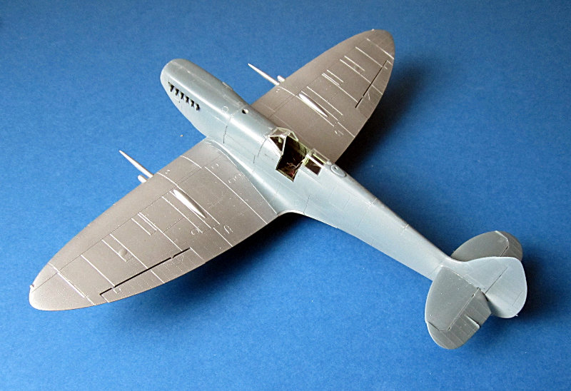

Again (see Bf 110D thread) I started with the wing and this was maybe the best fitting subassembly I ever built! It literally falls together. As I was in "the flow" I opted not to paint the background of the winglights but just glue on Alu-foil. This allowed me to close the wing immediately.
Then I glued as much parts into the cockpit as I could, followed by a Layer of silver and then interior green. A first black wash is on but of course the pit needs some fine tuning.
With the silver (decanted TS 30) I also sprayed the wing just to find some imperfections:
Waiting for the PE now to get instrument panel and seat belts in..

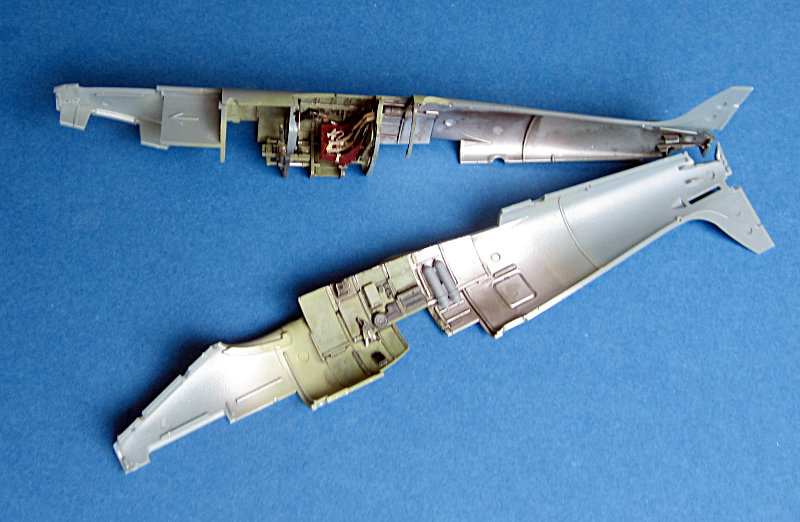

So the stuff arrived here and I am back at the kit:
all the best

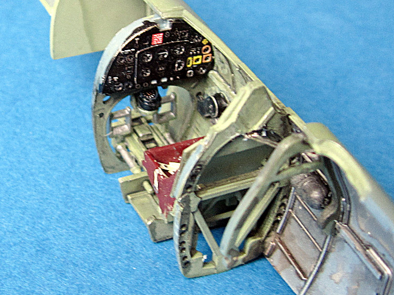

Posted: Friday, March 06, 2015 - 03:49 PM UTC
Hi ahain,
I attached the seat belts and glued the seat to the cockpit. Then I started with the instrument panel.
all the best
KitMaker: 10,931 posts
AeroScale: 7,378 posts
Posted: Friday, March 06, 2015 - 07:11 PM UTC
Steffen,
Really nice progress on the pit. Your IP looks great.
alpha_tango
Joined: September 07, 2005
KitMaker: 5,609 posts
AeroScale: 5,231 posts
Posted: Friday, March 06, 2015 - 08:10 PM UTC
heers Joel,
well, it is just the Eduard panel, that is what I like most in their sets...
hard to photograph though...

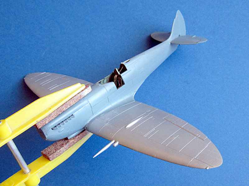

now the cockpit is halfway done I could progress quite a bit. The fuselage is closed and glued to the wing. The tail control surfaces were completed yesterday.
This morning I added lower cowl, exhausts and upper cowl. Don't be fooled the clamp is just to hold the cowling down while the glue is setting and this way I can control it better than with tape.

Steffen,
You're making really good progress. BTW, have you considered using the now fashionable Magnus Spit on a stick technique for the painting process?

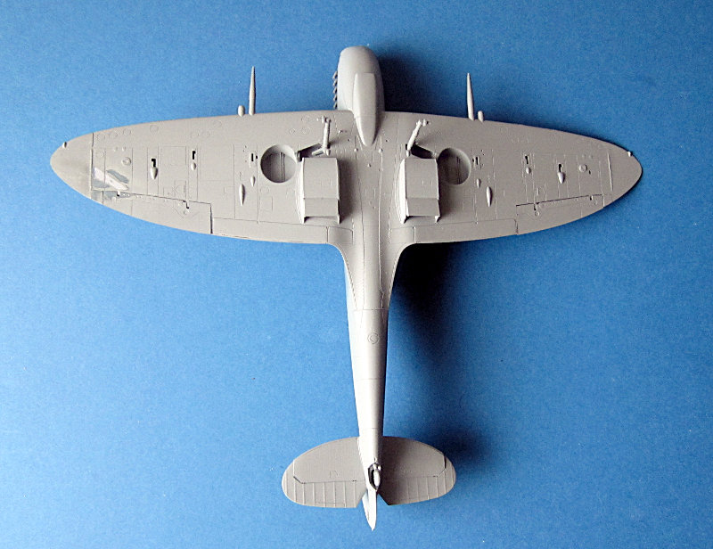

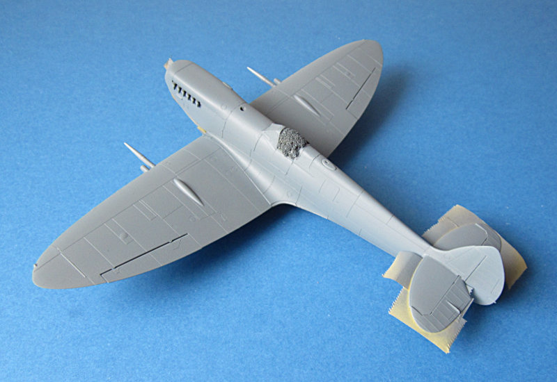

Posted: Saturday, March 14, 2015 - 09:07 PM UTC
Thank you, guys!
We'll things slow down a bit at the moment. I have completetd the pit with steering column and gun sight. I added the undercarriage legs and parts of the canopy.
When I sprayed the underside I noticed a sink mark due to excessive used of glue, which I filled and sanded.
all the best
P.S. @ Ernest: Well, I have a lot of projects running parallel, sometimes the progress is good sometimes not so. I have several "lack of motivation points", Biggest is cockpit but sometimes I also have problems with painting and decalling ... and finishing it. If I reach such a lock I just start something new or grab a started project. It is not efficient, but it suits me and in the end it is just a hobby meant to be fun...

Posted: Friday, March 20, 2015 - 02:27 PM UTC
Now the filler is dra I sanded ad repainted that area. Then I taped off the elevators and "keel" and sprayed the upper side ocean grey (all Tamiya) IMO it is a bit light but considering a scale effect it is o.k. (I did add a small amount of black though you can hardly see it)
Next step will be masking the camo (I am just too hamfisted to airbrush it free hand)

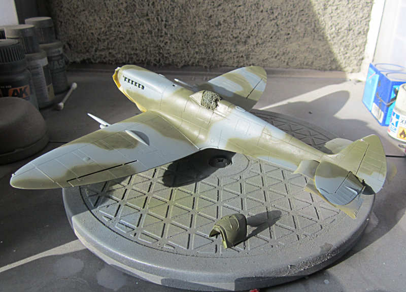

Posted: Saturday, March 21, 2015 - 01:27 PM UTC
Cheers Joel,
I use the new paints XF 81, 82, 83 and I think they are optimized for their 32 scale Spit.
Sadly the paint scheme in the instructions does not meet the A-scheme pattern of Mals Miracle masks. There are other planes in the kit that do, so I guess this is just a different schem. Thus I had to bite the bullet and paint it free-hand (it is much too laborious to cut masks for the whole thing)
I am not totally happy, but it is the best I can do. Also I noticed that the tail band is not included in the decal sheet, which is a problem as I should have painted it first to ease masking. The white wing leading edge is the next step.
all the best
KitMaker: 17,400 posts
AeroScale: 12,676 posts
Posted: Saturday, March 21, 2015 - 02:25 PM UTC
Nice one Steffen
Great job on the free-hand camo!

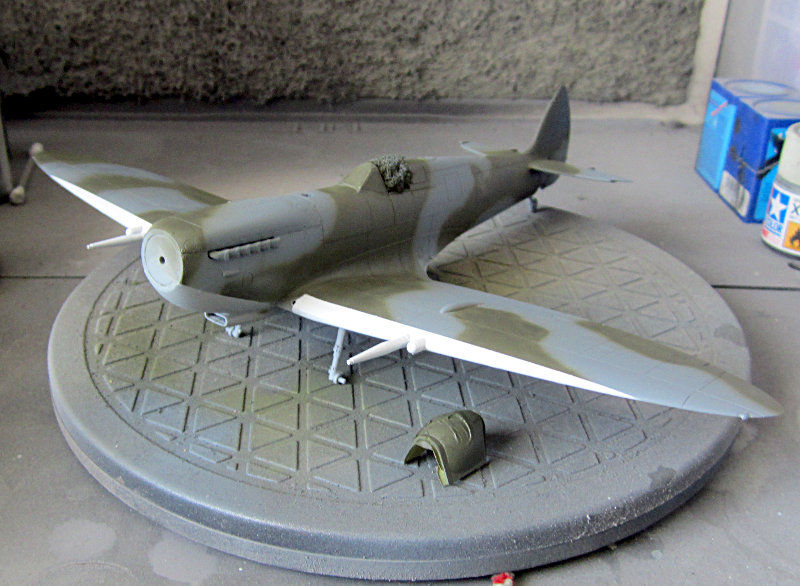

Posted: Saturday, March 21, 2015 - 04:41 PM UTC
Thanks Rowan!
here is the white theatre markings on.
Still undecided about the fuselage band. Either decal or airbrushed, both bear some work in it. Next is a clear layer as preparation for the decals.
