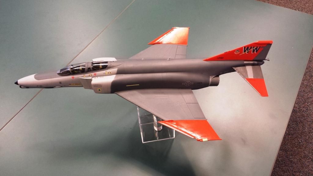

Some things to add on the Revell F-4E/F:
Cockpit:
The rear cockpit tub is too deep and is best raised about 1/8". No sidewalls does not help things, as this could have been an easy thing to add on Revell's part. No hope for them in the new Revell F-4G, as I've seen the sprues.
Canopy:
Not a lot of modelers know about Revell's F-4 canopy, but the aft canopy is too long and the front canopy a bit short. It's not as noticeable as the Intakes or radome/nose, so it's not really an issue that needs to be addressed.
Landing Gear:
The nose strut is way too narrow in diameter, much agreed as having worked the F-4 when I came in the AF, this was something I noted right off the bat when the kit first came. However, the narrow kit strut is not close to any version of the F-4, even the F-4B/N, much less the S. The F-4S shares the same basic strut as the F-4J and E. Even SAC's metal gear replacement missed this, so we're still looking for a correct nose strut for the Revell 32nd F-4s; though there may be one coming.
The main wheel and tires are proportionally off. While the main wheel inboard hub (really the brake end housing) is somewhat accurate, the outboard brake hub side is totally wrong.
Intakes:
Actaully, Revell's F-4 intakes are way off shape and profile wise. Looking from the side profile, the upper intake does not properly slope down, thus results in them riding too high on the side fuselage and the mouth profile too tall. Lack of intake ducting is also another negative to this kit.
Exhaust:
These are a bit narrow (not as bad as Tamiya's) and lack the "stand out" Divergent/Convergent segment details on the inside. The Exhaust ducting and turbine section are poorly done.
Wings:
Not need to worry here as all is good, even the wingtip angle; Tamiya's the one who go that wrong.
Overall, it's still a decent F-4 alternative to Tamiya, though it stands up a lot better when the pointed nose/Radome, Inaccurate Intakes, wheels, and Exhaust are replaced. A correct wheel set will coming soon too.

I see Darren, no problem. If you're not real sure about something and can't find any good evidence through research, then I can see why one would not comment on it.
However, just because one does not have "concrete/solid" dimensions to confirm a major shape inaccuracy, does not necessarily mean one can't "eyeball" a model and see that there's a major shape inaccuracy, or more. Even before I took dimensions of the nose struts, radome, and Intakes, I could tell they were significantly wrong in shape/size just from looking at the built up model compared to memory and photos. I do admit to having an advantage of having had hands on the real subject and have conducted a lot research as well.
I've taken the dimensions of the F-4B, F-4J, F-4S, F-4C, & F-4E main and nose struts. All NLG and MLG struts have the same dimension as far as thickness is concerned, expect for the F-4B, which is only 1/4" smaller in diameter in the MLG and 1/2" smaller in diameter in the Nose strut, which in scale would be hardly noticeable.
None the less, a good review and discussion. BTW, Revell has addressed the nose/radome shape inaccuracy. We gave them a sample of our corrected F-4E/F Nose/Radome to work from. I have not seen the test shot yet, but should here in about a week or two. I hope they made the pull off this correction.
