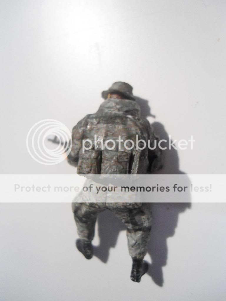

Shinsengumi decals are the best out there. I have tried Trumpeter and a couple of other brands. Here is my take on them.
Trumpeter: Really thick, backing film isn't very flexible. Only really usefull for legs and arms with no bends, and no fine details.
Alliance Model Works: Same as Trumpeter, a little more flexible. Used heaps of decal setting solution, and couldn't adhere to molle straps very well, broke apart quickly.
FFSMC Productions: Not bad, but the Multicam pattern I bought didn't have any white printed on it, it was the backing paper. The decal is semi transparent. And a little thick too. You will need to undercoat with a suitable colour. White is a little bright, so I used a yellow, then an off white.
Shinsengumi Decals I found are the best. Thin, printed great, and will settle into details very well.
I painted some figures with a base colour similar to whats on the decals, then gloss coated them. The gloss coat does help with moving the decal around, and then adhering to the figure.
Shinsengumi Marpat:
Alliance Model Works ACU
Trumpeter on legs:

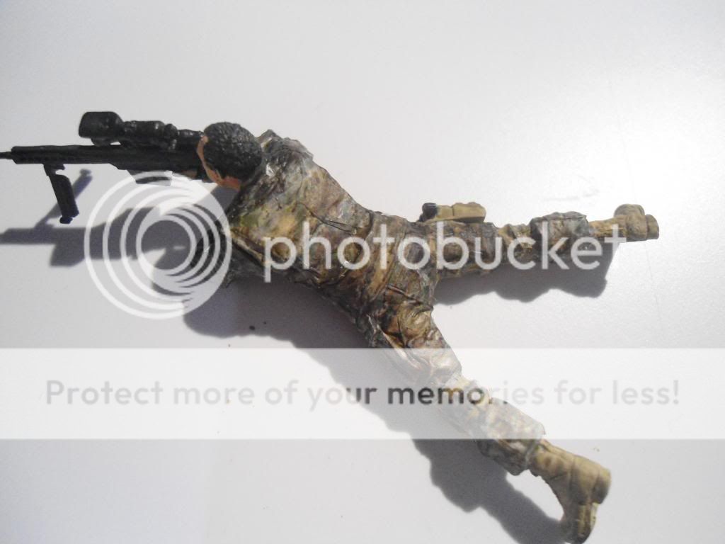

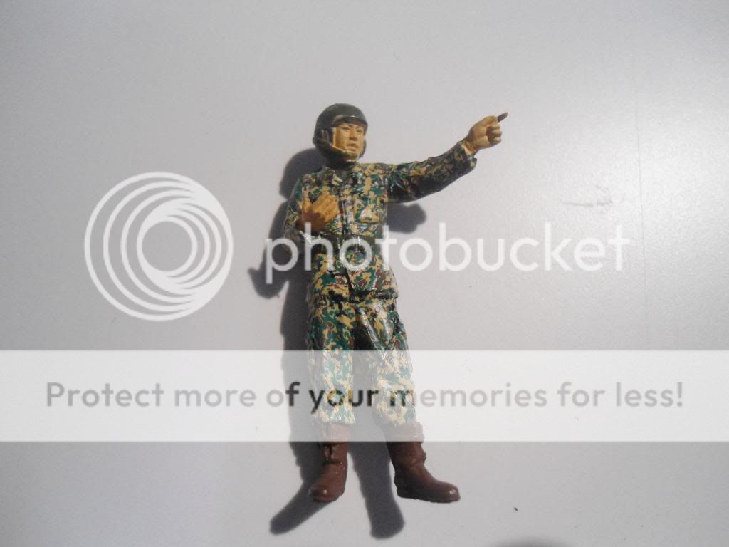

I got the pictures above wrong, the Marine Marpat is actually a Cross Delta Decal. These are on par with the Shinsengumi Decals. The figure below is in the Shinsengumi JGSDF camo:
This is in the FFSMC Multicam.
The sniper has been undercoated with an off white. On his upper back, I did a band of yellow, and realised this was too yellow.
This is another figure done with the Multicam, but undercoated in white.
