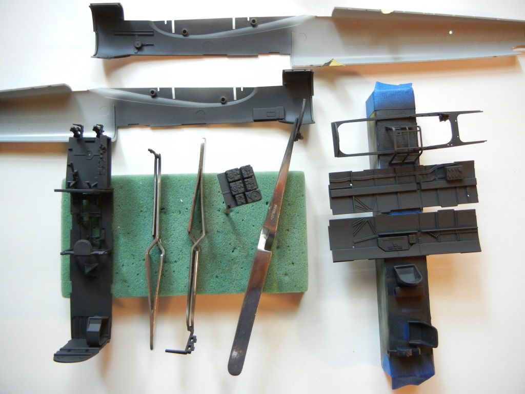

That decision being made, I've pressed on with painting the interior sub-assemblies. I started by painting everything flat black:
I then painted RLM 66 over the black, starting by spraying 66 in the areas between details, then spraying thin coats over the entire part until I got the look I wanted, which left low-lights in the right places (hard to see in the photos):
I also assembled the engines and nose gun sub-assembly, as well as the wheel hubs and other misc parts and painted them with semi-gloss black:
Since I don't plan to have the cowls open, I just assembled the basic engine blocks, and left off any small bits. After thinking about it more, and studying the instructions, I may try to built the model without the engines installed. If feasible, I will go that way, otherwise I'll stick these in later.
Next up I'll need to start the detail painting on the interior parts.

I have seen this interior in photos of a real 110, but try as I might, I cannot find the photos again on the internet. It seems to be popular these days, as I've seen two other recent build with a similar scheme
In looking at reference photos of in-service cockpits, I have found that they do get lots of chipped/worn paint, but otherwise stay fairly clean, so I try to replicate that (even though I don't have the skills to do a good chipping job).
I have put some scuff marks where the paint was worn through on the floor of the rear cockpit, since the floor was the "original" paint, and added some dirt to the floor of the front and rear. I did add a little paint wear (using drybrushed silver paint) to the seats and other high wear areas, but most of this is not visible in the photos.
While the instructions can use a bit of improvement, overall, I am impressed with the detail provided by Dragon for the cockpit, and everything fit very well. It looks great to me painted up, and should satisfy anyone who wants to have a peak inside once the canopies, etc. are on. I am so pleased with the results, that I won't be adding any details to any future builds and will build it out of the box as I have on this one.
I closed up the fuselage today, and will let it get all set and will start minor sanding tomorrow (the nose and the rear cockpit cover are not glued in the photos):
Will need to do a little sanding and re-adding of detail in this area (my fault as I should have sanded the top forward edge of the belly insert to get a better fit):
