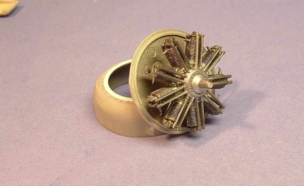

As a model, it has been a favorite subject for decades. In this case I will discuss the Roden 1:32 Sopwith Triplane kit #609. In the hands of England’s Naval Aviators the unconventional Sopwith Triplane was to prove itself well in the hostile skies of 1917. As a model, it has been a favorite subject for decades. Now Roden has come to us with a very versitile kit. You can build either the single or two gunned version from this all plastic kit. Even at this writing there is a build taking place in the Early Aviation forum. The variations and the chosen schemes make this a great kit to sink your teeth into.

I have been working on that for the passed day or so. Remembering the Roden Oberursel I wanted to start with the engine. At first I thought the Clerget was undersized. Note the lip of the firewall on Lars' build from his build thread.
Of nescessity we all know the need for solid glueing surfaces. Just like others Roden has gone with a bit of a compromise. While all of the engine detail is there, the cylinders are minutely short to compromise for the thickness of the inside walls of the plastic cowling.
I haven't finished converting the deminsions to 1:1 scale. I have had some 1:48 drawings pumped up to 1:32 and will be making a comparison. I wish MerlinV were here. He has helped me out with these scale issues before. But I have a call in to Burl Burlingame for his input. The short of it is that I have not run into any problems yet. There are one or two concerns I have but I'll hold off commenting until I check some of my notes.
Note also that Lars has done some extended work on the cowling in adding an inner ring of plastic . I'll let him comment on that but there is a modification there. More later as I come to it.
