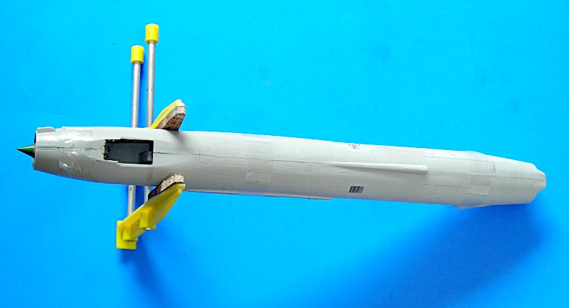

sometimes I just have fun in cutting and glueing plastic. Then I start a new project even if I have a hundred started projects on the pile. honestly I first wasn't all too enthusiastic about the Su-7 re-release, but when I did some research for the kitreport and had a look into the kit I was pretty happy with that and decided to give it a go. Today I got some stuff I ordered for this project: HiDecal decals for Su-7BMKs, fitting Lifecolor paint, and the scoop set by Quickboost:

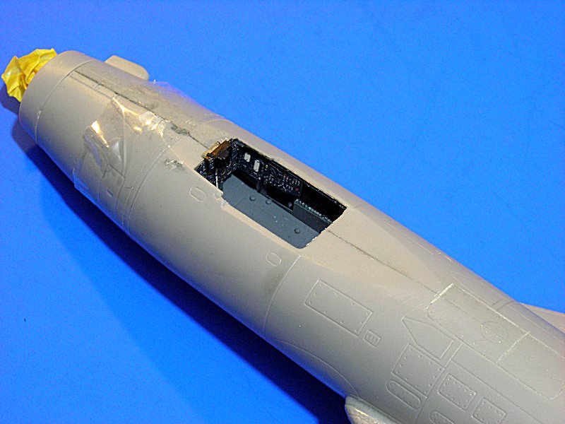

I started gluing some pieces in the cockpit:

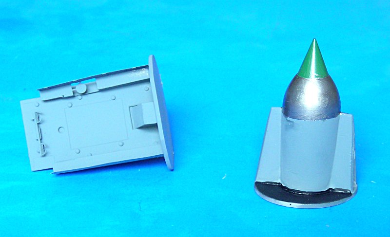

and I used my motortool to grind away the unnecessary plastic on the fuselage. Furthermmore I removed the gills from the fuselage inserts and glued in PE parts:
Not pictured is the nose cone and the exhaust pipe that I also glued together. I am not sure how well I will progress with this build, but it is fun so far...

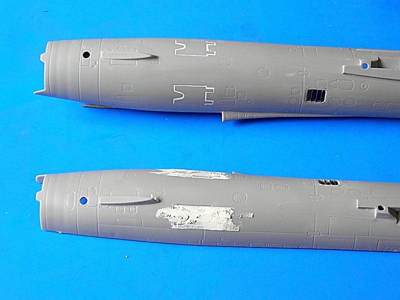

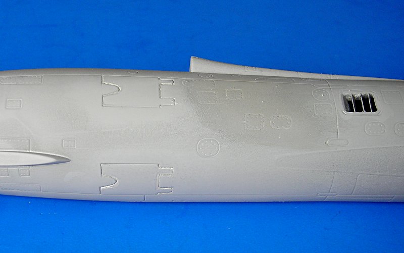

but back on topic .... I do a bit of filling and sanding at the moment, as the speed brakes don't fit at all and I want them closed...

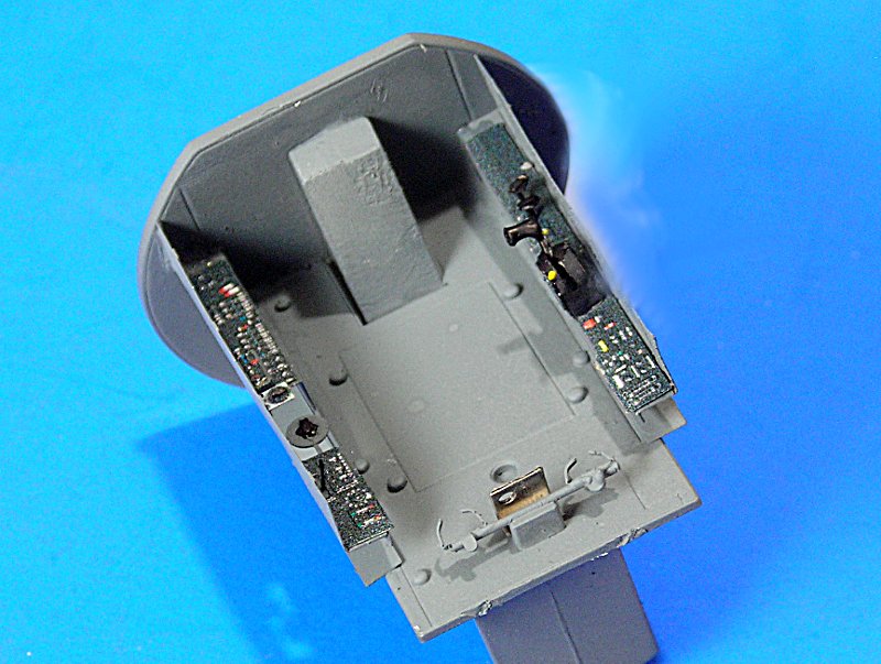

After some sanding and rescribing I put on a thin layer of primer. It is not perfect, but I am o.k. with it ... at least under a few layers of paint

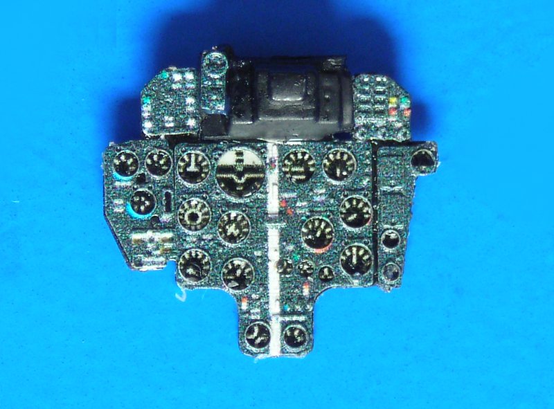

I also managed to add ssome more PE in the cockpit. As many will know this is something I do not really like to build ... and sometimes it shows. I'll keep this area pretty much oob.

After glueing the tub to one fuselage half I turned to the dash .... it is not really fair to make such photos of so little parts, because the grainy surface is hugely overexposed. and yes I slightly misplaced the panels, but I still think it is o.k.

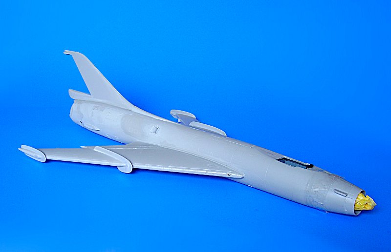

BTW it is difficult to get the wings straight without the rudderfin and vice versa too .... and to make it all look good together is a 4-dimensional problem

Steffen, I like closed airbrkes myself, but usually am unhappy with the result of closing them and trying to re-scribe.
A better idea may be to sand them flush them make a tape "mask" around the perimeter of the brake leaving it exposed and the surrounding plastic covered.
You then spray some paint onto the mask and slowly build up the paint so when the mask is removed you have nice clean edges and a nicely defined edge. The new (paint) airbrake will be slightly higher than the surrounding plastic, but it is a good trade off for nice tight edges.

many thanks for the hint, though that method does not fit my "working style". I do not mind that the edges look a bit wobbly .. it is just wear and tear. If I had planned a little ahead I would have made new ones from plastic sheet that fit better....

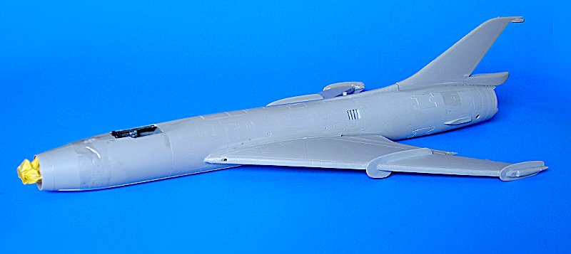

Here is how the plane looks now. I did not really nail the angles, but for now it looks acceptable. We will really see it when the u/c is on. I need to fill a bit under the lhs rudderfin and wing root ... but all in all not much. Of course I put some work into the fit before I attached the parts! ---- especially the fin as a slightly upward angled part would never sit flush to a downward curved fuselage so better sand some plastic before you glue and you will save a lot of filler.
Ahh and the lhs fin part is a short shot. There is a bit material missing at the front, but it is not much and an easy fix.
